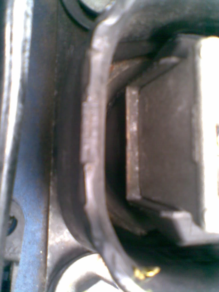

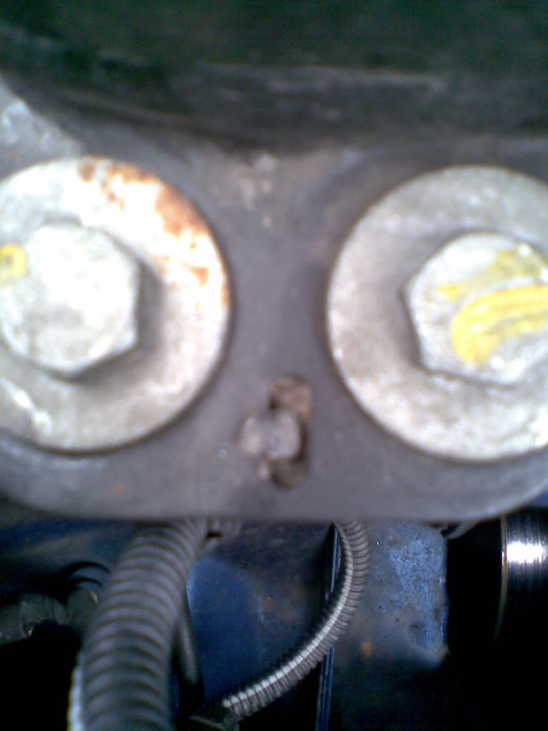

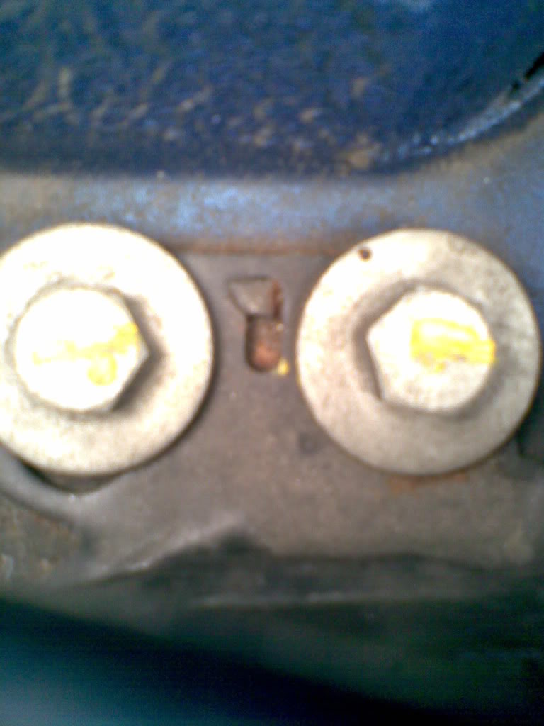

I don't think i can move the engine any futher forward Henry, I've took some pictures on my lunch to show why.
I did however notive the top mount had a bit of movement in in and little bit's of what looked like rubber at the bottom, so think i may need to look at that next :(
Here's the pic's, excuse the quality!
Top part of mount
Bottom part of mount
The mount itself (this don't show much)
does look about as far forward as it's coming
a few people have found that their top engine mount has split/torn in two, so doing that one next is your best bet. the only other mount is the little rubber block on the front of the gearbox, and that's just a support/packing piece really.
at least you'll have all-new mounts once you've done - they're a common problem on these
