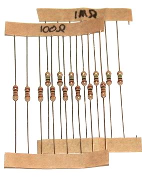

lol - i call them diode's, most people refer to them as resistors. Its a little electrical device which you solder into the wire which leads to the seatbelt pre-tensioner / inertia reel. It prevents the airbag warning light from coming on ( if this light appears on your dash your complete airbag system is immobilised ) with this gadget your dash and steering wheel airbag will still work and also your front seat belt pretensioners

So long as the resistance is between these values above (I'd a resister value in the middle of each of these values) then no warning light will come on.
Just go in and ask for a suitable value resistor, like edde says in ^ something in the middle should do.
edit: Ah, beaten by the man himself.
so i just cut the wire and solder each a wire to each end then done yea?
Theres two wiures to the unit (least I think there are if not then wire the other side to the earthing point on the car.
Cut the wires and solder one side of the resister to one wire the other side of the resister to the other wire.
