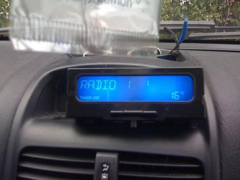

I could easily make a guide on how to do the standard CC..if I had the dials. Its PISS easy. The Clock though, to do it PROPERLY requires a bit more faffing around. NOT repalceing the bulbs then the overlay bit with an LCD filter. Thats cheating and it looks s**t

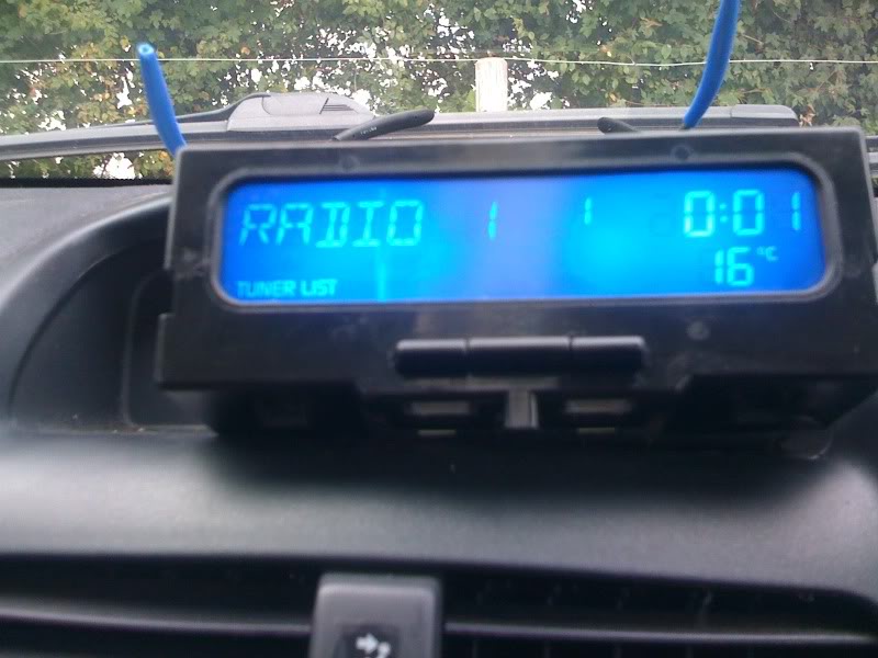

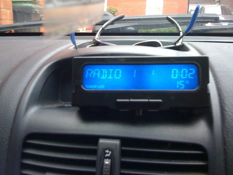

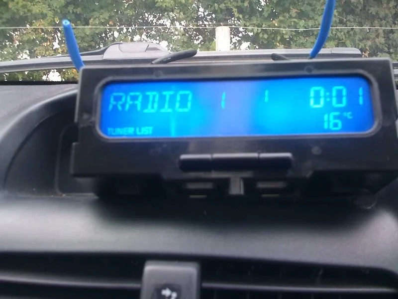

Here is the clock/clocks I did... Ignore the lines on the LH side of the bottom 2 pics..that was still the "experimental" stage :o
Done by removing the bulbs altogether and building up to small circuit boards that fitted in there place...each board had 9 leds wired in series. The best and ONLY way to make the clock section look good.

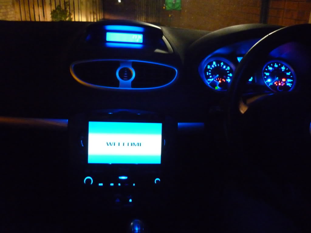

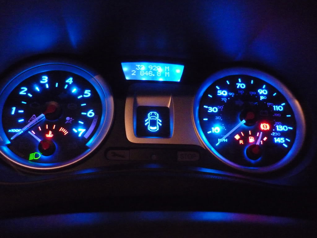

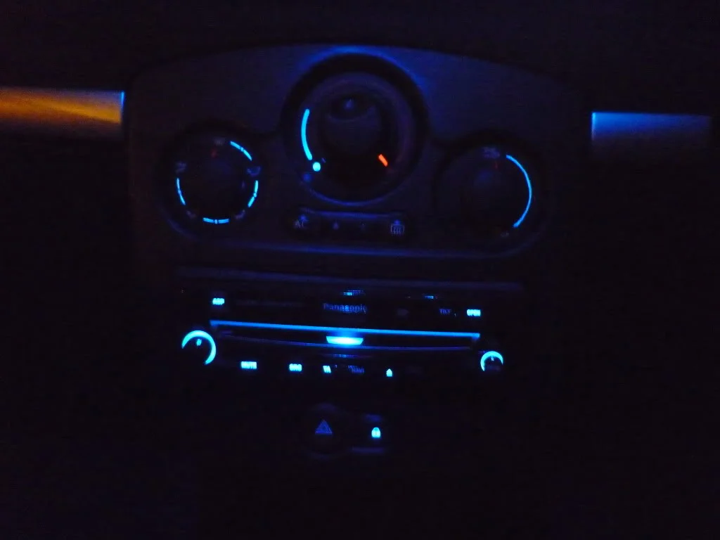

So this is what ive done so far and im pleased with it, although you can hardly see the millage and petrol gague.... haha What bulbs do i need for the heater controls? The dial type, not the digital and also for the headlight adjutment, tried using just one of the wee leds that was supplied for the instrument panel but it just got fried when i turned the lights on so i need a different LED! If you guys could like me to what i need that would be amazing!
You need a thicker filter behind the Mile-ometer I reckon.
You either put the LED in the wrong way round..or didn't put a resistor inline.
LED's have a certain voltage rating...if you whip the headlight bit out and "try" and take a pic of what you did Il help further.
Il crack it out tomorrow and get a pic up tomorrow night probs about 7/8ish when i get home from work. And with the Climate control what bulbs is it? just so i can order some new ones :) Thanks for your help Richy :)

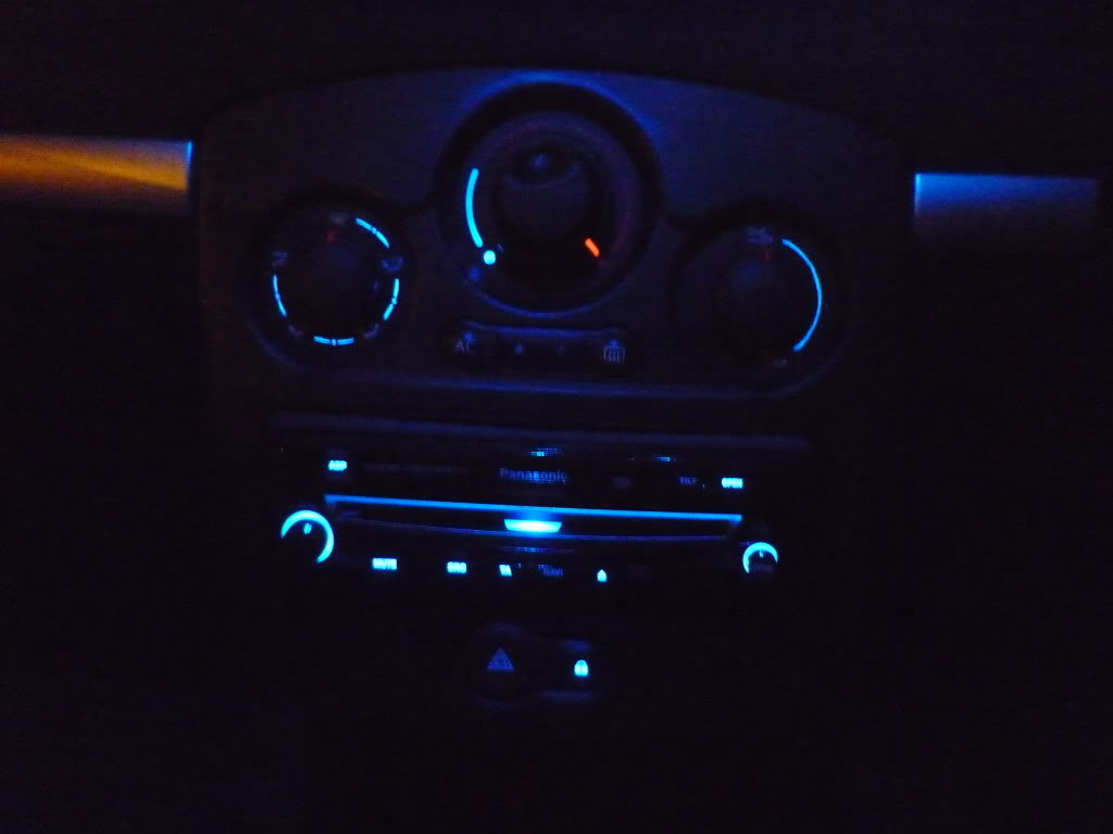

Ok got my new bulbs from crazy LED's today, put the new bulbs in the climate control which was a right battle but they didnt shine through at all. i could see from the back of the uni that the lights were on however nothing could be seen from the front! Help? lol
they should shine through ok? have you tried at night? they aint V bright but you should be able to see it.
i think i might have removed an orange piece of plastic from inside but cant really remember now
I did mine, its quite dull but the screen covers most of it
Also did the dials and they were a ball ache!
