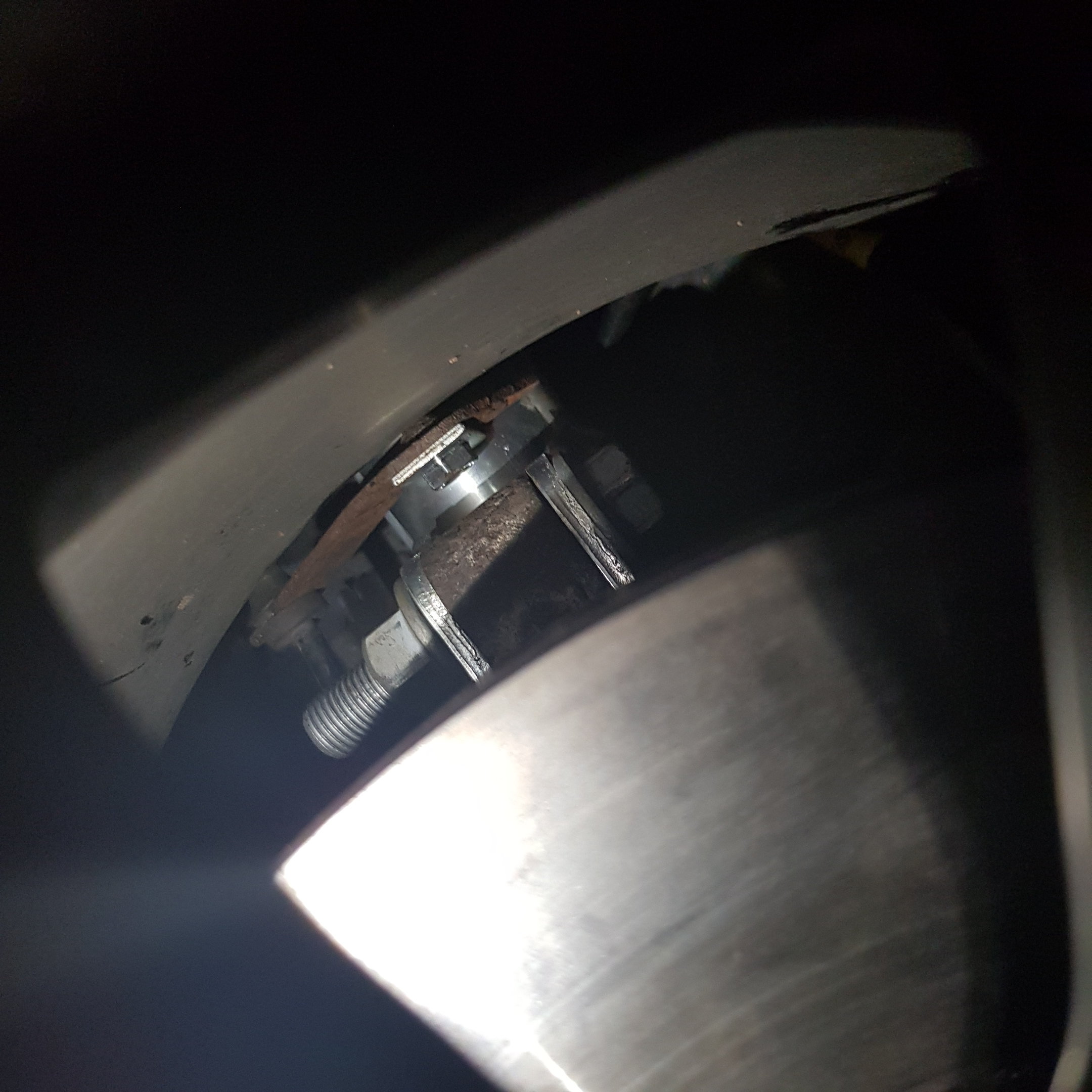

Hi guys I've fitted for the most part my blistein B14 coilovers and when I put my 2118 alloys on they come close to the coilovers, has anybody else had this combination? Did you have to use 5mm spacers?
Also the bracket for the abs wire catches the alloy any body else have this problem?
Pic below of the bracket

I have run 15" 2118's with Bilstein B14's no problems. What offset are the wheels? The bracket for the abs sensor just needs bending as stated above.
Yeah I'll bend the bracket so hopefully that will sort it
As for the ET of the 2118 I'm not sure but think there is only one offset for the 172 and 182 fitments
