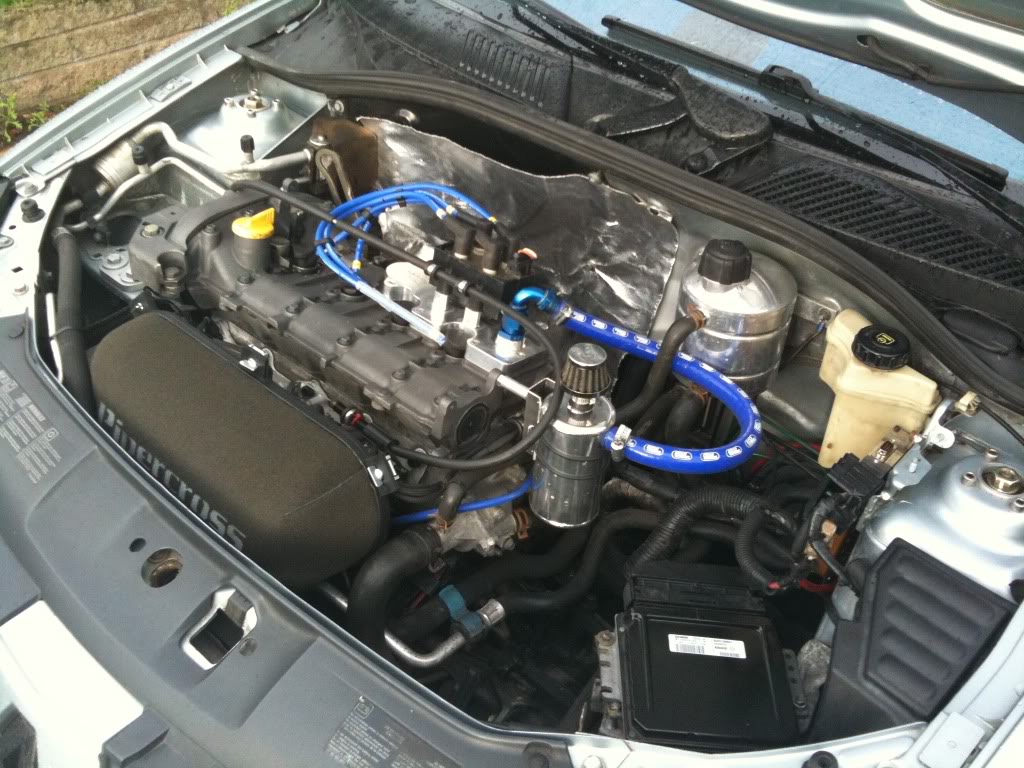

Sausage filter was fitted yesterday morning :) Love it, seems to pull a little better aswell, perfect fit if i do say so myself.

help me, I'm retarded. So what exactly does that shiny plate and tank do with the new leads? looks pretty fancy

The shiny plate is a replacement for the standard breather on top of the rocker cover :)

looking really good there Ben. I like the breather set up and the painted cover.
In reply to Jamie - the throttles are an oval shape, not round like others. This makes it hard to say what size it is, but area wise it is the same as a round 42mm throttle. Of course being "shaftless" and less restrictive they flow like a 45mm throttle. The other kits people offer are usually a 45mm throttle that is tapered from 42mm one end to 48mm the other.

Thanks :)

where and how much did that set you back if you dont mind me asking :)
Re: Project 172 *** ITB'S - 204bhp *** Sausage filter fitted Page 15
I paid £50 for it, but its from angelworks, so its probbaly worth about £150, its at least £100 in material alone at a guess.

I take it you've removed the plastic block behind the left side of the grille? So the top grille is open on both sides. (as standard left side is blocked)
