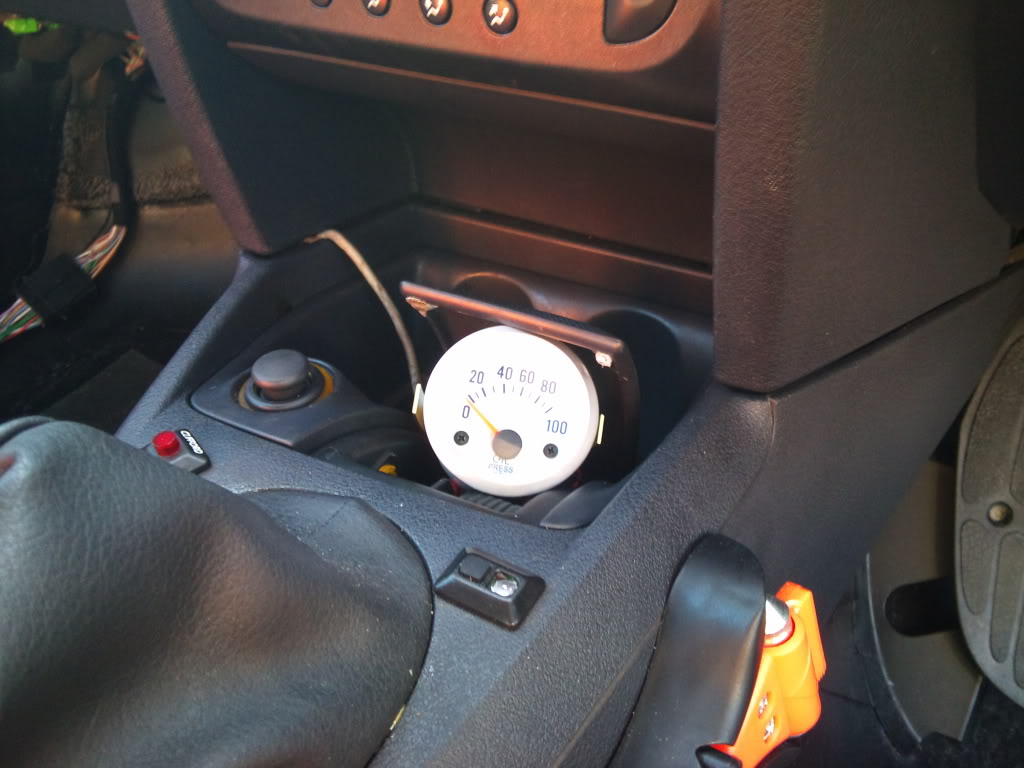

Oil change done today. Couldnt fit my oil temp gauge as the m14x1.5 sump plug adapter was to small, so it must be m16 for that.
Im to sure on fitting it though, as im worried about it hanging down and catching it?
Oil pressure gague temp location-
Still not decided where to mount them once both installed either...

Anyone know if you need to have the original oil pressure wire plugged in?
Bit of a shitter about the sump plug mate...
Did you find out the size in the end ?
