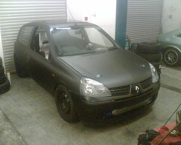

Final engine running plans now going thorugh!
Juts getting the loom built in next couple of days from Omex when I finally pay them lol! O and somehow fitting the exhuast?!
But it looks liek you fitted a standard one no problem wayne?
Unfortunately not got anymore pics, but hopefully should tomorrow night
  182, SQ7, Trafic
Well, I have no more pics!
BUT I am making the manifold tomorrow night, mine needs to be lengthened to fit under the PAS rack! :(
Omex also came through at the weekend which is now half plugged in!
Still waiting for plumbing to be done then hoepfully should be a good job!

Manifold got started tonight!
Completely changing it now using 2" pipe instead of standard which is a tad bigger than 1 3/4".
4 bend's to 2 Y pieces, then hopefully 2 pipes under car until first box!
