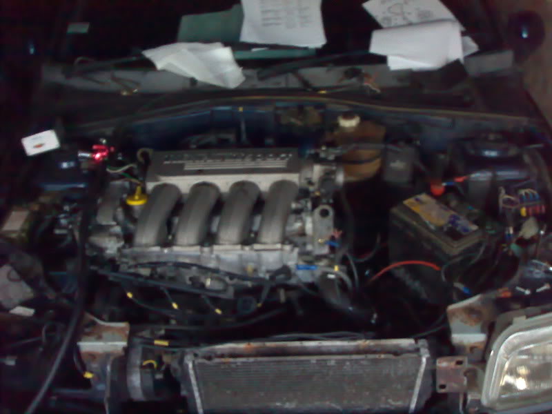

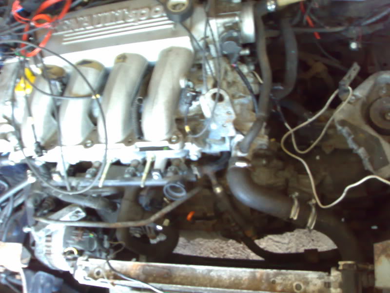

Just a few updated pics for you all to see
