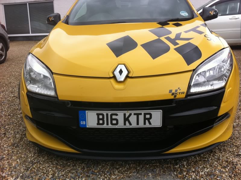

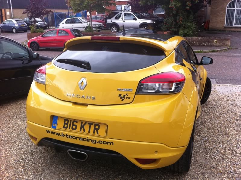

Some tasty demo cars, they have slightly more torque than mine :dapprove:

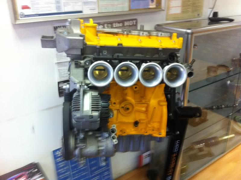

Tasty ITB'S one day, one day :approve:

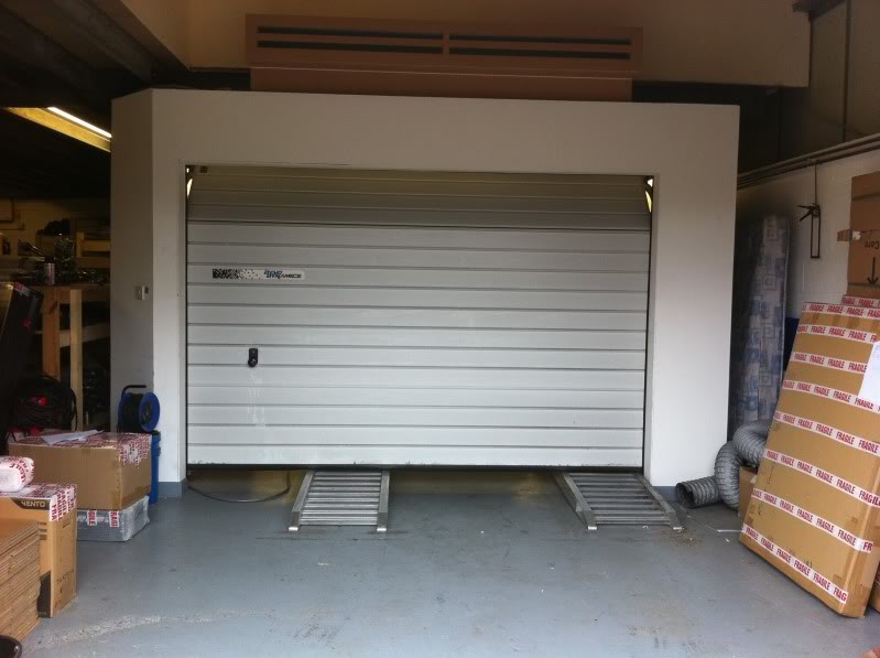

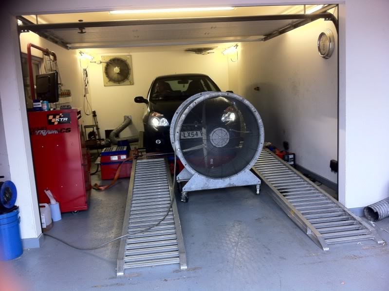

After signing the reliant paperwork it was straight to business with getting the car rolling roaded before the cams got fitted.

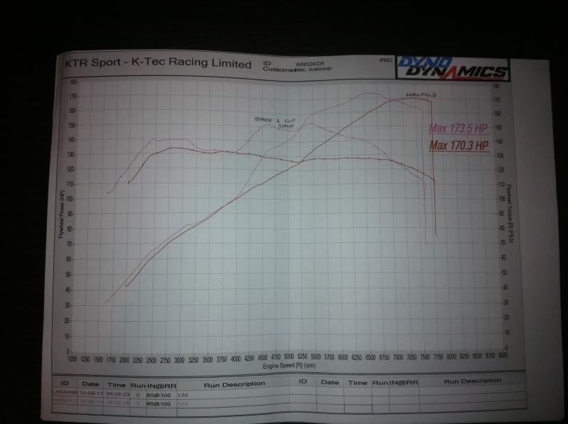

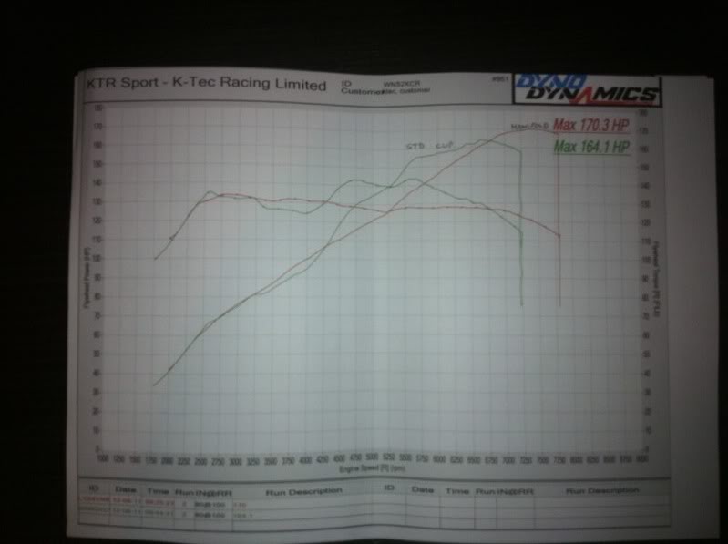

Rolling road

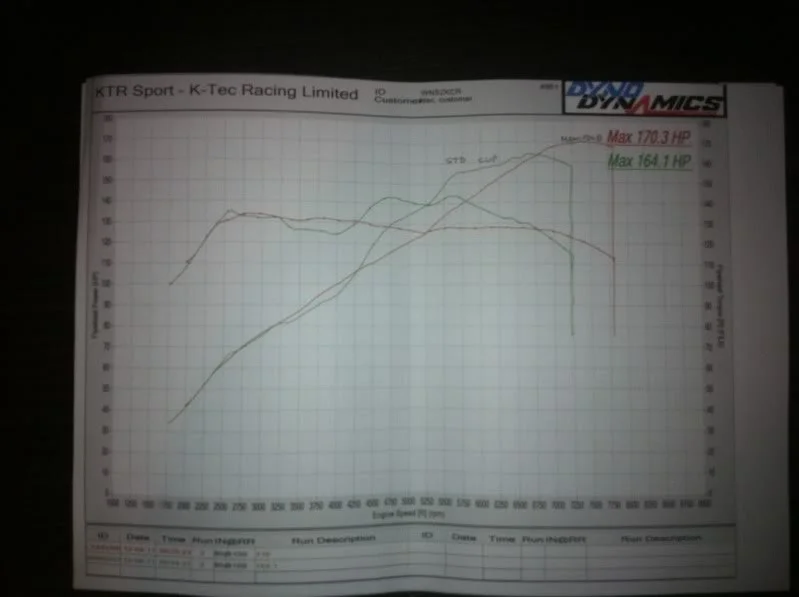

Standard Clio 172 Cup except for stainless exhaust + decat vs RS2 Manifold
Same Standard Clio 172 Cup with K-Tec stage 2 remap vs JMS RS2 Manifold
The rollers will read low but it was a good comparison with the cup which was tested before mine, you can see the loss of torque in the midrange and something had to be done about that.

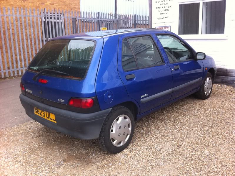

Here's the 1.2 8v beast without power steering.
And survived the trip back

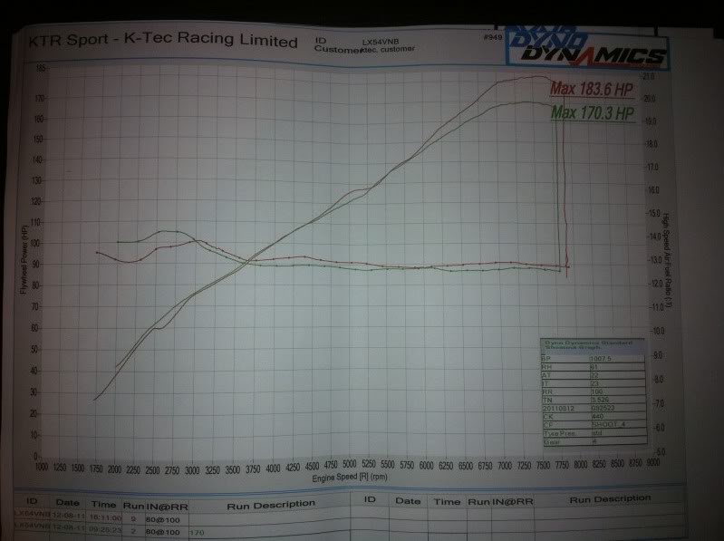

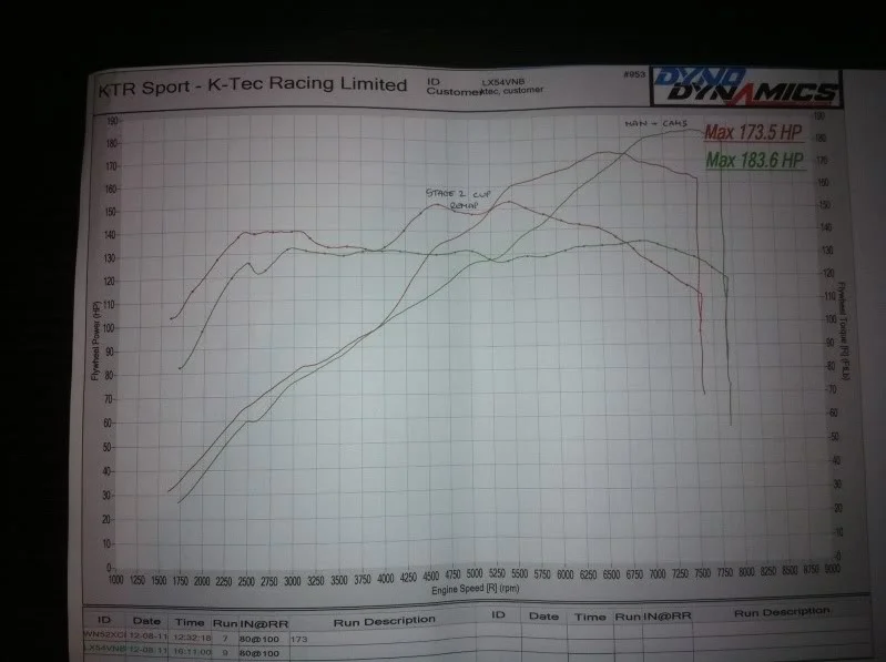

Cams all fitted and on the rollers for live mapping.

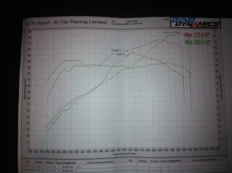

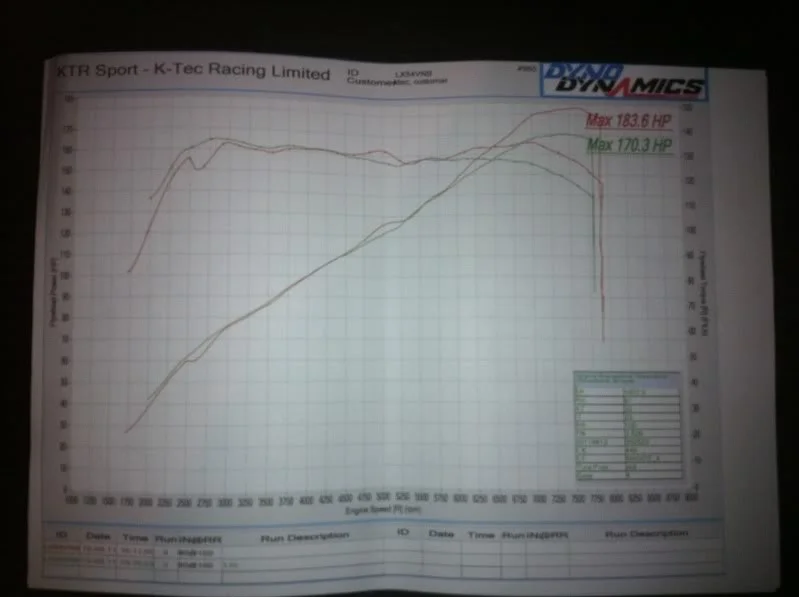

Standard Clio 172 Cup with K-Tec stage 2 remap vs JMS RS2 Manifold with Cat Cam 438
Before and after results
So with a gain of 13.6bhp and an increse of torque along the rev range i was very happy, after racking up 200 miles this weekend i can honestly say its like driving a new car. the power delivery is more purposeful and pulls like a train with the cams. But if i revert back to the standard manifold the car will be a different animal and is something im contemplainting in the near future.
I would like to thank all of the guys at K-Tec for looking after me and discussing the pros and cons between the rs2 manifold and the standard manifold setup, i throughly enjoyed the trip and it was well worth it.
  172/1.2/E30
So your 182 is doing about 183 bhp with cams and inlet? Do you have any pre-modding power figures as i´d say these figures are too low.
as i said the rolling road results at k-tec usually read lower, i will take the car back to hayes engineering where i have got the car rolling roaded at every modification. i assume the readings will be higher say 193 bhp ish
Good gains mate. Would be interesting to see what figures the cams make with a standard manifold.
RS2 seems to loose alot of torque unless I'm interpreting your rear-outs wrong on the iPhone lol
  FULL FAT 182
indeed Matthew, that's all because of the short runner length. the good thing is i can revert back to the standard manifold if needed and then the torque will be regained. Ill wait and see.

Geat write up mate. Glad you put the graphs up too. Gives a good idea of your car in comparison to a near standard one.

I actually feel a bit sorry for you after reading all this, JMS should be embaressed to sell that! especially with a £1.5k + price tag. I got throughly ripped for stating exactly what your graphs above show (in another thread).
The best possible thing you can do is revert back to standard manifold and sell the RS2 on and forget it ever happened tbh! 135ft lbs on a "performance" manifold with cams. That should be making 165ft lb's all day long... Do the right thing sell and buy ITB's, mine made 175ft lb's at Ktec ;)

I'm pleased for the OP, the cams have made really good gains. However I have to, atleast in parts, agree with Laine.
To my untrained eye, it's the cams which have given the gains, not the manifold....
I'd be asking JMS the reason the manifold hasn't made anywhere near the claimed figures.

Lovely car dude, but am I reading that right that you had the RS2 on and made 170bhp/135lb ft, then had these new cams fitted which took it to 183bhp/135lb ft?
  53 Clio's & counting
Thats what i looks like Gray - I was hoping I wasn't the only one seeing that lol.I know DD rollers tend to read fairly accurate, but thats lowwww
  172 cup RS2 - 330ci
