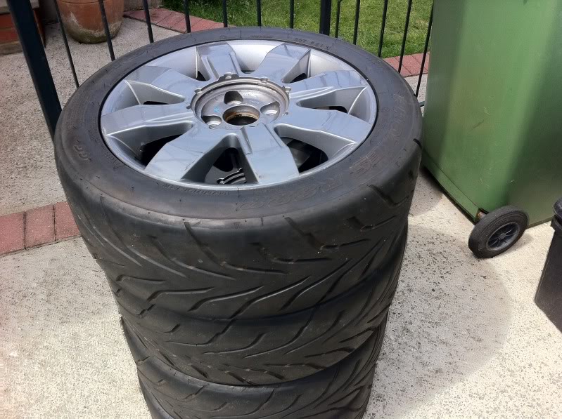

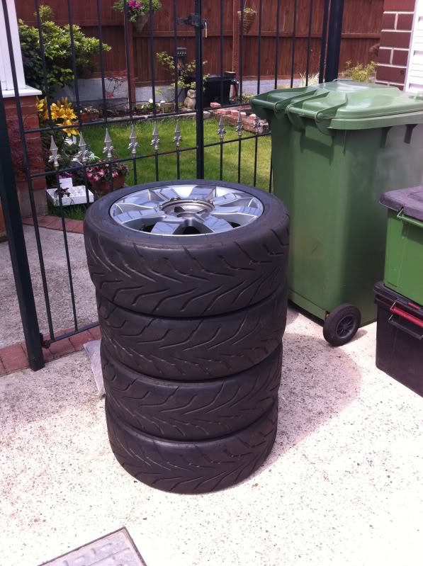

Managed to pick up some Toyo R888 tyres from the forum and got them fitted on my old 182 cup wheels, here are a couple of photos.
I will be looking at booking the renault sport track day at brands hatch as its been over 5 years since i last had a go.

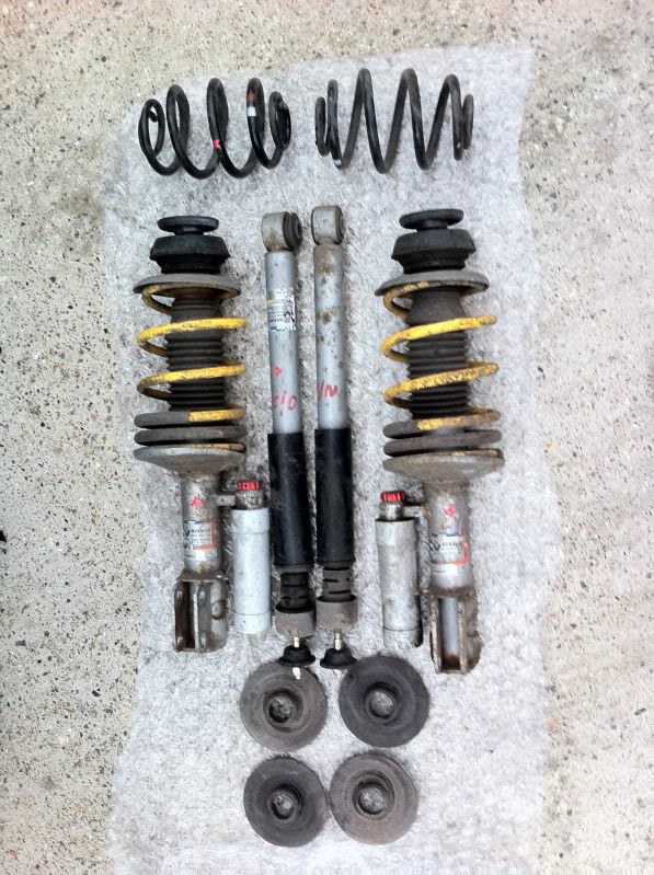

Its been a while since I last posted but I have been busy sourcing choice mods, i have been lucky to cherry pick some parts from a salvage trophy at some great prices.

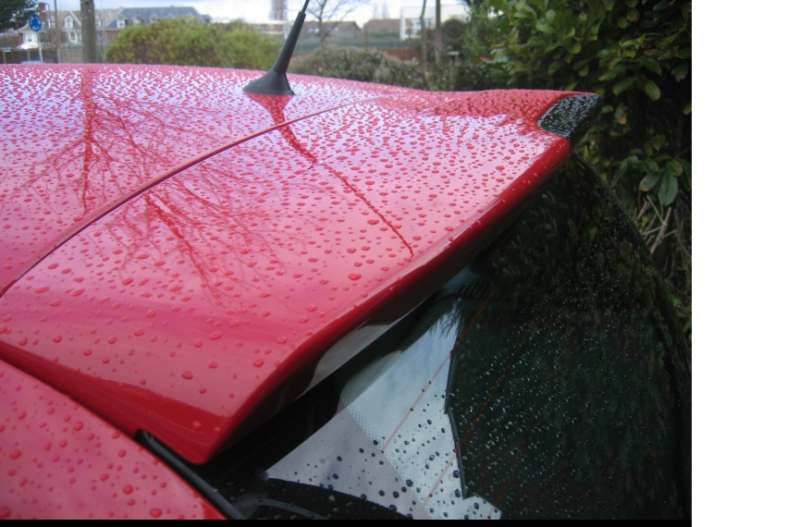

Trophy Spoiler including struts, obviously getting sprayed black gold @ spray shack.Always been a fan.
Sachs suspension, just needs cleaning.

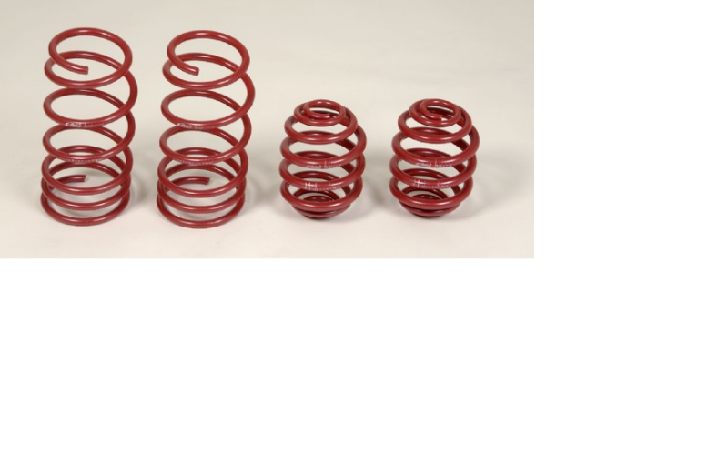

Sportlines

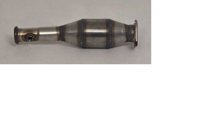

K-tec 182 Sports cat, already fitted (can now hear radio)

Spoiler fitted once Simon has finished painting it.

Any reason you went for sachs over some decent coilovers?
For more than one occasion i have been down the coilover route and had nothing but a harsh ride, either putting my back out over speed bumps or loosing fillings over cattle grids. Coilovers are great on the track but on the road they can be a nightmare. I honestly believe the trophy set up is a brilliant compromise with the sportlines for both road and track. And the price i paid for them you would struggle getting a decent set of coilovers.

Nice car, very similar to mine, which is also blackgold with anthracite turinis (trophy ones ;) ) with trophy spoiler, trophy suspension + eibach sportlines and also has a scorpion exhaust.
I would have saved the money you spent on a sports cat though and got the standard cat modified with a 2.5 inch exit (like mine)
Hi Jack,
how lower does the car sit from when you had the standard cup suspension compared to now?
im contemplaiting getting the sportlines this week, would you suggest this modification?
i found a trophy being broken on the internet and had to pounce ant the oppertunity to cherry pick the bests bits, it will look similar to yours but with a better offset to the wheels ;).
