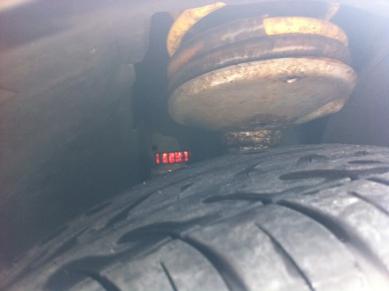

Managed to get the trophy suspension fitted yesterday, all I can say that it's by far the best modification I have made.
The ride is slightly stiffer but reacts well to covering and handles speed bumps very well.the ride height is slightly higher almost the same as the non cup Packed 182.
I'm just awaiting my spoiler to arrive from spray shack (Monday) then it's trophy spec'd

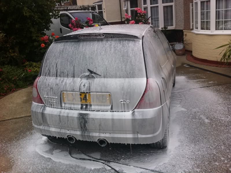

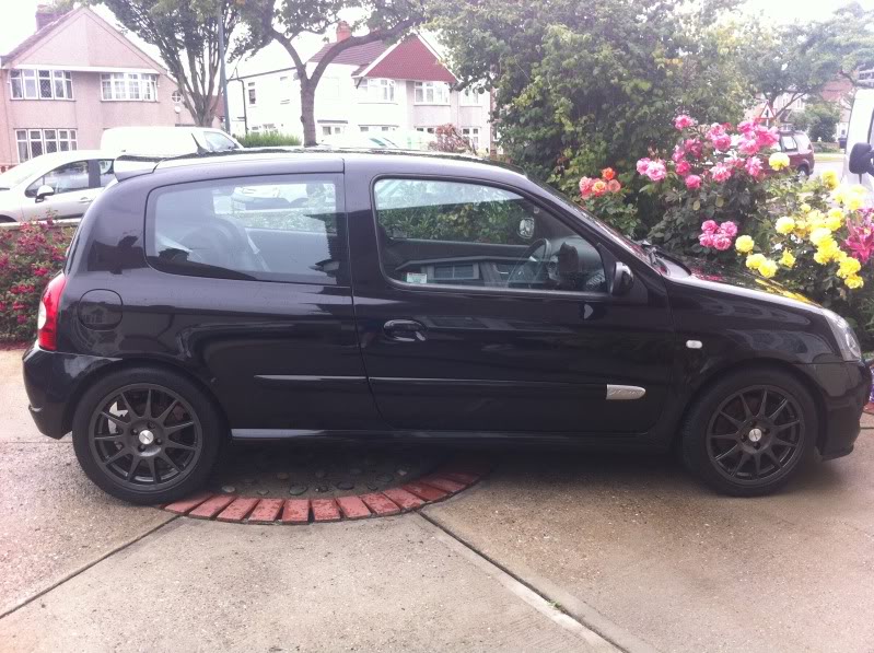

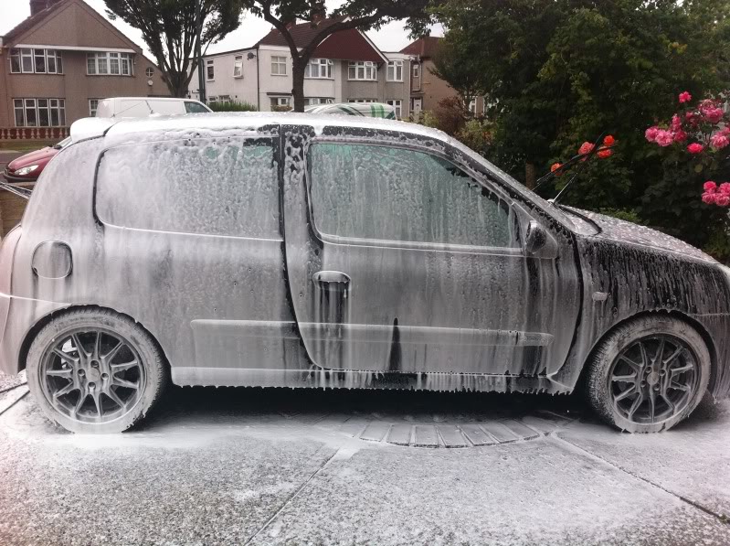

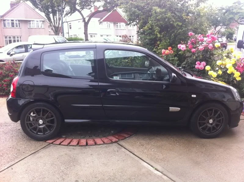

I had some free time this morning so i gave the car a once over as i haven't cleaned it for over 2 months, the snow foam is a laugh too.
And a couple with the trophy suspension
Before
After
  FULL FAT 182
BTW the boot has the original cup suspension and a sub for the tuneage. the back should lift ever so slightly.
The suspension mod has been far the best thing ive done to the car bar the brake set-up.
