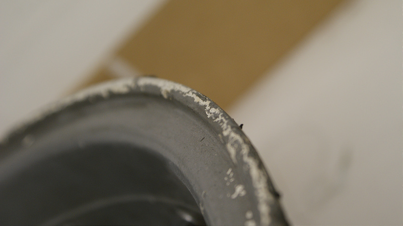

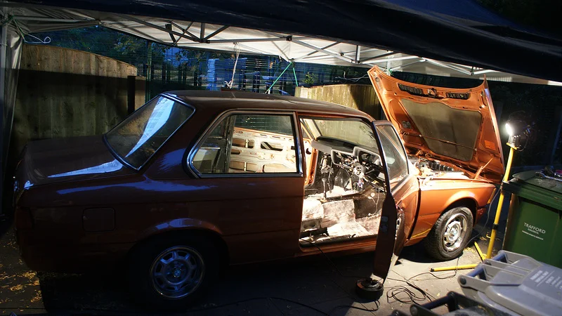

Got started on the wheels today.
This will probably a fairly long job :(

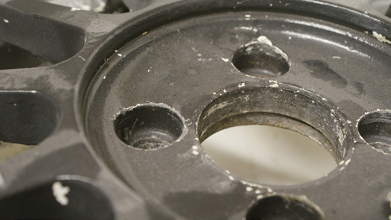

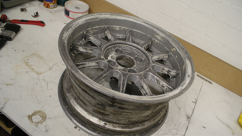

This is how they started:

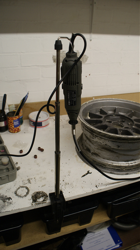

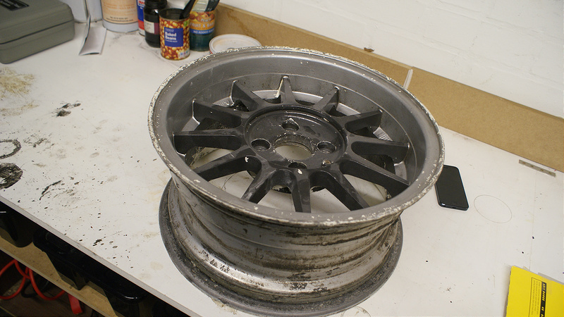

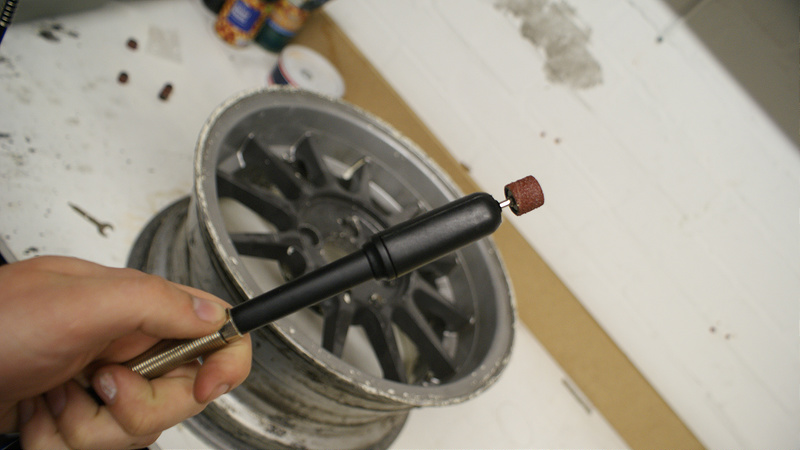

Then, with the help of this:

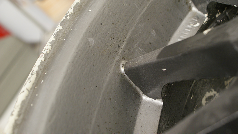

I did this:
Need to find somewhere that sells a decent primer and then get some paint on them. Judging by my 182 wheels on the RB, these should look good :)

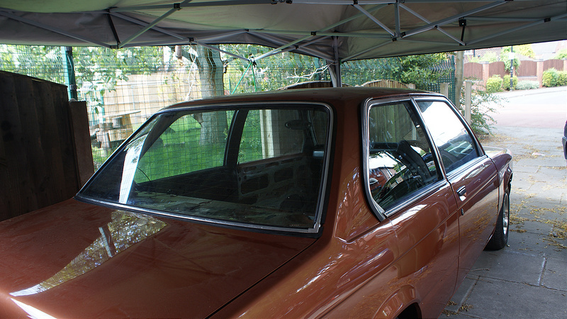

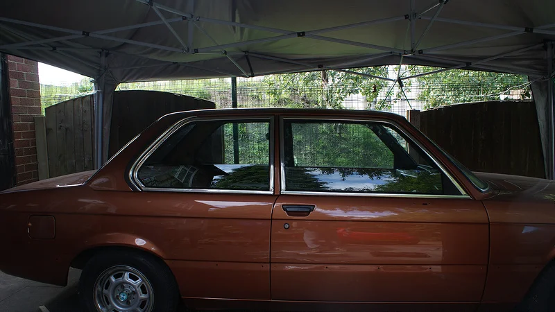

Chrome trim fitted today, had a bit of a nightmare with the trim on the side glass, but we got there.

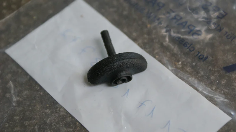

Also, new rubber stop for the petrol cap:

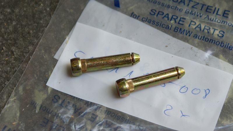

New pins for the door check arms:

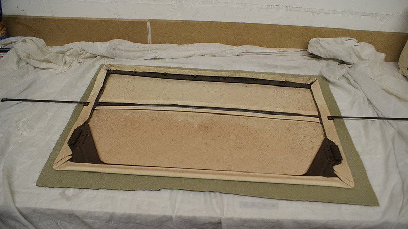

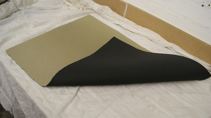

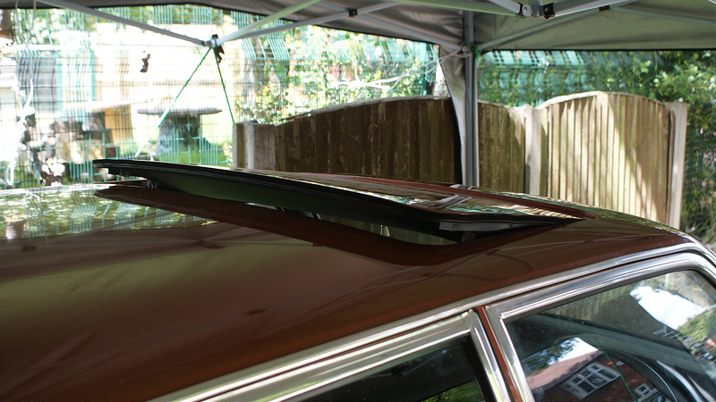

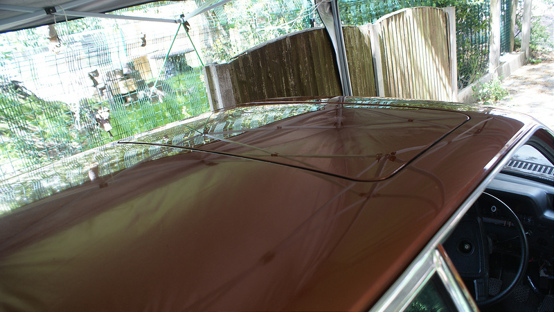

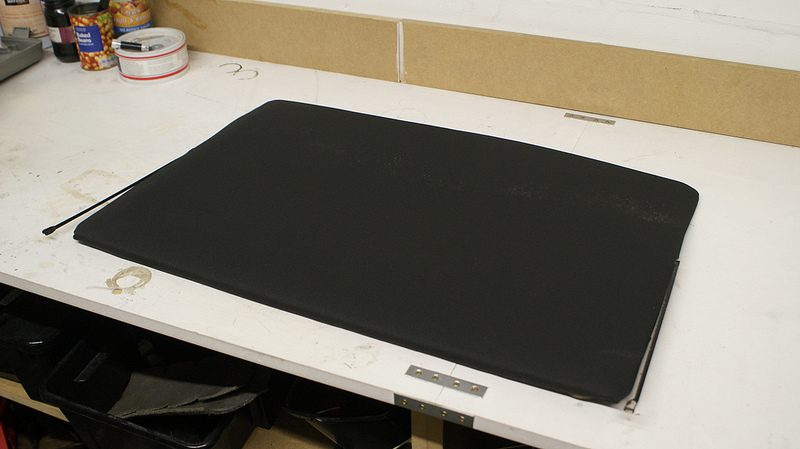

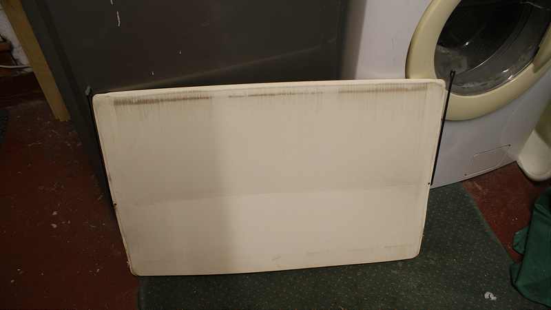

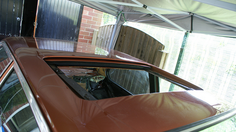

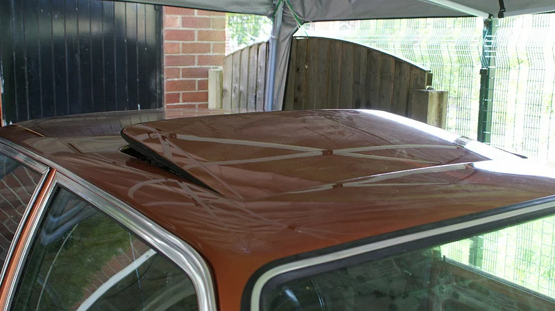

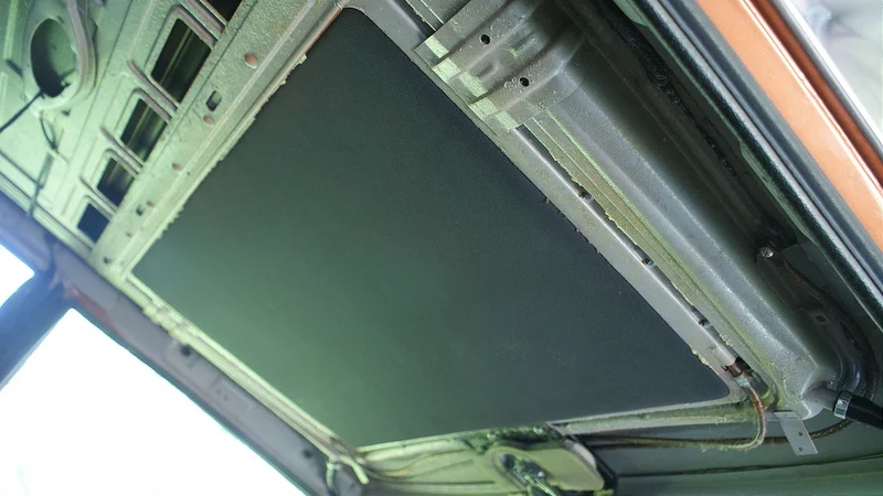

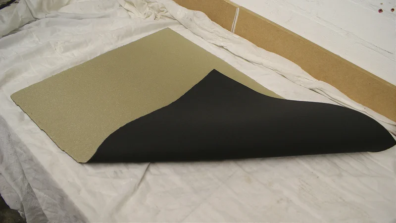

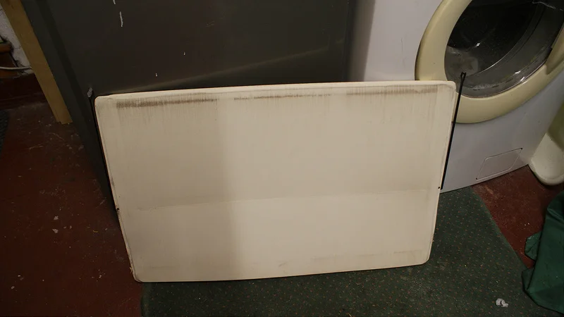

Did the sunroof today, sounds an easy job, but I wasn't the one who removed it, and it was pretty tricky to get it fitted. Two minds make light work of it though and Jon.G was round to help out :)
Needed to recover the underside of the sunroof before fitting it.
New headlining:
After some head scratching a bit of fiddling, we got there:

I jest :) Yeah I know it would be easier, but tbh, the dremmel and flapwheels make it a pretty quick job. I'm not entirely sure I want to keep them, so a quick and simple refurb is all I'm after.
I also quite like the idea of doing as much as I can, myself.

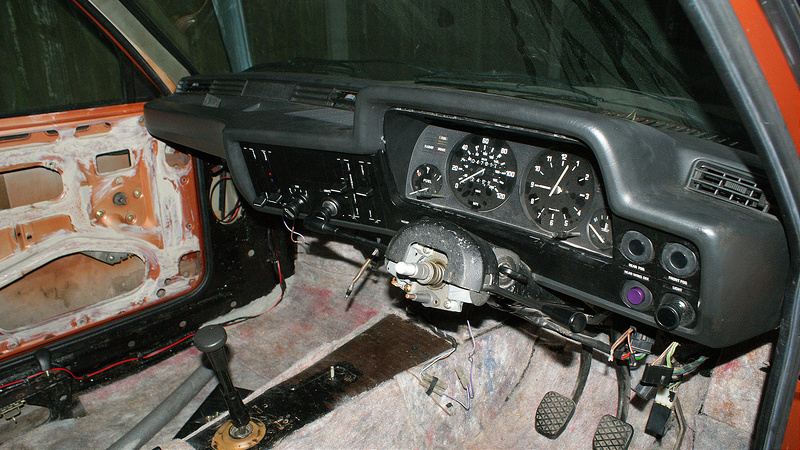

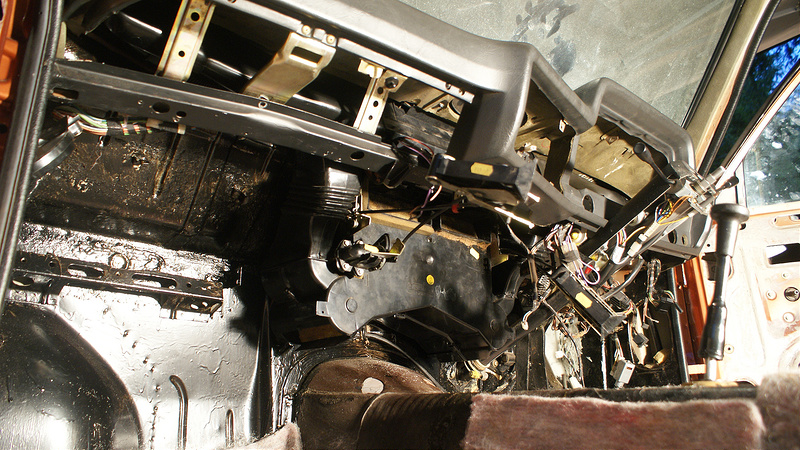

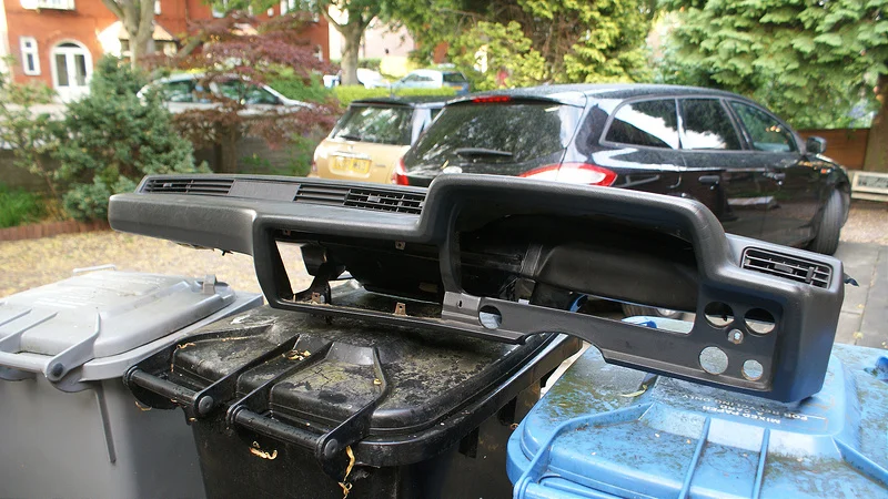

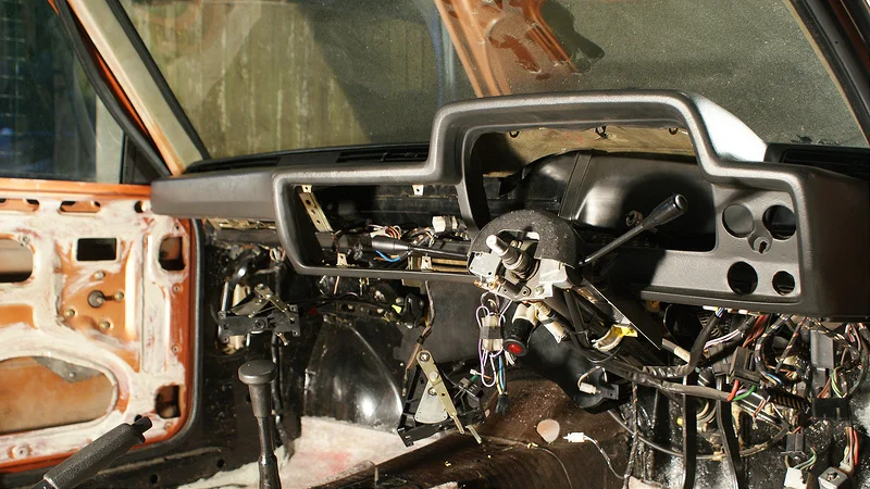

Did the dash and heater system tonight.
Dash with vents all fitted:
Heater matrix fitted (car is crying for a clean!):
Dash & heater matrix fitted:

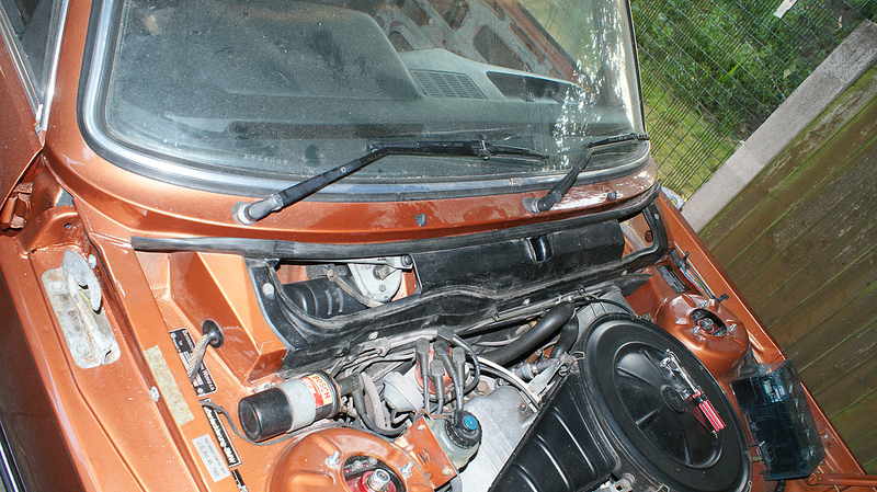

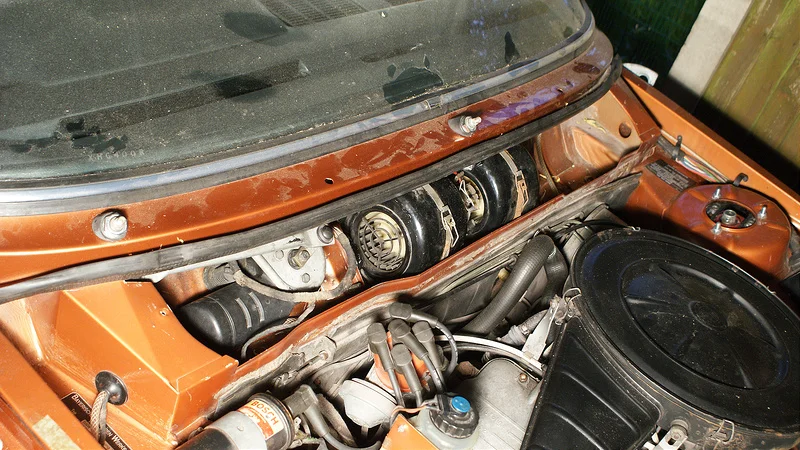

Manky wiper arms painted black and fitted to the car, along with the scuttle panel and washer jets:

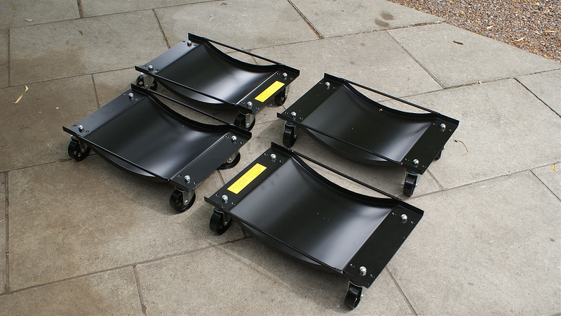

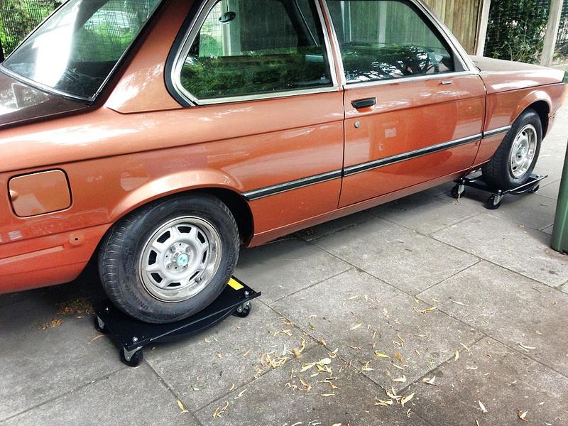

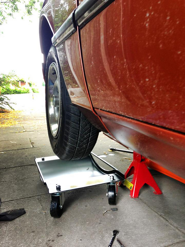

Also purchased some vehicle dollies. They're really good quality from the looks of it, and make moving the car a lot easier, although the movement is a little hard to master!

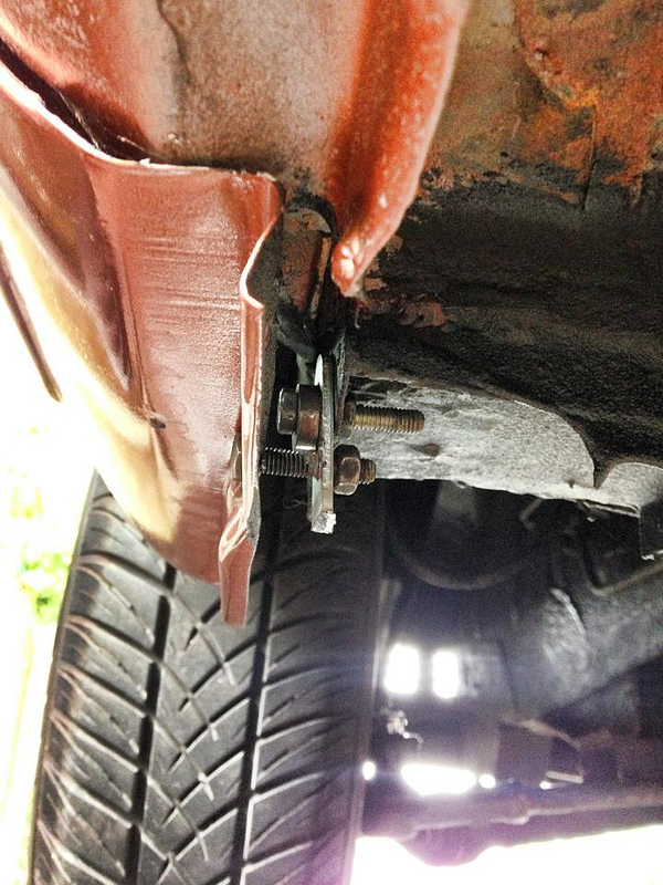

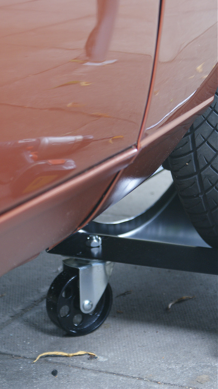

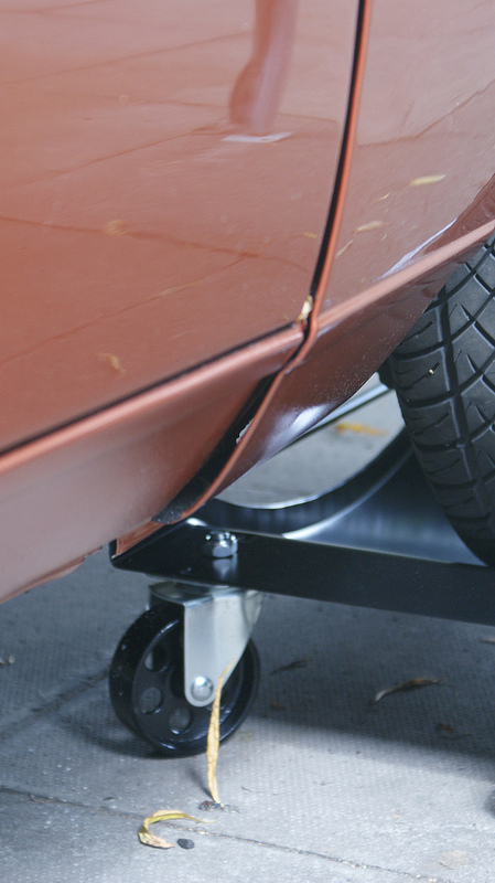

I've also sorted most of the poor fitment of the wing too. It was sticking out a long way at the base, I'm attributing this to the fact the wings are non OEM.
Anyway, I drilled a 6mm hole in the wing, and the side of the jacking point, then put a bolt through it and a nut on the back, and voila, it worked perfectly.
The bolt is tucked away under the sill too, so you can barely see it.
The passengar side was a little trickier, the wing was sitting lower down and wouldn't bolt straight into the jacking point.
This may look quite rig up, but it's done as neatly as possible.
I made a bracket, and drilled it so it could be bolted to the jacking point, I then drilled it again lower down to allow the wing to bolt up to it.
Worked a treat :)

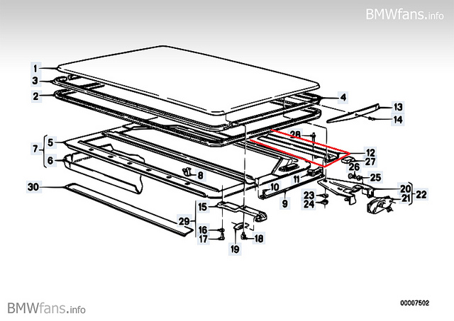

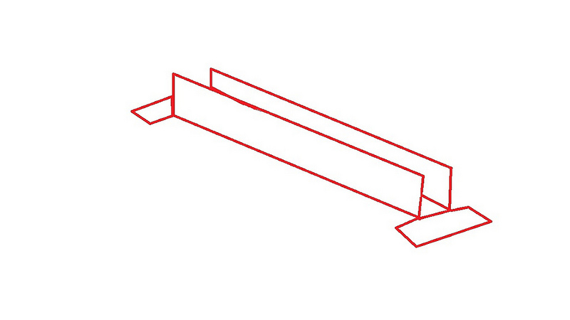

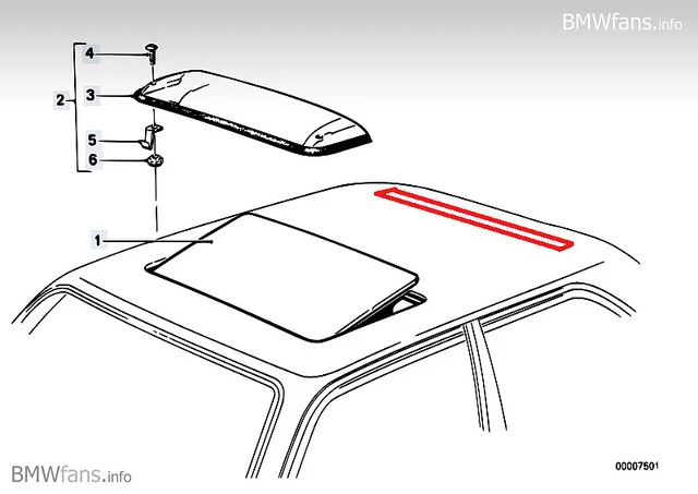

In the meantime, I have made some good progress, no photos at the moment, but I did sort the leaking sunroof out, was a very simple fix in the end:

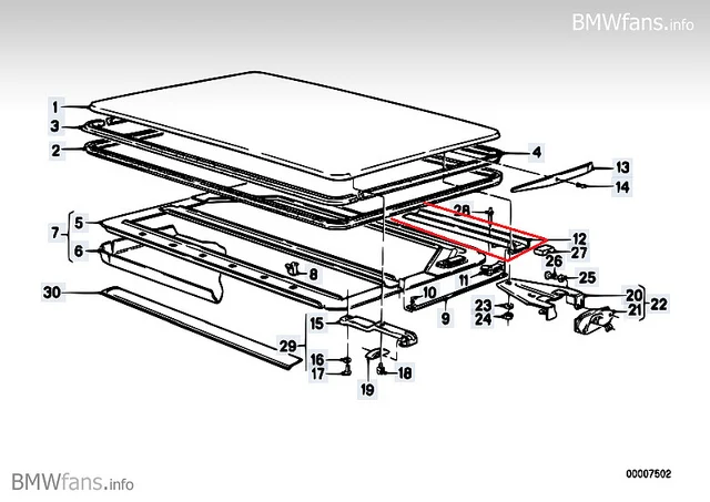

The sunroof seal is only really a weather seal and is designed to allow water in, once in the car, it should be caught by the drains and then it can run out onto the floor.

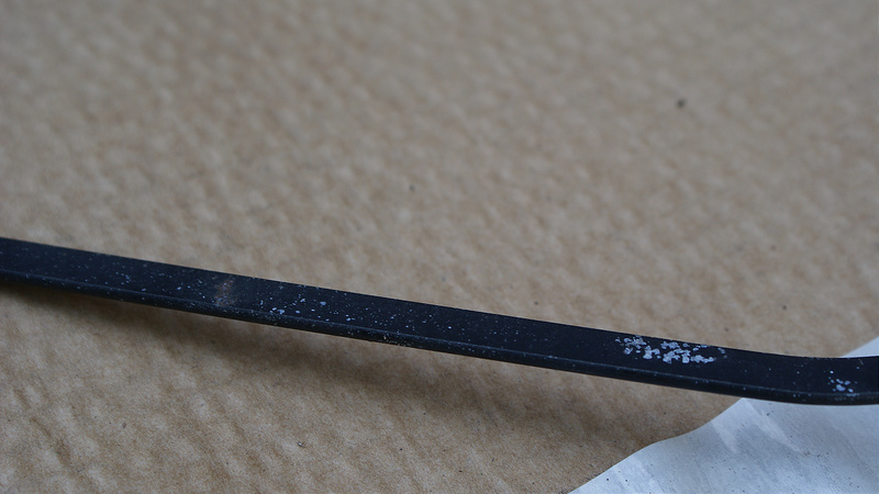

At the rear of the sunroof, there is a drip tray, which slides with the sunroof itself, number 12 on this drawing:
That piece looks like this:
When we were taking the sunroof out, all those months ago, the drip tray was removed and somehow got slid back into the roof void where the sunroof goes, like this:
My mates spotted it last night while we were trying to figure out where the tray was.
Some wire and a little fiddling later, we had it out and lined up, and the sunroof doesn't leak water in any more, happy days!
