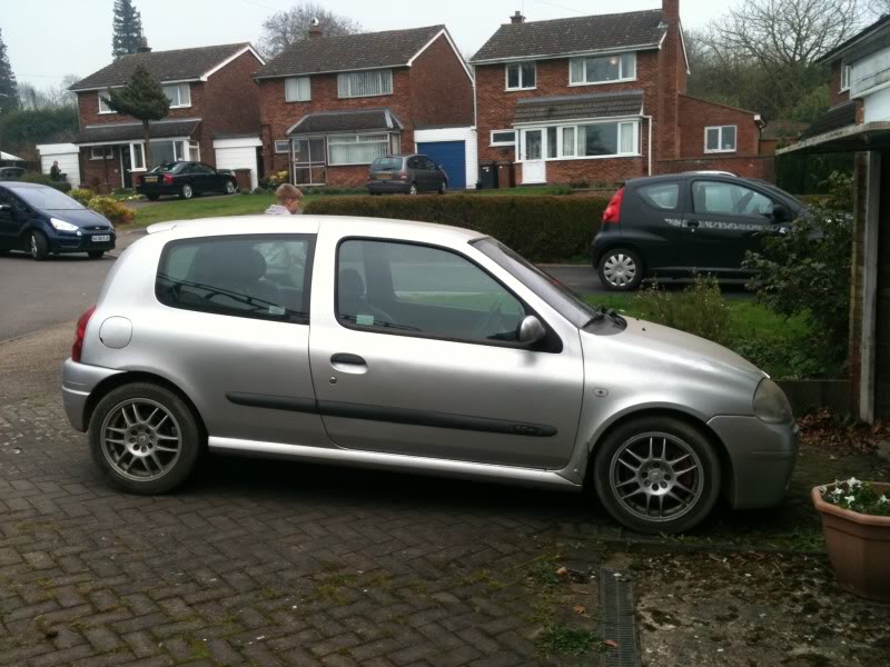

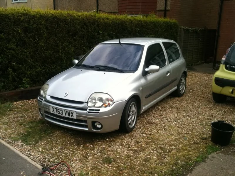

Long story short I've just recently brought a tatty round the edges ph1 172 that's been sat in a garage for about 2 years! It needs some work but I've payed very little for the car so can't complain!
Original plan was to either fix it up to sell on for a profit or use it as a cheap run about!
How it looked after a good clean!!
Well the plan has changed now as I'm sick to deaf of having to take out a mortgage to run my current daily motor! Audi S4 2.7 bi turbo running about 350bhp!
So because of that project cheap like the budgie was born!
First things first I need to get it road worthy which means buying and fitting the following!

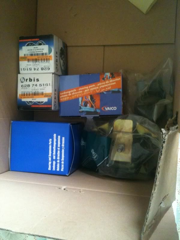

Engine mounts, brakes, and ball joints have been brought already and I'm going to collect a full 2nd hand 172 cup suspension kit up tomorrow night! Not sure if the springs and dampers are any different but it's a cheap way of sorting the broken spring out for now!

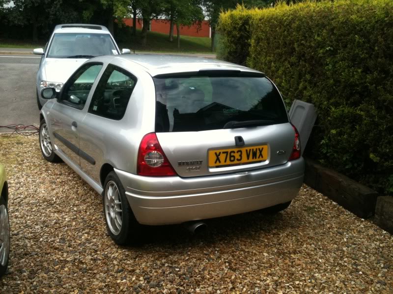

I think Rob must have seen it for sale on either edition38 or audisrs cus I had it up for sale on those sites when I was struggling to store it somewhere after a mate decided to stop paying the rent on a lock up we both used and didnt bother telling me!
It was up for £550 then and I would have made money on it! Someone paid me a deposit on the car and was gonna buy but they pissed me about getting the rest of the money! The next person tuned and tried to offer me £350 at this point I then found somewhere else to store it plus I was £100 up on it as I kept the deposit the first person paid me! ;-)
So I thought I might as well keep it and use it!

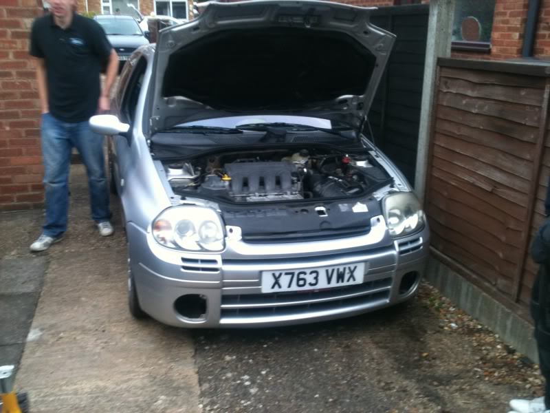

Well started doing some work on the car today!

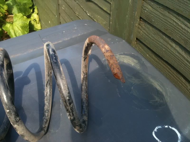

Went and picked up the 172 cup suspension that I won on eBay for £14! I knew a rear damper was leaking bit other than that they were all ok and a bargain way of sorting my cracked front spring!

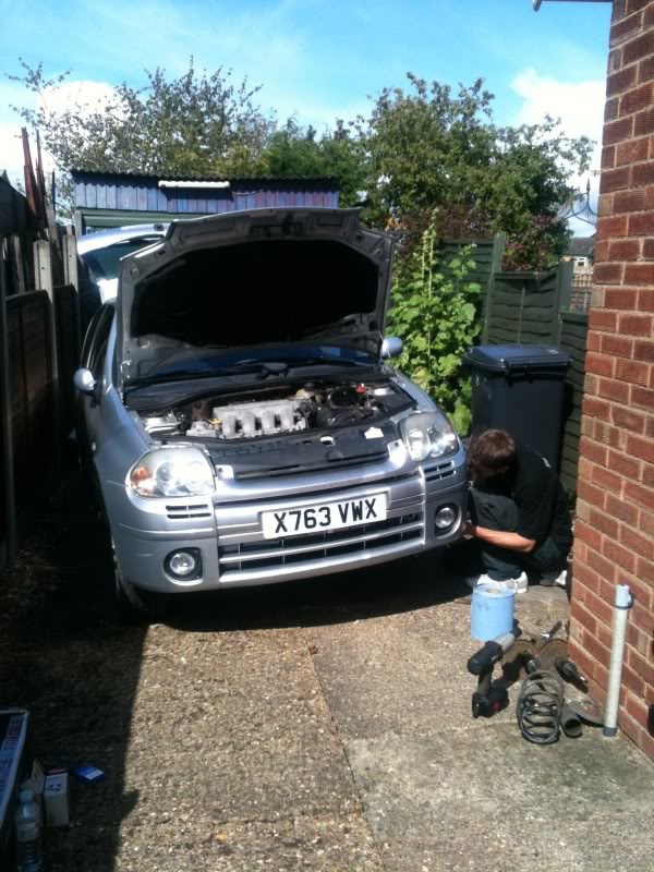

Got home, got the car jacked up and started stripping the old bits off!

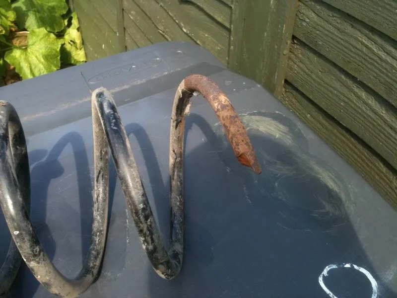

Once we stripped the car down we realised the drivers side spring had snapped aswell but unfortunatly under closer inspection the replacement dampers had seen better days but luckily my originals were mint! So built them up using the new springs!

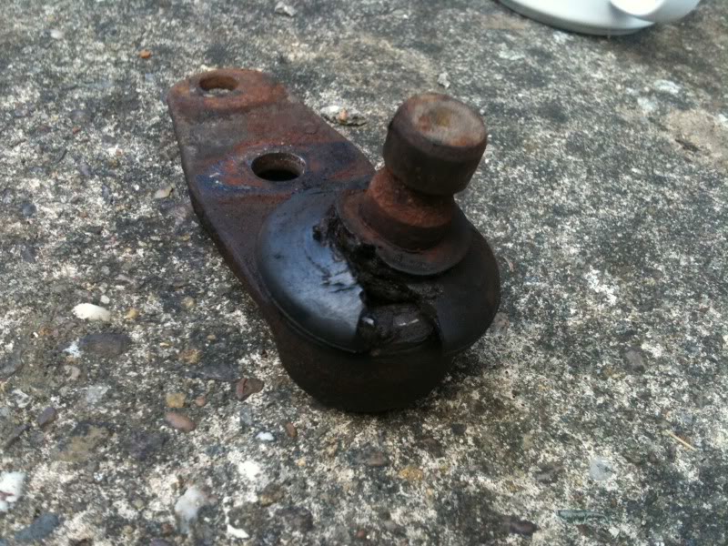

Went to also fit the new lower balljoints as the old ones were well and truly past it!
But then realised my replacements were slightly different having 2 smaller holes, so a quick trip to GSF got me one replacement as they didn't have more in stock!
What with the pissing down rain and stuff being wrong it was turning into a ball ache of a day!
Still need to sort the drivers side ball joint and the engine mounts but it's slowly coming together!

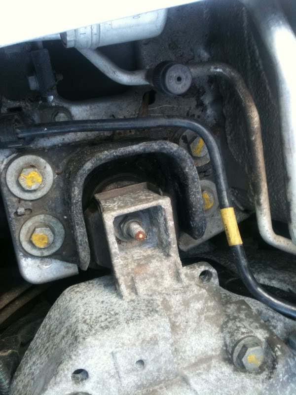

One truely knackered engine mount!
Eventually I'll be fitting coilovers and poly bushes etc... But these are to get it road worthy so I can start using it and having some fun!

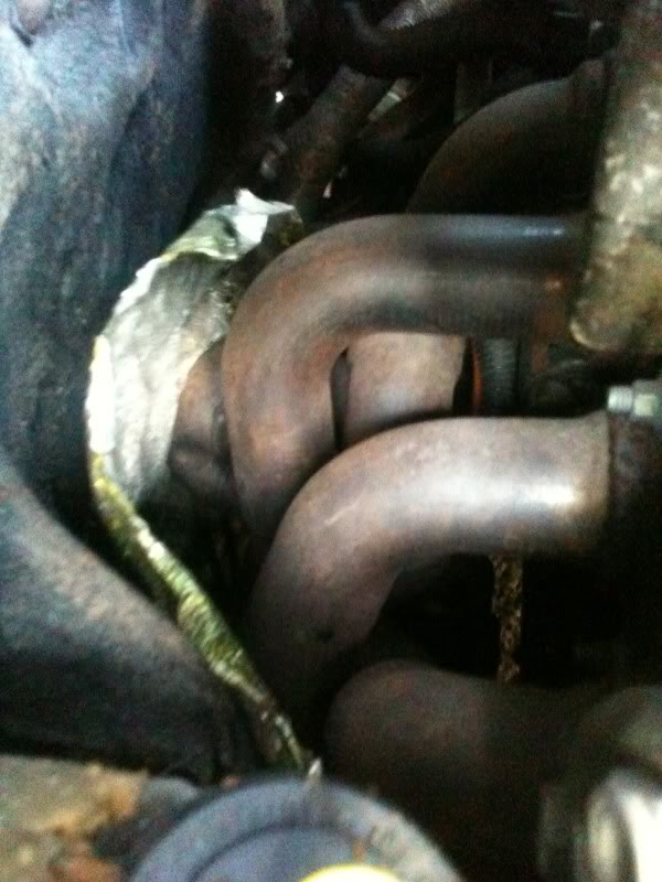

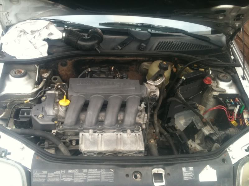

Got a query though what exhaust manifolds do 172's have as standard?
I think they've got a tubular similar to the 182's but my bro thinks cast!
This is what's fitted to mine!

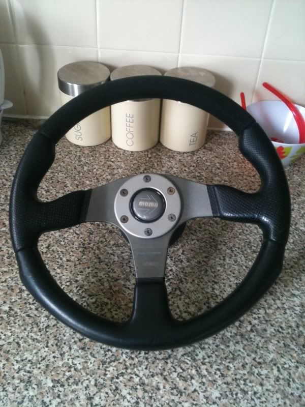

Also brought this from a mate for £10! Momo champion leather and alcantara steering wheel! been sat in his paintshop for about 6years so was caked in dust and crap bit a good clean up and it looks alright!
Just need to get a boss!

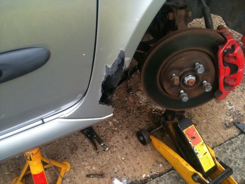

Well changed the drivers side balljoint and was jacking up on the hub to get all lined up when I heard a ping!
Well that explains the weird vibration! Lol
And I defo gonna need a new wing as I caught the cracked bit with a pry bar and it's all fallen apart!

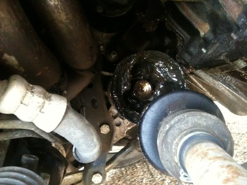

The pic above the knackered wing is of the drivers side driveshaft at the gearbox cv. Looking at the shaft and cv joint it looks like it just slots together rather than having fixed CV's on the shaft Is that right?

Well the momo steering wheel has just made me some money! Lol had a Mk2 Golf boss on it which I've just sold for £25! Lol

Need to get a offside driveshaft as my inner bout has split and when I jacked the car up it popped out!
