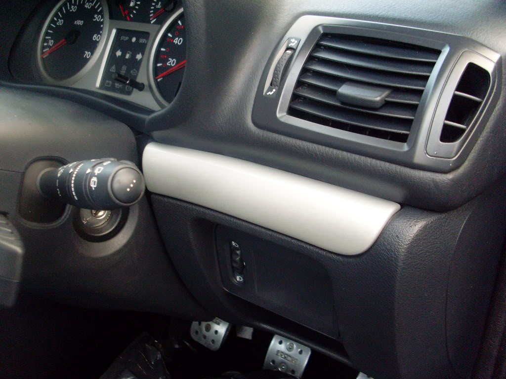

it had the orginal dash strips with the billabong sticker on it which i didnt like, i had some carbon sheet laying around so put that on, including the hazard button panel.
it looks half decent in the pictures, but in reality you could tell it was fake carbon and im not into cheap halfords look. so off came the carbon with a heat gun and sanded ready for paint.

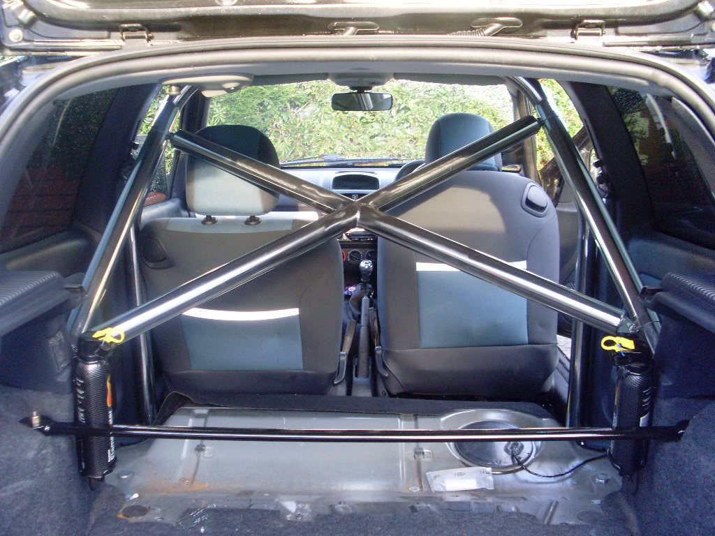

now, one thing i always fancied was a roll cage, i like the 'track' look and roughness off it. so when i saw the most famous cage on CS come up for sale, i had to have it. and yes if you dont know what im talking about, i bought russ' sold cage.
Pix
rather tight fit with the sunroof! :rasp: but we got it in after 3 hours!!!!

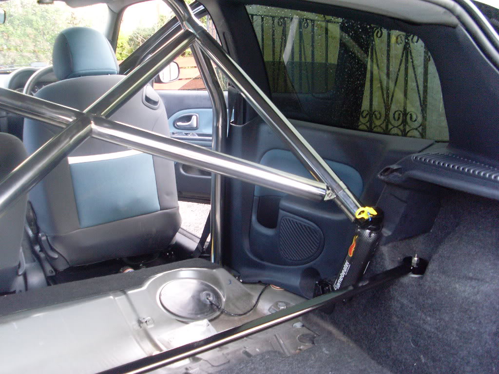

If anyones wondering, that rear strut brace is a omp one which iv stripped back and sprayed black. dont think i like it though. what you rekon?
installed some Carbon fibre fire extinguishers. wanted to put them on the bage somehow but couldnt figure how to do it without either scrathing it or drilling holes in it.
next on the to do list is decide what im doing with the rear floor?!?

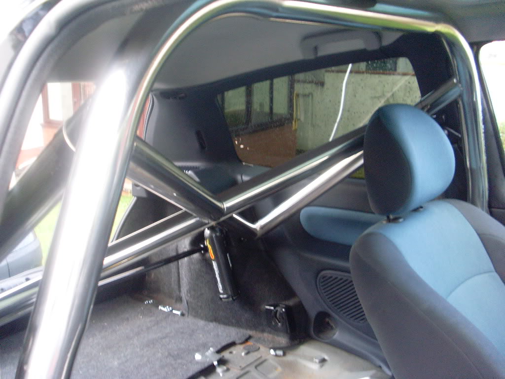

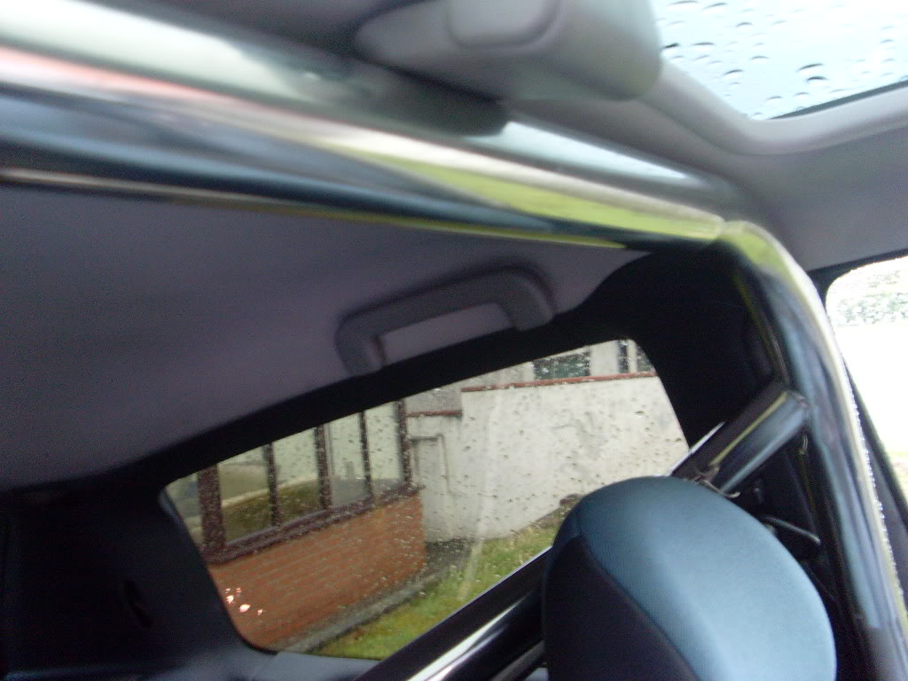

That cage looks very far forward. It looks like it is in line with where the side of ur head would be, and not the b pillars.
I'd be fitting huge amounts of padding to those uprights. Cos without you are looking at serious brain damage with a side impact, and no crash hat on.
^^in reply to above
As i havent fitted bucket seats in yet it does seem that way. the seats in the pictures are all the way back on the runners. its not normally like that and it may not look like but the cage is adjacent to the b pillers.
the cage looks completely wrong... as Steve said its further forward than the B pillars without question, all the pics show that clear as day. Are you sure its mounted in the correct places at the back?
Are those extinguishers for show? Can't see how you'd get to those from inside the car without whacking your head on the bars of the cage

The rear interior panels need to come out so that you can mount it on the metal rather than the plastic. you can see in the pictures that its tilted forward at the top.
spending the day tromorrow fixing it, will post pics when complete to satify you load.
regarding the "fire beaters", they are bolted in, so no worries about them. but doubt they will be staying there very long anyway.
How do you plan on using them in an emergency???
the holders are bolted in, the actually hand held units arent, they are clipped in and fully secure.
