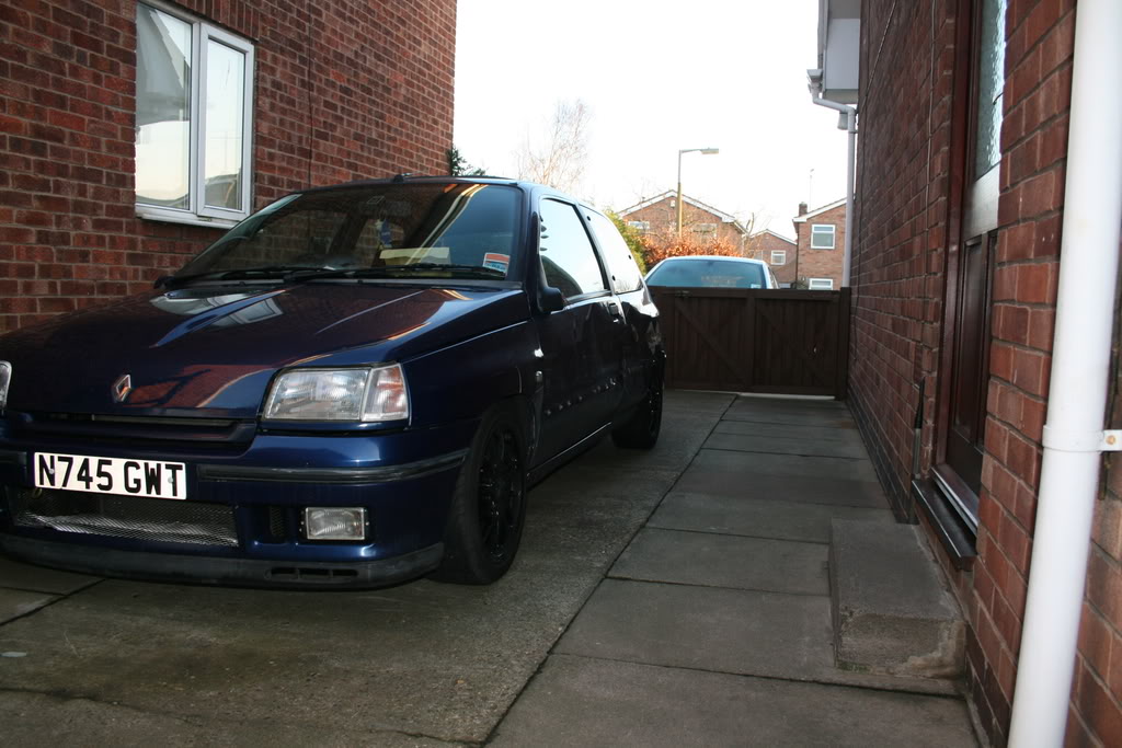

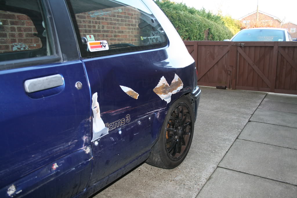

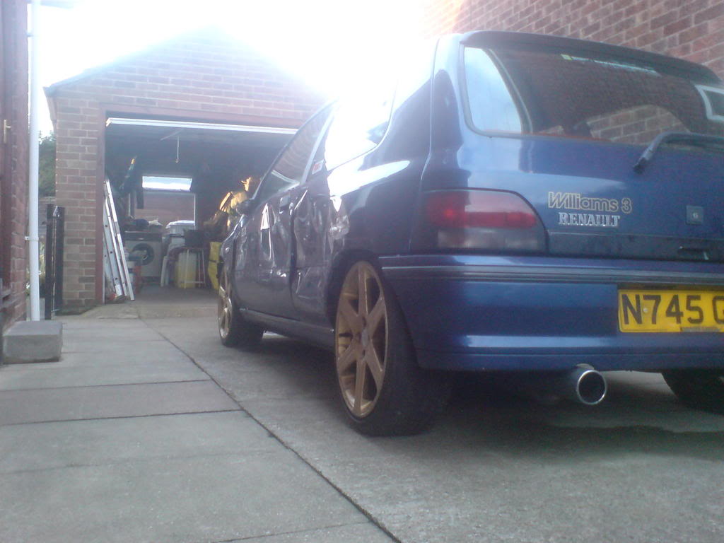

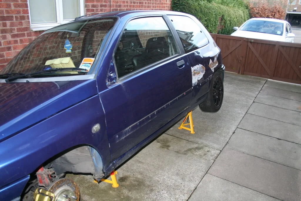

hey guys had the car a couple of weeks now, so thought id get a post up,

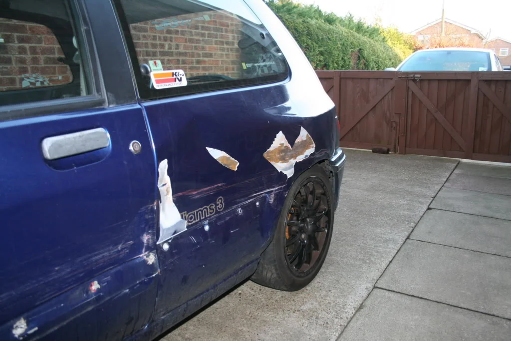

i bought the car of "deban" off here for the small sum of £275, it had damage to rear qtr door and front wing, but other then that was in excellent condition

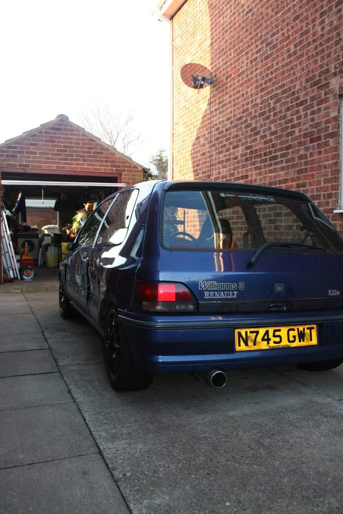

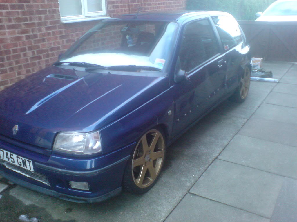

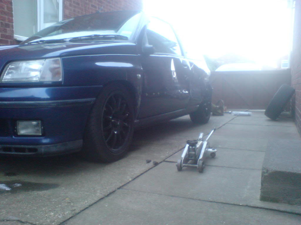

heres a pic of how i got her, sat on my nans drive looking sorry for herself
and no its not a williams one of the previous owners stickered it up, got my g/fs hairdryer waiting so get them off 2moro

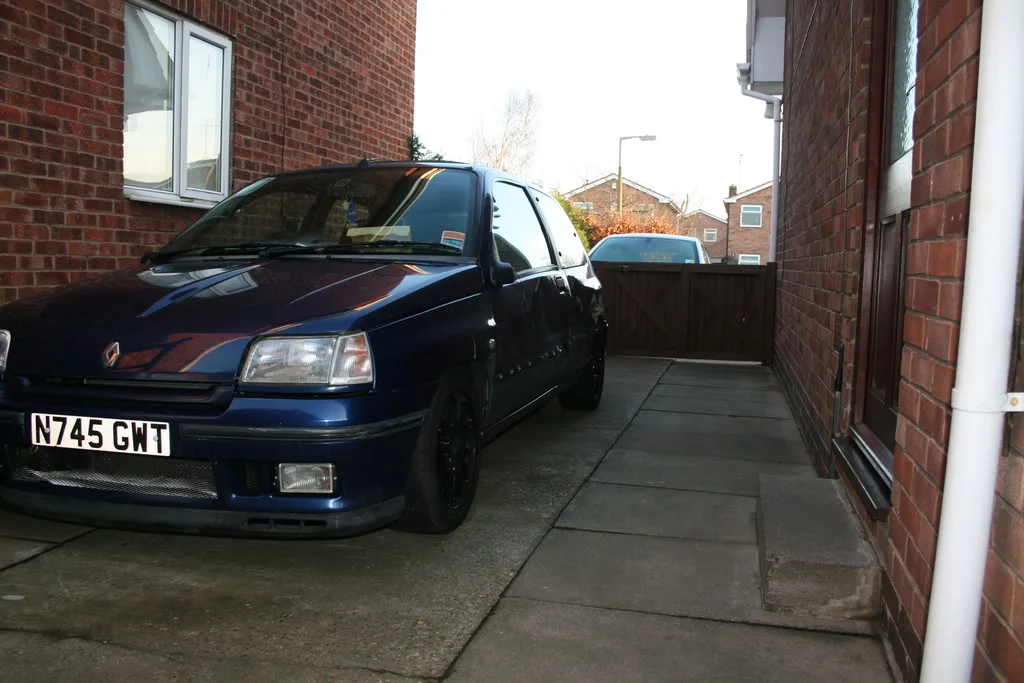

first off the plan was to strip her down and fit the valver engine to my 1.4 as a hybrid, but after much consideration i decided with new sills and hardly any rust it was better to repair and not destroy so first off was to fit my alloys and get it sitting better

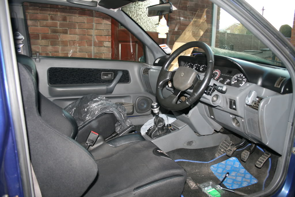

1000x times better ill think ull agree, next up im fitting my bucket seats sould have them fitted 2moro so will get pics for ya,

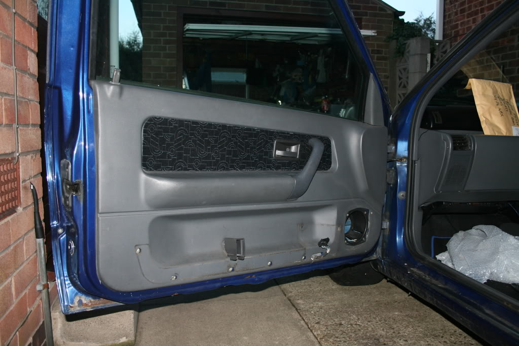

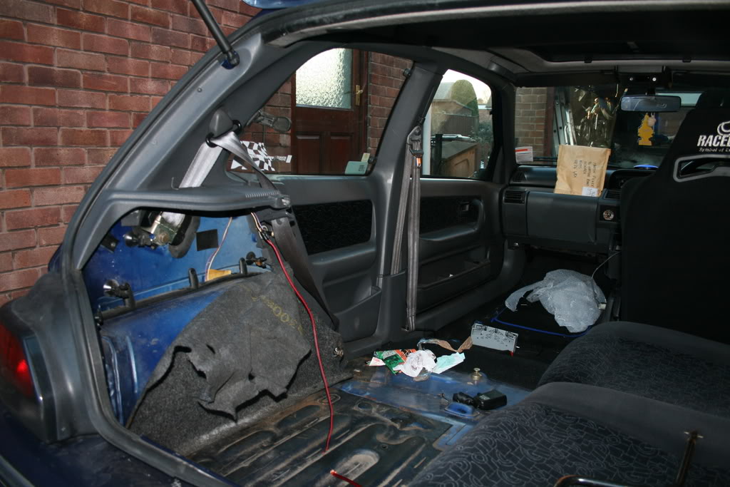

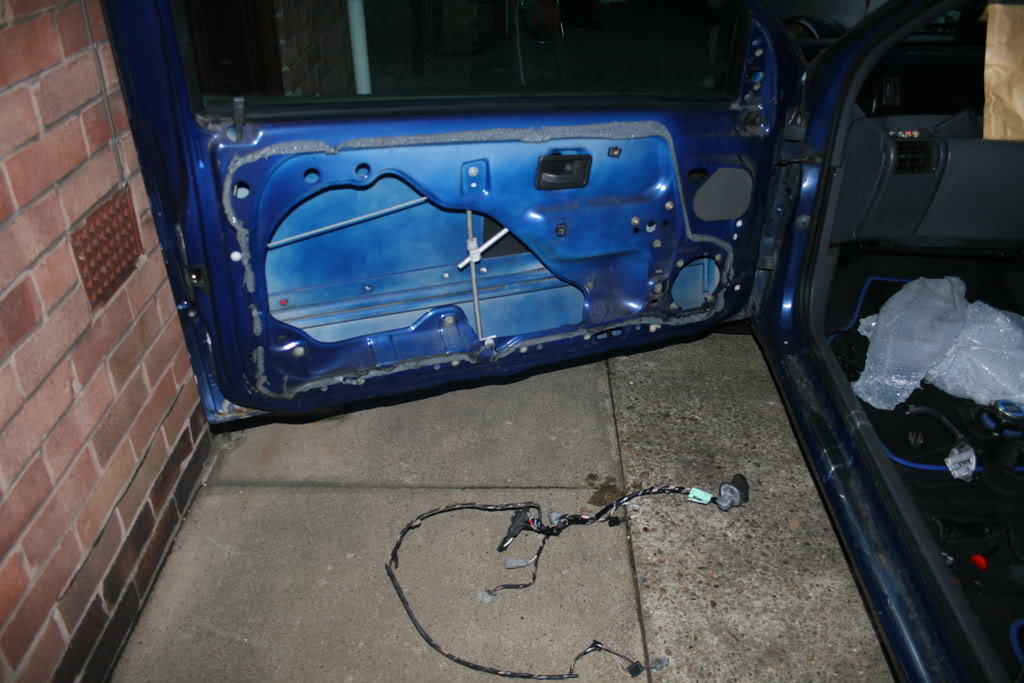

taking door card off ready to strip door down

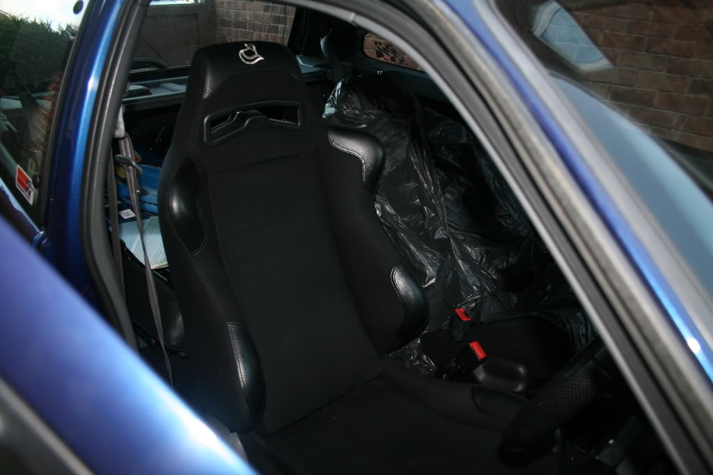

then i managed to get my drivers seat in correctly, didnt want to fit passenger with climbing in and out all the time

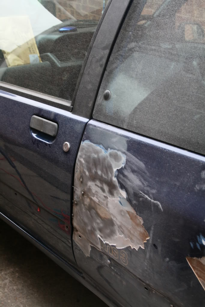

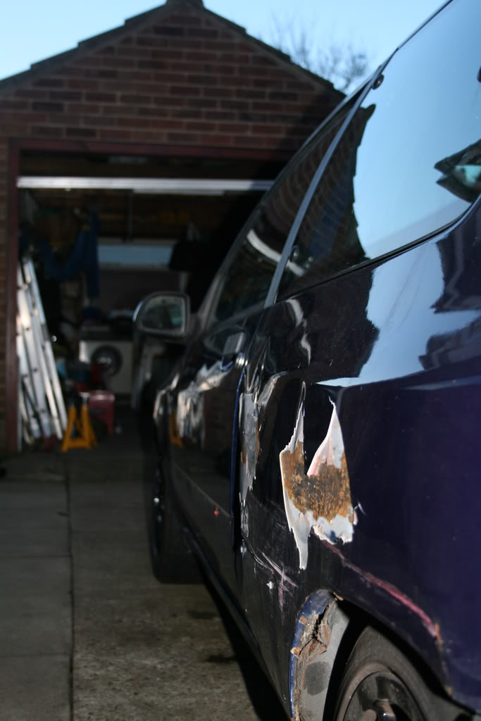

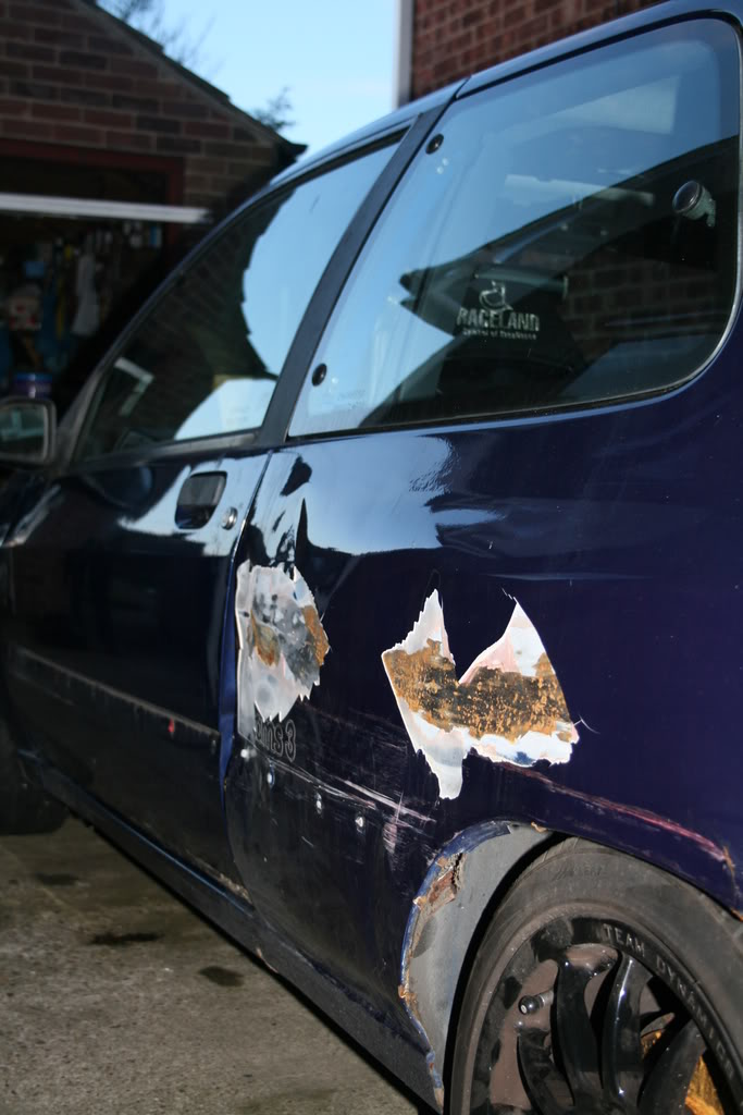

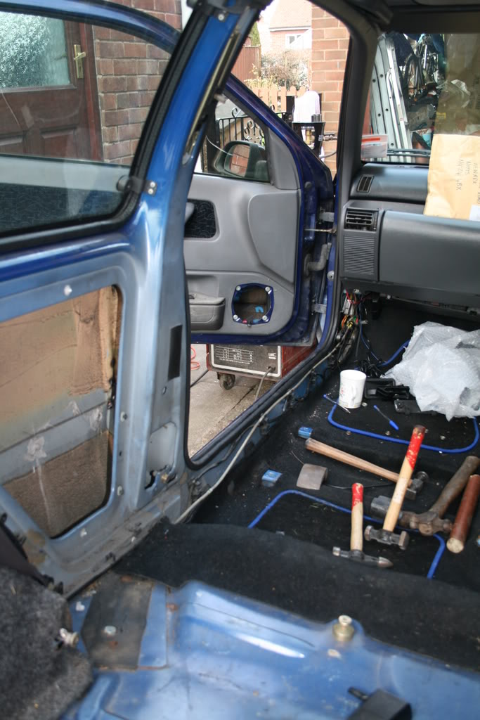

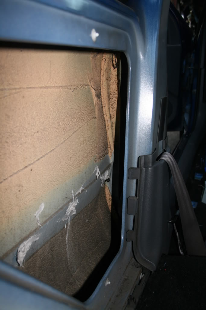

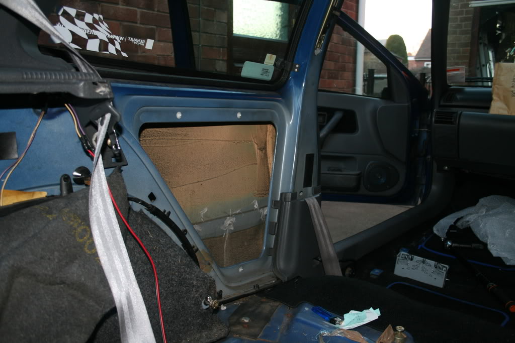

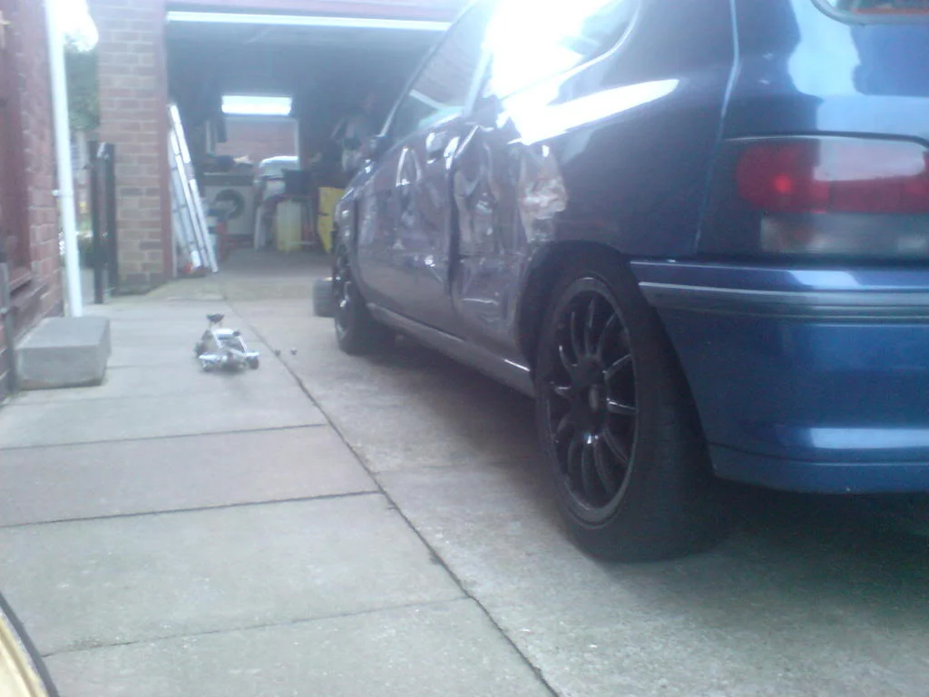

then i removed rear door card to get at damaged rear qtr

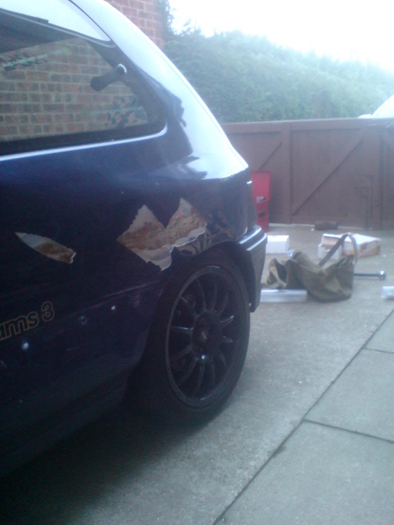

as you can see damage is quite bad, but nothing some hard graft wont sort out

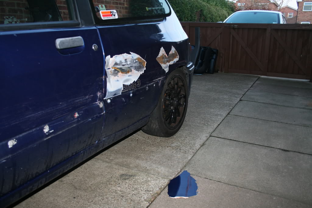

after i pushed the damage out with my special tool, MY big size 11's, i heard a drop on the floor ...

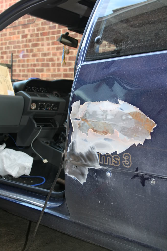

more paint fell off,got some clearer pics for you guys aswell
Daniel
  Whichever has fuel
Thats not paint falling off mate, thats chunks of filler.
I bet that cars rotten as f**k underneath.
  Clio 1.4 Maxim
there is a little filler in the paint yeah, but not loads, and its only rusty as its been like that in the snow

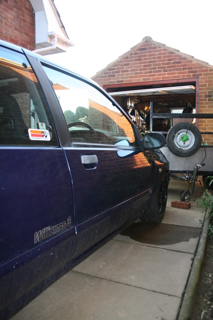

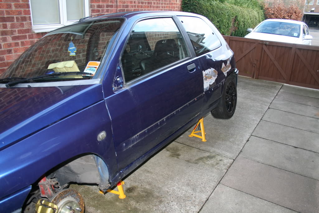

well i got my new door, wing and mirrors of MatBrown, so got to work tonyt, fitting them, wing went on in seconds door was a little more hard work but got there in the end
heres some pics

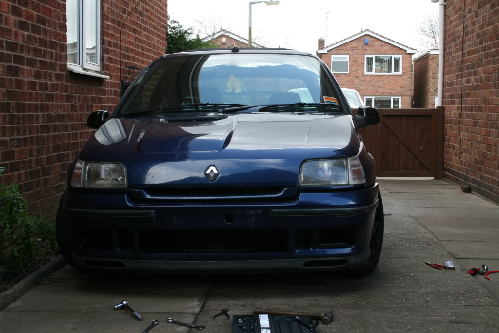

fitting the new wing and door

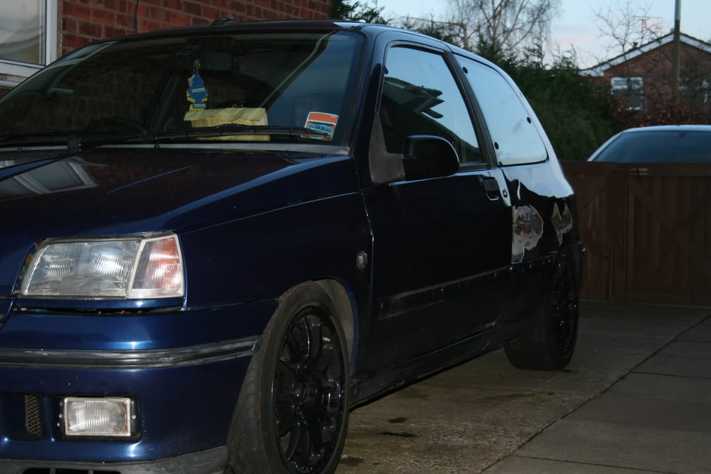

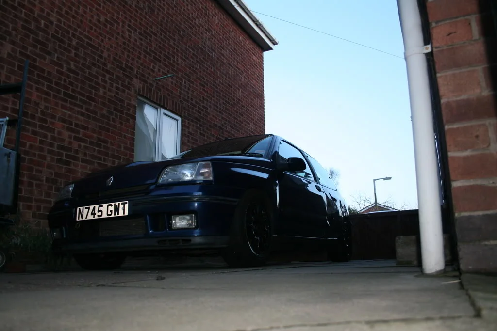

got wheels back on and back on ground, fitted my phase 1 mirrors, that need spraying soon,
looking more like a straight car, now just rear quarter to go,

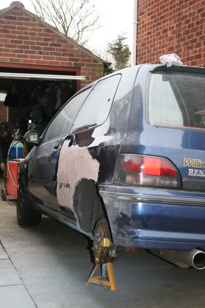

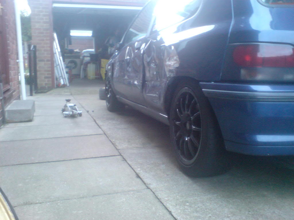

these pics so, how much rear quarter is folded in
Daniel
  Whichever has fuel
Mate, i'm not trying to piss on your fire or anything and i apologise if it comes across that way, but are you sure theres not more rot in that car???
Because to me, in this pic, it looks like the inner wing has rusted away from the outer wing and the whole lot has just been skimmed with filler.....
  Clio 1.4 Maxim
no i see what you mean its bent back inside the arch from the accident there is some rust in there but it will be sorted, i checked mate cause after taking pics i was a little worried about it lol

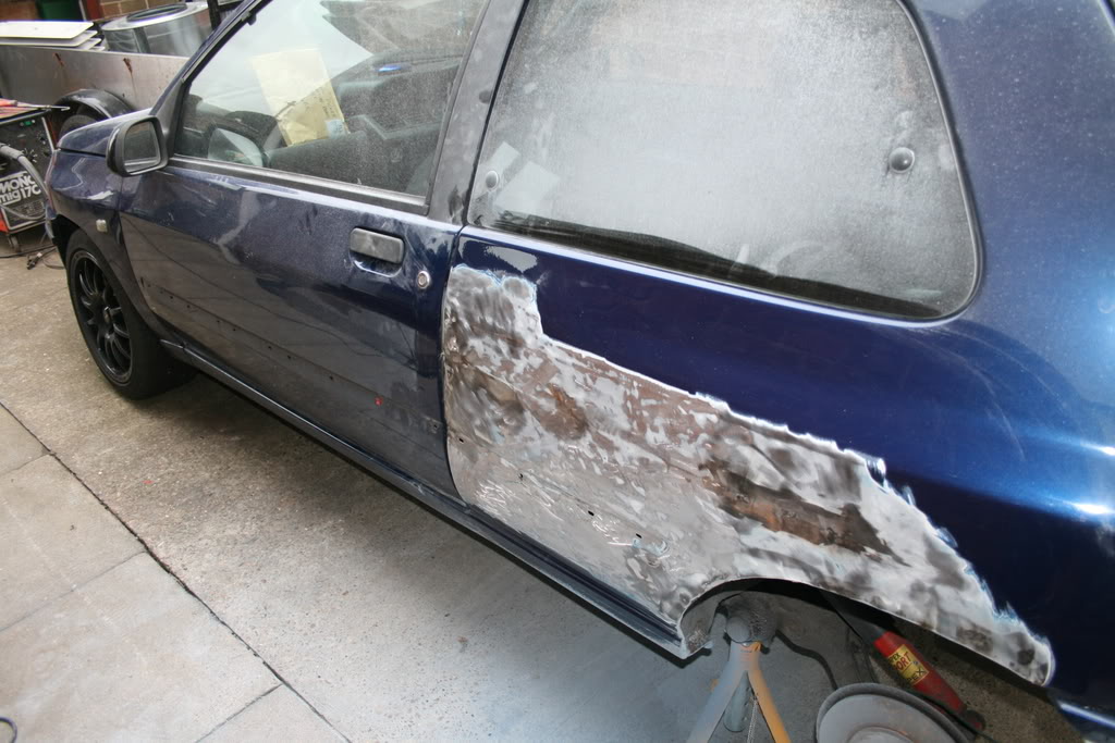

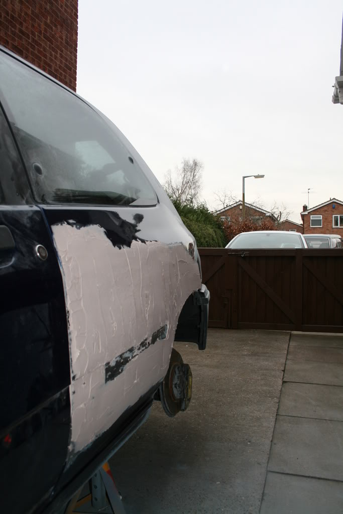

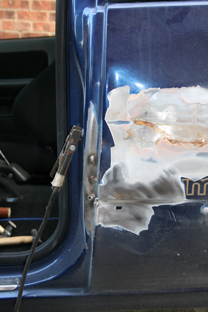

BIG UPDATE,
first off i started by stripping some interior

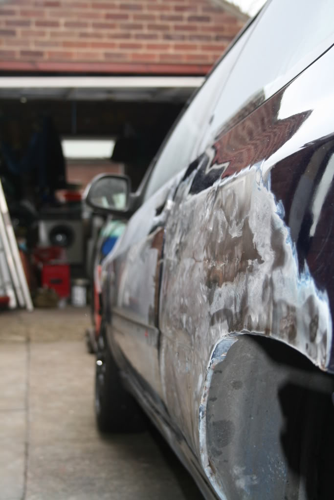

then i got grinder happy and started taking paint off,

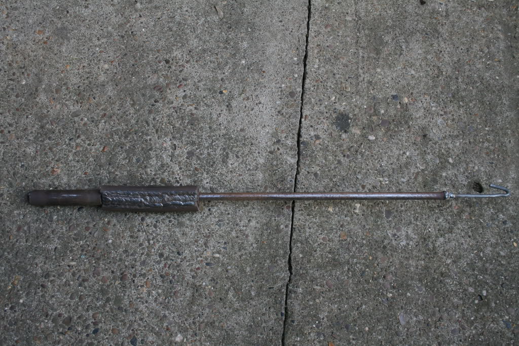

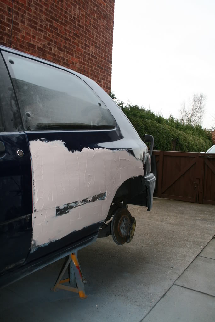

then my uncle had mocked up a slide hammer for his mk2 rs2000 escort project so i borrowed that
here you can see welds from the pegs we welded on to slide hammer the dints out
then it started looking better and better after every bang
ground some more paint off,

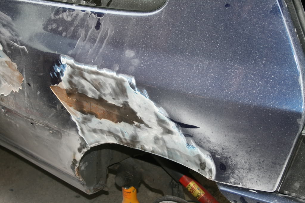

turns out it was dented before and who ever repaired it just fillered over old paint took ages to get cleaned up
got the whole panel cleaned up
then time was running out cause i couldnt spend all valentines day working lol so i got a layer of filler on and left it at that
but since i got it, its come along way
dint when i got it,
dint now,
Fillertastic. Surely a 1/4 cant be that dear to buy. If the car genuinely isnt rotten as a pear and full of filler all over the shop then personally I'd buy a new 1/4 and stitch it on if you're putting some time and effort into it anyway. If you've been doing that work all outside my bet if the filler you've slapped on will end up coming back off again in a very short time anyway.
Looks like a good 3mm + of filler even before you got hold of it here.
  E92 M3 Monte Carlo
a new rear quarter would cost more than the car,i know a 172 quarter is about £500,lot of work aswell fitting a quarter
  Clio 1.4 Maxim
read the thread that is on old pic showing how far it was bent in when i got it, its had the smallest skim of filler to make sure its smooth i used a slide hammer to pull out the dent, read before speaking

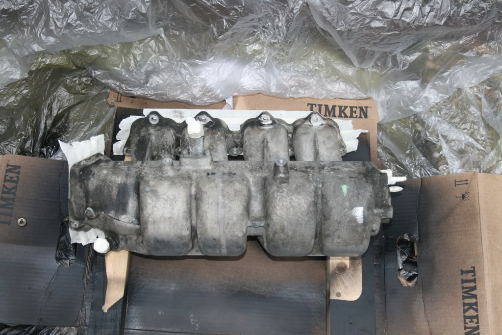

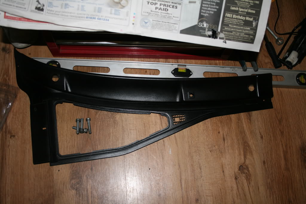

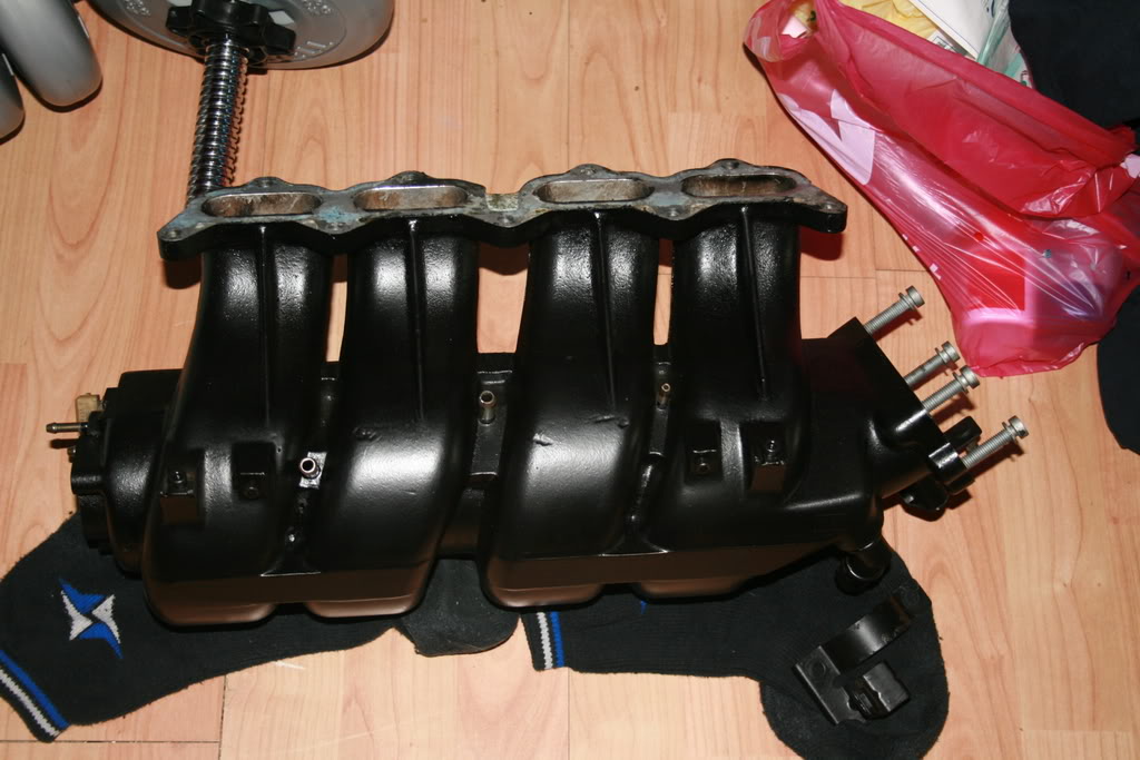

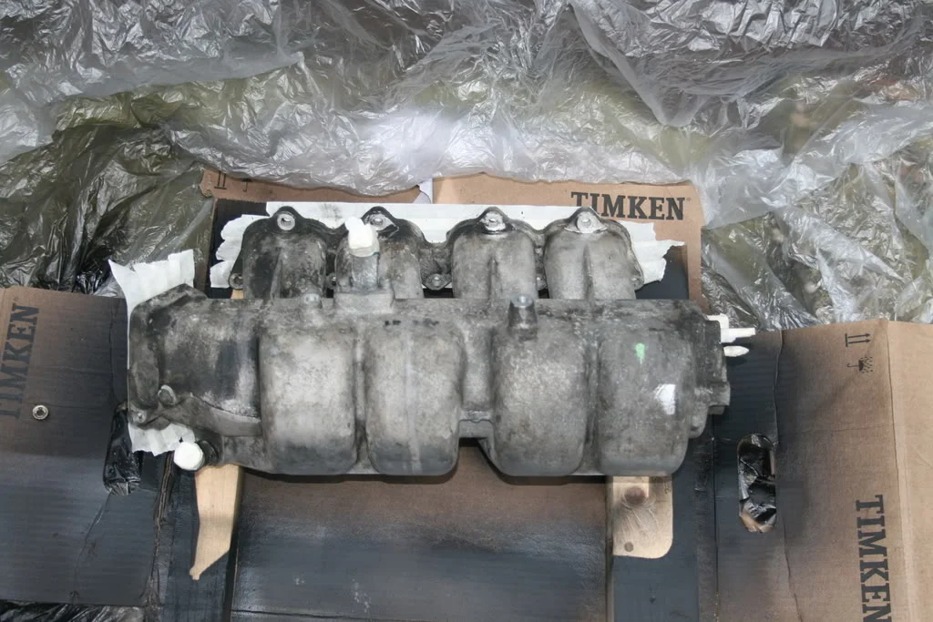

got the inlet finished tonight
how it looked when i got it
after a few coats of hammerite satin black
also sprayed my spare scuttle panel
should hopefully get a gasket set soon, and then i can start cleaning the engine up :D:D

and about the rear qtr been told there about £700 and i dont need one qtr is fine now, but ill get some pics up after i start smoothing it back, will be done soon, i hope just need to find work

ive filled a quarter like that before, infact it was worse it got in volved an a crash and it didnt budge so u'll be fine, and you dont want to be puttin a 1/4 on it, i've seen brand new cars on the forecourt with hidden quarters of filler, keep up the good work, PS where you live and what you do as regards work ive got a mate in recruitment,

Good work on pulling it out etc looks much better :) alot of people do what originally happened and just budge it fixed :(
just watch the filler in this weather, it will absorb moisture if you havent treated it yet, and primer does to just so you know ;)

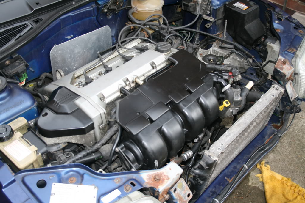

well a bit of progress today,and yesterday,

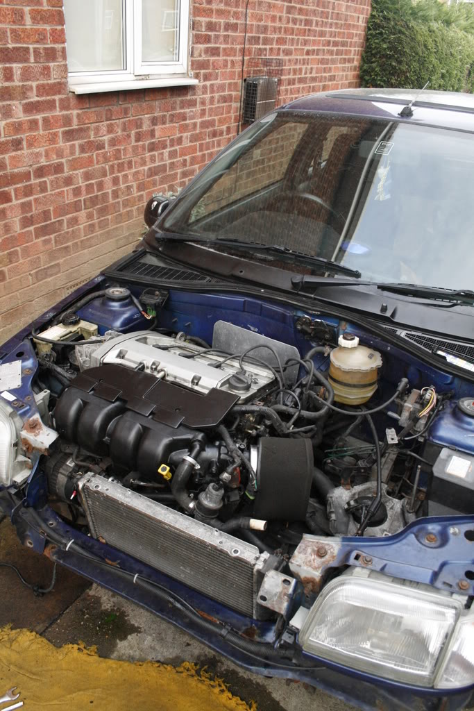

got my self some new spark plugs, ordered some new HT leads in yellow, sprayed some more parts up and then i fitted my inlet to the car,
YESTERDAY
Stripping Everything down
Inlet off, this was a nightmare undoing all the bolts, don't recommend this job to anyone
fitted new inlet and gasket, as you can see it got scratched but ill touch it up,

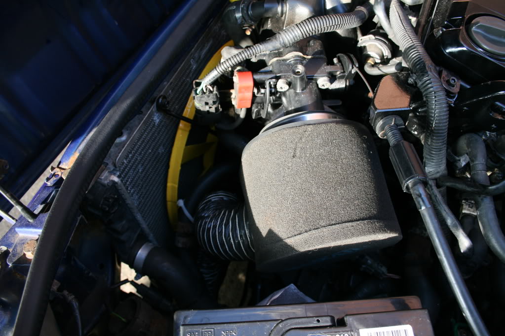

test fitting induction kit, and engine plastics
just waiting on some new bolts for rocker cover and can get the black one on and fitted,

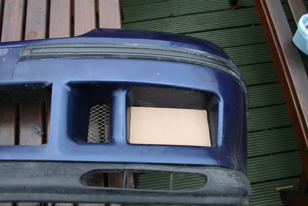

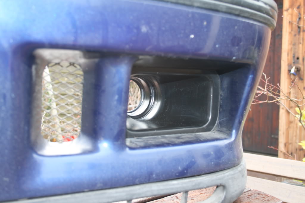

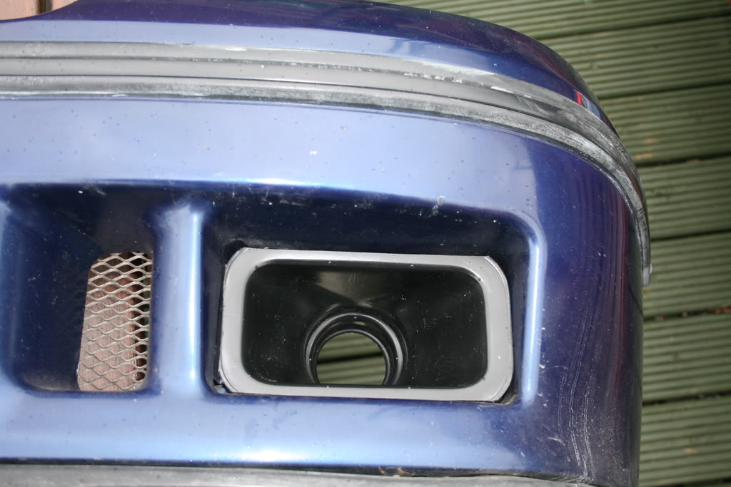

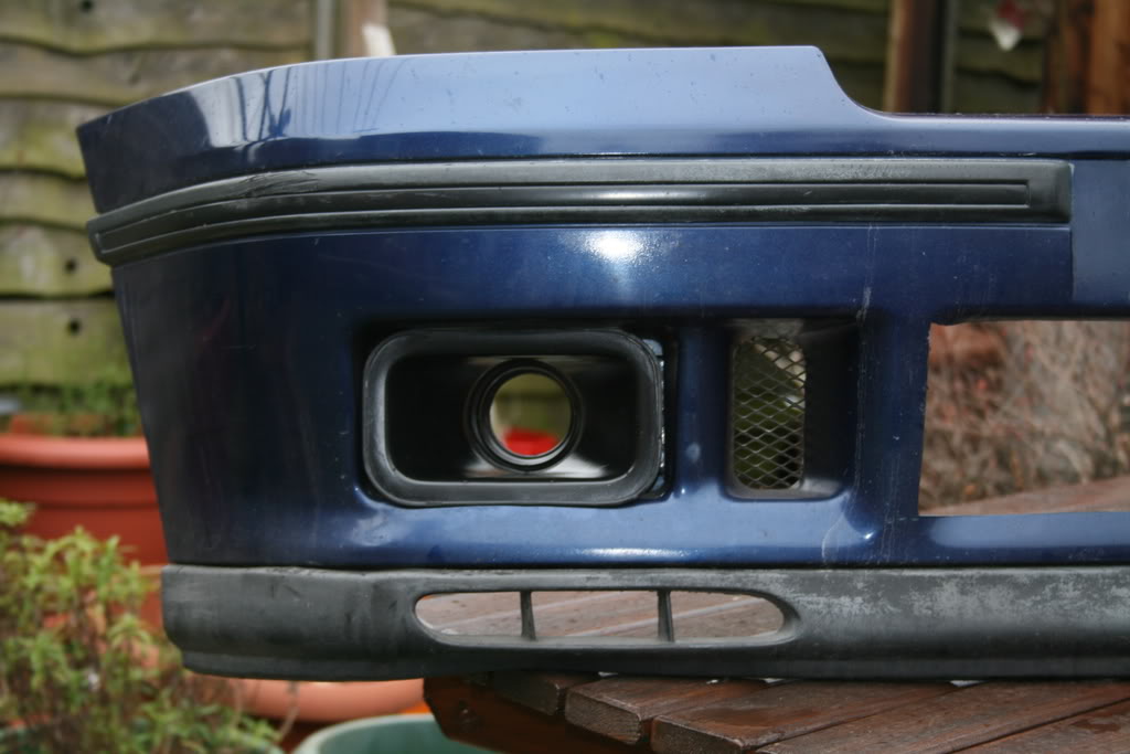

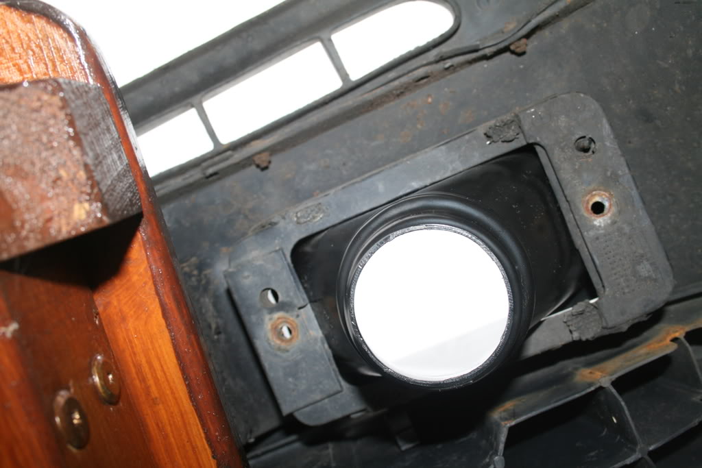

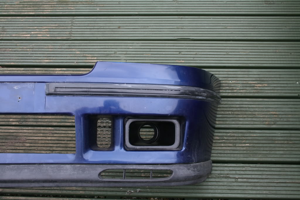

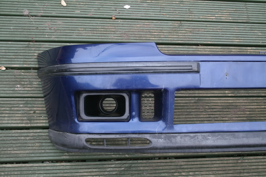

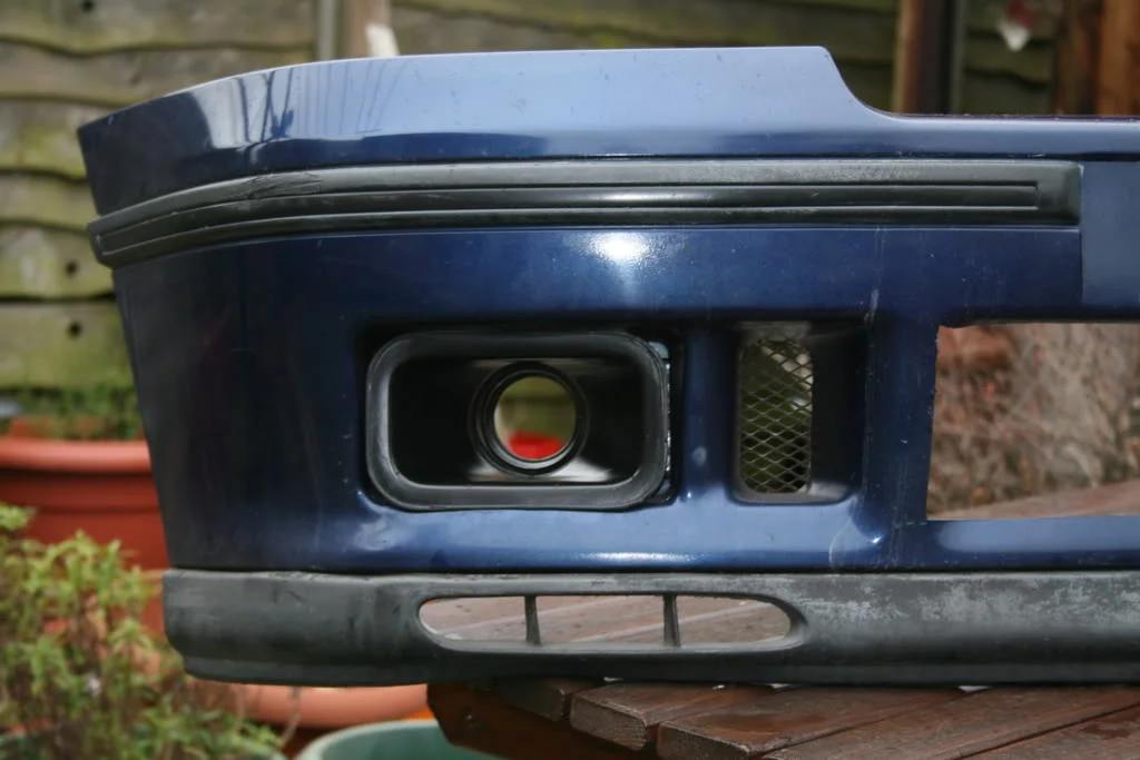

i got my self some air ducts for the front bumper as the fogs didnt work and wanted to do this anyways, followed coops guide found here
http://www.clio16valver.co.uk/forum/viewtopic.php?t=9082
test fitting
Cardboard template
cut down with dremel only to find fog light mount on bumper needs cutting
so cut that down and they fit perfect
used some tiger seal and fitted them and stuck them down and am just waiting for them to dry to get a air feed pipe and get it fitted back on car

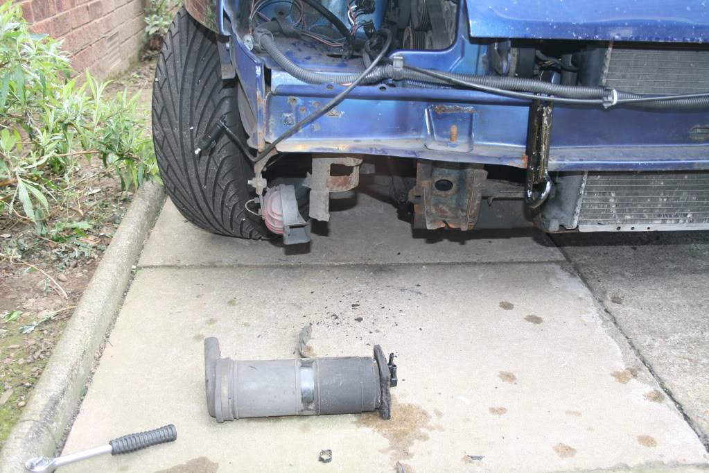

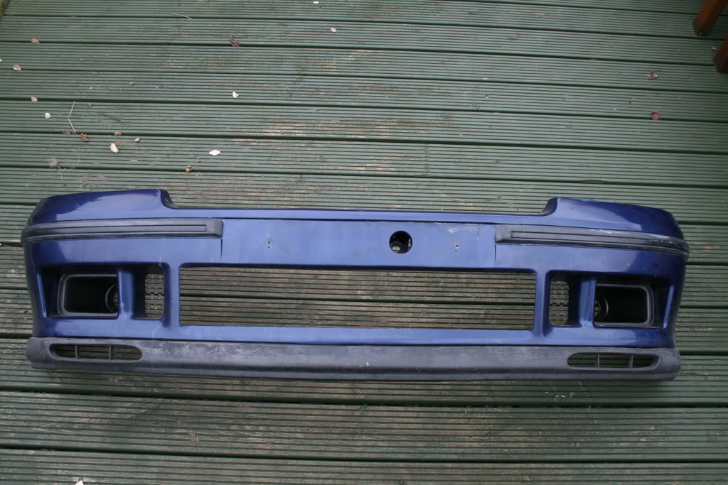

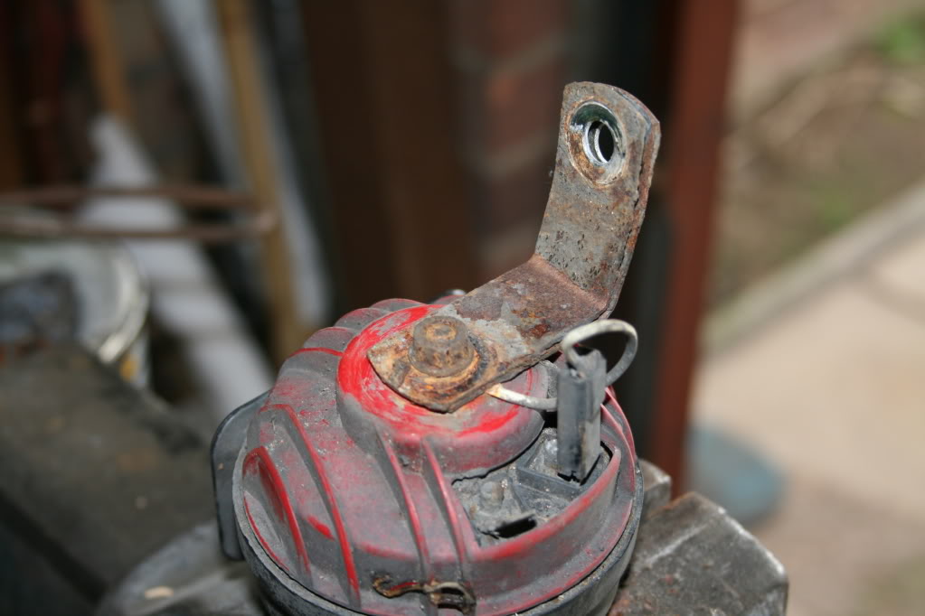

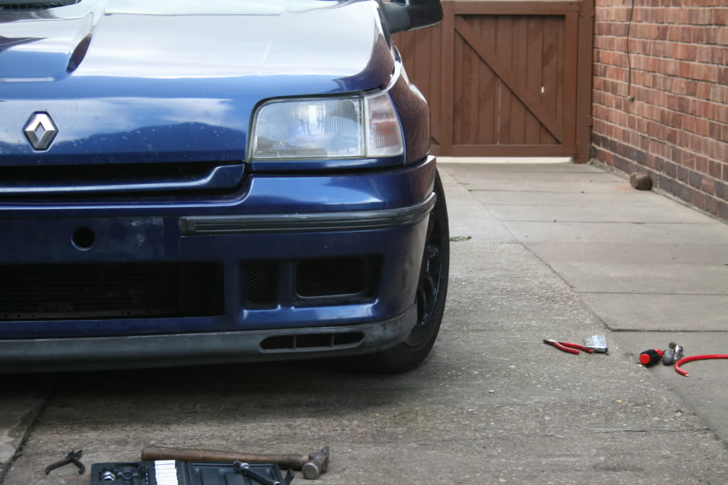

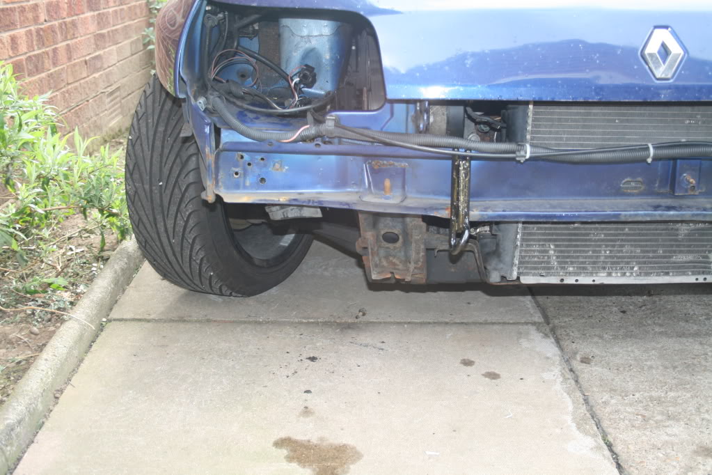

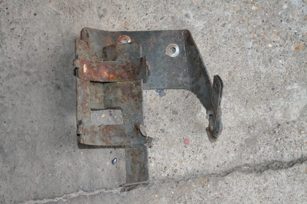

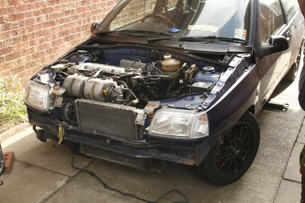

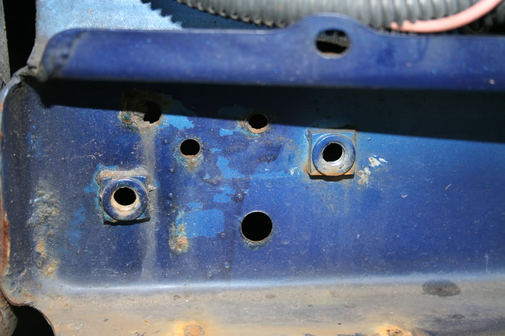

first off after i fitted my fog light air scoops i went to re-fit my front bumper and the carbon canister was in the way, so i did some research and removed it,
removed these too bolts
and this lot came away
this meant removing the horn
so i removed some little strips of the mounts and modified them to fit the horn
horn remounted out the way, all better..
meaning i could re-fit my front bumper,

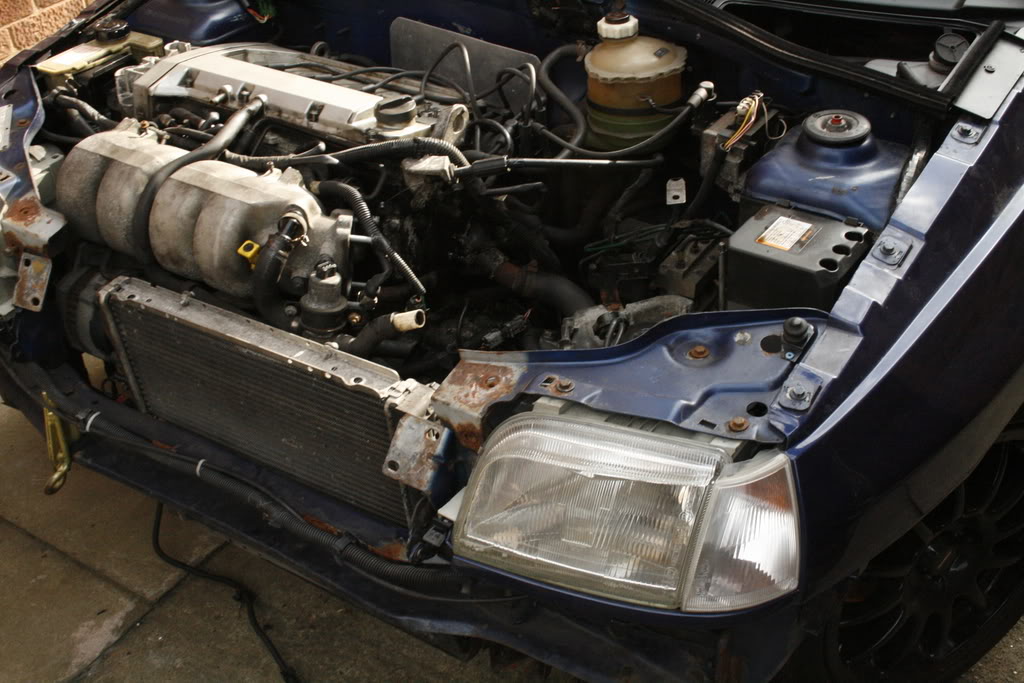

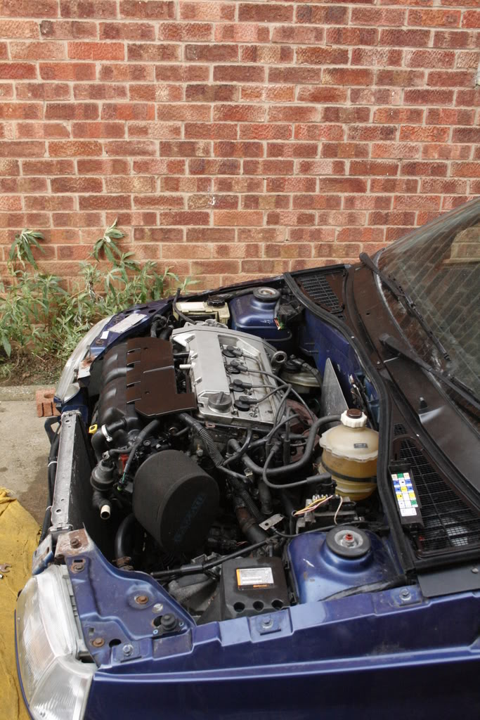

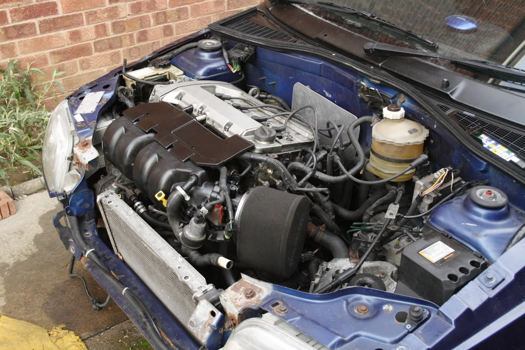

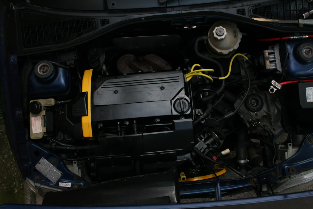

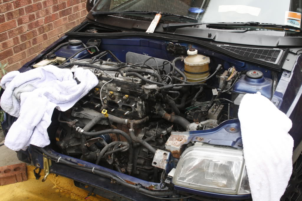

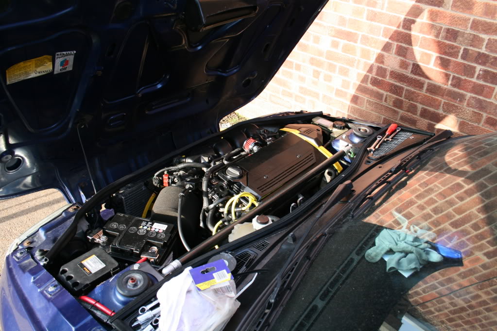

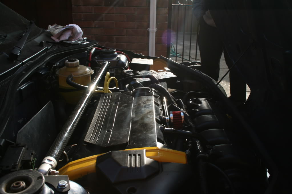

also got on with some work on the engine bay
painted some bits yellow and black got new rocker cover gasket fitted, and new allenkey bolts holding it in place, fitted new battery clamps, painted the fan, just tidied it up really,
its not finished but as you can see from this pic its alot tidier then before
not the best pic but you get the idea

fitted my carbon fibre strut brace today went on very well,

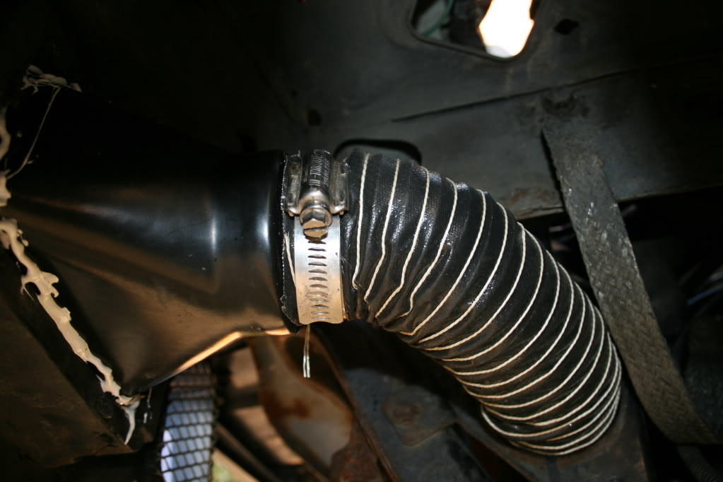

got my air feed fitted
