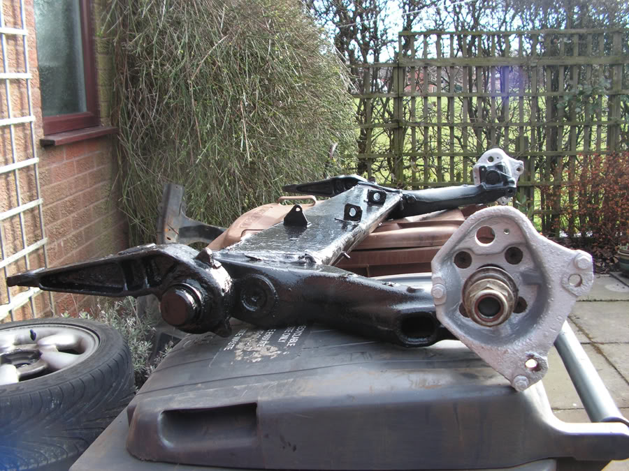

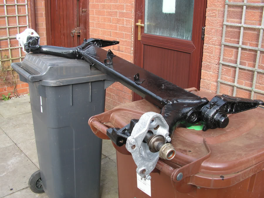

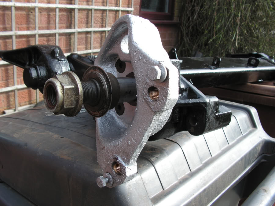

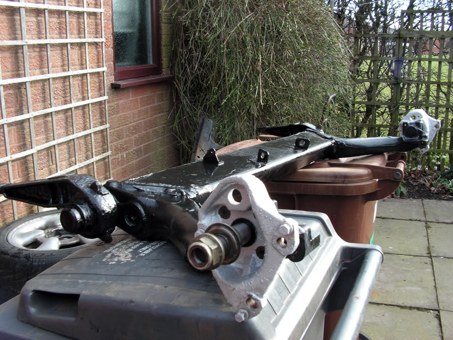

Finished off the beam today. Coloured those end caps up in silver hammerite and 2nd coat of black hammerite brush on, on the actual beam.

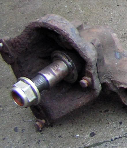

Not a perfect finish, but where do you draw the line. Almost tempted to do them again. In an ideal world should have sent the ends off to be chemically cleaned for the perfect finish, but cleaned them up best i could. Spent 3 hours cleaning them up this morning before spraying. Again though the rust has set in too badly to get them perfectly clean. Still a few cling-ons of rusty bits!! :eek: :D :p :(
Improvement on what they were though

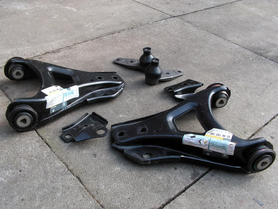

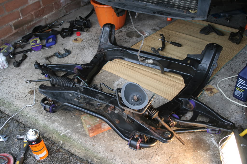

Also picked these up Friday night. :eek:
172 widetrack bits almost collected. Just need to find a willy/19 16v ARB now.
So bits to get now are;
willy rack
poly bushes
willy ARB
trackrod ends

Wot are those wishbones off they look like valver ones, you need 172 wishbones for the widetrack. The difference is were the arb goes on, the arb on the valver it screws in the end and the willyams arb has clasp on the end, do you know wot you need to finish the widetrack off and wot need to be mashining down
  Clio 1.8 16v - 2.0 Conv
Hi mate, calling renault tomorrow for some bits, so will check part codes, but 100% theyre 172 wishbones as far as i know. They have the strenghtening plates and hole to match on wishbones itself, which the valver doesnt have.
Yup, i know about 2mm either side needs to come off the hubs. Ill offer them up when i get my coilies to get correct amount.
Parts needed for widetrack completion off top of my head:
willy arb
poly bushes
willy rack

Although they seem to also be from a kangoo looking at the part number. But theyre given as the same part number, clio/kangoo. The only difference seems to be the strenghtening plate part with the extra hole.
Yes, I can see now mate. Theres a plate where the hooks through on your pic?
There isnt one on these wishbones, so I dont see how they can fit now.
Ill call renault tomorrow to confirm.

Yeah, they are just round plates with a hook that go through the wishbone, round the bush then have a bolt through the wishbone on the other end. Out of the 1000's of pics ive got, I havent a single one of the wishbone/ARB from underneath lol :(
