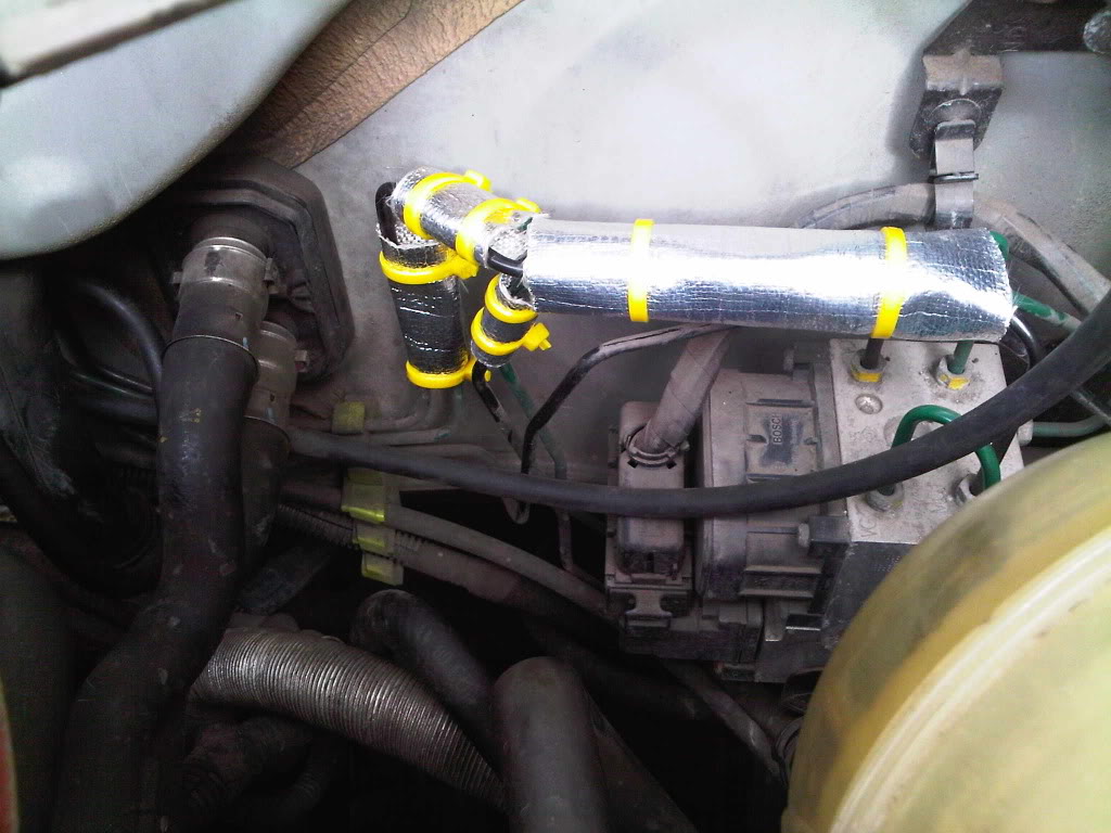

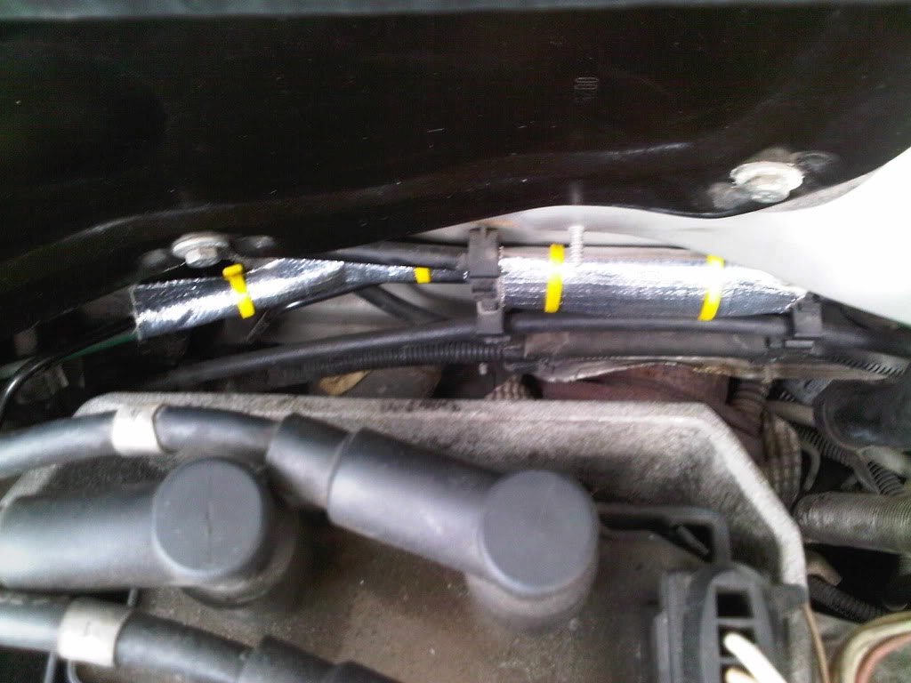

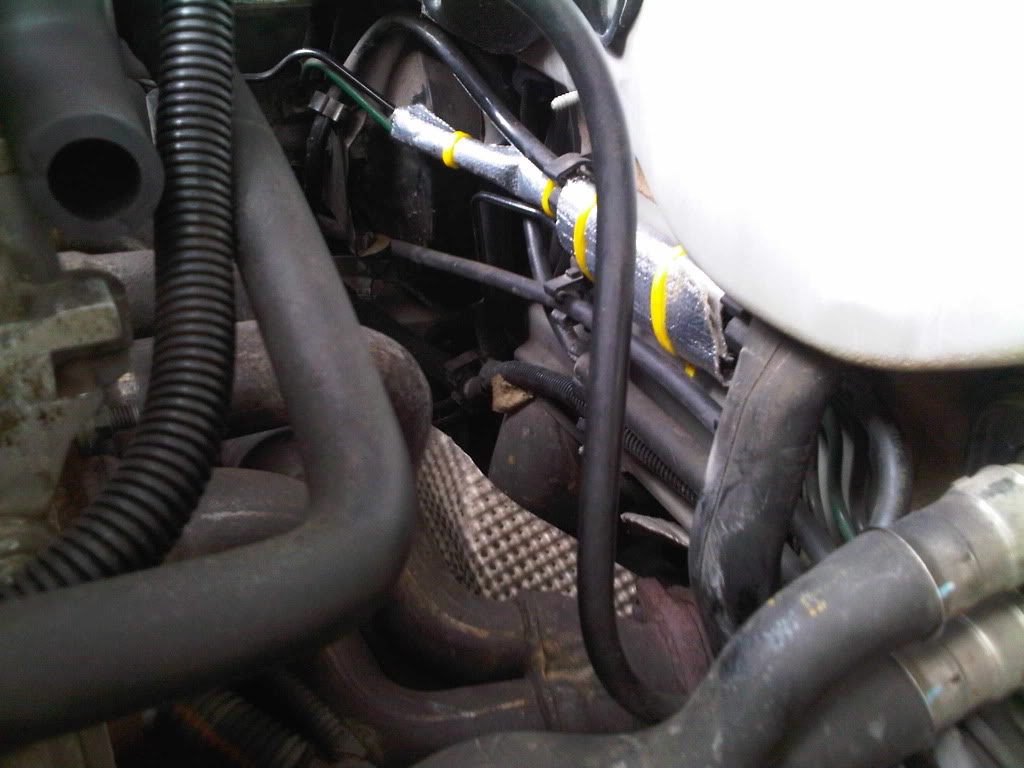

i did wrap them in the end and heres the result
i brought the stuff i linked to in the OP and its sems like decent stuff i brought two sheets and only used 2/3 of 1
