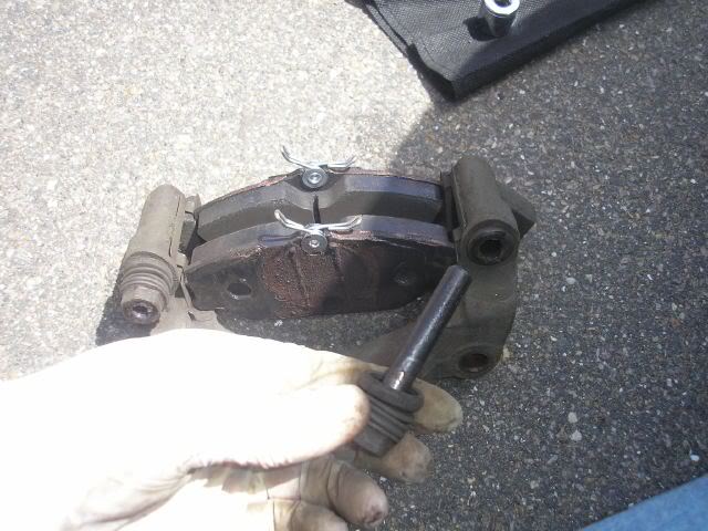

  Megane r26
this little bit here, should always be inspected on brake change an greased up
Akay
  Clubman Cooper S
Thanks. Yeah I rebuilt the fronts and greased them up, haven't done the rears yet might have a go tomorrow weather permitting!
  Megane r26
Fair play dude, doubt the rears would really give you too much greif as the braking is front biased as you no doubt know, but suppose its worth it just for piece of mind. Good luck fella
