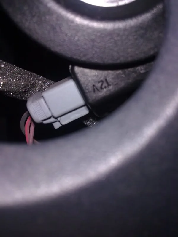

I am currently wanting to install a push to start ignition in the 172 and have took a few pics of what im presented with and wanted some deffinative answers.

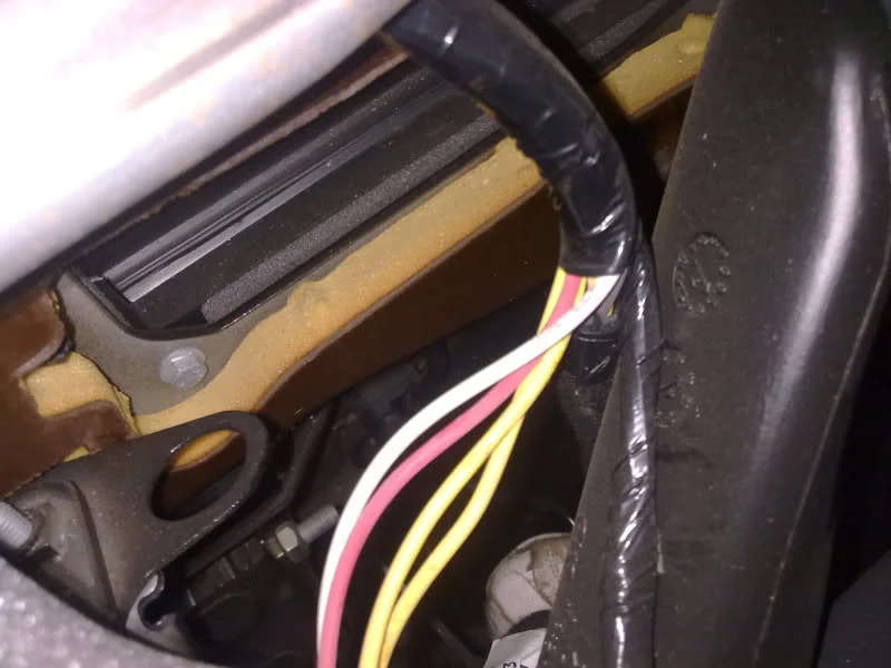

First all these are the 4 wires from the ignition barrel which provide the main starter motor power.
Which of these 4 cables acts as the 3rd turn of the key to start the motor?
I can see a good source for a nice 12vdc to open the circuit to allow the 40amp relay i actuate. This hangs of the barrel itself.

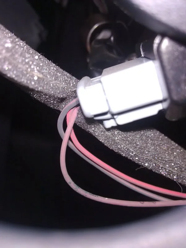

Above is a close up of the 12v indication and below is a close up of wires.
Again which ones do i require?
Im going to be using this with out that stupid red button but use a button hidden else where in the car and dis the wires which would effectivley render the key only useful for steering lock and immobiliser.

I fitted a push start button, firsty don't use the bottom two pics as they are for immobiliser and they are very sensitive and need enough electricity to work I strongly disadvise doing this. Secondly, I want to warn you, the button gets old quickly. Its fun to begin with but do you really want it? the key will be more reliable and easier to sell. Wiring wise if you buy a kit it wil tell you, there are specific terminals to use for each. I'll post it if I find the instructions...
I'll find my kit on the net tomorrow. It just replaces the 3rd turn not the first 2. You can remove your immobiliser ring and reposition it as a cup then leave the key blade in the switch. Then use the button to start it, you would still need the fob to get past the immobiliser. I'll explain more when I'm on my mac and not my iphone
