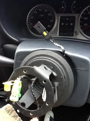

I'm in the process of threading the wires through the boss to bolt it on.
I've done the air bag wires and the black and red wire (horn I think).
What do I do with the last connector? It's a black square block type thing. No way is it fitting through the hole in the boss.
Help? Mk2 ph2 btw :)

It will fit through mate, i've got an OMP one and its abit tight but it does go.
Make sure your steering angle sensor is lined up properly mate, it gave me loads of problems when mine was out.
  BMW E82 M Sport
How do you know which way to line it up lol
In the top left hand corner of the sensor there is a little window. When you turn the inner ring of the sensor you will movement in the window, you have to work it out from that. Its pretty easy to work out i'm just sh*t at explaining things lol.
  182
It will not fit mate! Sorry to tell you the bad news! I had the same problem, for some reason the omp boss does not fit, had to send mine back and got a MOMO one that fits perfect
Problem with the omp is the hole for the wires to go through is simply not big enough

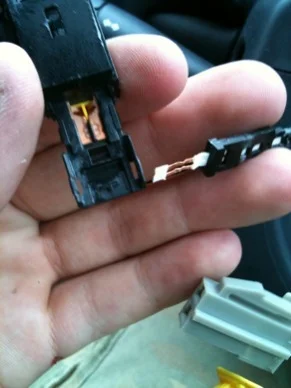

Ben have I broke it massively?

Did you try fitting the biggest one through first? so the other wires werent in the way? Before you broke it anyway lol..

I think this is what has happened. I didn't realise there were different kinds for the Clio. Hole was too small but I couldn't tell by looking at it if it was going to fit.
Trying to prise it in has knackered the ribbon wires for the cruise control.
Also i tried to line up the spinning sensor thing, thought i did it right but the TC light is still on so either i've done it wrong or i've broke it.

You shouldn't have broke it mate. If the steering angle sensor is set right and you still get ESP + serv light's you will probably need steering angle reset to 0 degrees. This happened to me and it had to go to Renault to be sorted, cost me £50.
