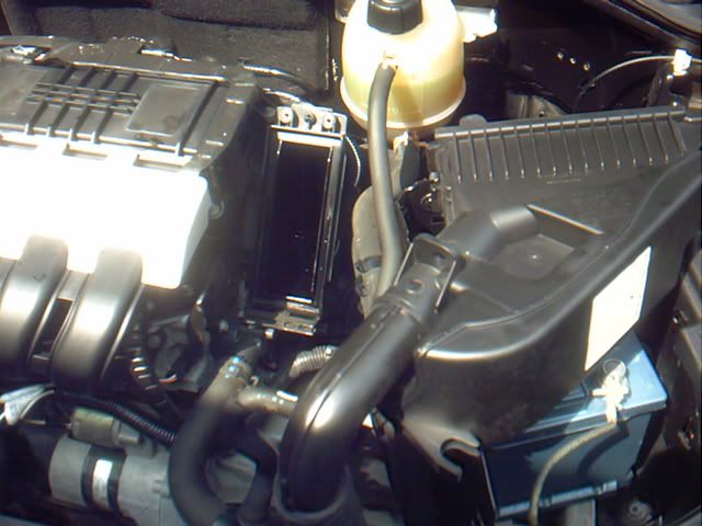

All you need to do is.
1. Take off your air filter housing.
2. Under the housing - side of your engine you will see (Bmh pic 13.53).
3. Undo to two bolts (10mm IIRC).
4. Clean sensor and connectors.
5. Re fit and connect.
6. Filter back on.
And...........................Job done. It took me 1/2 hour to do, and cost nothing.

Under the bonnett;) on the right (blackbox thingy).
ok so i still cant find it, i think im actually stupid. i lift the bonnet and theo nly black box i see on the right hand side is the plastic cover for my fuse box?
now im with you, back to the great outdoors armed with.......false hope. thanks mate brb :)
easiest way to remove the housing? tried those two nuts and they refuse to budge. in a rather awkward position for getting a wrench in there with the plastic grooving each side

two bolts are out and its swung open, but doenst completely remove, correct?
yeah trying bud trying :) id rather learn a bit about my car than have to take it to renault at 68 quid / hour if its really this sensor doohicky
No, it only swings open, you should be able to get to the bolts holding it to the block now so you can remove them.
OK, you should be able to unhook the hose that feeds air into the airbox so you can get that out of the way. Then you should be able to get at the sensor now, if not then the bit of airbox still attached to the engine needs to be removed. The haynes isnt overly clear and I cant really see from that picture.
