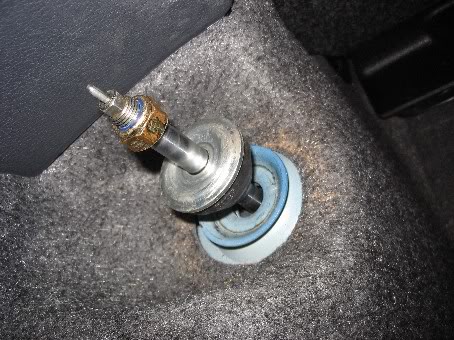

Here's a pic of when it came out the first time:
Looks like I only have one rubber bush?

hmmm cant really work out whats happened from the pic
seems the bushes had slipped down allowing the shocker rod to side up through the hole but cant really think how it would have happened
this is obviously how they should look.....

Yep mine looks the same at the top now, don't know about underneath will have to have a look.
