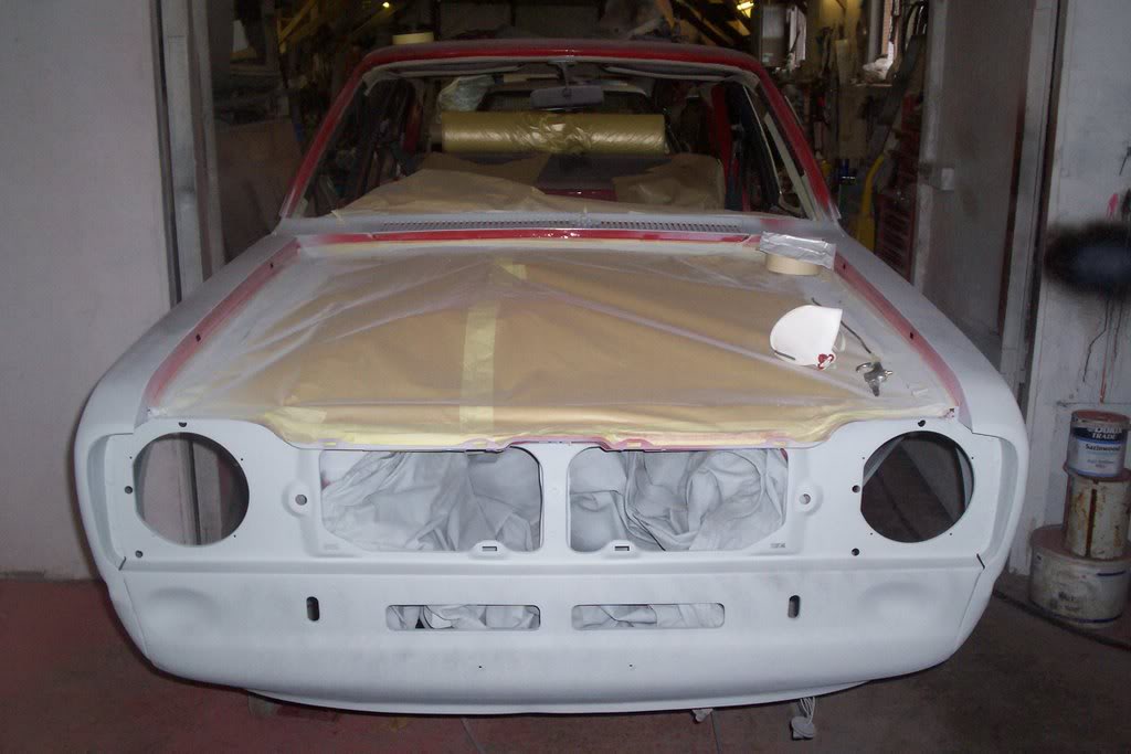

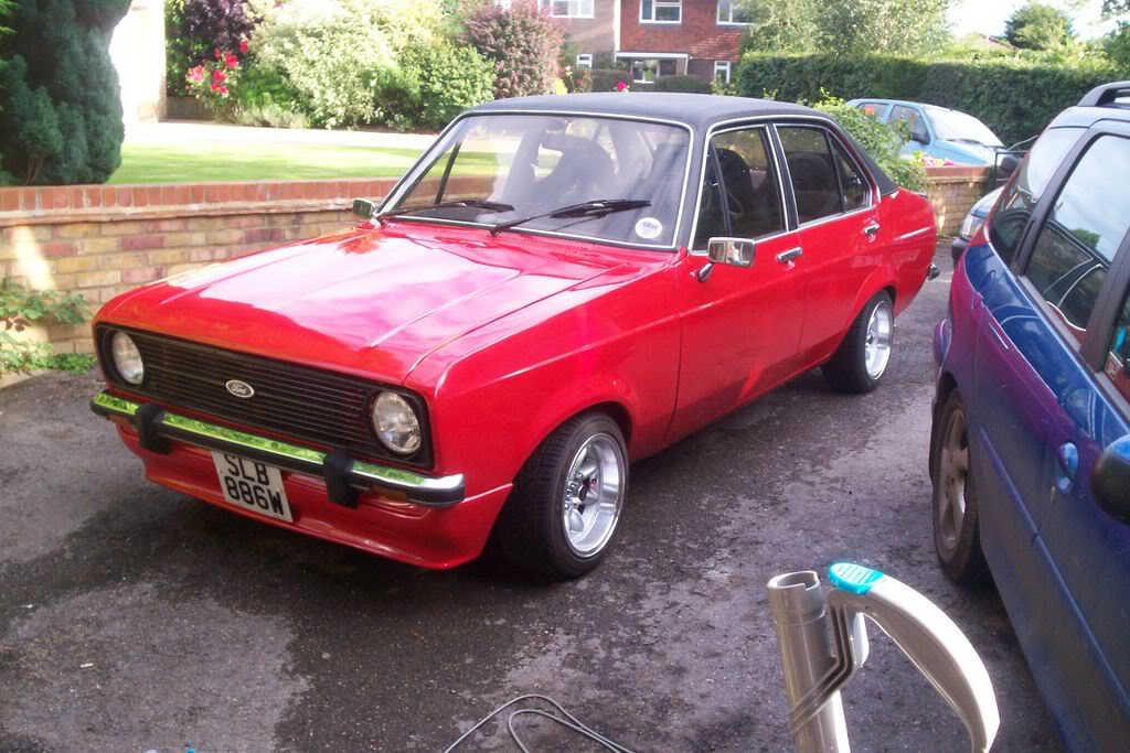

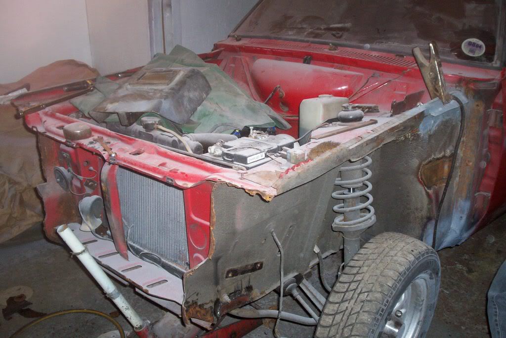

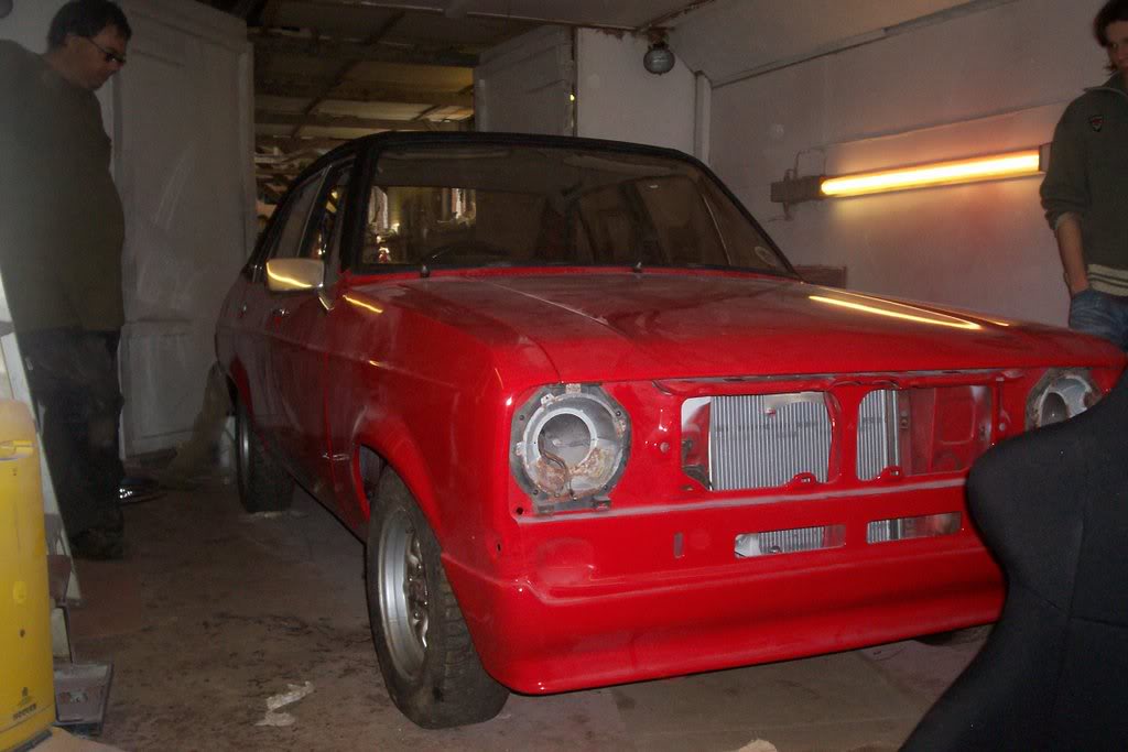

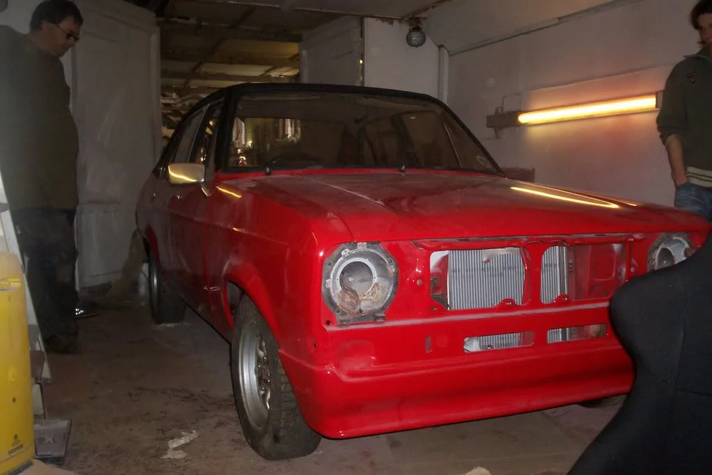

Quick Photo - Sums Up How my MK2 Escort got built...
Car  182 Trophy #333

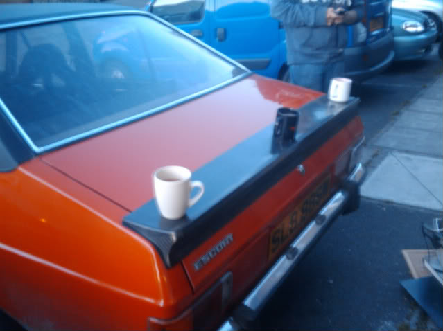

i think this is probably true for alot of projects......shed loads of tea!

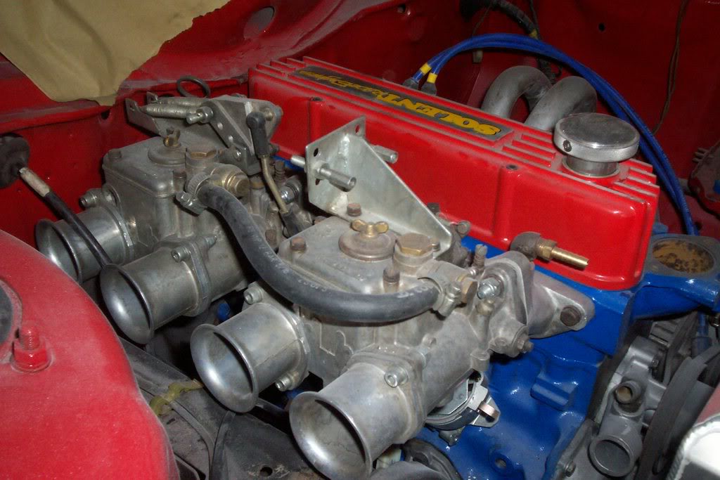

If you're gonna go 1600 you're probably better off with a 1600 x-flow, bore it out to a 1760 and stick a wild cam in there, its what mines running! If you're gonna go down the pinto route its 2.0/2.1/2.2/2.3 or nothing really!!

escort, they came in 1300 and 1600, the block on both is slightly different iirc, 1600 is a 711m block and can be bored out to about 1760, if youre lucky you can find a south african crossflow block, think theyre coded ***AX or something like that, they can almost go to 1980cc, theres a guy with one in a mk1 escort estate running low 13's!
