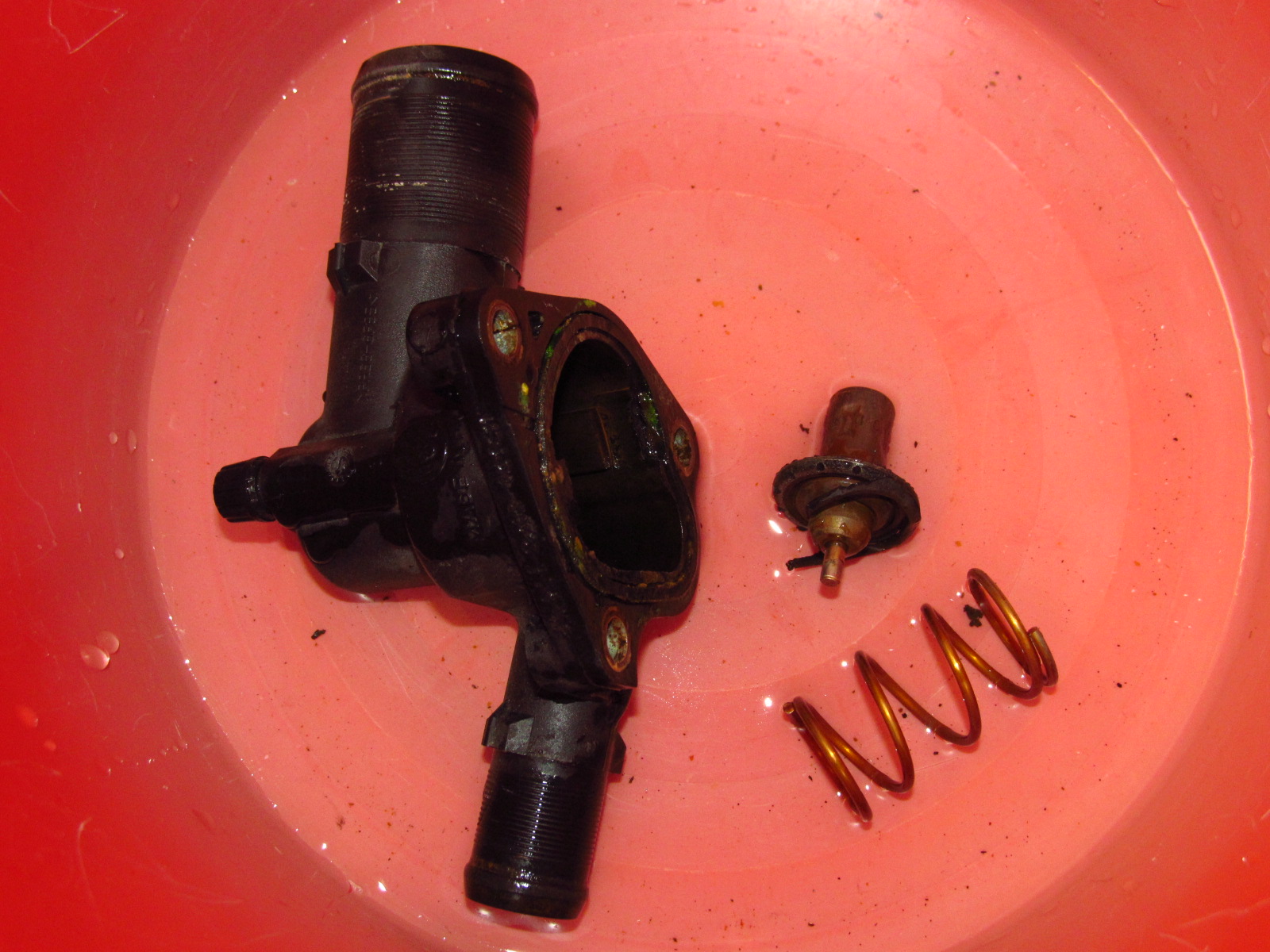

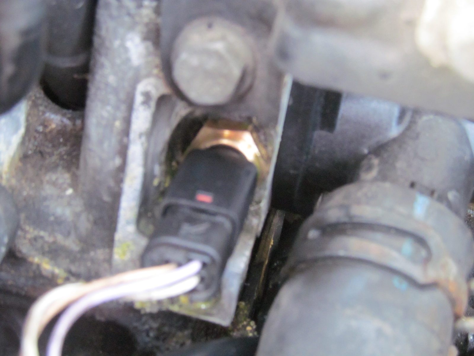

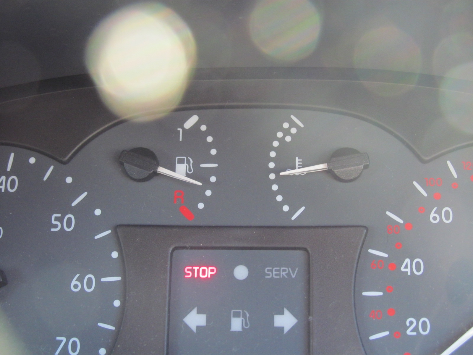

So My plan today was to change the thermostat and temp sensor as for a while the heater was only blowing cold and the temperature guage was showing that the car was not getting up to temperature. then a few days ago the temperature needle didn't move from the bottom that's why i was changing the sensor.
well i got the thermostat changed but i couldnt find the right sized socket to remove the sensor so i left that for another day. so i refilled the tank bled the thermostat and started the car for about 5 mins then put the rad cap on and ran it for 10mins at 2500rpm but the heaters never got hot. the rad fan kicked in after i stop revving it .
so i was wondering if the bad coolant sensor is causing the heater to still blow cold or do i likely have a bad heater matrix? im going to get a socket later and change the sensor at the weekend

One last thing when i put the old thermostat in a bucket of warm water it exploded lol

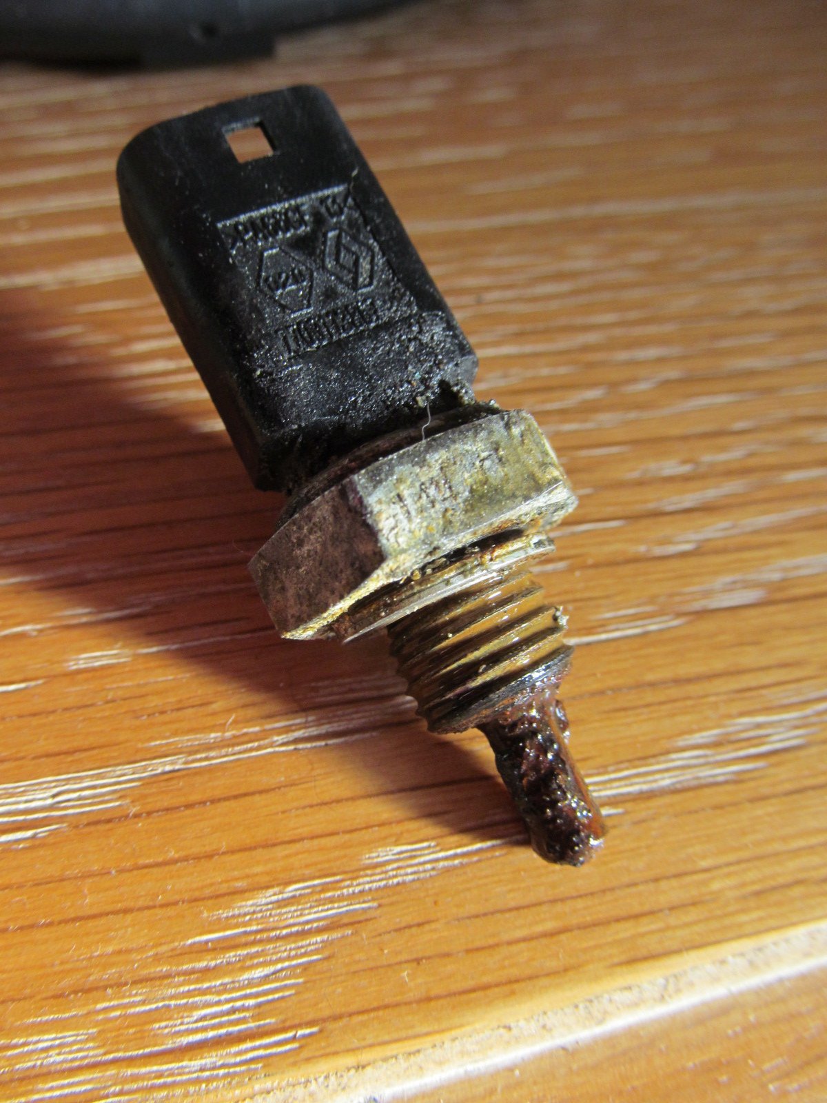

Got the new coolant sensor in today and it's working perfect but still blowing cold 😞
the old sensor was very cursty :poo:
