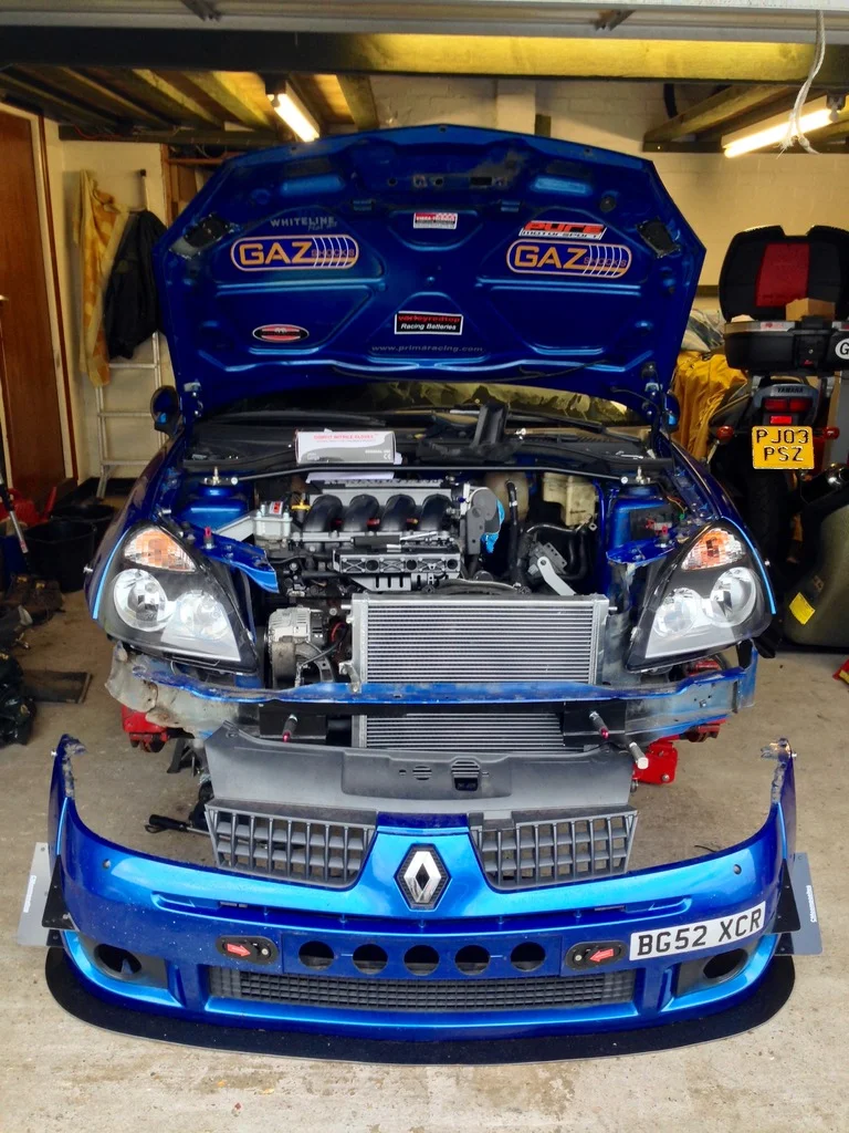

Like this (see below) not exactly under the headlights, but more central in the crash structure. Definitely possible
  Cup In bits
^^^^^^ I have the same but I put them behind the reg plate. You can put reg plate on with Velcro circles and nobody will see them.
Have you been pulled for your plate yet haimsey?
Chambers_RS
  Clio 172 Cup&Leon K1
The pic above is my car :)
Only reason I put the catches in the middle was because its had knock on the offside and crumpled the corner of the crash bar slightly so I can't get areo catches in the normal place lol
If you look just below the headlights your see what I mean.
Also the holes Where already in the crash bar to fix the thread bar/pin to.
Regards to the number plate, the car hasn't seen the road since I fitted it lol

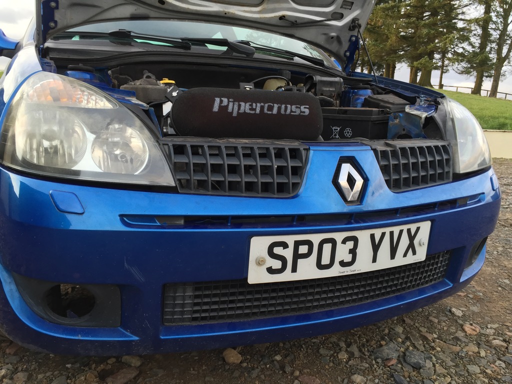

@haimsey Did you remove the reinforcement from behind the bumper when cutting the cooling holes and removing weight?
If yes, how do you remove the reinforcement please?
haimsey
  ph2 172
The above image isn’t my car, I have however cut holes through my bumper, I just cut through the reinforcing part also. It’s a bit messy from behind, but you can’t see that bit...
VenomUK
  Clio 172
That’s all I needed to know if people are just going through it or actually removing it all before hand?
haimsey
  ph2 172
There must be a way to fully remove it, but the bumper will be floppy. I never thought about taking it off completely, just removed some material to make it functional enough to get some more cold air in (but then put the reg back on for road use)
VenomUK
  Clio 172
I was going to go down the quick latch route 1 either side and 1 either side of the number plate which should keep the flex to a min. I will have another look on the weekend or just do your proven method of removing material out to ensure clear flow
