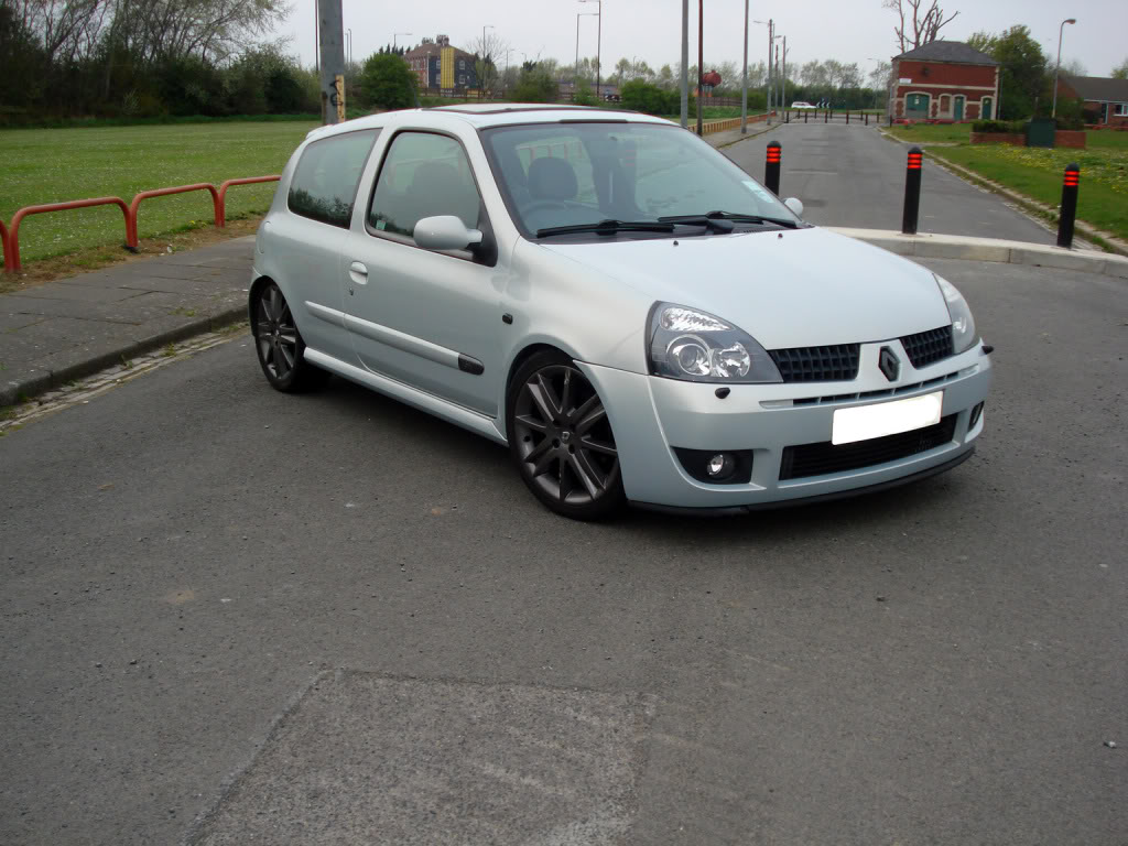

Hi guys, I want to put renault nervasport r17wheels on my clio. I dont know if they will fitts Into fenders when i turn....are there somebody who got experiences with it?thx..
They will fit but you'll need low profile tyres (205/40/17) otherwise they won't fit, and spacers just to make them look good.
