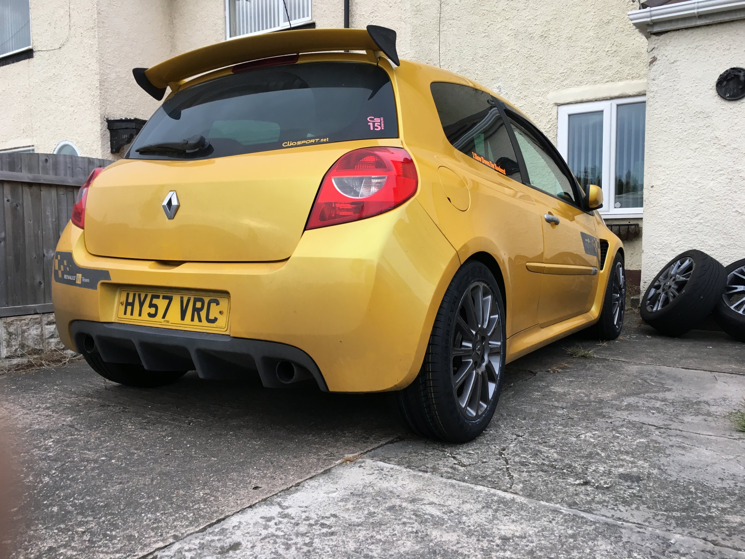

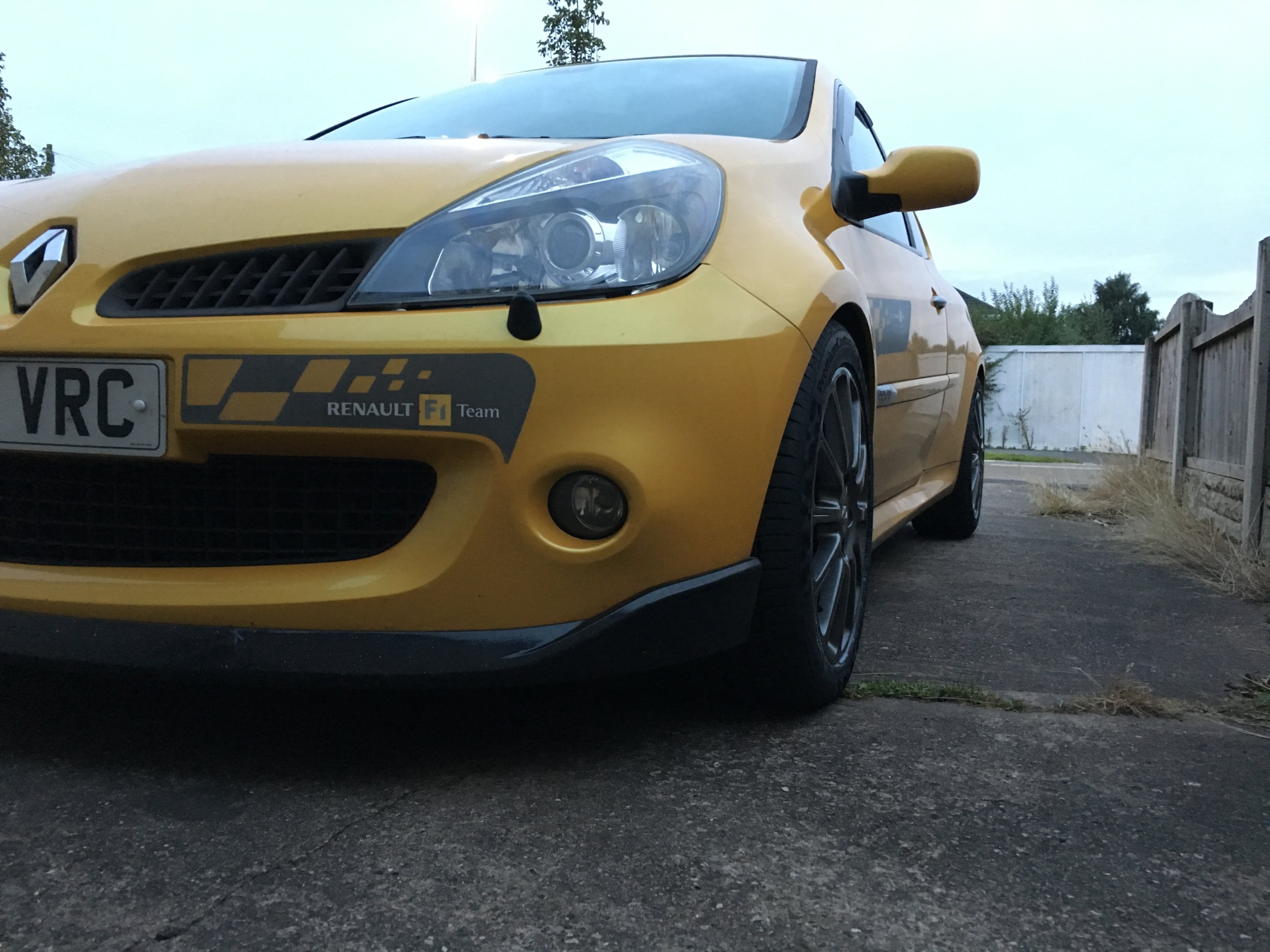

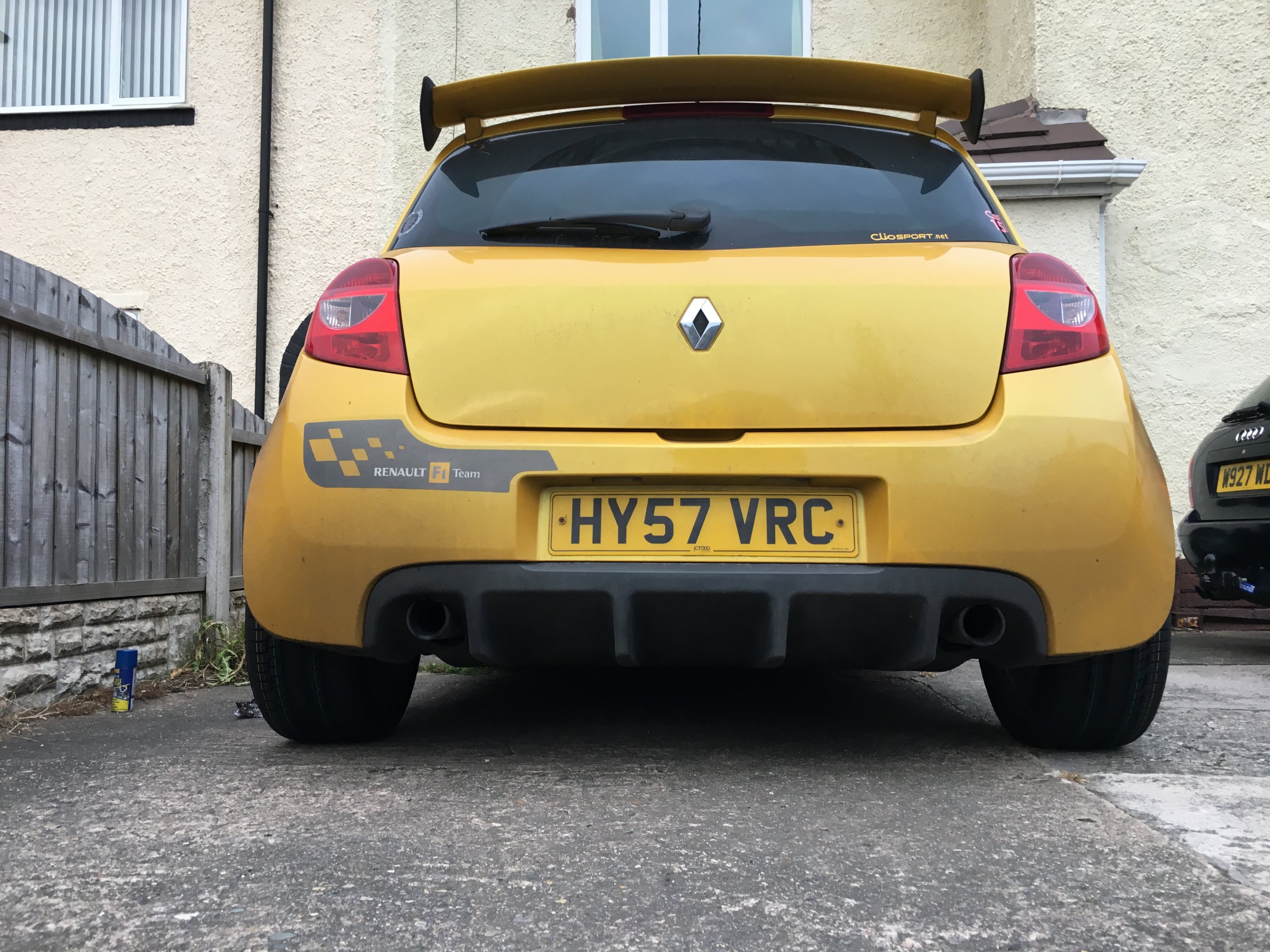

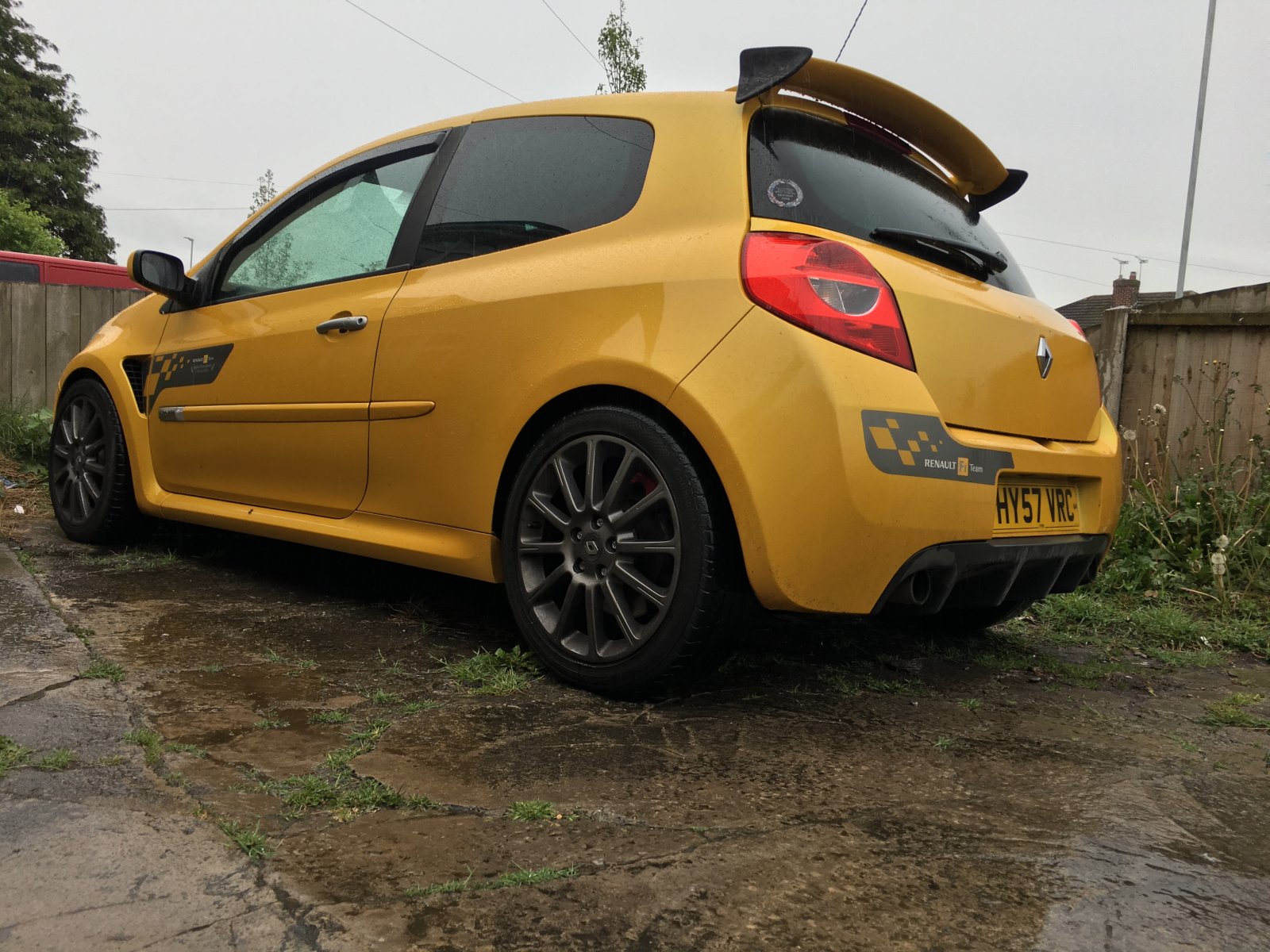

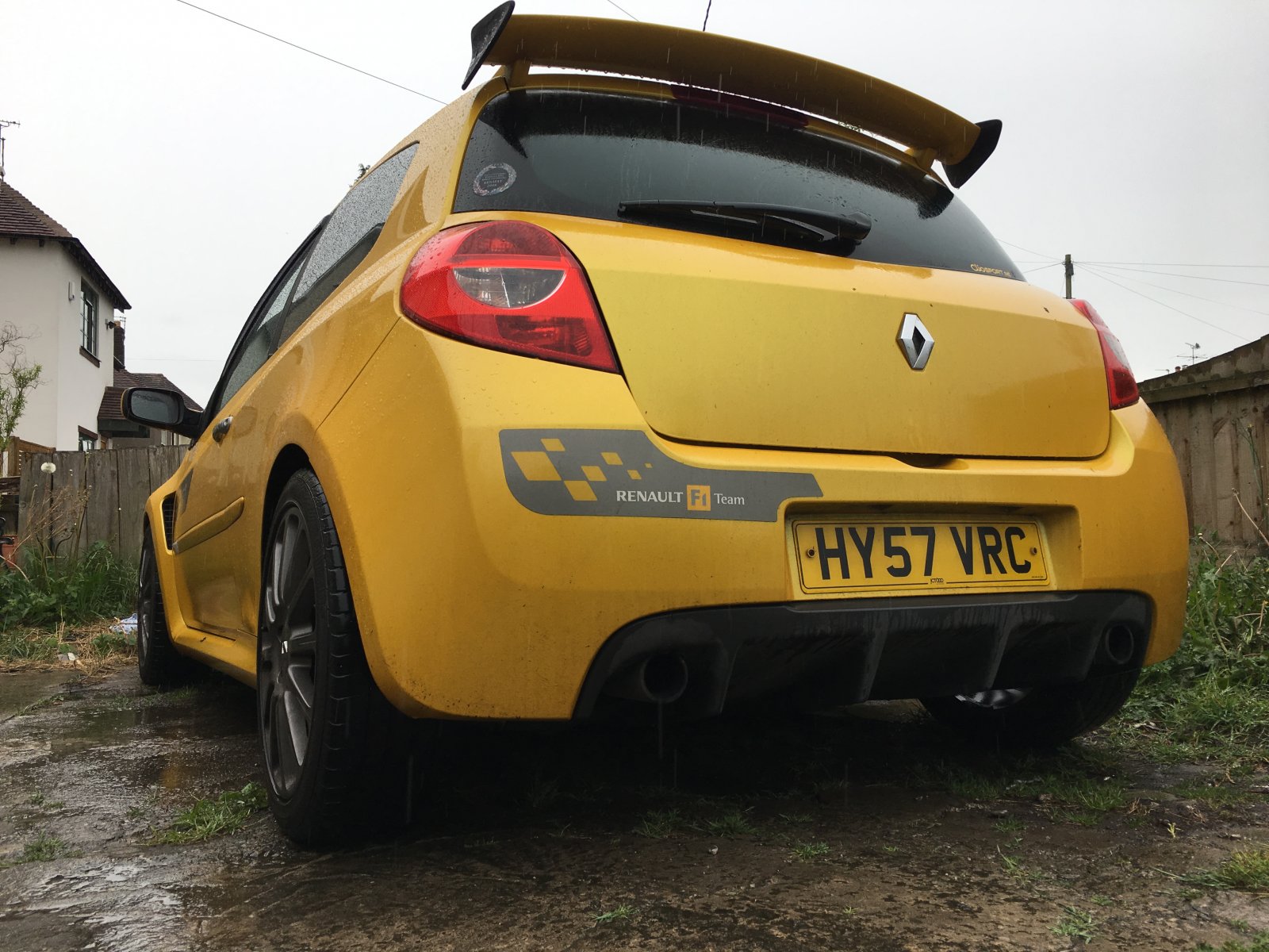

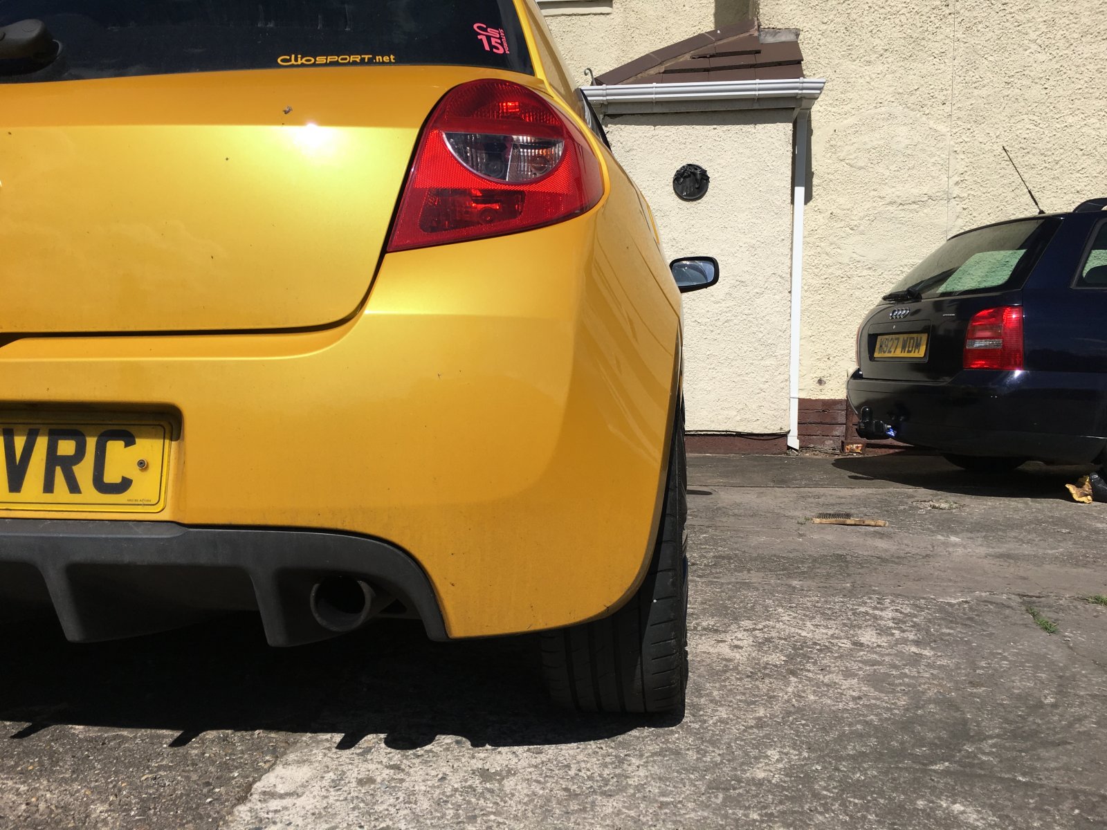

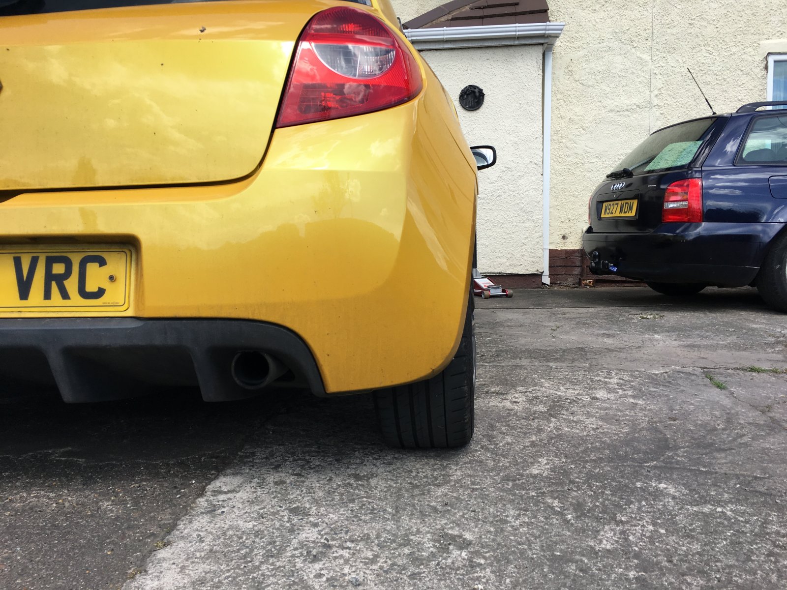

So, after the last few messages, I bought spacers.
20mm hubcentric bolt through types. Not what I wanted exactly but hey ho.
Obligatory pics
I think it could do with another 5-10mm but it's a subtle improvement.
It should look mega with the speed lines and chunky tyres one.
welshname
I wouldn't say you needed any more than 20mm. I ran ktec 19mm ones and they were perfect. Loved the stance and never had a single moment of rubbing or anything.
Sent from my Nexus 6P using Tapatalk
Knuckles
ClioSport Admin
Yeah, I like it
It looks just the right amount of wide without being full blown racecar/scene stance.
Seems to tramline on bad roads and it feels a bit wider on the road, but otherwise it's no different handling wise. Its probably a placebo but an extra width is noticeable from the drivers seat.

I felt it tramlined and felt nurvous under braking
Hacked mine off after a day 😂

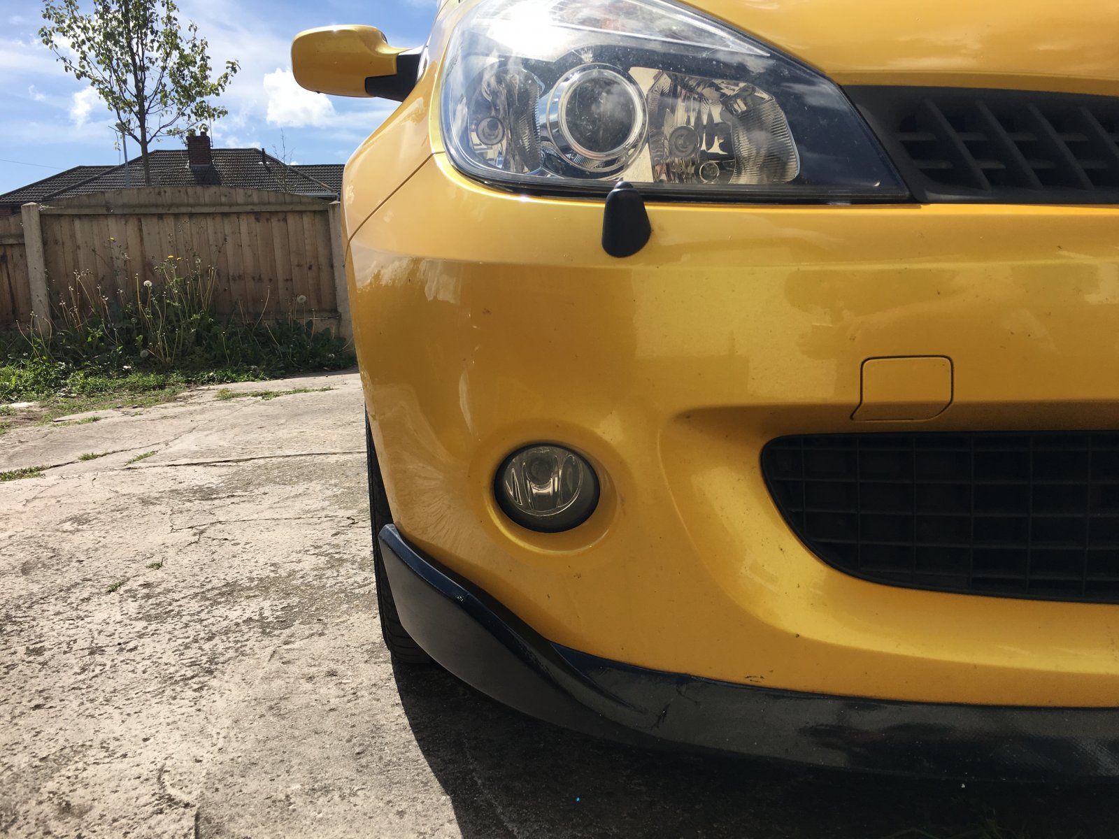

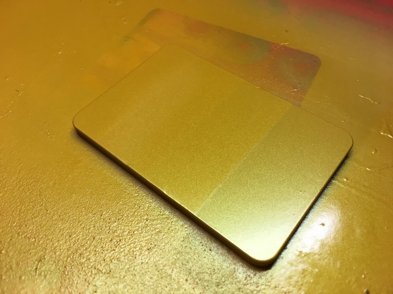

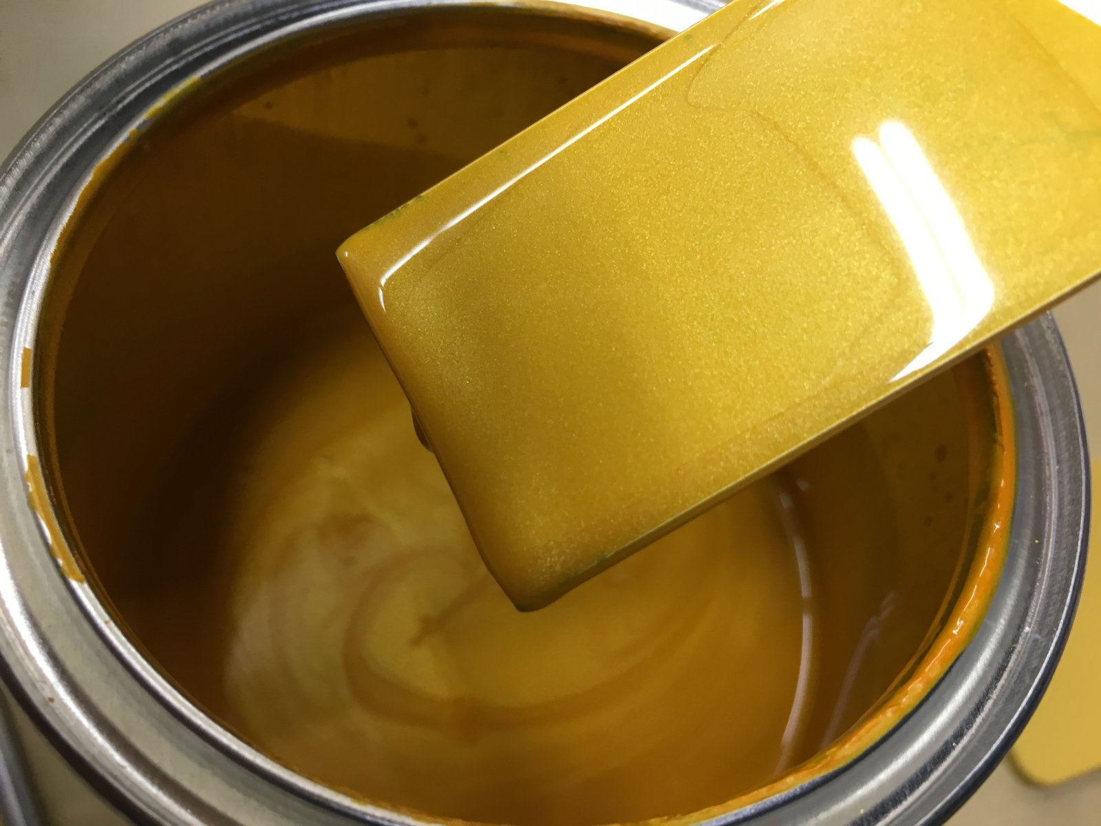

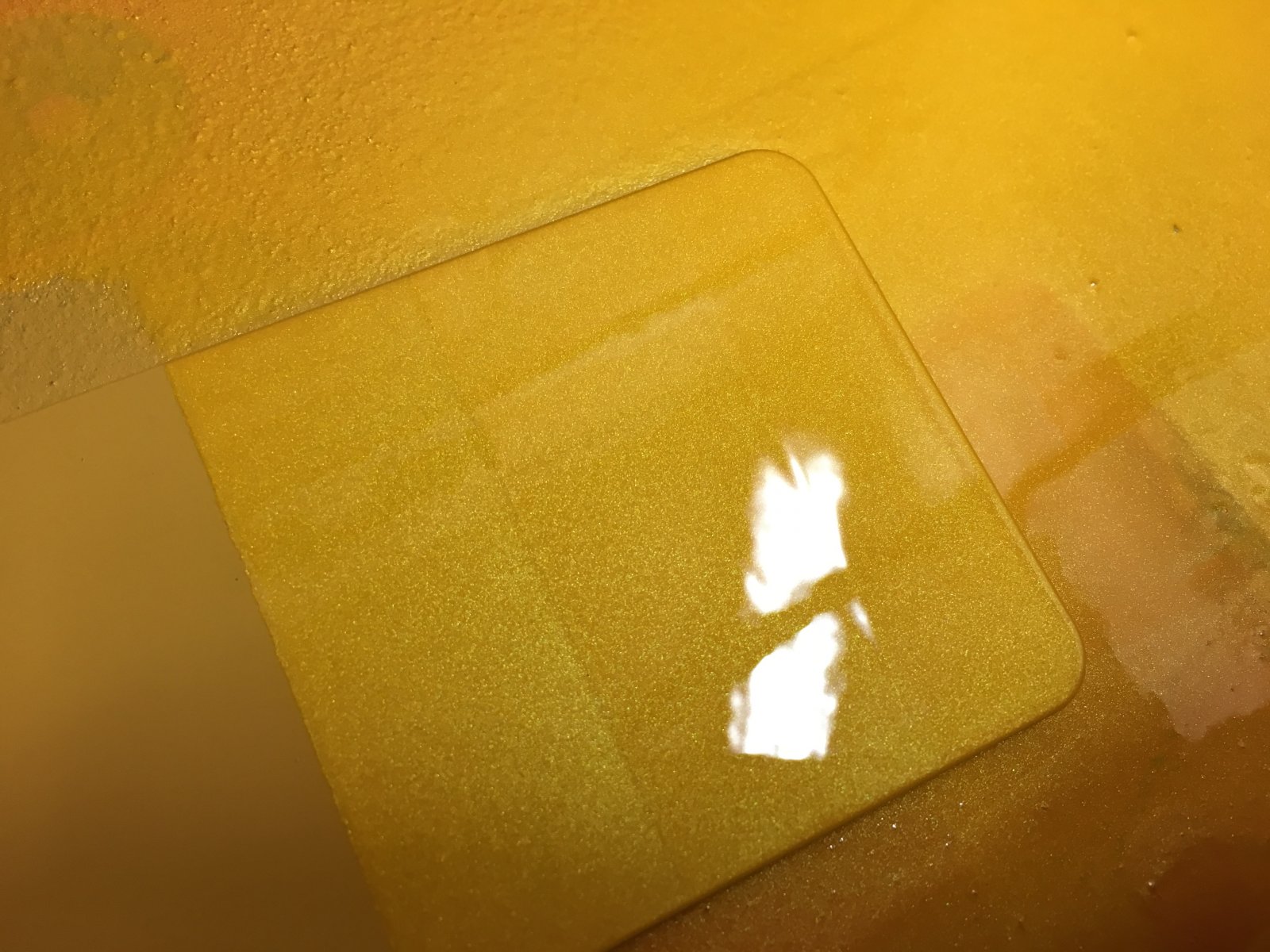

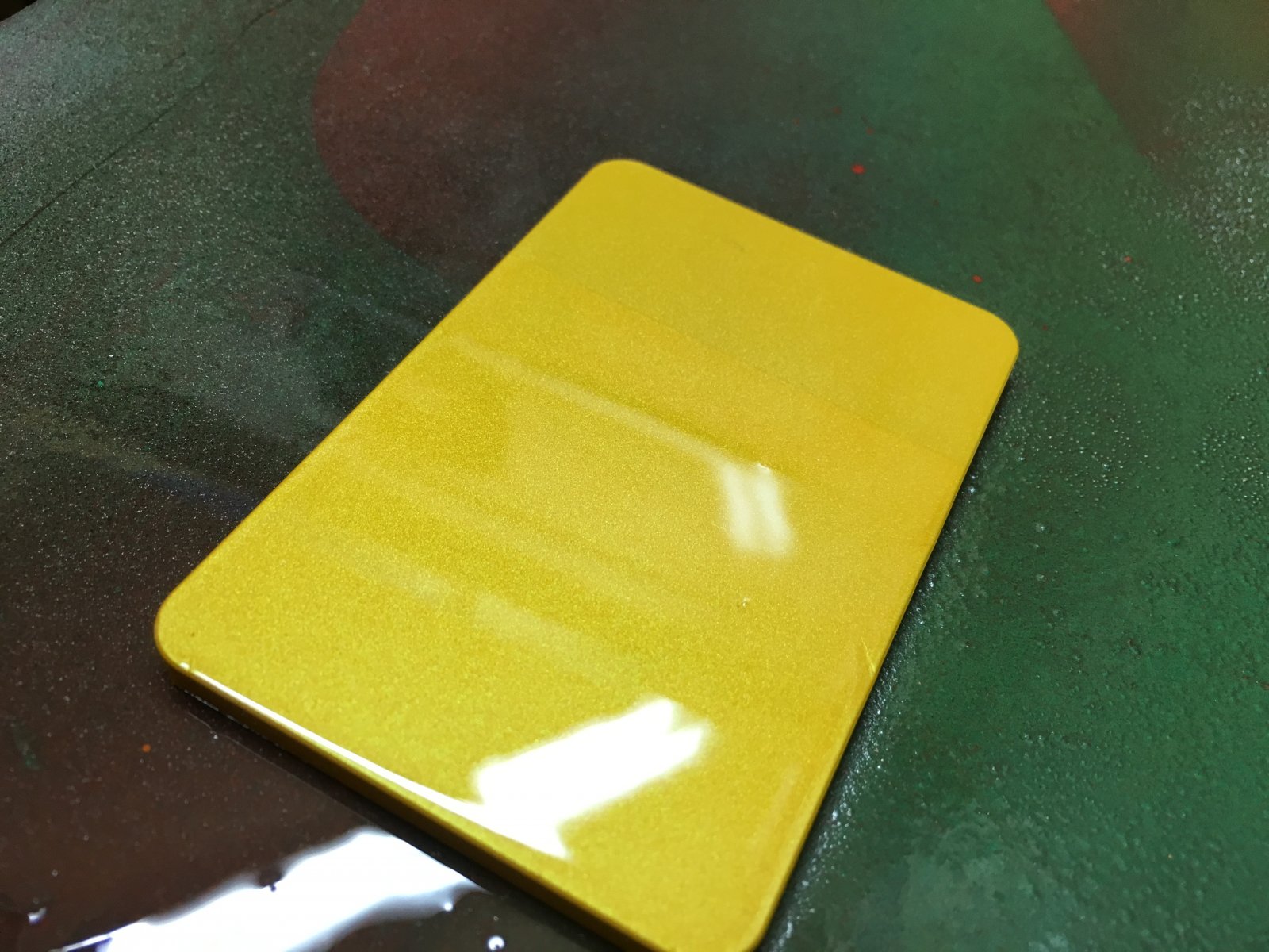

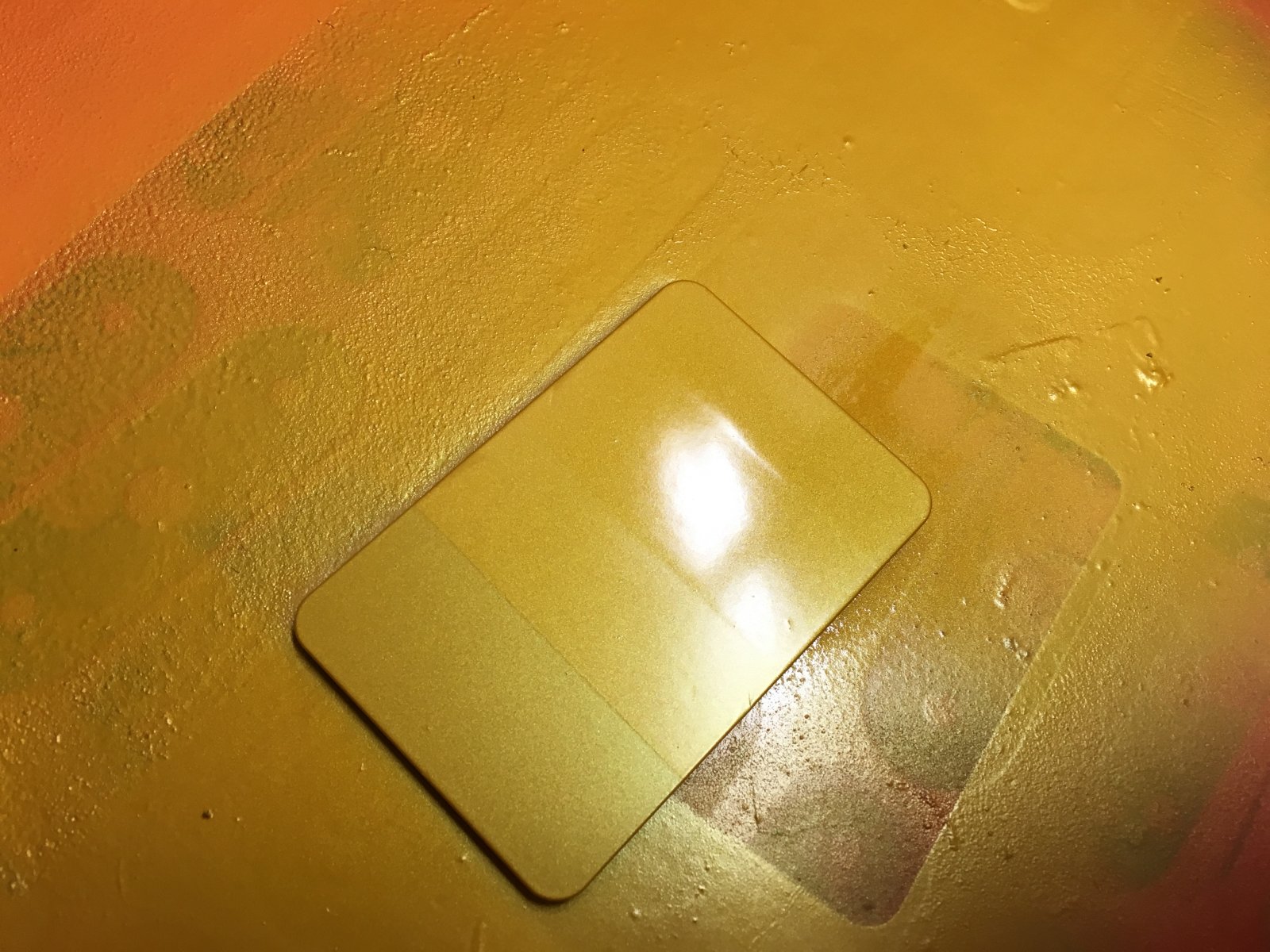

So I bought some yellow paint yesterday.
A stone chip turned to peeling paint on my spoiler, so I thought I'd make a test piece to see how many pear layers I need to match my car

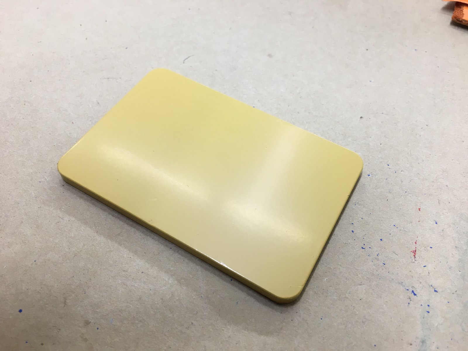

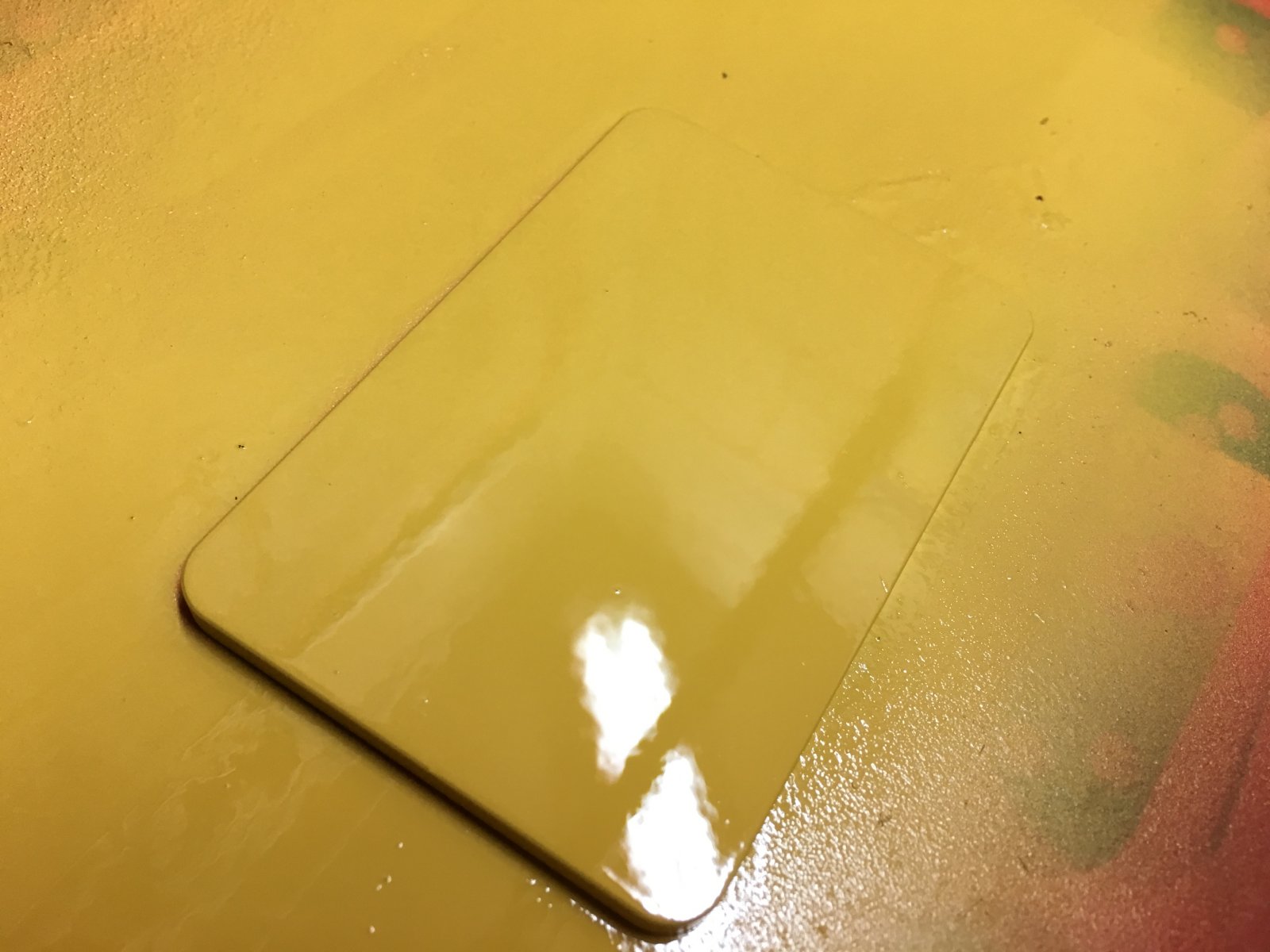

Base coat
It's a nasty mustard colour when it's dry
Mmmmmmmm

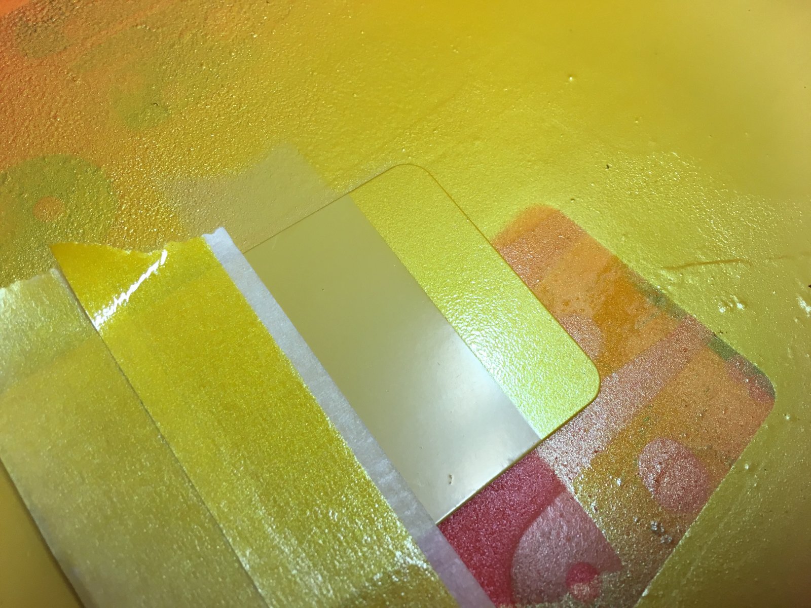

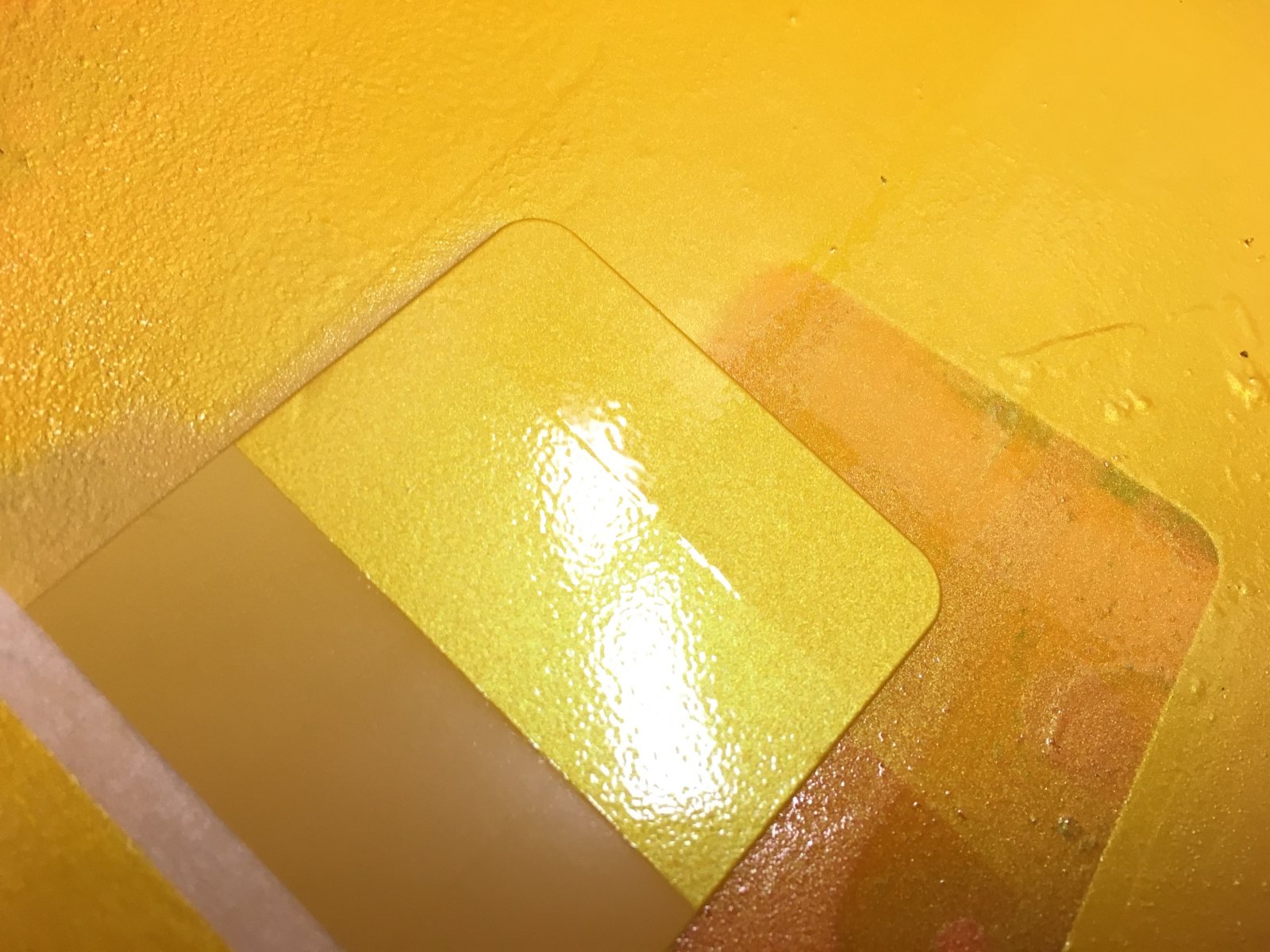

First coat
Second coat
Third coat
Fourth coat
For those that don't know. The idea is to apply a coat, remove a strip of tape, add another coat, remove another strip and so on until you've built up the desired amount of layers.
The different amount of layers on pear coats changes the colour of the finish as you can see below.
I'll let this dry and clear coat it on the weekend to properly match the finish then offer it up to the car to see which is the best match.

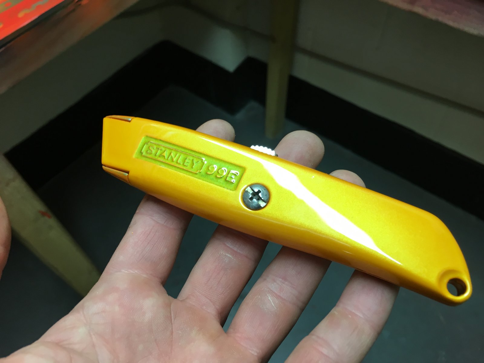

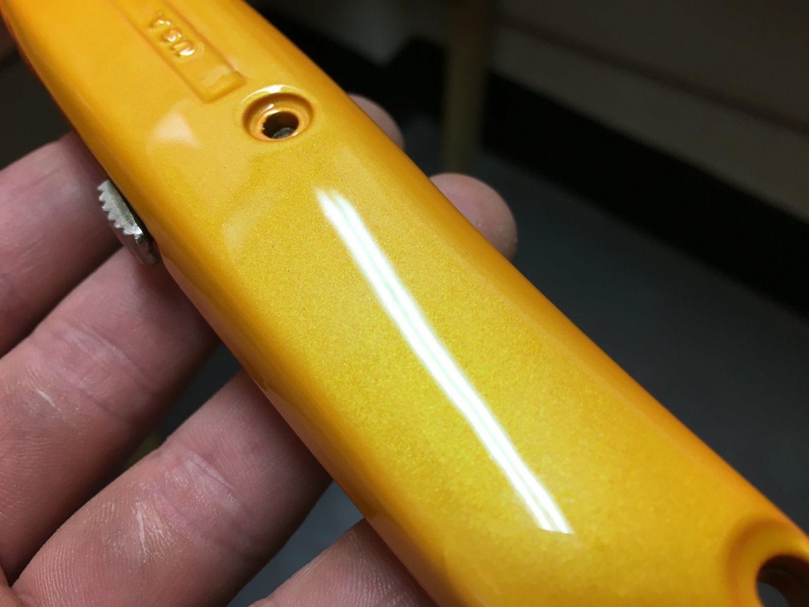

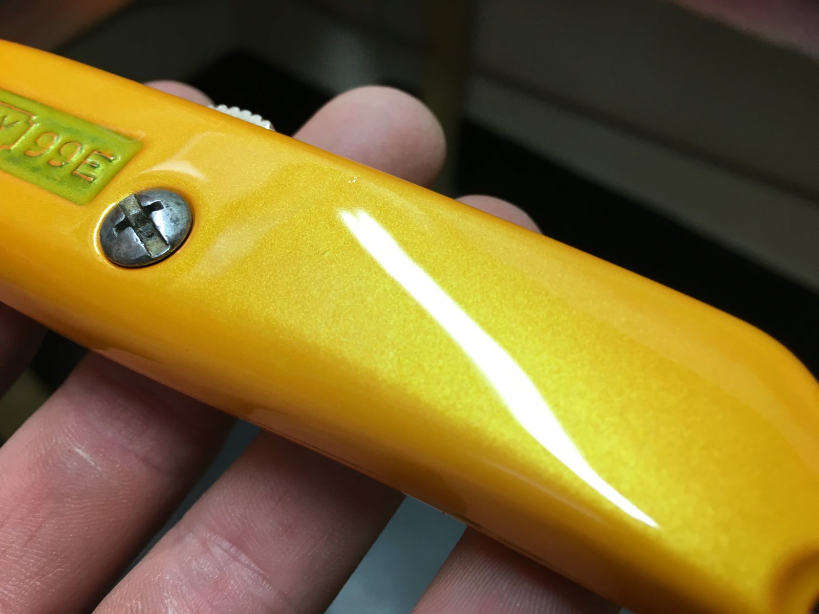

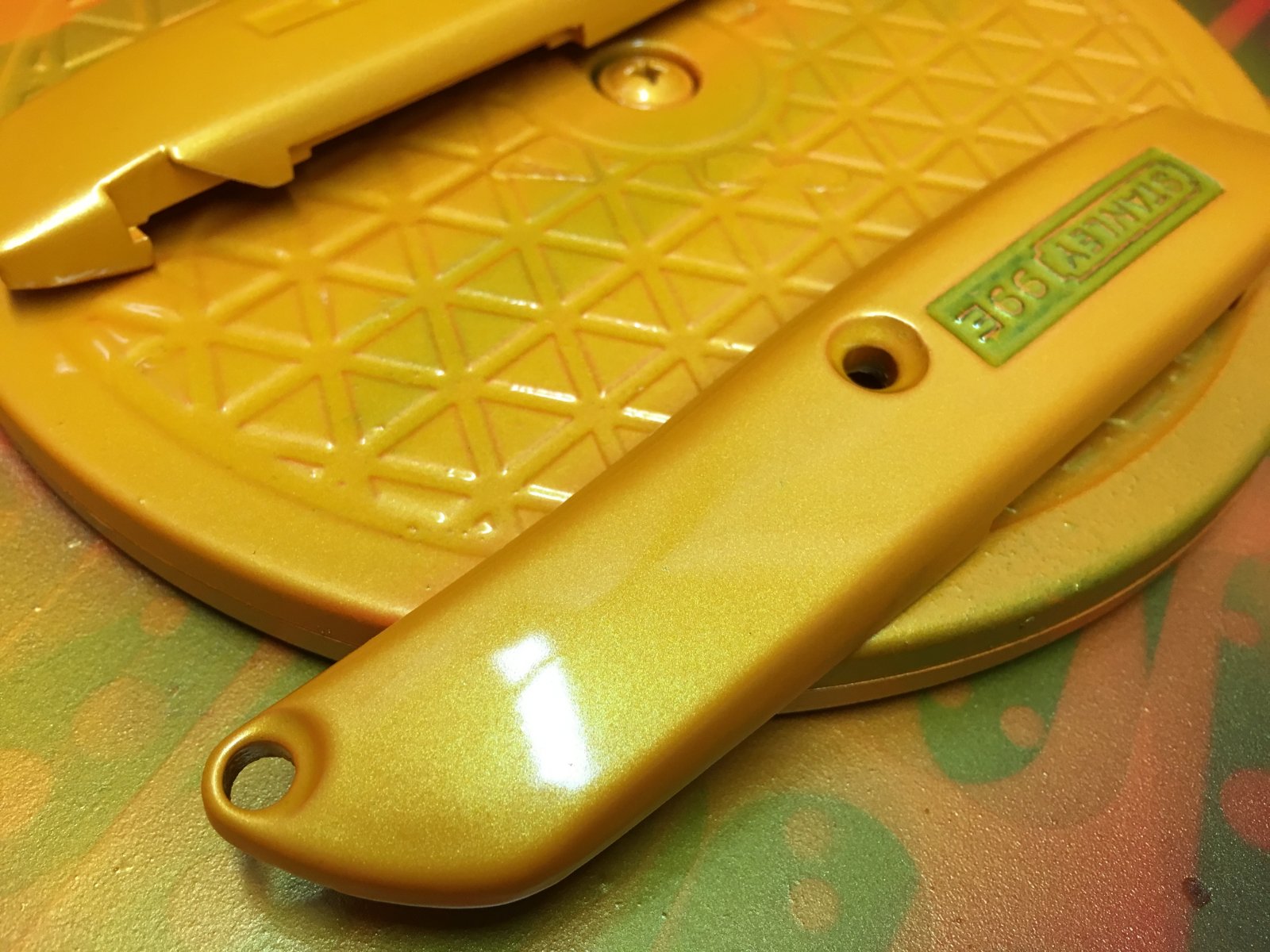

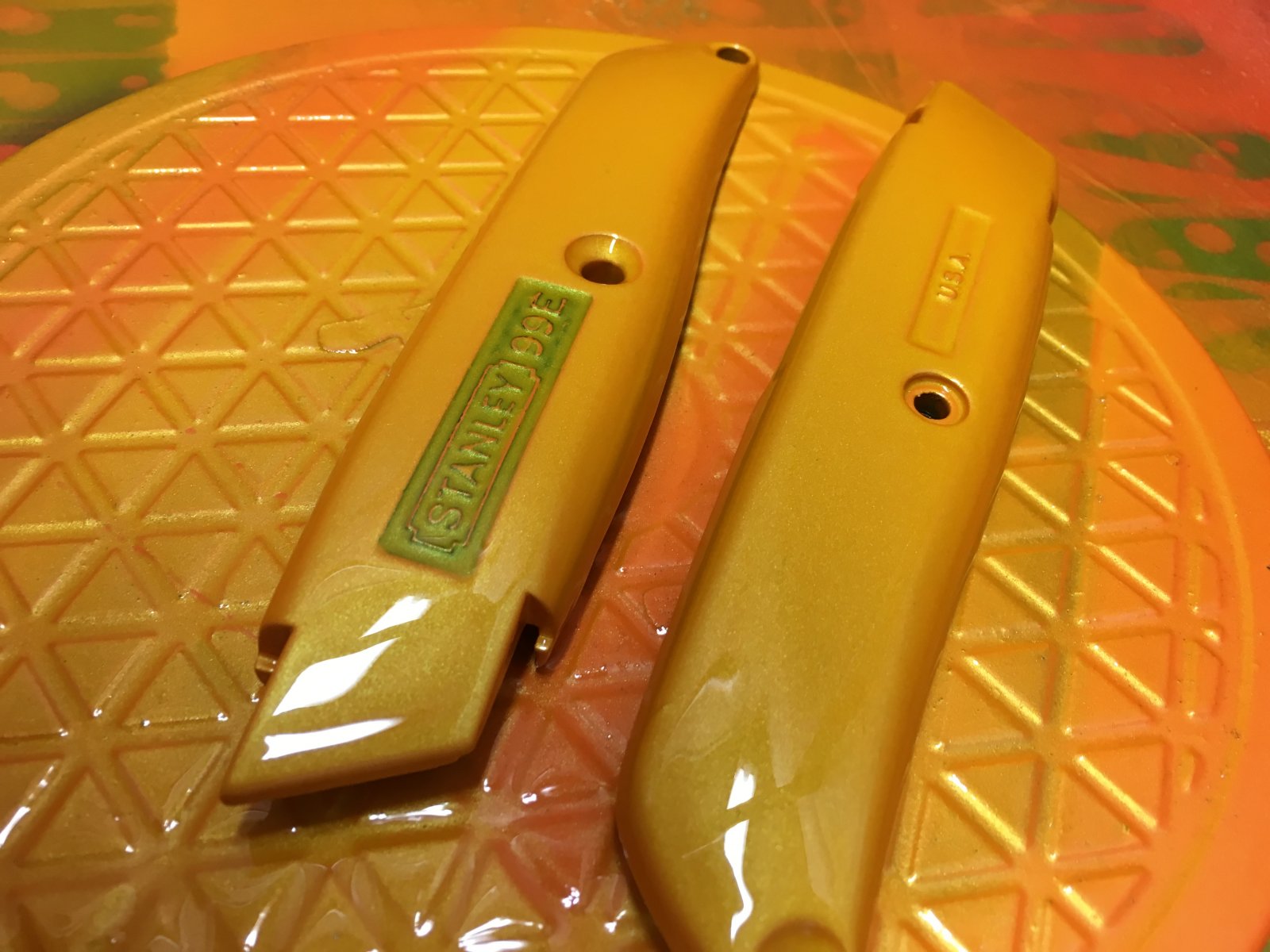

And I made too much paint so now I have a liquid yellow Stanley knife.

[emoji23] I want a ly stanley knife now. Wherw did you get the paint from mate?
Lol! It's not actually proper liquid yellow as I sprayed the pearl coat over what looks like a focus st orange base.
It does look cool though

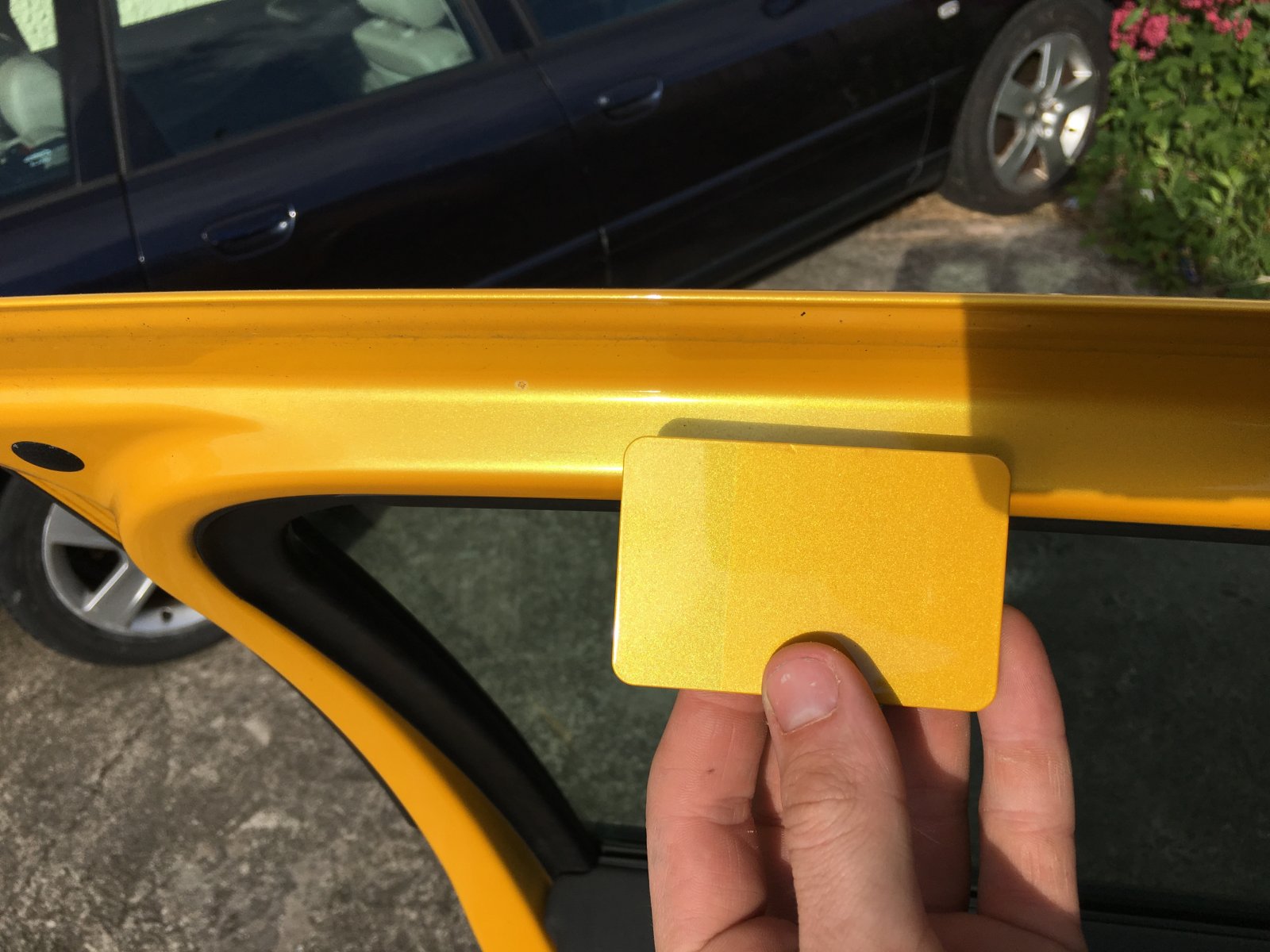

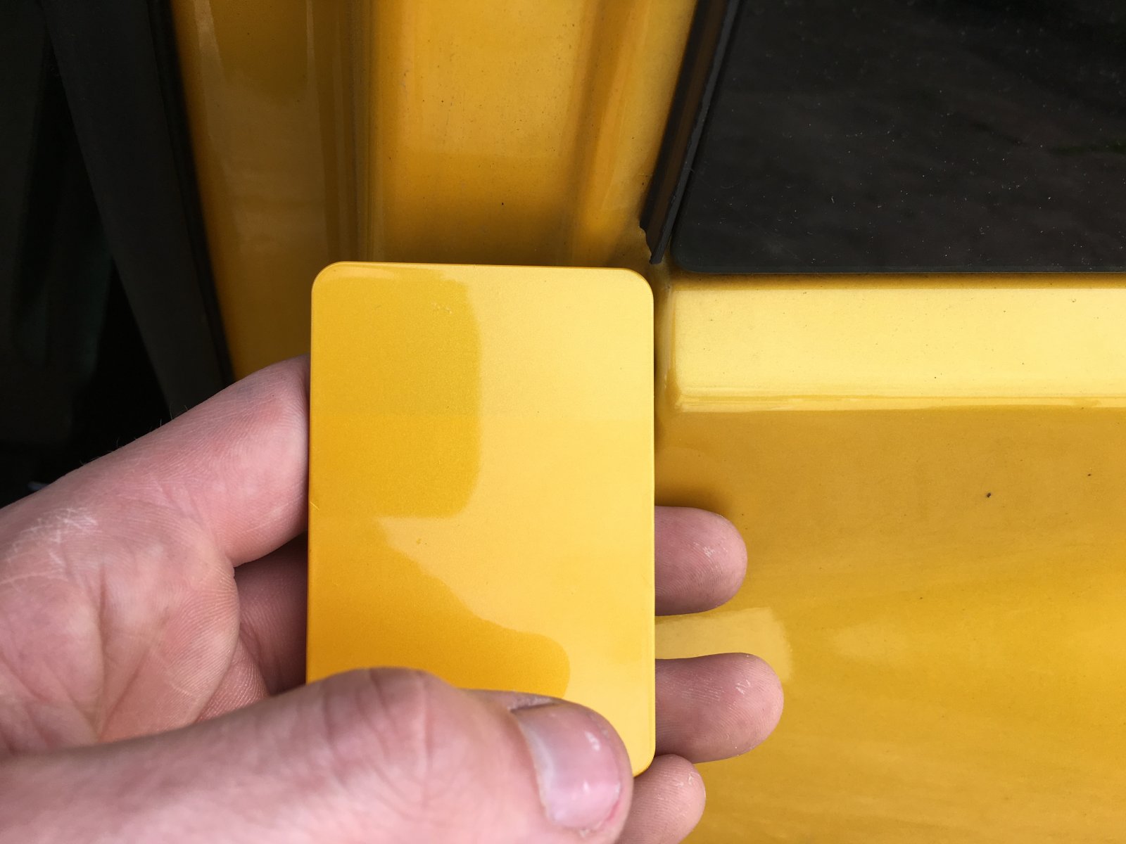

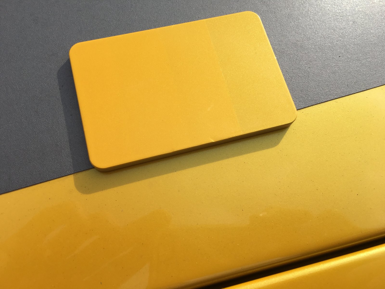

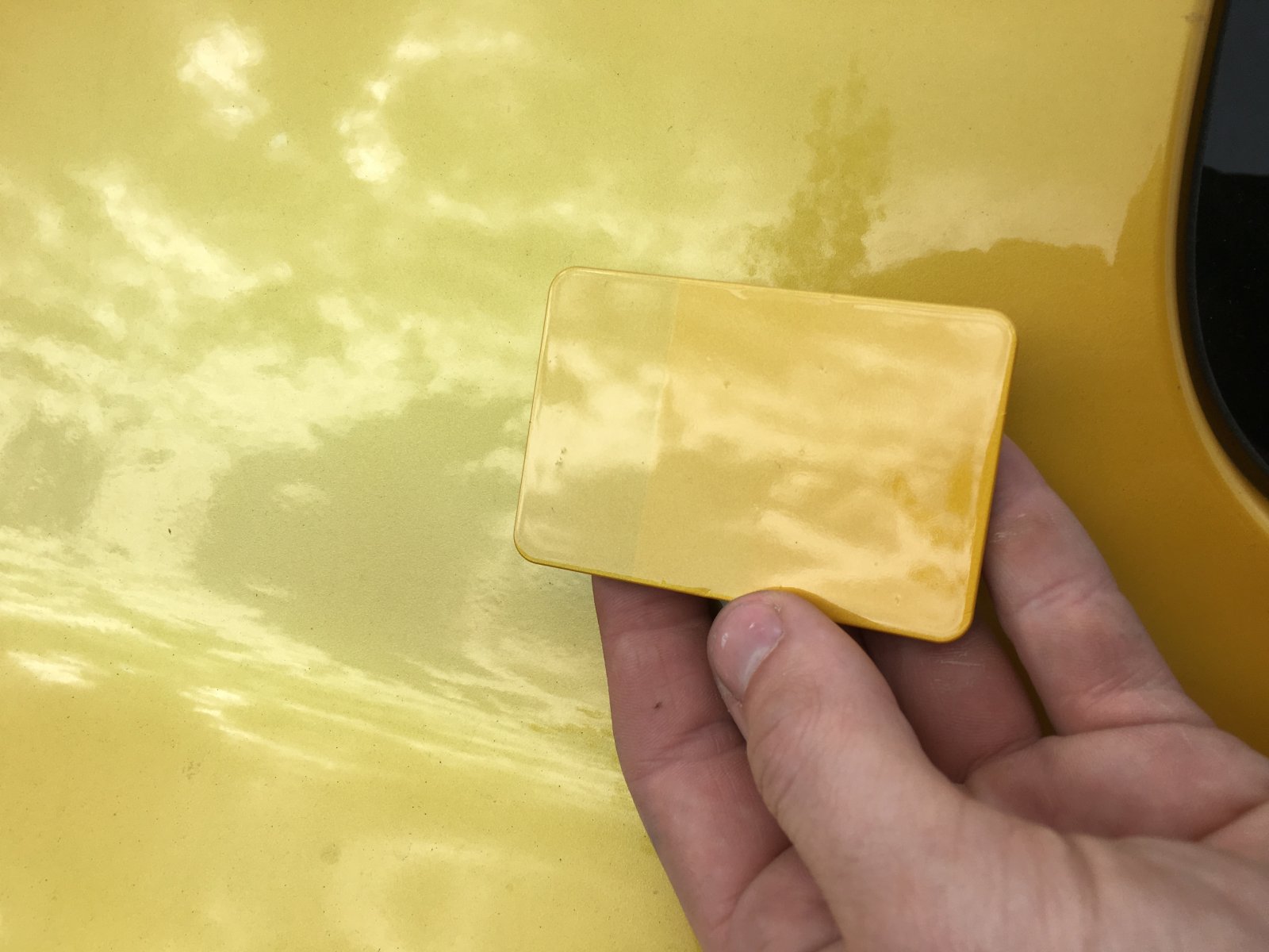

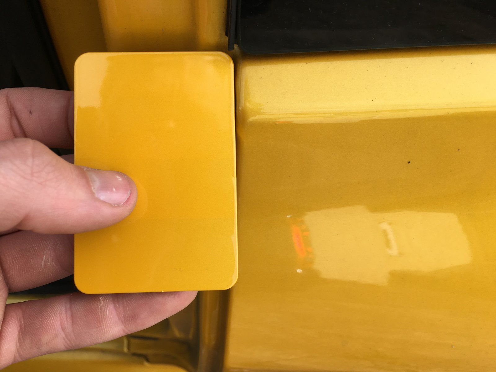

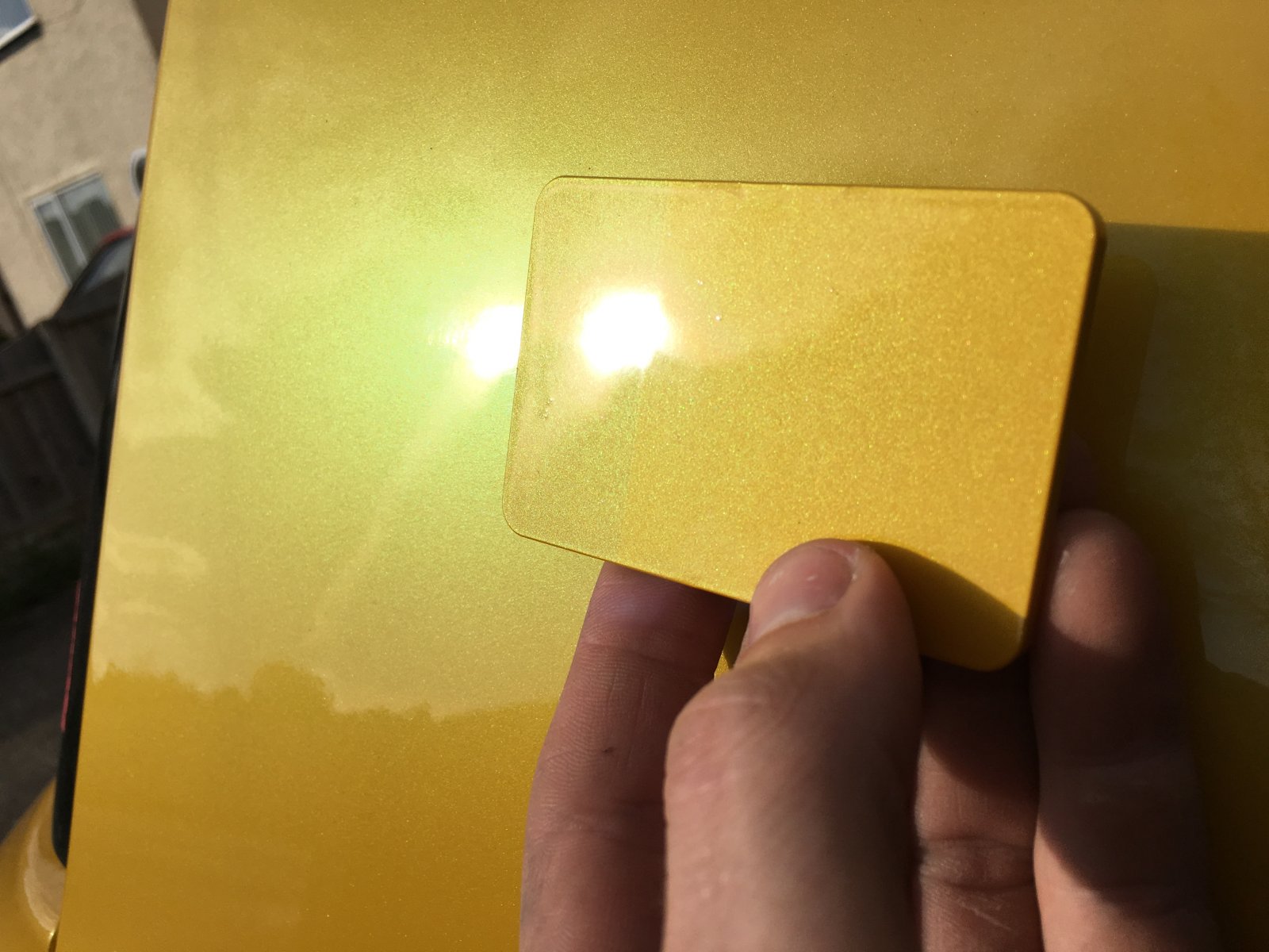

Anywho, the colour match looks good. It looks better in the sun, I'll try and catch it later if it comes back out.
It looks like only one pearl coat will be the best match. I didn't expect that to be honest
That probably explains why my car looks different to other yellow clios/meganes.
Ah well. Now to clean the car, get the spoiler off and paint it.

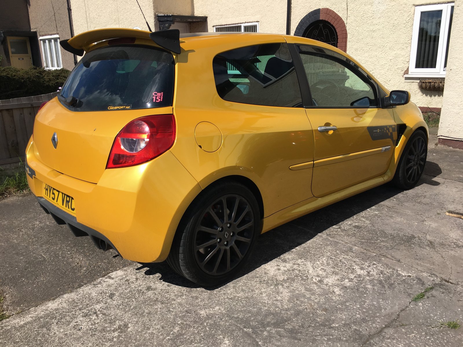

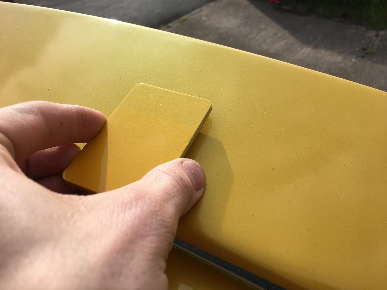

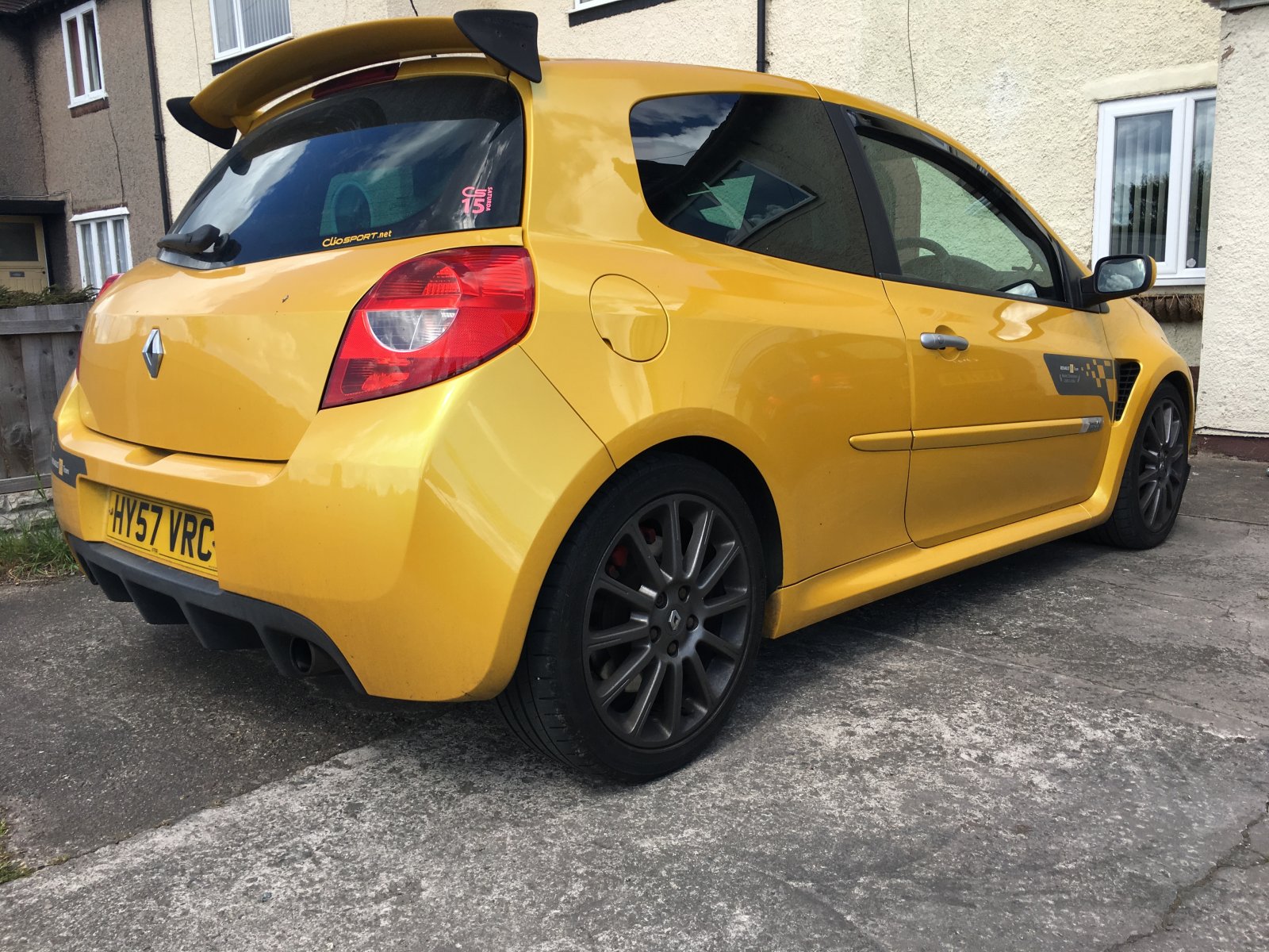

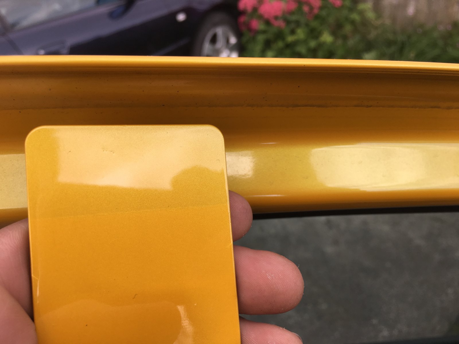

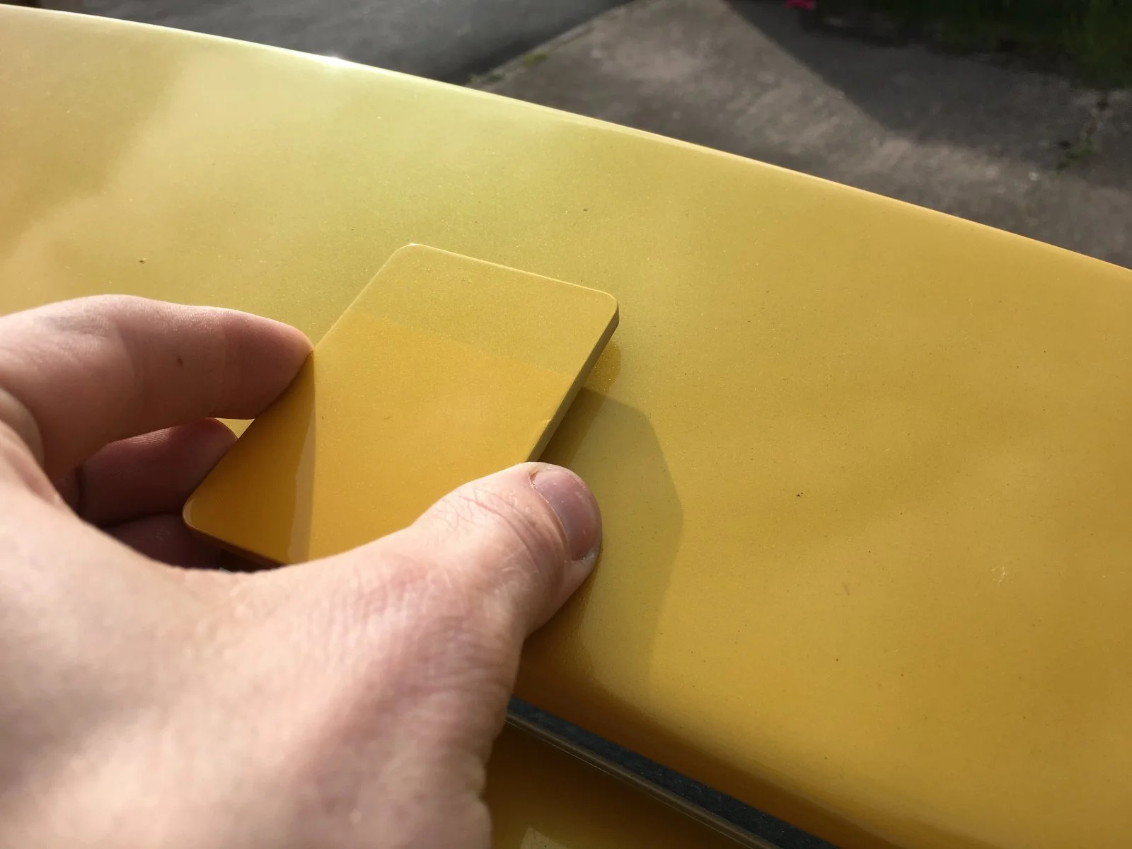

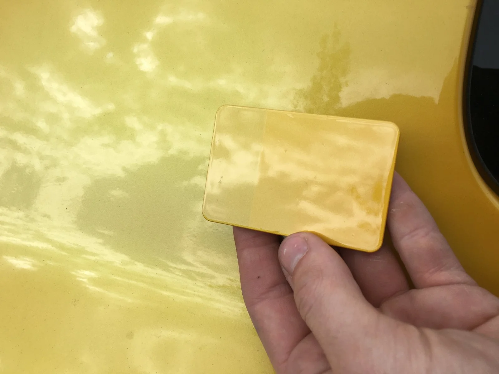

Got some pictures in the sun. What a pita it is to picture the test panel at the same angle as the car!
But yeah, one coat of pearl is the best match (one coat is the lightest one)
One coat at the top, against the bottom of the window
Four coats at the top, against the bottom of the window.

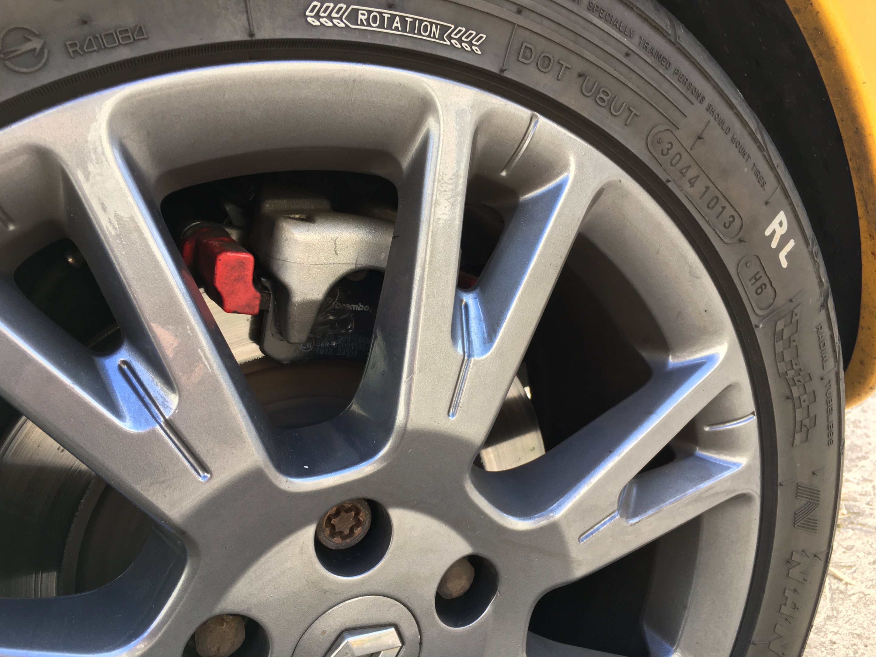

I left for csf at Blyton on Thursday at dinner time. At 10am, my car was on the ramps in the garage opposite work with the rear wheels, calipers, pads and handbrake cables on the floor. Joy.
I asked the garage to strip, grease and refit my rear calipers, because they started binding a couple of days before I was due to leave.
They came back and said the calipers were fubar'd and I needed new ones. Joy.
So a lot of money later, I had mismatched calipers. To add insult to injury, the garage didn't bleed them properly so me, @MartinL1993 and @Gus bled my brakes with @Alistair14 s jack and stand (thank you all) by the track the night before csf while @.Joe fucked around in my cars brain.
So now I have another job to do on the car, colour coding these 😧

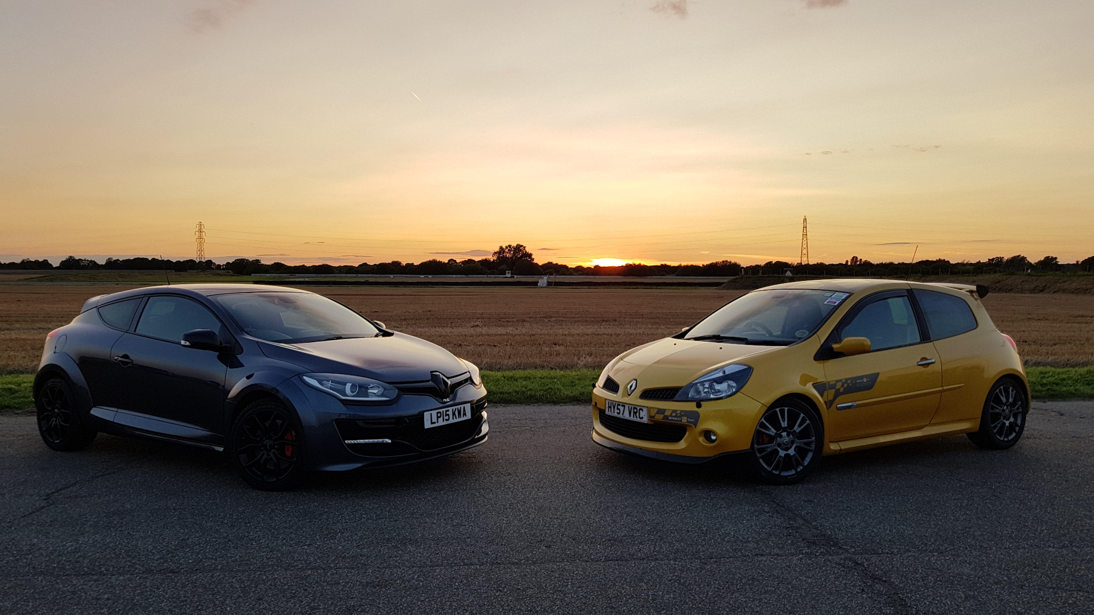

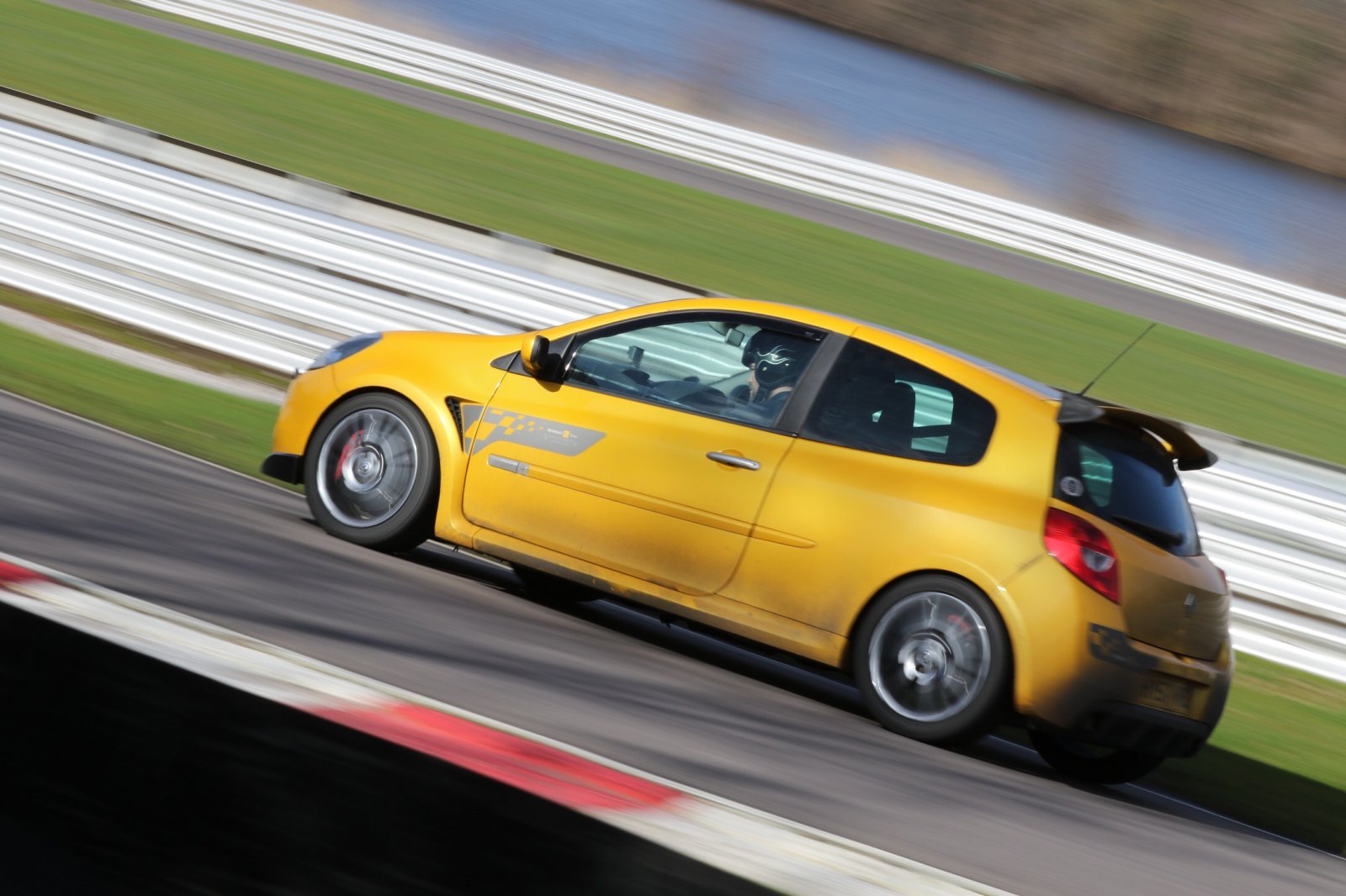

Apart from that, the car was flawless again at Blyton, I finally managed to get it to not push wide, feeling like a proper rally driver by keeping the throttle open and keeping the nose under control with the brake. All while getting passed by faster drivers lol

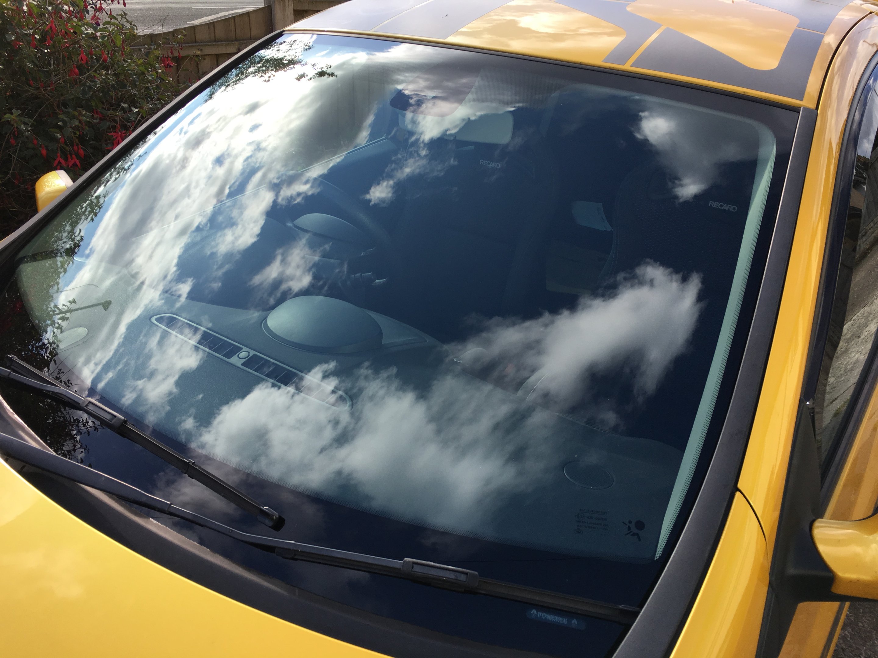

Aaand I Drove home from work the other day and found a massive crack down my windscreen, so had a new one fitted today. It'd be rude not to get new wipers to go with it.
Bloody cars
MartinL1993
Oh god that's poor luck with the windscreen mate! Did that start as the little chop or another one appear?

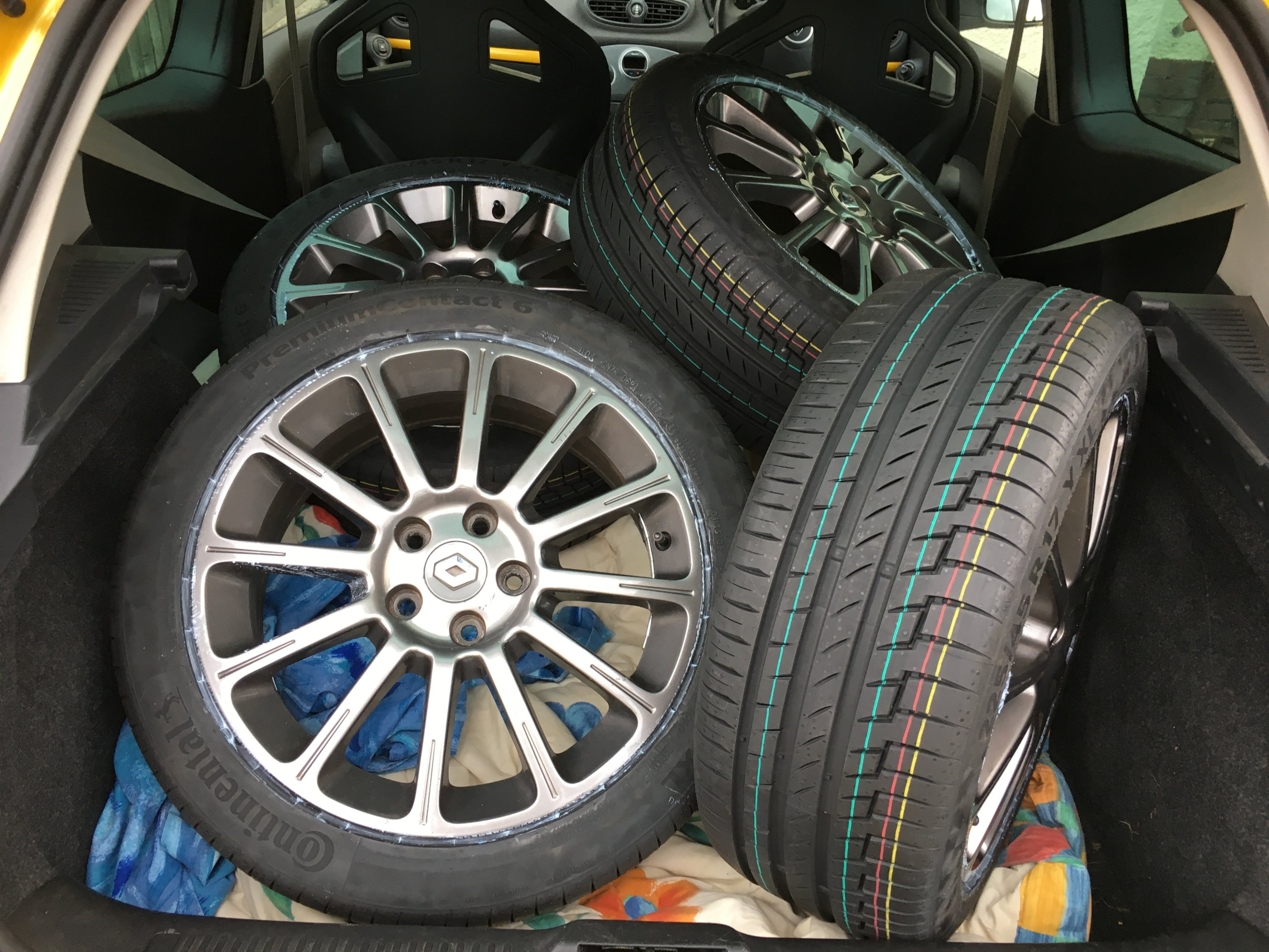

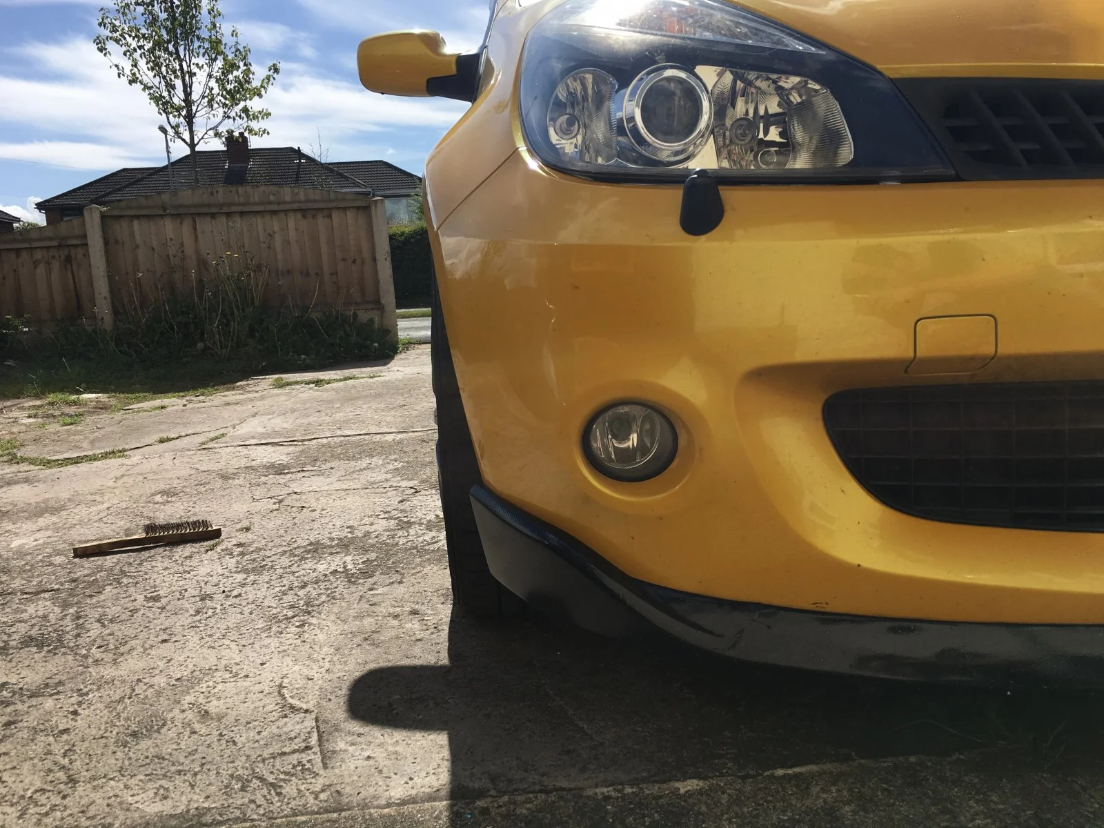

Small update. The sport contact 3s were coming to the end of their life so after a bit of reading I settled on continental premium contact 6. They supersede the premium contact 5 and sport contact 5, merging to two to sit at the top of the range continental up to 18" the sport contact 6 starts at 19" :(
Nice chunky shoulders
I do love chunky tyres. I went for 225 over the standard 215 to fill the arch better and get a slightly bigger footprint
I took them for a quick drive to scrub them in and first impressions are very good... in the dry. They seem to bite well on turn it and skip around in quick direction changes just the right amount.
