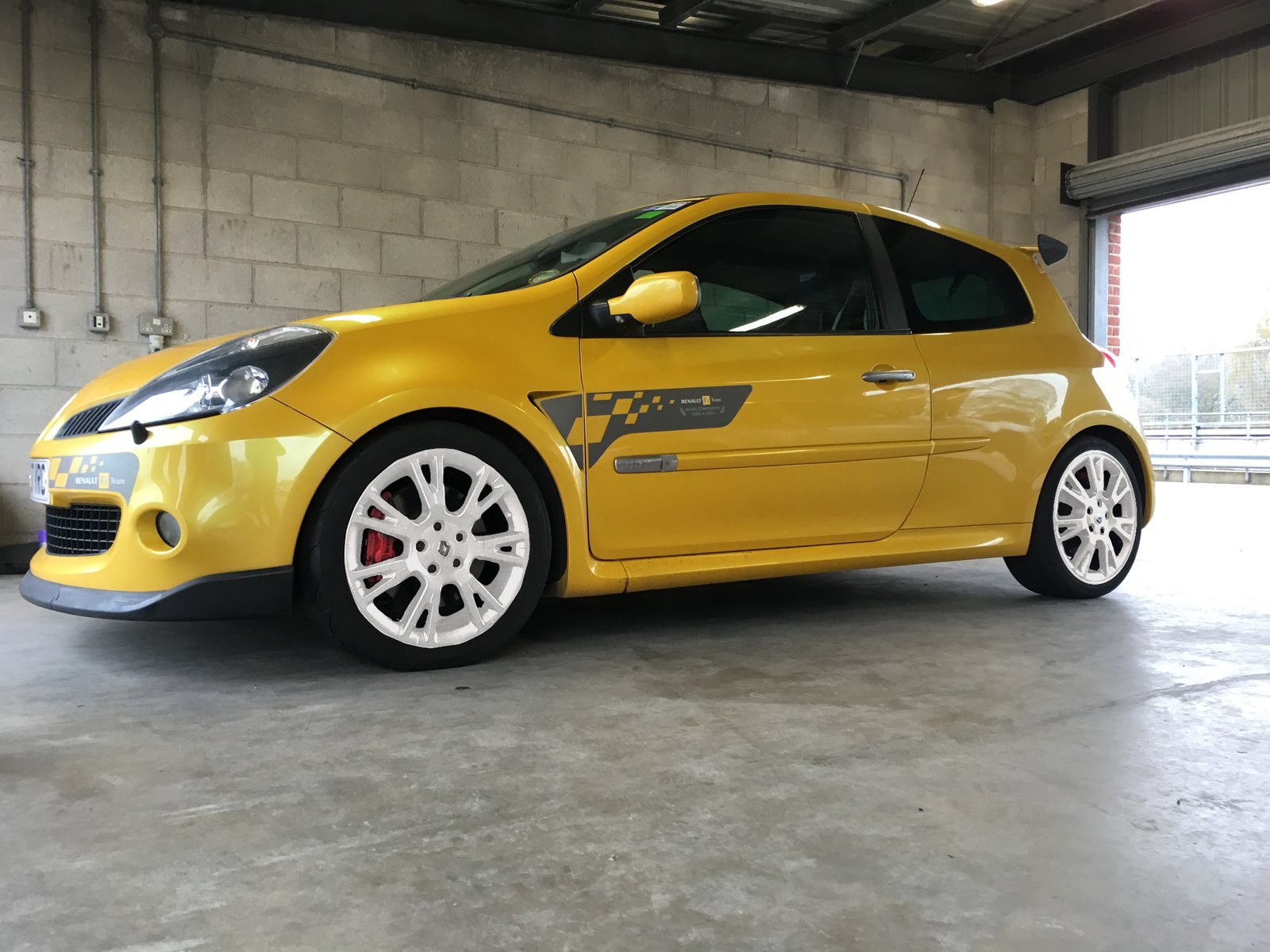

Quick/poor ps to get an idea of white.
I love it tbh
With spacers it'll look hella epic.
Knuckles
ClioSport Admin
I stole a few pics from a guy on the renaultsport forum's flikr

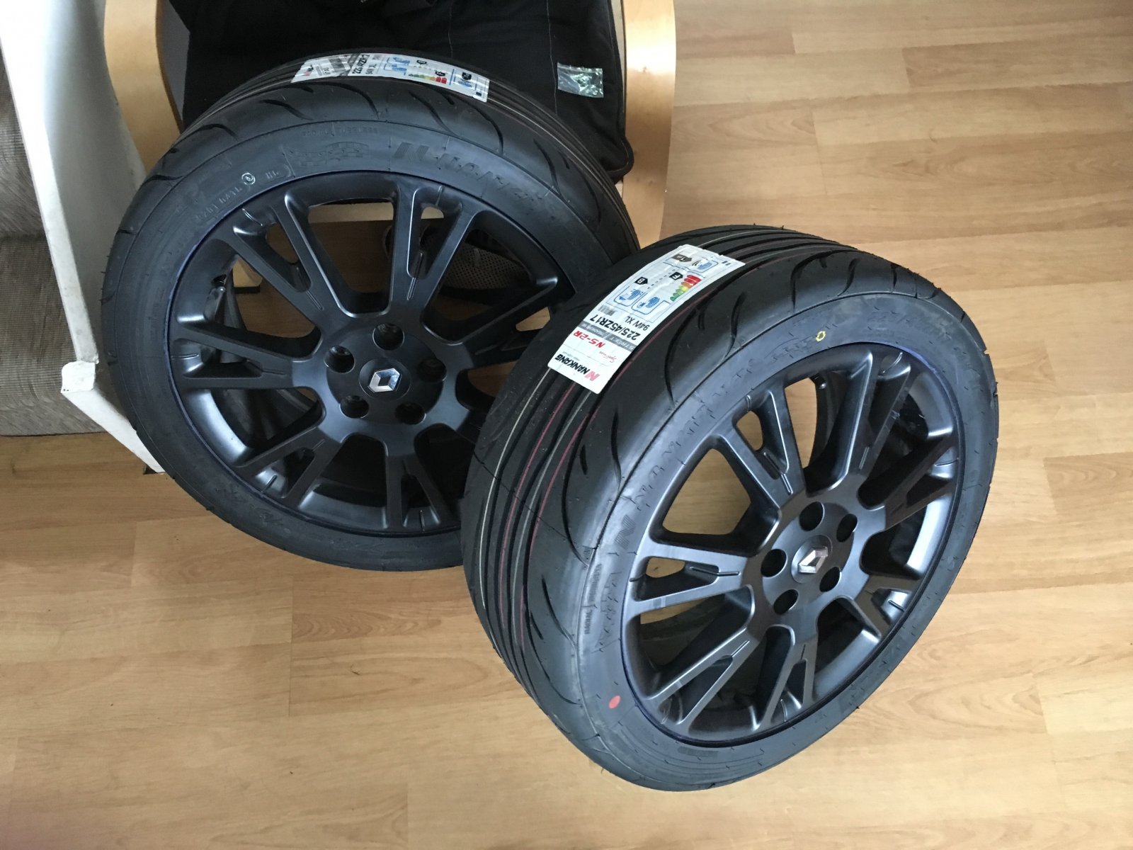

I love the look of the 225 width front tyres. They fill the arches much better than the standard 215 section ones

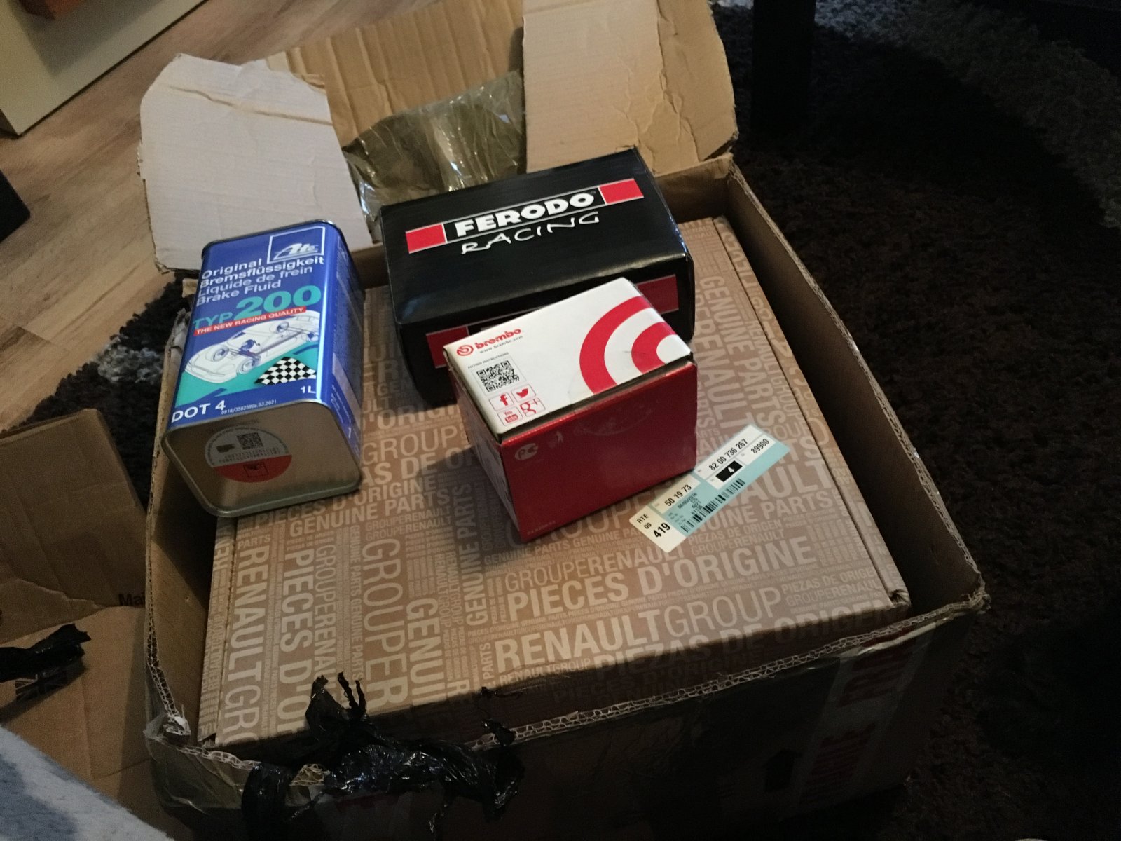

So after finding my brakes weren't up to track work at the renaultsport day and my rears needing changing, I bought new rear discs and pads and front ds2500s from George. I'll be fitting these soon and hopefully they'll hold up to Blyton in a couple of months.
Although my front discs were changed with the pads last August before the last renaultsport day, I think I'll change them anyway as I've got an inkling that they aren't genuine Renault/brembo.
So I'll hold off fitting the ds2500s until I've buy some front discs.

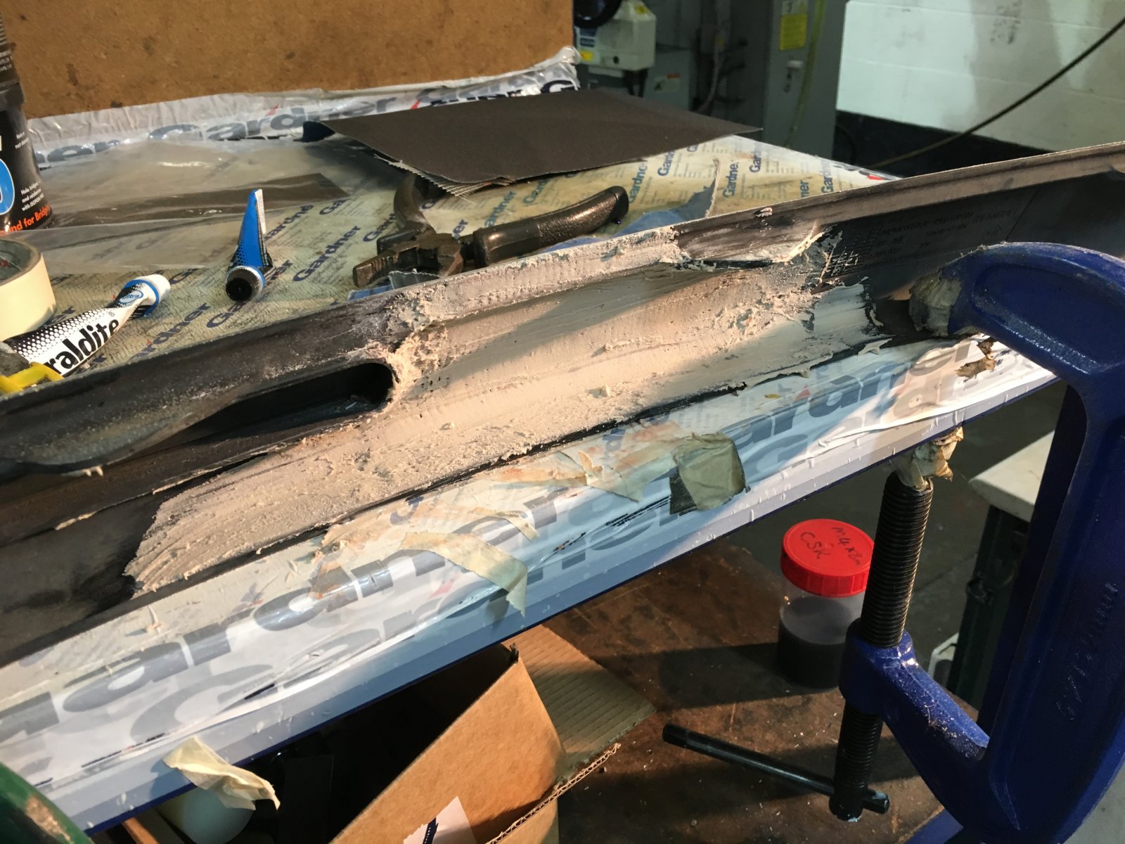

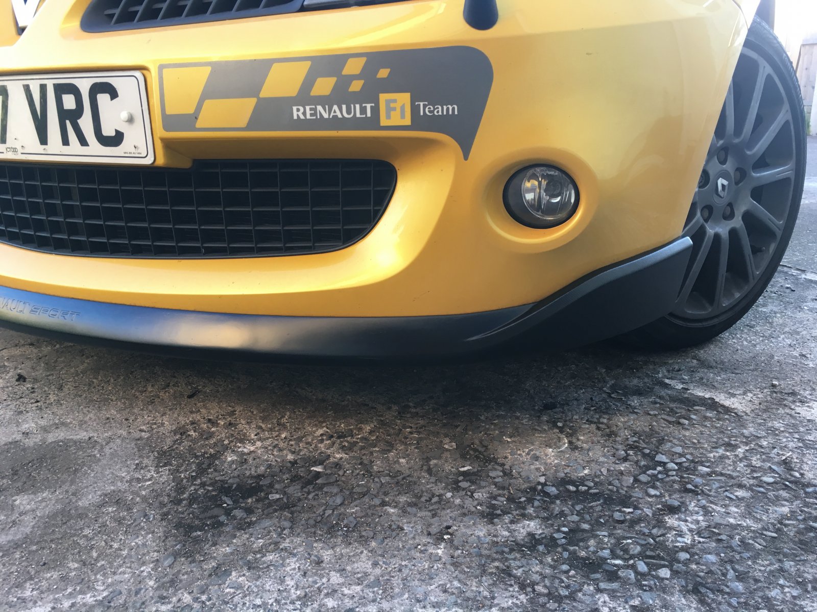

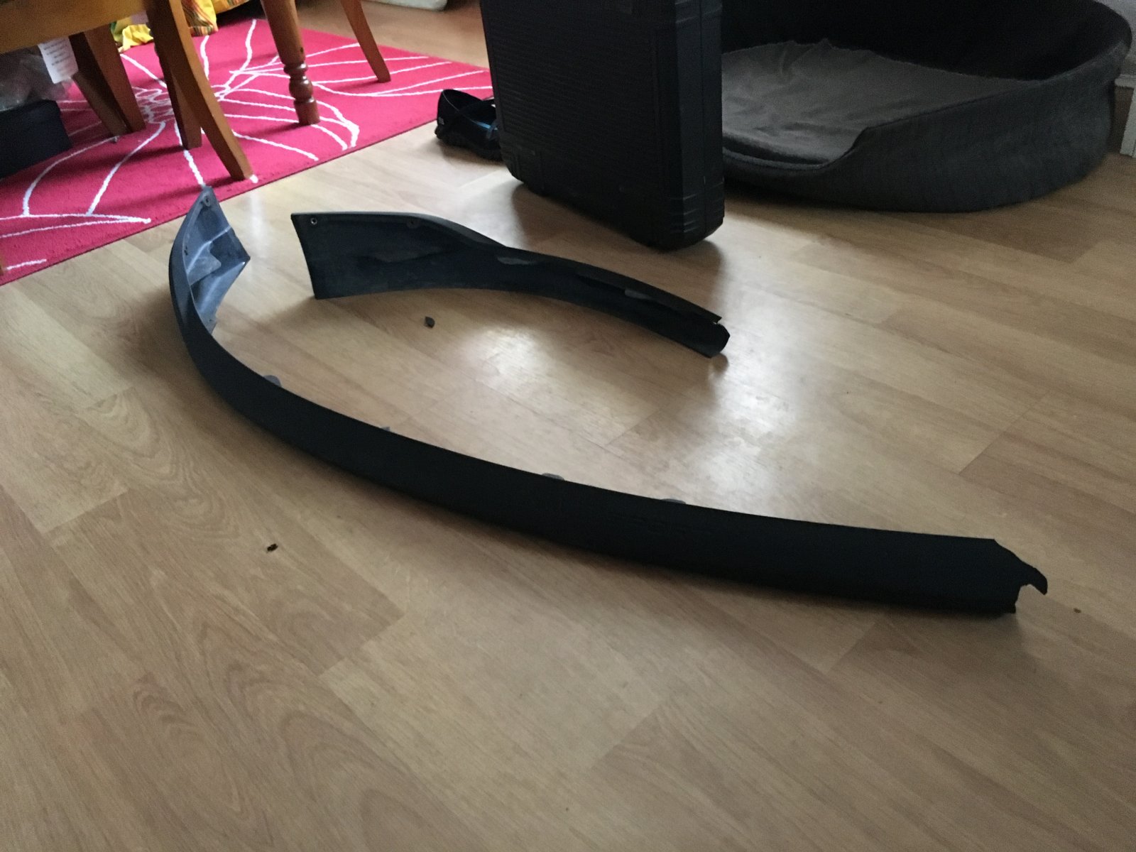

Also, I cracked my splitter a few months back getting of ash's drive.
It held up fine until a couple of weeks ago when I touched a curb with it and the whole thing sheared, snapping at a couple of fixing points. This needed sorting.

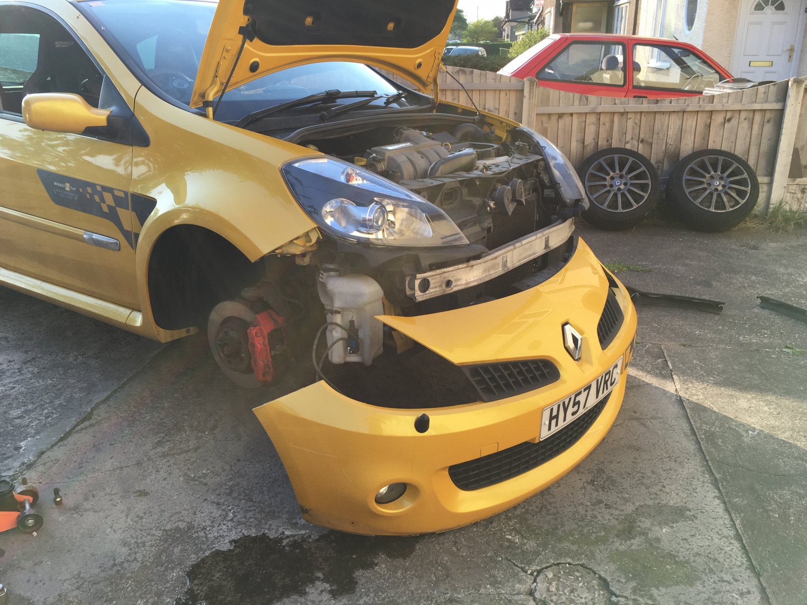

I started whipping off the bumper to get to the screws holding the splitter to the edges of the bumper
Poor splitter :(

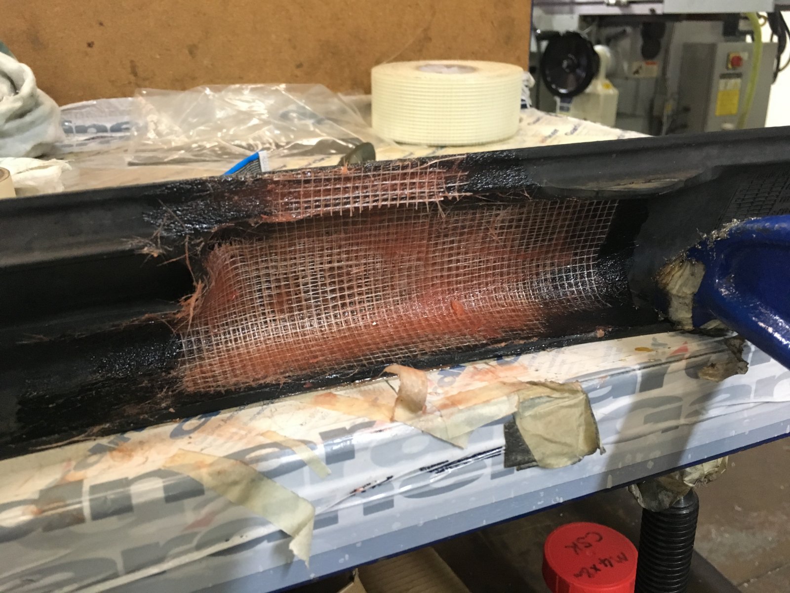

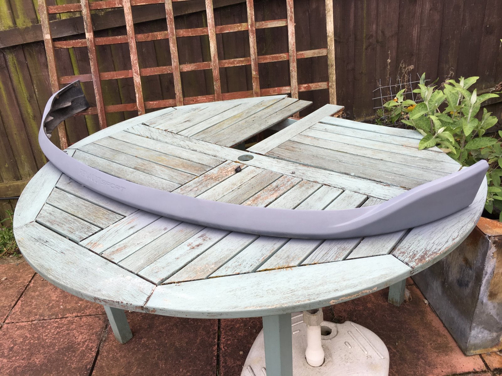

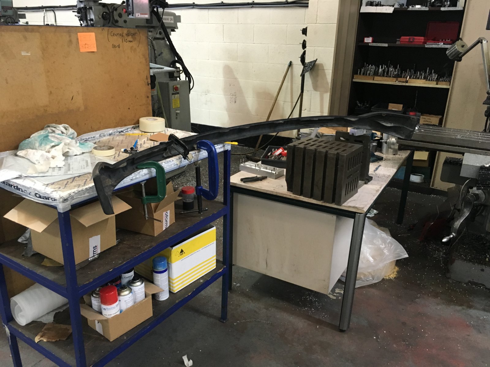

Took the splitter to work and fixed it to a table after positioning it together and bonding with araldite.
After this dried, I suck a few layers of mesh down and fibreglassed over it for strength.

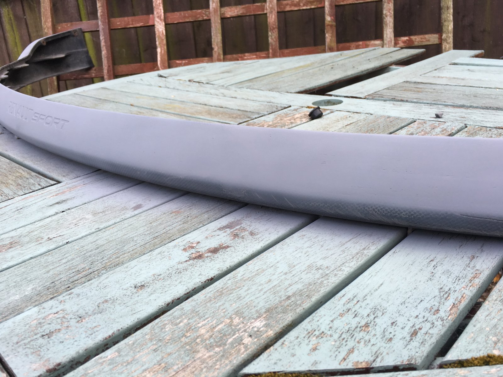

After the fibreglass dried, I went over it with filler to get a smoothish finish on the back and a smooth finish on the front.

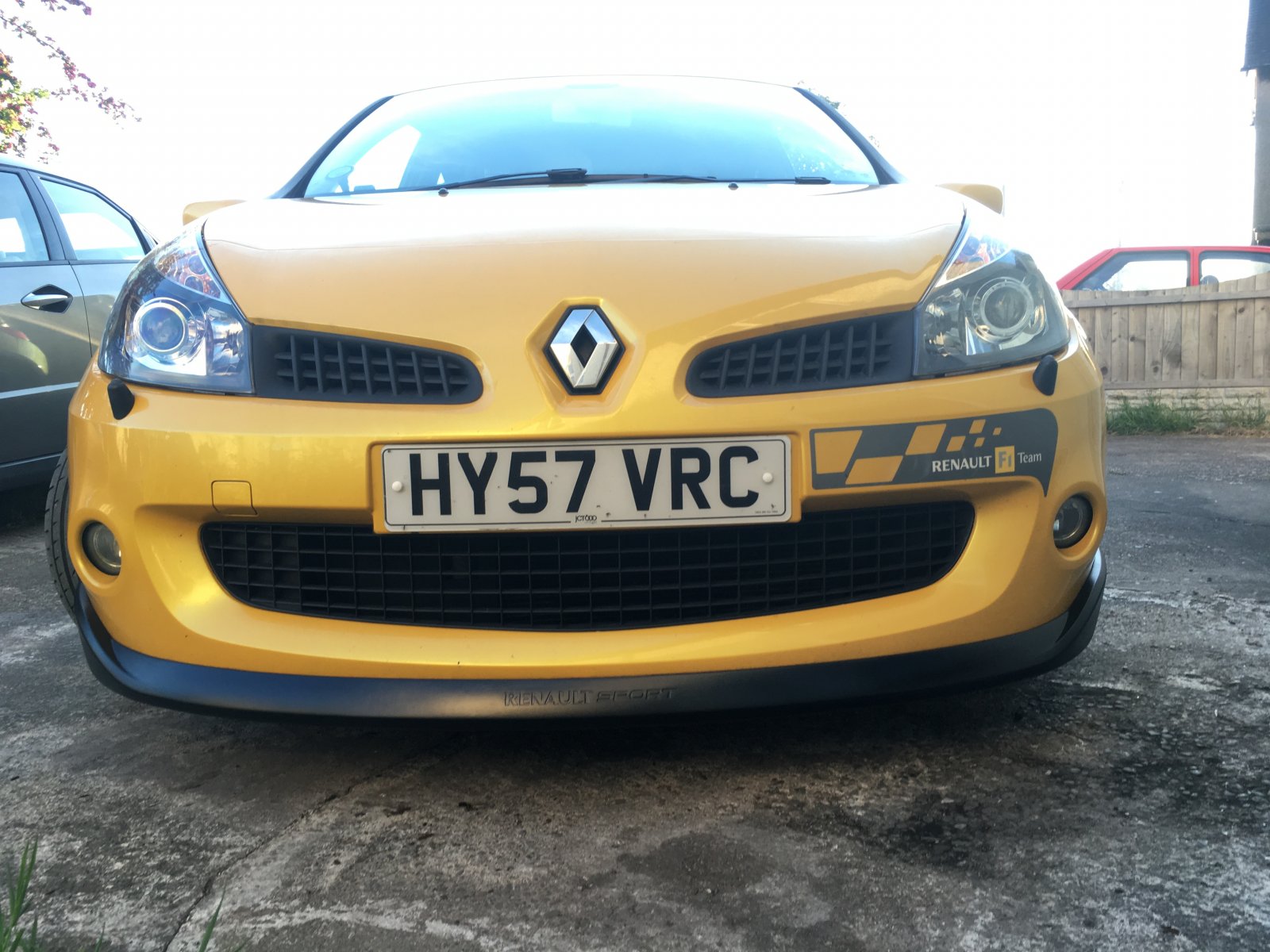

That's all I have pics of at the moment but it's currently mid way through being fully smoothed, then it can be sprayed and put back on the car.
I'm stuck as to what to do with it though.
Gloss black I think will look pikey, would satin black paint look oem enough and stay looking decent?
I'm dabbling with carbon dip, but, it could look pikey as f**k and I'd have to research different companies because I've seen a lot of shite carbon dip.
Thoughts?

Looking good. I fancy some ds2500's for mine. Let me know how you get on.
Did my vague instructions on removing the front bumper work then?
Sent from my Nexus 6P using Tapatalk
It did actually. I wrote a proper guide on it afterwards though.
It'll save someone else from removing all four undertray bolts lol

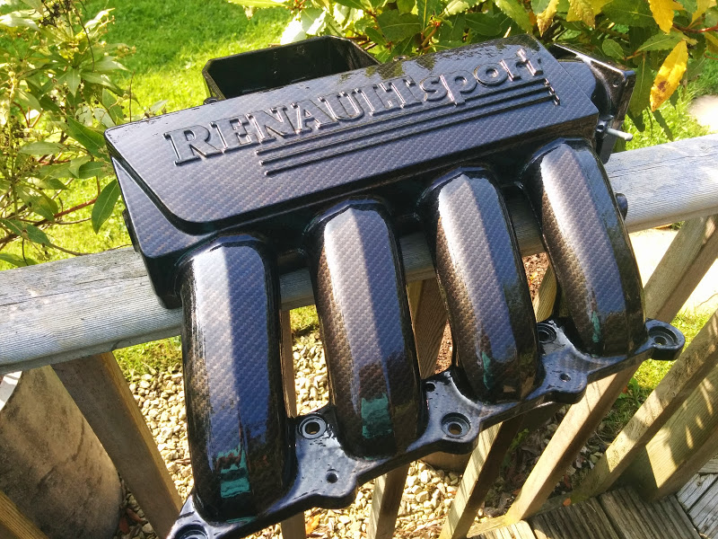

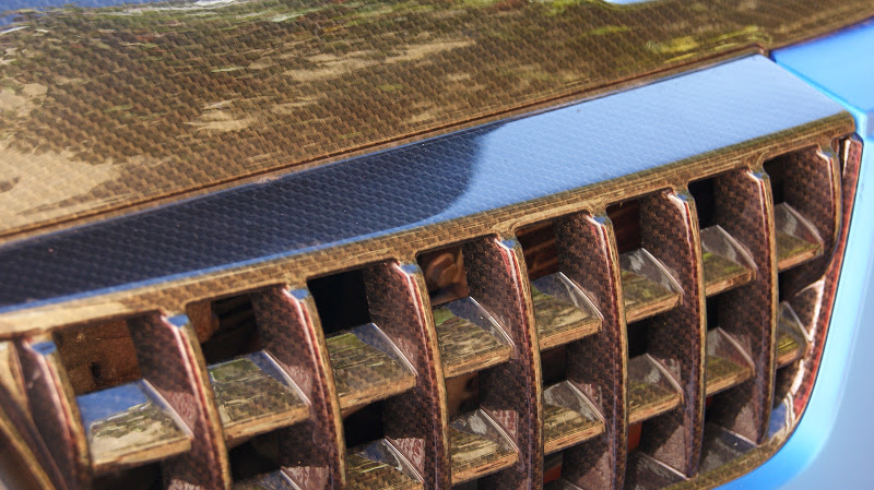

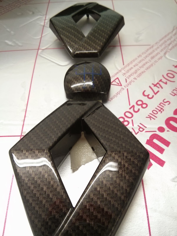

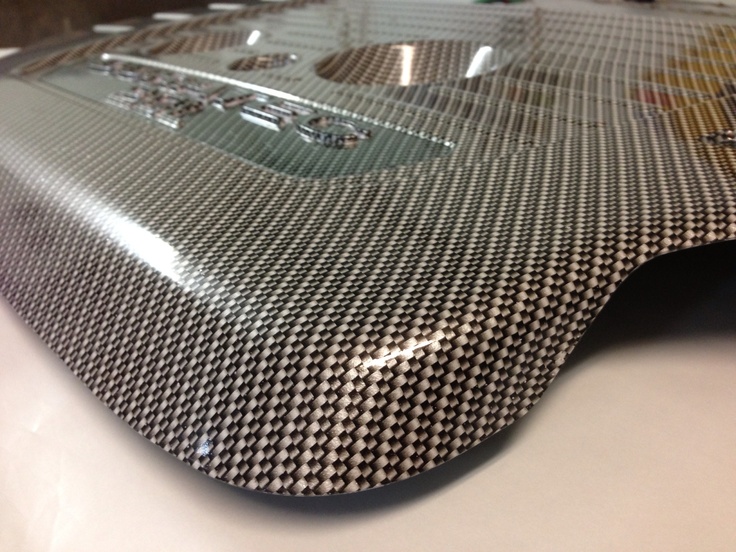

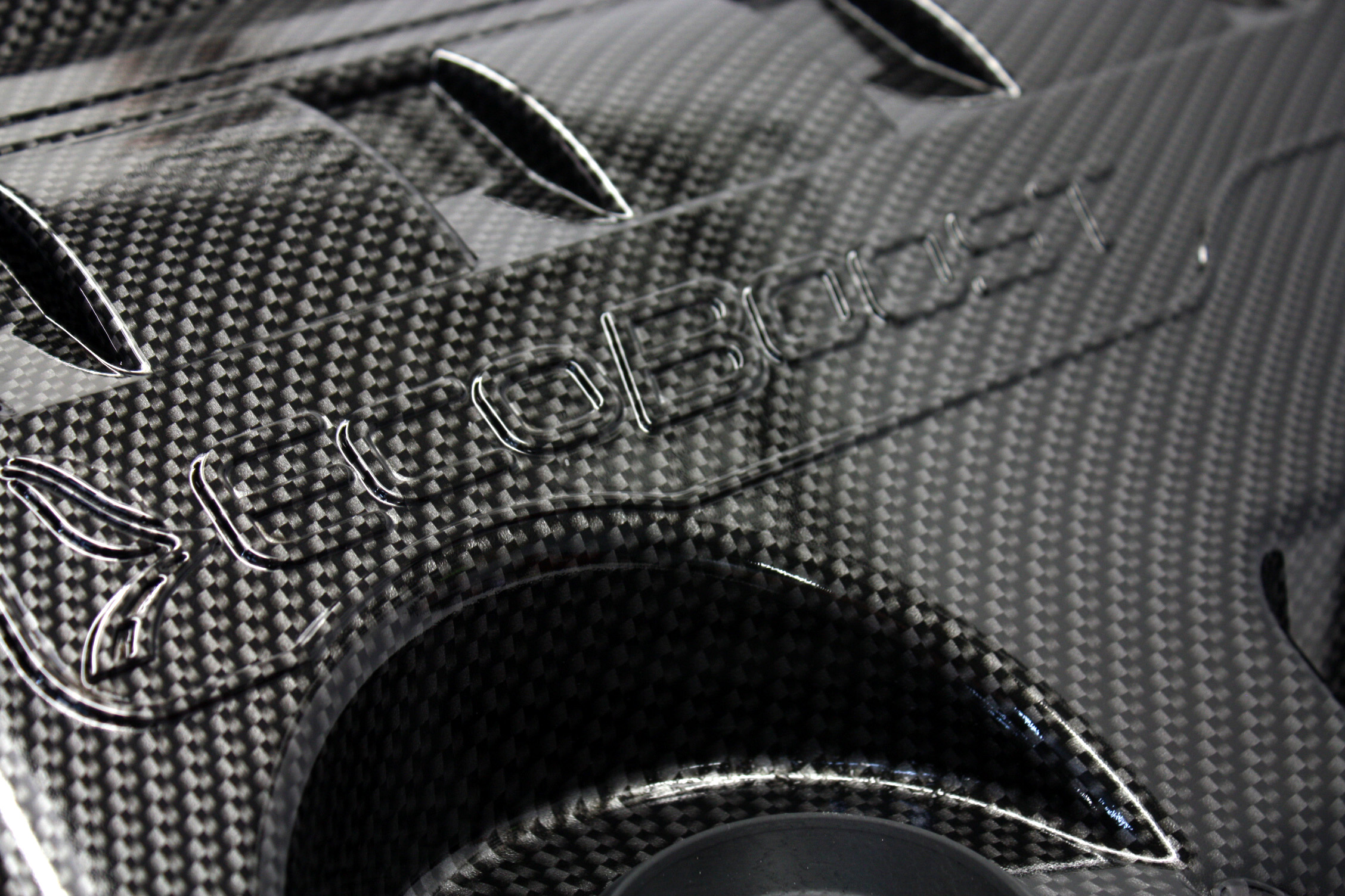

All carbon dip looks s**t tbf. Sayin black would look fine imo
I've seen some that actually look real, I'll try and find some pictures.

Ds2500 front pads fitted today along with oem rear discs and pads and new supergold fluid.
Then I stopped an annoying little blow in the exhaust.
The rears were well overdue! One pad out of four was doing all of the work (what little work the rears do anyway). And I think I found why so many owners have trouble with the rears binding... The rear pads get jammed in the tensioners.
We had to file a fair bit off the sides of the pads to get them to fit smoothly, so hopefully that's put and end to the binding.
First impressions of the fronts are they're leagues better than oem.
I took a local twisty road home and found myself under shooting the corners by a fair amount! Having to accelerate again to get around the corners due to braking where I'm used to on oem pads.
