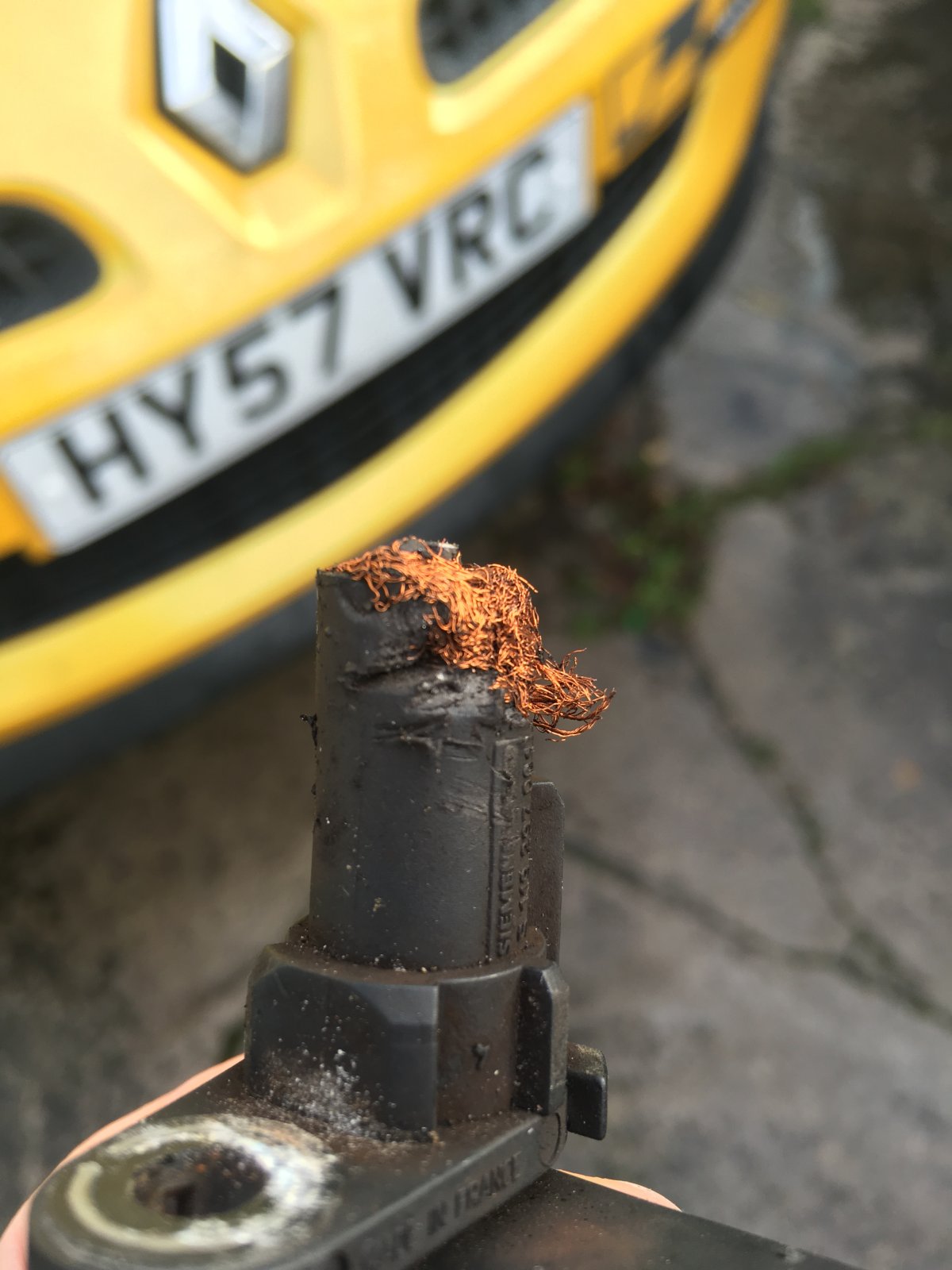

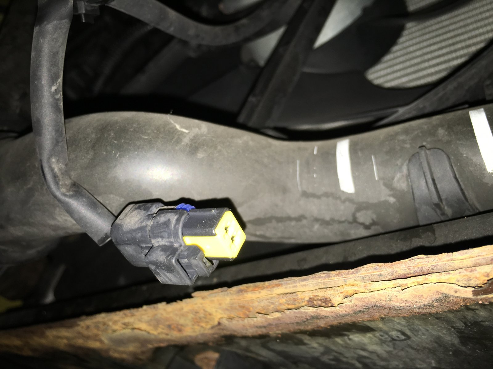

The following week I got it diagnosed properly as having a misfire and a sensor fault, a few people said crank sensor, so I got that, a pencil coil and a set of plugs ordered.
When I popped the undertray off, a wire fell down, which was odd... It came from the crank sensor.
Odd, plugged that in and tried to start it with no luck.
I found out why when I removed the old sensor;
Proper job.
Got the new sensor fitted with the plugs and coil pencil and the car fired up, revved fine and didn't eat the new sensor. Ace.

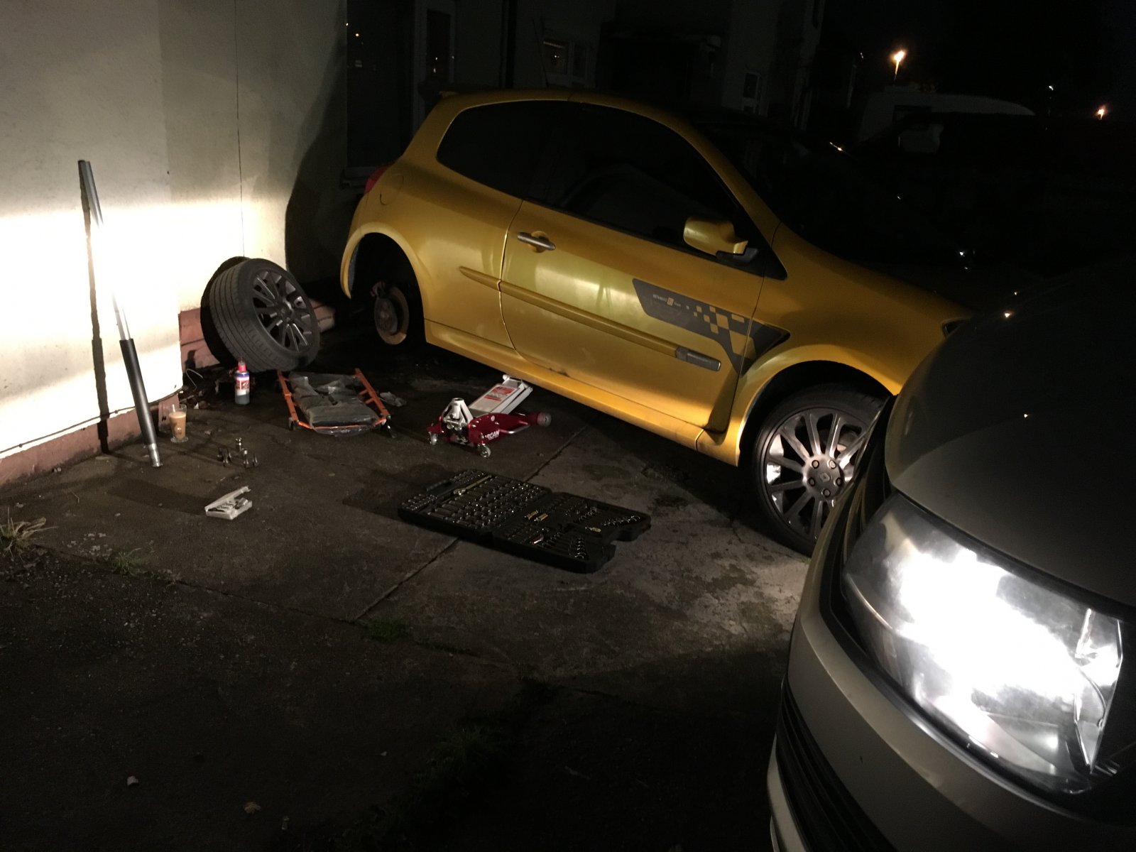

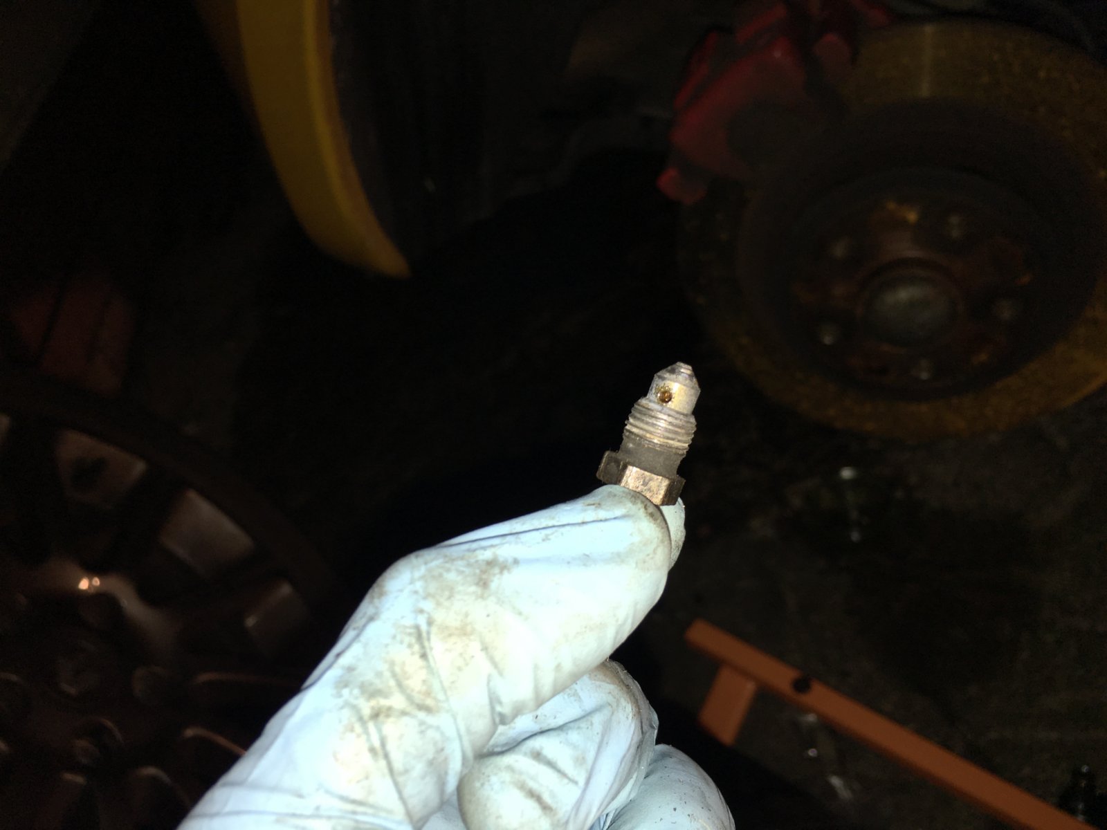

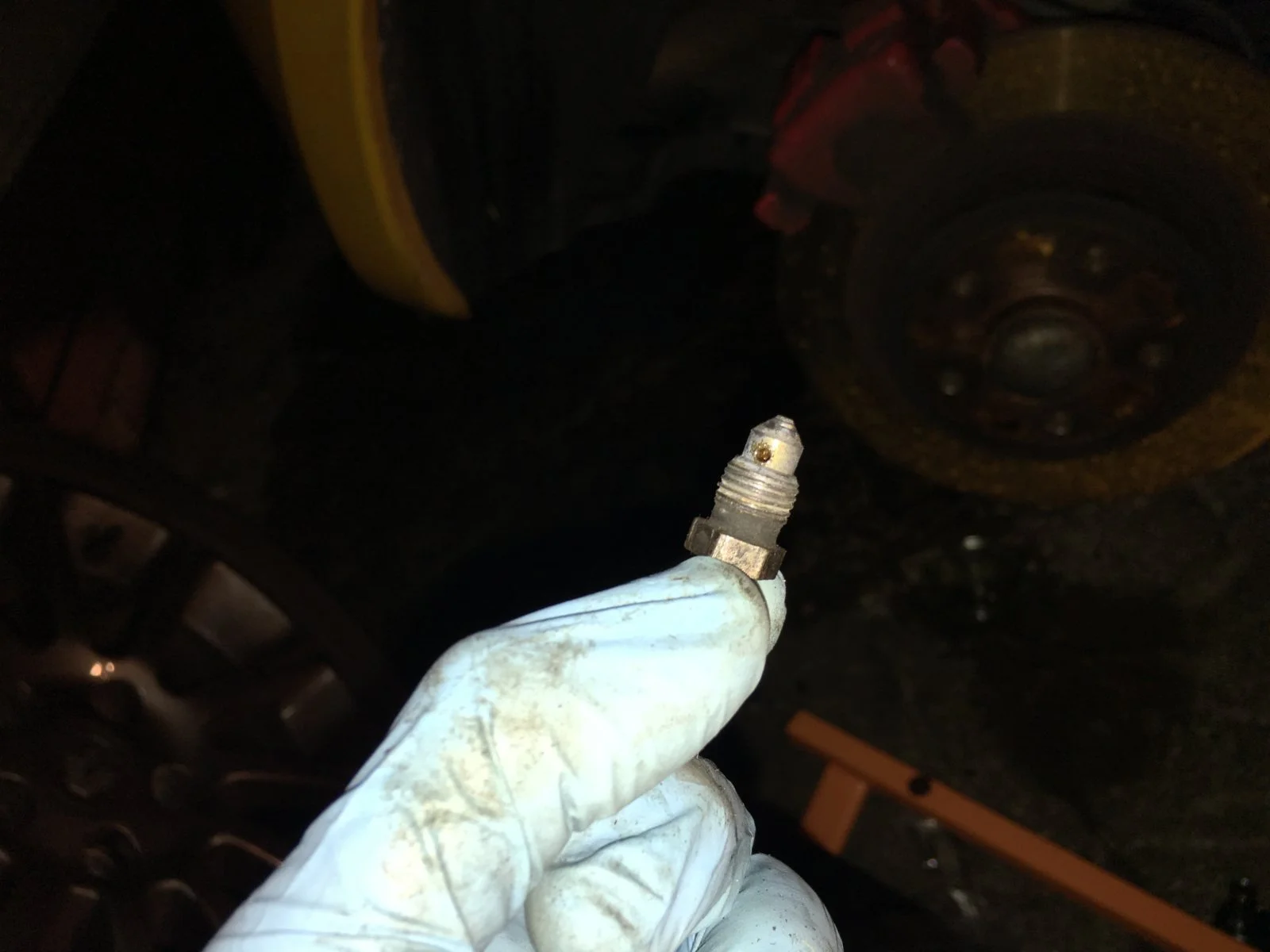

But the car still had no brake fluid in, and the brake line I got in a hurry wasn't genuine and was a hell of a lot shorter than the OEM item, I didn't like this so I ordered some HEL braided lines and a new bleed nipple as my rear one seized in, turns out it was just tight as f**k. Mmm. Tight nipples.
This one had seen better days
The joys of having no garage and using a van as a work light.
I got the new lines and nipple fitted yesterday and filled the system with supergold fluid, job was a good un, no braking fault and a decent pedal feel.

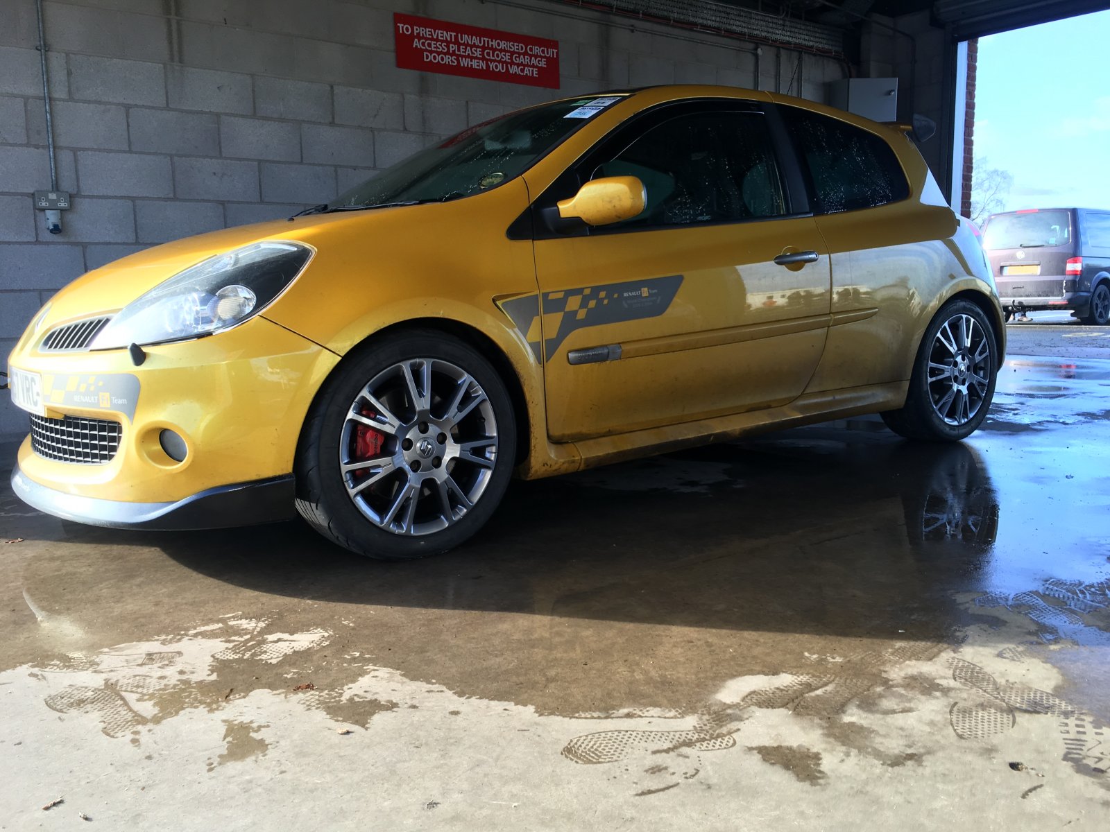

A couple of pictures from before it broke.

Good work. What happened to that sensor?!!?
I also wish i had a garage, CBA doing anything in the dark/cold! Next house it's a must!
MartinL1993
Thinking about it more it could have taken a knock somewhere on track, not sure how but for it to have unplugged damaged and then maybe damaged the exhaust?
Then again we have no idea what damage the truck did if not all of it

The thing is it didn't even go pop on a hot lap. I was pootling around for a lap waiting for the m3 to catch up then it went a few corners later after the m3 went in.

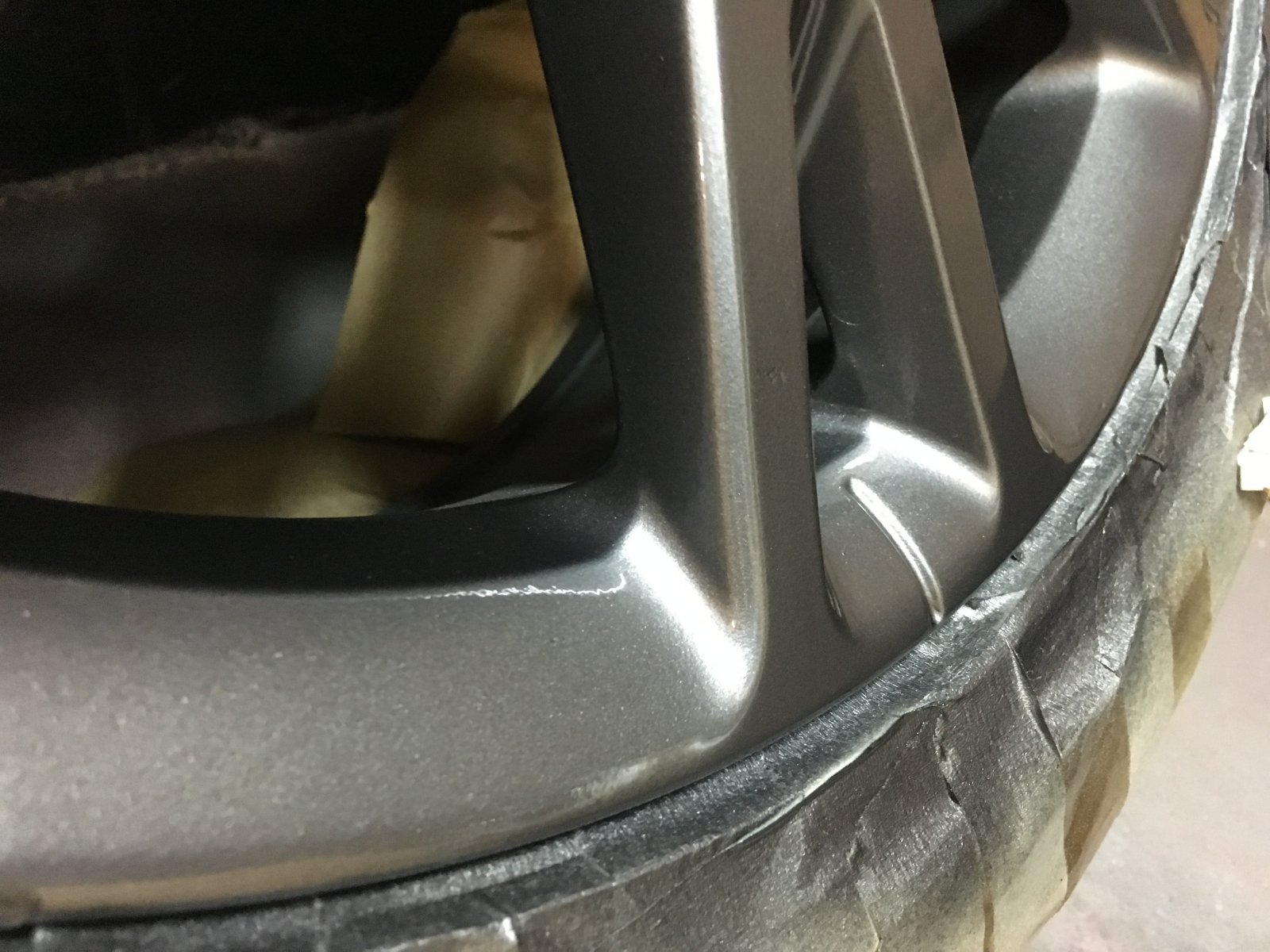

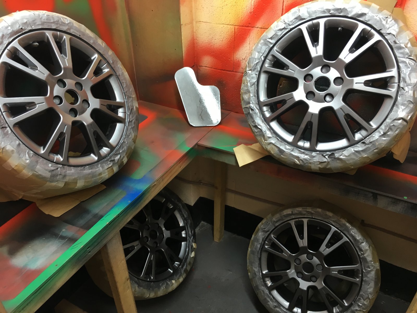

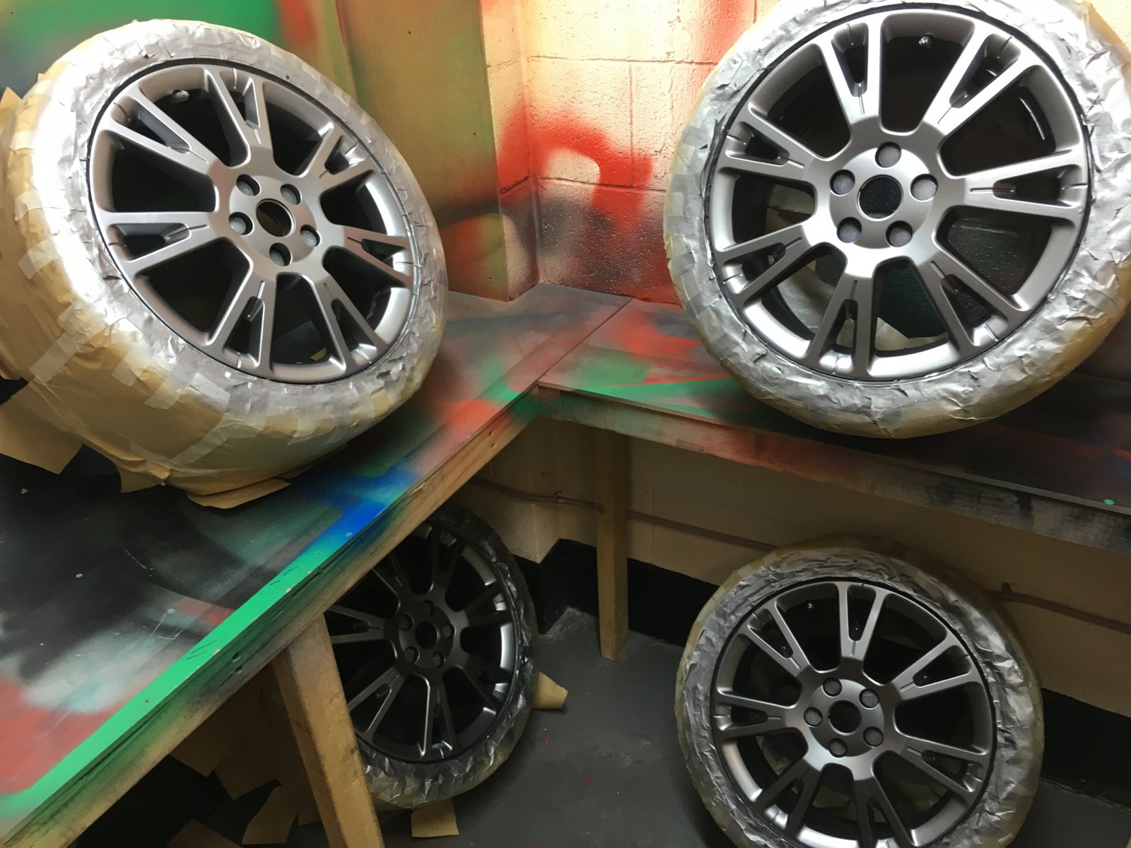

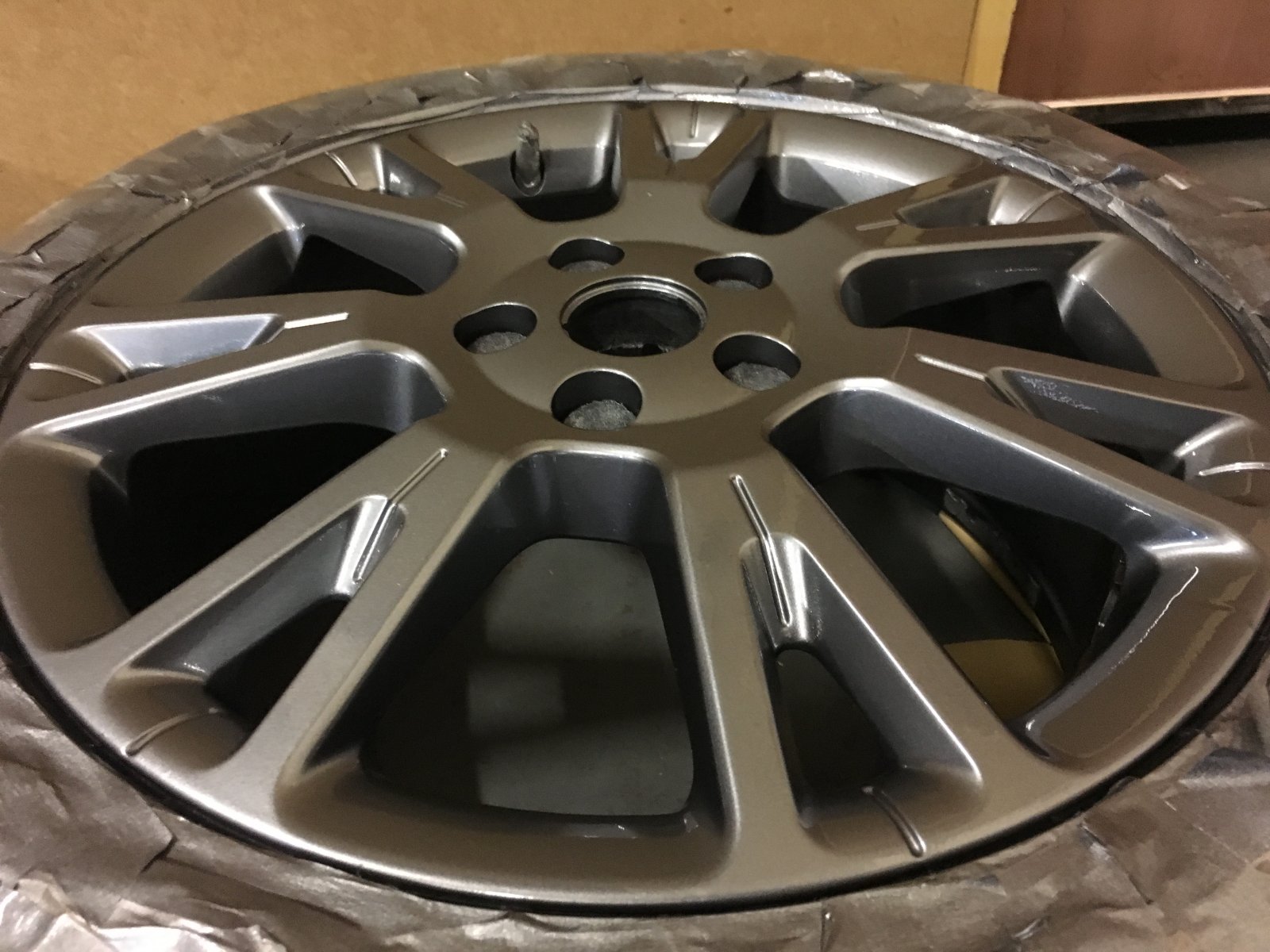

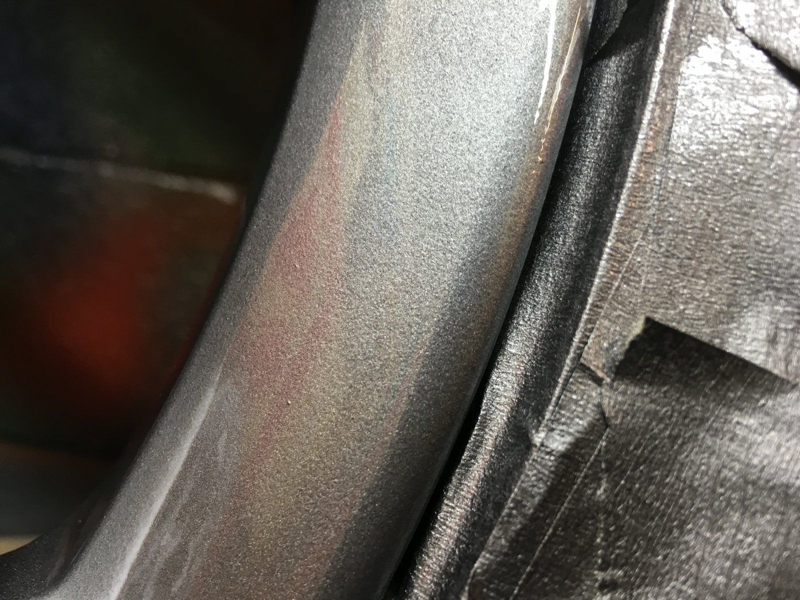

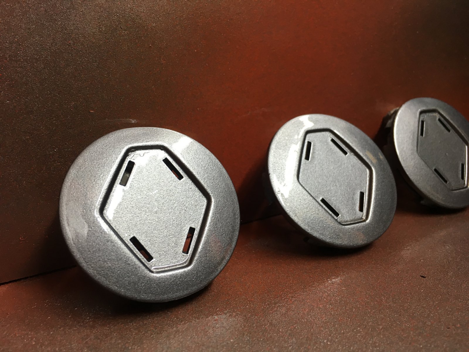

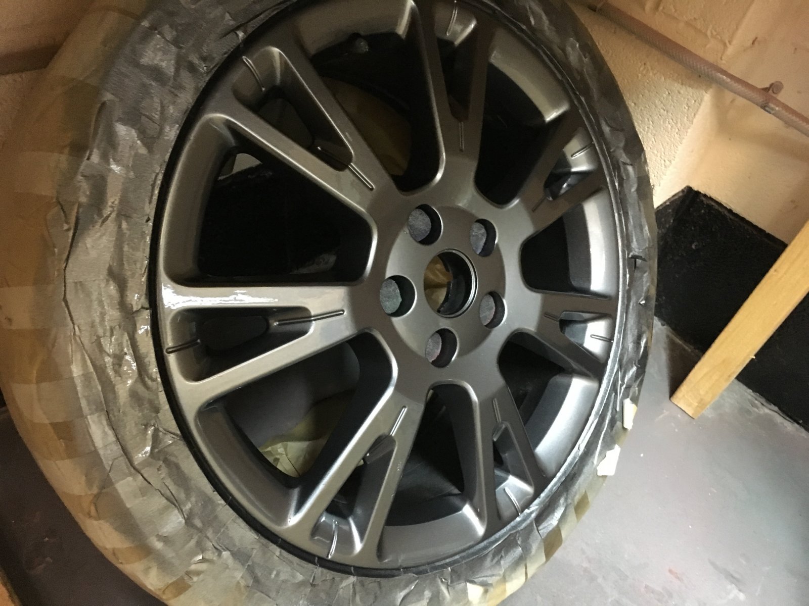

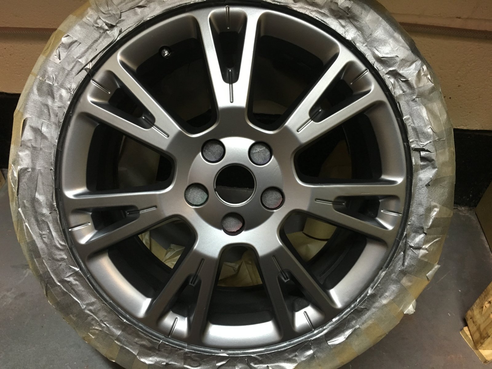

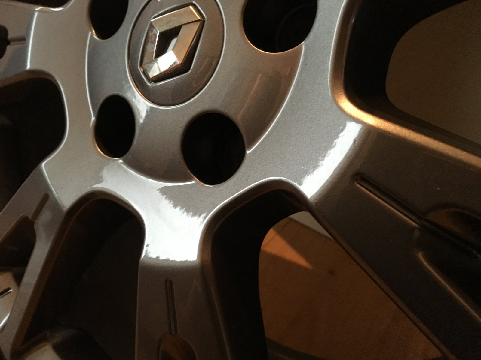

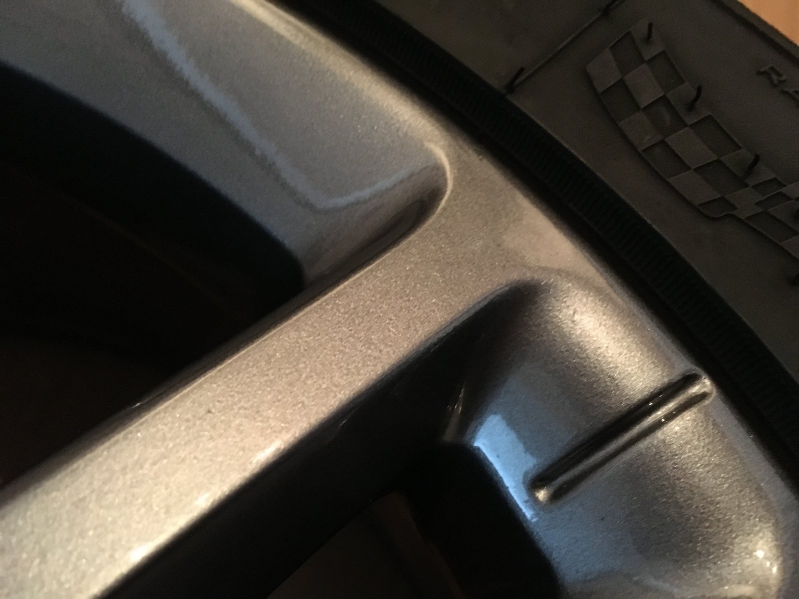

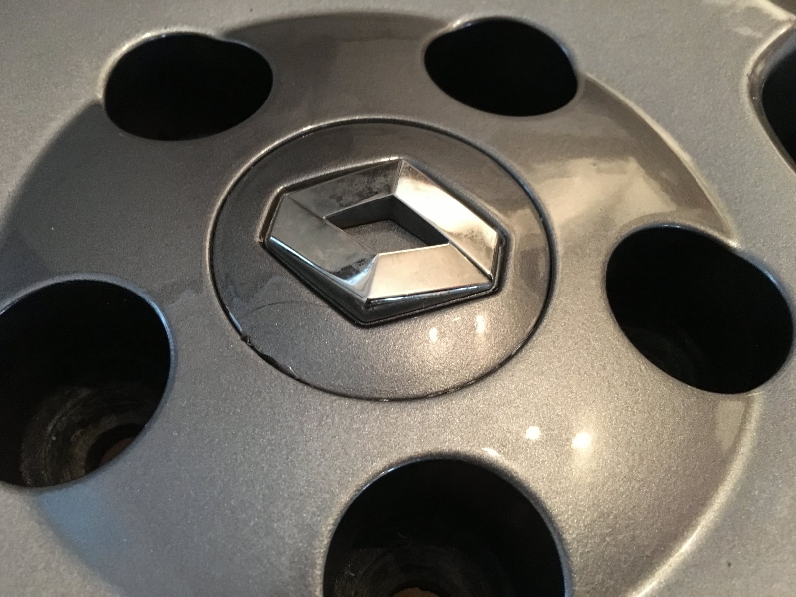

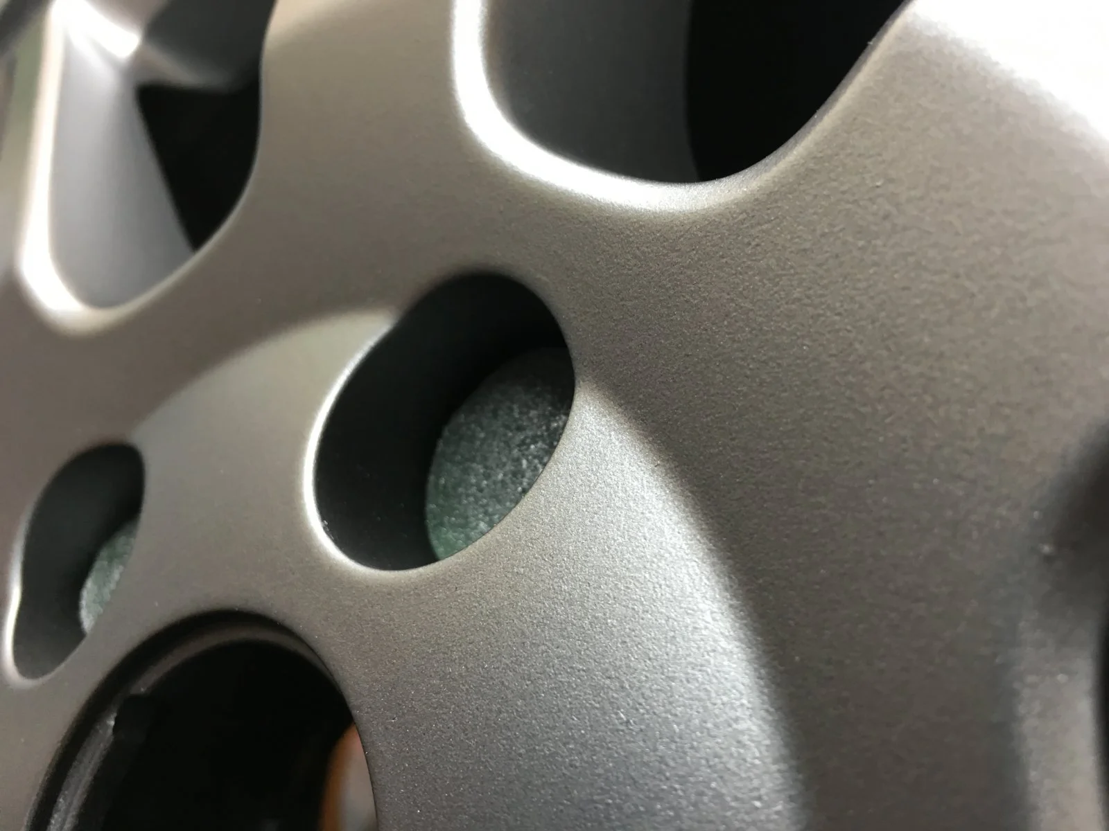

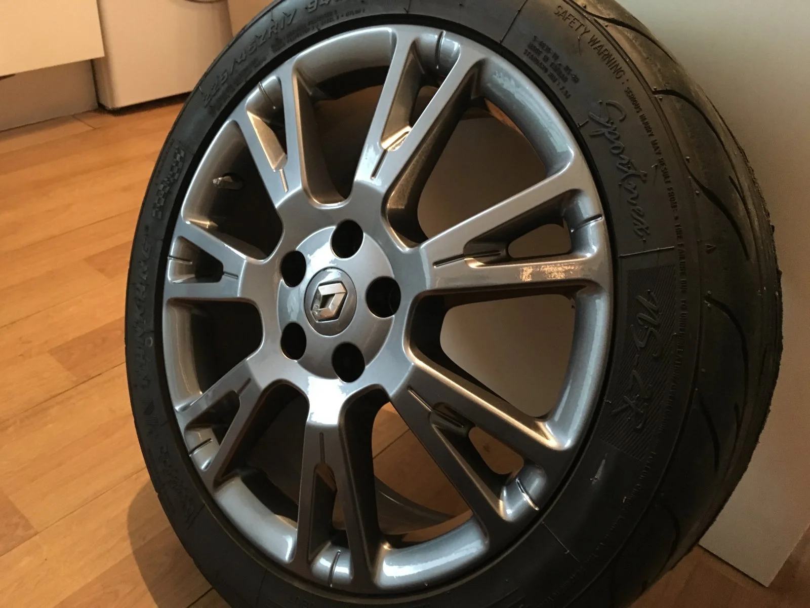

As I've always hated black alloys and we've just set up a proper spray booth in work I thought it'd be rude to not sort out my speedlines

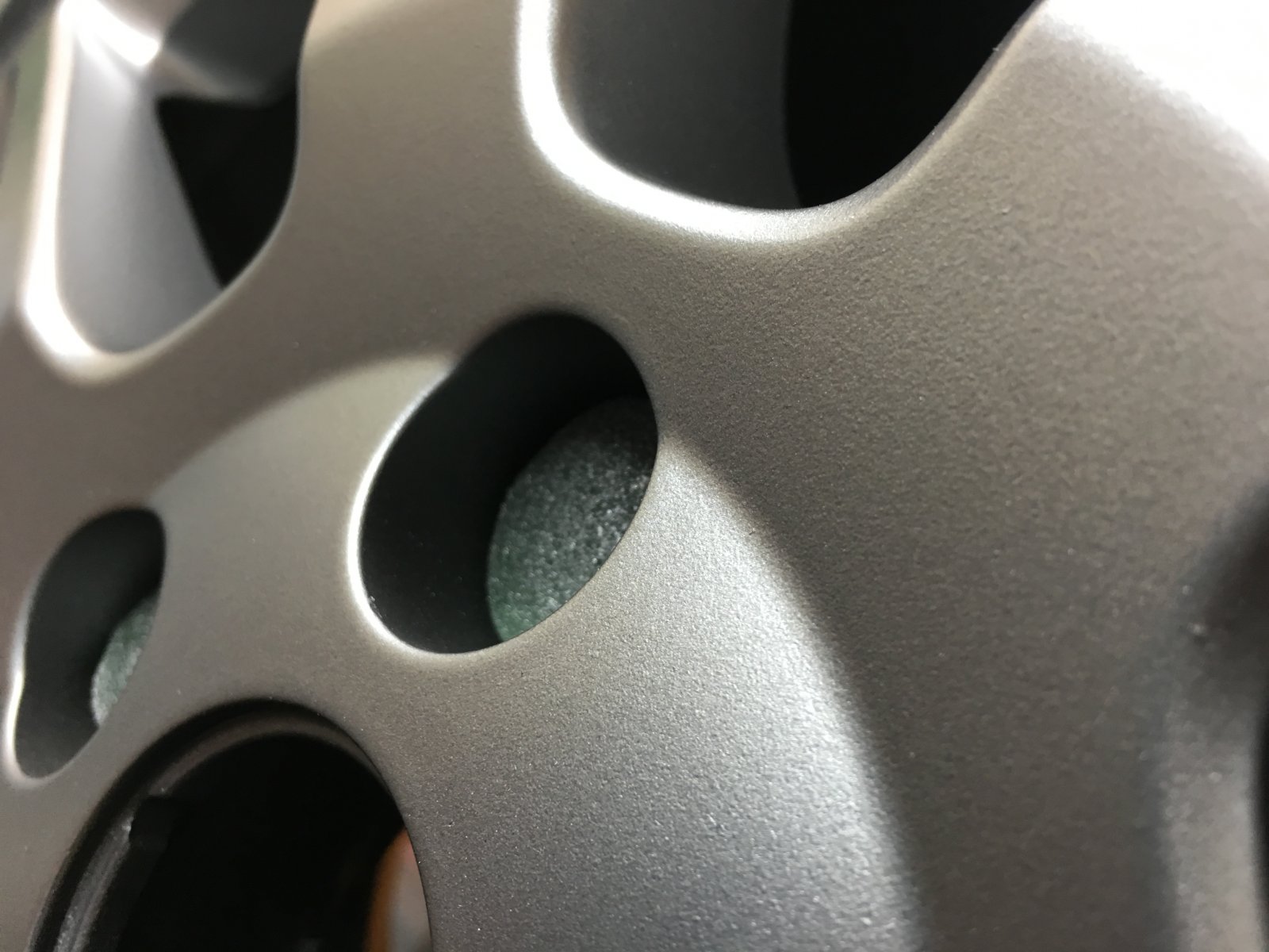

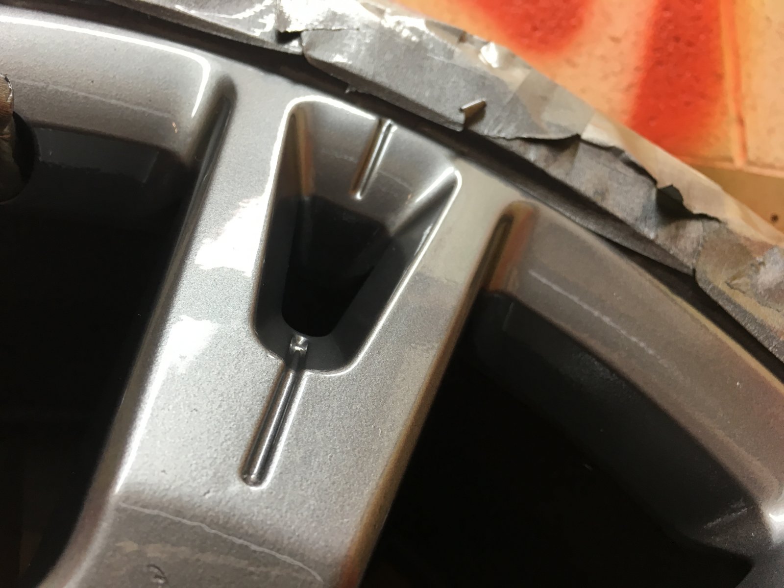

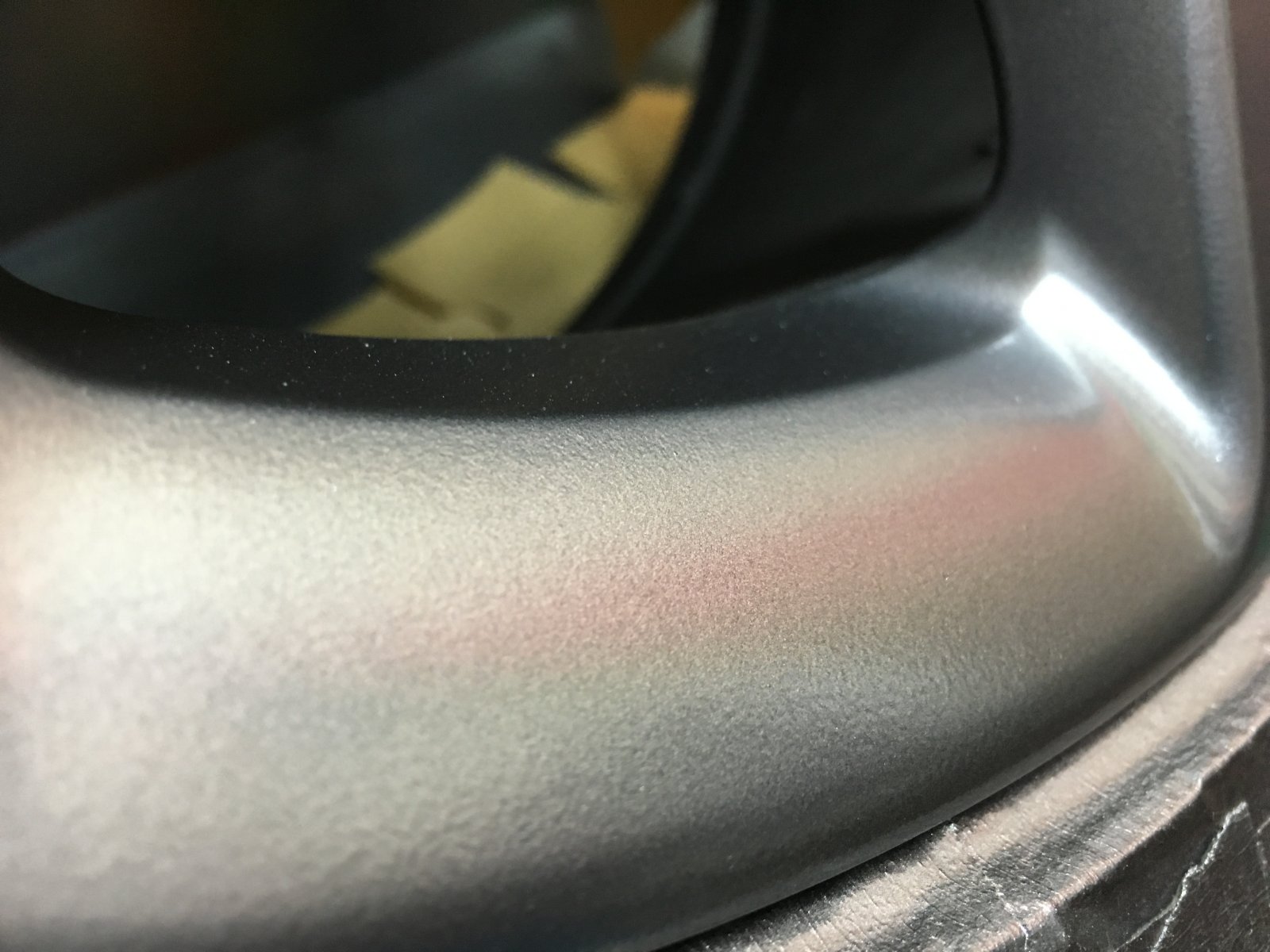

For my first attempt spraying properly and spraying properly with metallic paint, I don't think I laid the base coat too badly. The texture is all there so that's curing overnight then I'll put the lacquer on tomorrow to give them a nice gloss and depth.
The paint is bmw a52 space grey iirc, my colleague who I track day with is doing his wheels in it too after oulton this Saturday

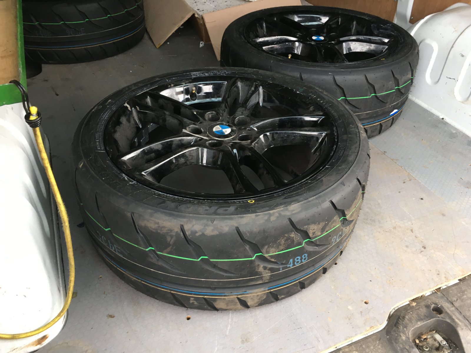

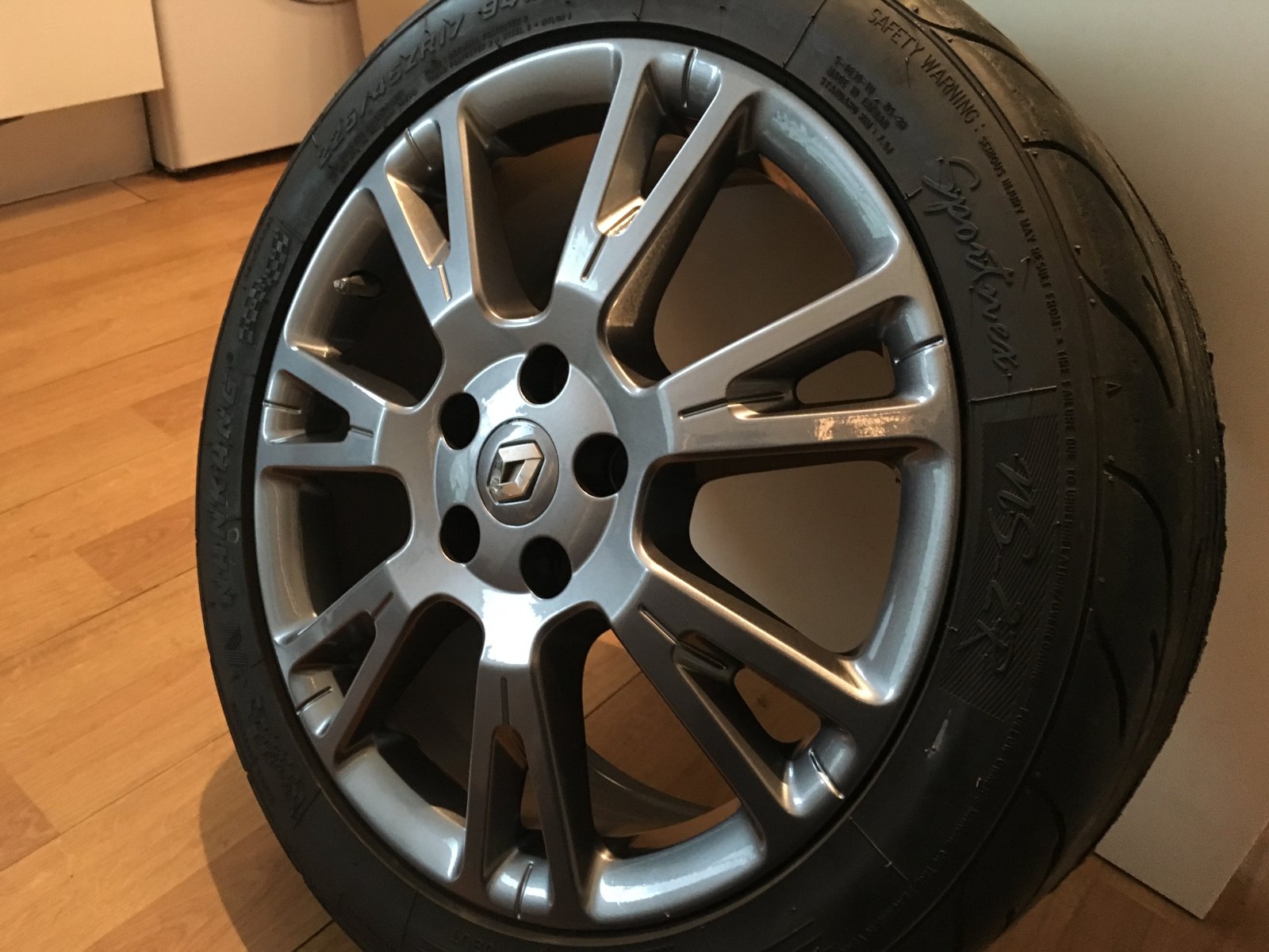

These are the ones we'll be doing next. Sexy new tyres too

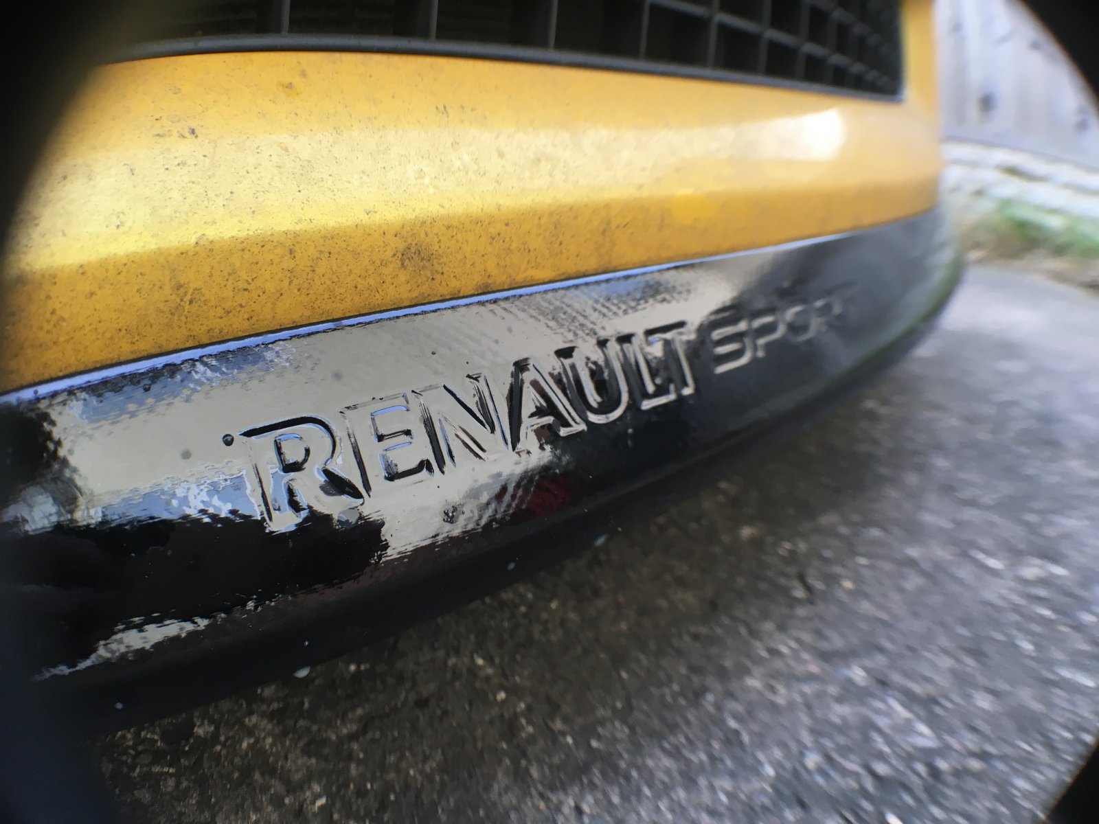

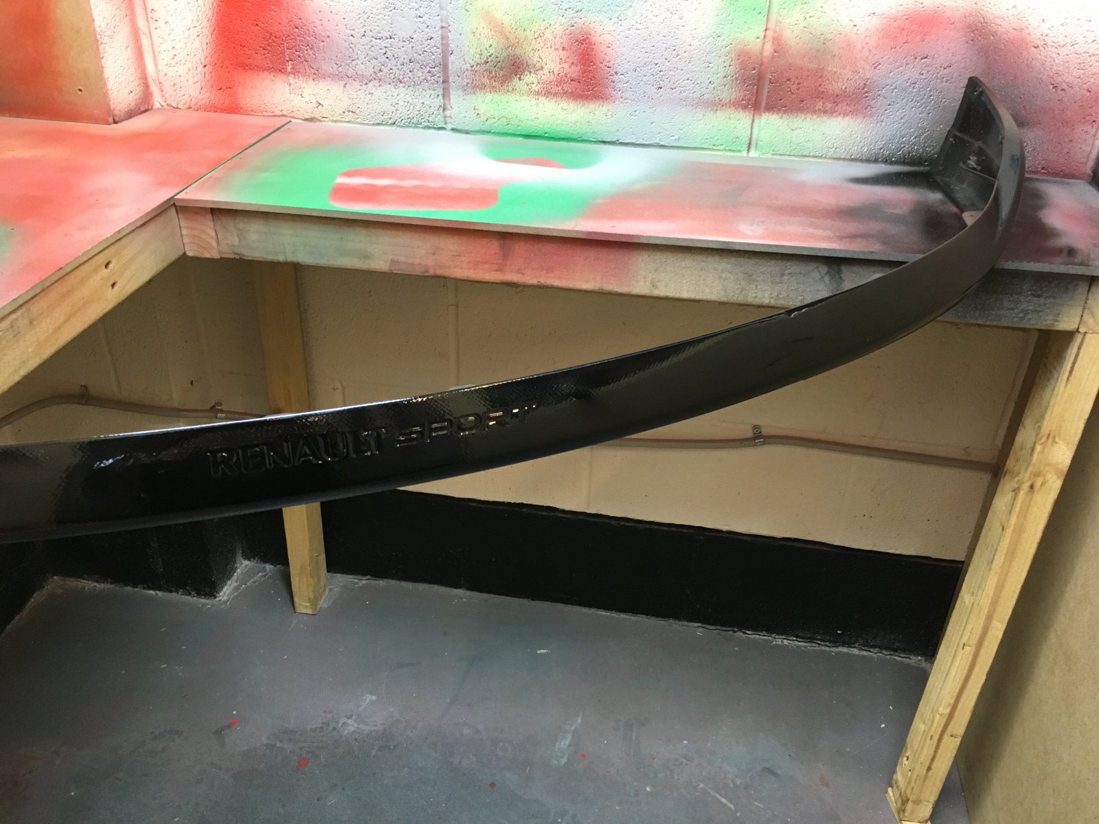

...also, I fixed my splitter again and painted it gloss black. Full 17 year old spec.

Such gloss much wow :smile: Seriously though they look great. I wasn't a fan of speedlines before but they've really grown on me. Definitely getting a set in the future
Much cup race look.
Thank you :D I can't wait to see them on
I was the same, didn't see the draw of them, but I got these at a silly good price and whenever I see Laguna silverstones I can't help but think they look like cheap knockoffs.
If you can, definitely get some. I think I'll put these on over summer now they're pretty.

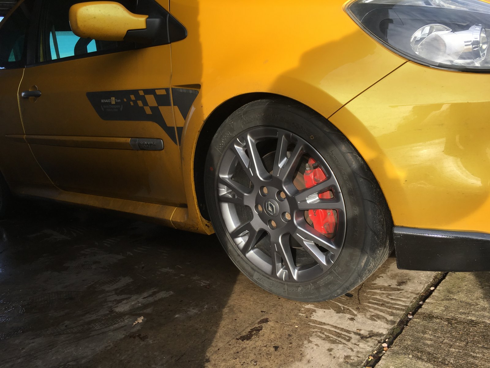

I just got some pictures through from oulton
It's crying out for spacers. I might clean it for the next track day
I'm currently spraying the speaker surrounds to match the wheels as they were a little scratched.
For anyone interested, BMW space grey is a brilliant match for the r27 decals. Much better than oem anthracite.
