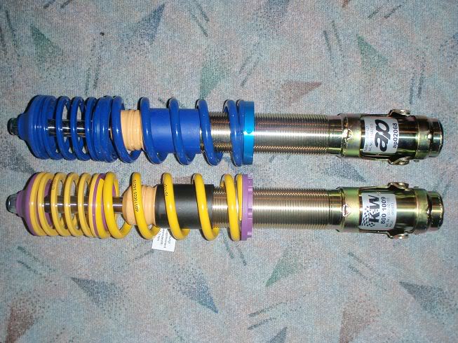

So over the past week i've been scouring the internet for a cure to my rattling front end/slightly loose steering, & today i decided that its probably the top mounts, a cheap enough fix at circa £80 for parts + fitting. I always get carried away though, so then decided that if ive got to pull things apart i might as well change some other bits & bobs as well!! After all, it is 98k miles old & if i do all the changes at once, it saves money on re-alignment, etc ...
This morning I ended up buying some AP coilovers from the chap i got the EVOMS off :eek: According to the forums, they're apparently quite good, with fairly soft/OEM style handing - which hand on heart is what i wanted, stiff suspension is cool on track, but bouncing up & down the motorway every day simply isnt fun anymore!! Anyways, considering they cost me bugger all, if they are rubbish, i'll just pull them off again and buy the Bilstein PSS B14's that i'd originally decided upon.
This way however, for the £800 that the Bilsteins would have cost, i can have new AP coilover's, replace all the front end bushes (maybe Powerflex them), sort the top mounts & bearings, do the re-alignment and have money in the bank ... that ill probably then spend on H&R ARB's ;)
The AP's are apparently made in the same factory as KW's anyway, & having looked at the comparison below, they do look quite similar:

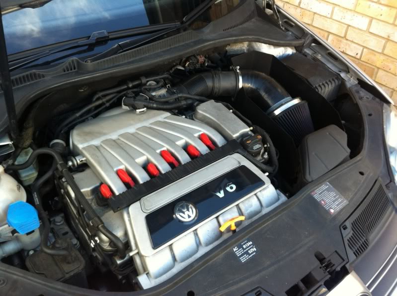

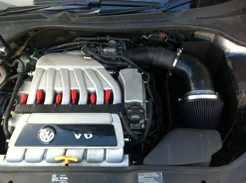

Secondly, the EVOMS induction kit. Basically the worlds largest cone filter, in a ruddy great big airbox. Uses the same cold air feed as standard, so in theory, the air is still coldish as the bonnet acts as the lid to the airbox, you just get more induction noise. UNDERSTATEMENT!!!!! What i didnt realise is that the R32 has an 'induction noise generator' thingy, so induction noise is piped straight into the cabin - helps to explain why it sounds so throaty as standard i guess? Needless to say, with a open cone filter the size of my head under the bonnet, the noise inside the cabin was quite frankly obscene. Probably an awesome addition if you have a Miltek, & want to bwaaaaarp around everywhere, but i really like the standard raspy exhaust sound, & the deep boom from the EVOMS just sounded wrong.
So the timescale between fitting it, going for a drive, removing it, then selling it on the R32oc was approx. an hour.

Nice cone, it's fecking huge.
Not surprised you took that out, running an open cone on anything >2.0 is mental if you ask me. I put one on my 172 for a laugh, it made so much noise it was obscene, so f**k knows what it'd do on a 3.2 with an already throaty roar.
Can I give it a go on mine? It looks like it'd fit!
