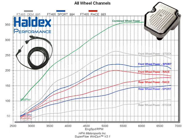

Bit of blurb from HPA's website:
The Gen 2 Sport controller takes into account the TPS signal more so than the OEM software and therefore can proactively begin applying power to the RWD clutch packs before wheel spin begins, and as power is increased, more power lock occurs in the RWD unit until full lock is achieved. By default, the controller is designed to be in Sport mode which transforms the handling characteristics of your AWD car by increasing torque transfer to the rear axle and giving more rear wheel bias.
With the installation of a specially engineered wiring harness and switch, you can have instant access to all three of the programs built in to the controller; Stock, Sport, and Race. Race mode will unleash further potential as it provides faster reaction time to vehicle inputs in the AWD communication system, and allows for even greater amounts of torque transfer to the rear axle.
Basically, it will give me up to 50% drive to the rear wheels ...

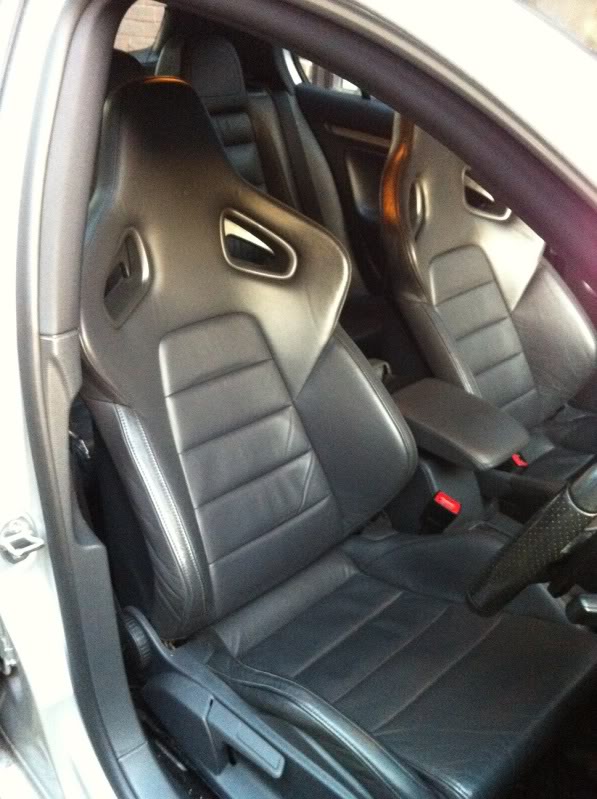

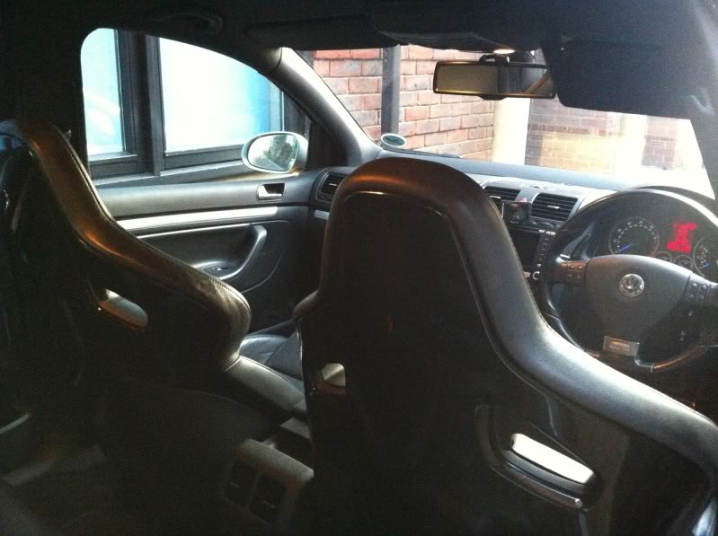

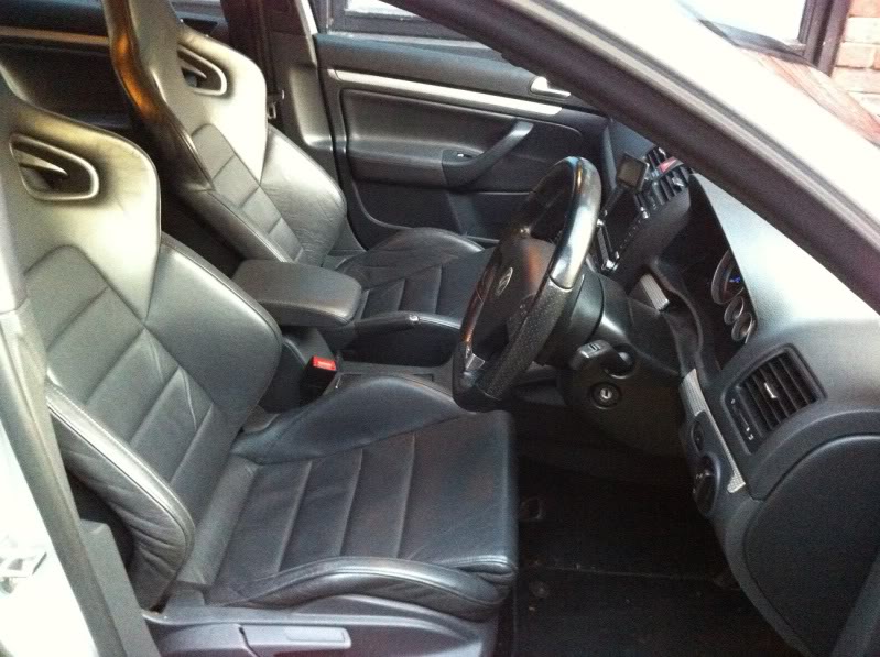

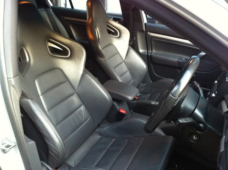

So last night, 8 days earlier than expected, the chap selling the Recaros delivered them to me from Ipswich. Cost an extra £60, but saved me the hassle of driving 250 miles after work in the cold & dark!!! Tbf, it would have cost me that in fuel anyways, so cant complain ... he's part-exing his car for a MK4 R32 this week so they needed to go asap basically.
Took about 40 mins to swop all 4 seats over, but i now have some VCDS programming to do to remove the Christmas tree of warning lights on the dashboard. Is seasonal though, so not the end of the world lol.
Excuse the cr4ppy iPhone pics, i will take some decent ones when i clean the car next. So sometime in 2013 i would have thought.
First impressions are that they are considerably harder than the standard ones, & less 'sofa like'. On the flipside however, they are a lot more supportive around the shoulder area, more deeply 'bucketed' and tighter around the hips. They are also a lot lower!! Feel like im now driving in the car rather than on the car. LOVE THEM!! :clown:

Out of interest, how adjustable are the Recaros and are they quite rare?
Looks lovely, top work on both the Haldex and Recaros. Please say this is coming to play at the next Llandow...
Not sure on the next Llandow day im afraid, dont have any more holiday days available until April :(
Have also done Llandow twice now, which tbh, is more than enough really, although it is quite amusing in the rain!!
Recaros wise, not that much adjustment really, just height, forward/backwards and tilt. No lumbar like the standard seats, but i normally have that as far off as possible anyway, so not an issue so far. Are still heated, more so in fact, my bum was roasting this morning, & not due to curry of any sort. Availability wise, they are rare as rocking horse sh1t, hence why i jumped on them, most people want part-ex for the 3dr standard seats (they tilt forwards), so finding someone that only needed 5dr seats was a rare occurence!! Were a £2.5k option when new (£1.6k for leather, then another £900 for Recaros) so they werent massively popular. Also, i wanted the ones with the R branding, instead of GTI, so again, limiting my scope for finding some.
