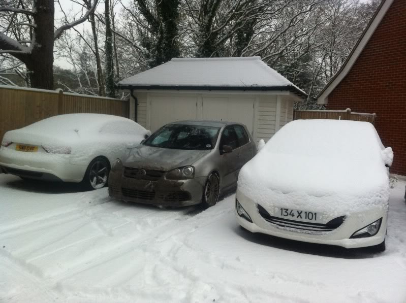

A quick question, what are those number plates on the car on the right? Keep seeing them; common, yet surely foreign?
