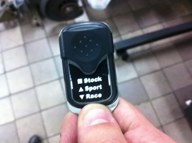

Not fitted it yet Ben, only turned up yesterday lol ... will be a job for the new year now i think. Wireless controller is quite cool though, just like a little key fob. All reviews suggest that its an excellent modification though, so just treat yourself, not like you'd lose any money if bought 2nd hand anyways.

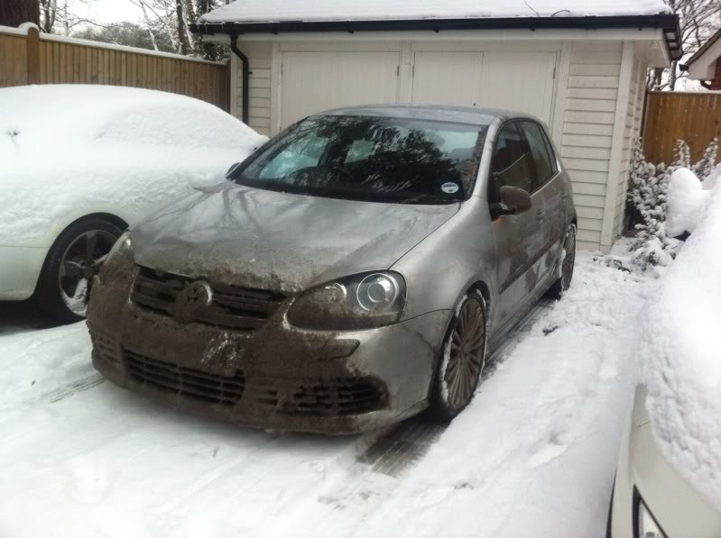

Not much of an update on the R32 as of late, other than to say its been brilliant in the snow, although the Haldex is a little weird for drifting/donuts, as you have to get the front wheels slipping/understeering before the rear wheels kick in ...

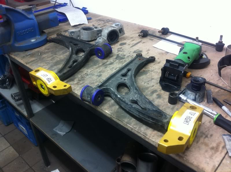

Few other bits being changed on Saturday to cure a knocking from the front end, namely Powerflex ARB bushes, Powerflex wishbone bushes,
Whiteline ALK, balljoints, trackrods/ends & more than likely fitment of the Haldex controller. Will also get the alignment checked & set for 'fast road' specs by the chap whose doing it all (Alex at AKS Tuning).

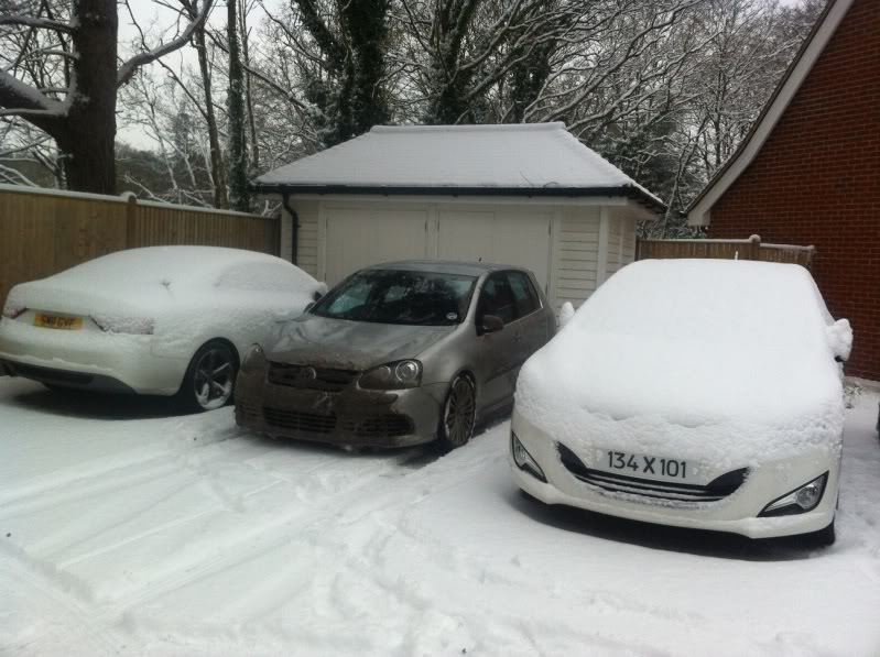

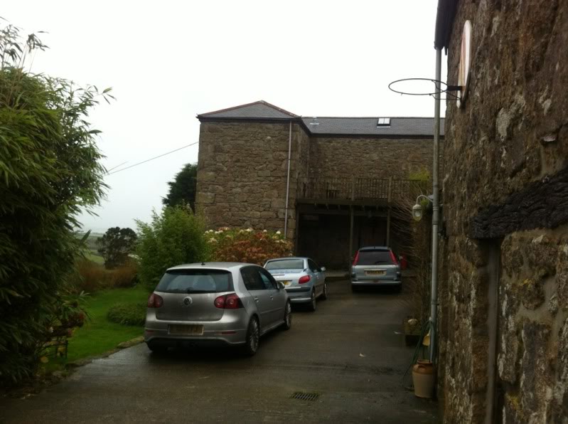

The above pictures are from last Friday, where i stupidly went to a meeting in Warwick (100 miles away) for 11am. At 12.30pm when i came out, the world was white. After having to go 'off-road' and follow a Rangie down a snow covered dirt track (to avoid a massive traffic jam onto the M40), i can safely say that if i didnt have the R32, i wouldnt have got home :clown:

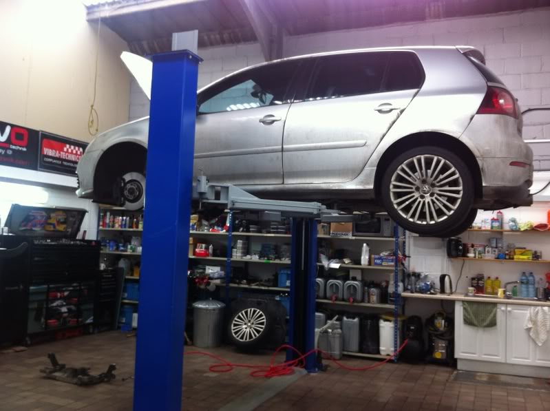

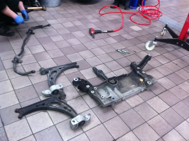

So on Saturday, the final pieces of the R32 jigsaw were put in place at AKS Tuning in Bedfordshire, mainly to solve the rattly front ARB, but also to tighten everything up at the front end, reduce understeer and generally make it a much nicer car to drive.
Subframe, wishbone, ARB all off - not the easiest of jobs on a lift, so glad i didnt attempt it on the driveway!!!

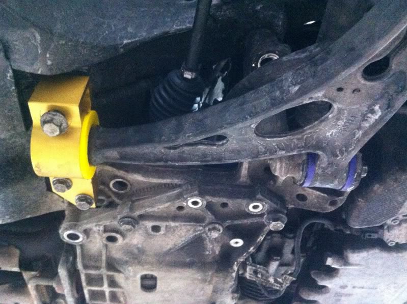

Powerflex wishbone bushes pressed in & whiteline anti-lift kit fitted:

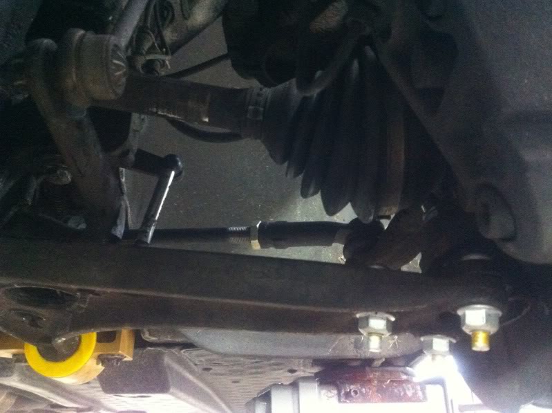

Fitted back onto the car:
Along with new balljoints, trackrods, steering arm gators and subframe bolts:
Alex noted that the trackrods were a little knackered, so that would have definately been contributing to the slightly loose feeling in the steering!! Also mentioned that the front coilover struts werent fitted quite right, ie they needed to seat a further 5mm down into the hubs. He sorted it out, but the car is now another 5mm lower, which means it scrubs & catches on everything!! Bit of a pain as it means ill have to set the ride height up again, c'est la vie ...
Final addition was the wireless haldex controller, took 10 minutes to change the unit under the car, then another 15 to get the wire from underneath into the transponder in the boot. Then have a key ring to adjust throug the settings as & when required:
First impressions? Steering & front end are amazing (despite the tracking being so far out that the steering angle sensor warning light has come on lol), turn in is sharper, grip is better, & as a bonus, there is some additional weight to the steering - which is always a welcome bonus. Ride is slightly harder due to the polybushes, but i dont think the slightly reduced suspension travel is helping either tbh.
Haldex controller? Havent really pushed the car at all, but you can feel some additional 'push' from the rear when you really boot it. Certainly not a drifting machine, but the grip is phenomenal now. In the interests of science i absolutely hoofed it in 1st coming out of the junction last night, in the p1ssing rain, and it basically just f*cked off up the road, no understeer, no wheelspin, just launch.
