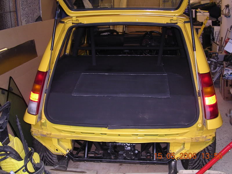

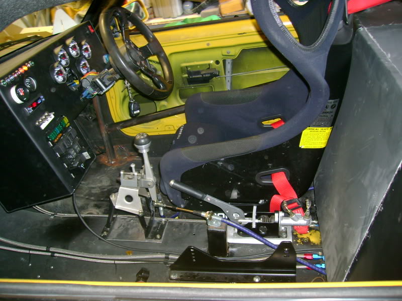

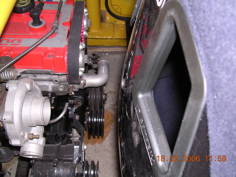

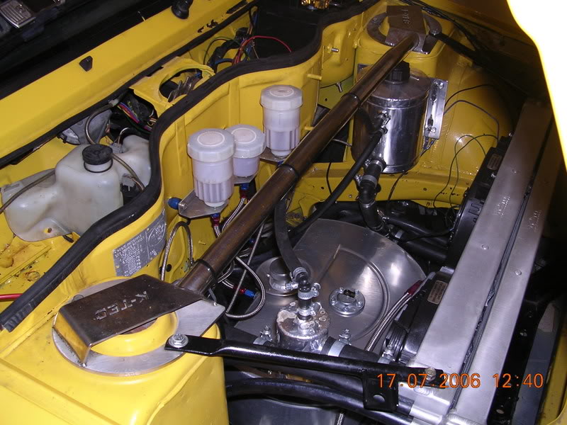

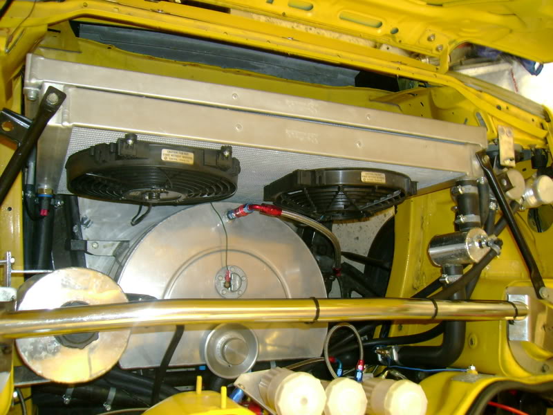

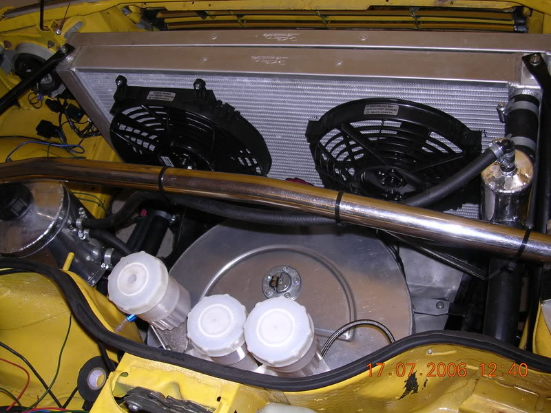

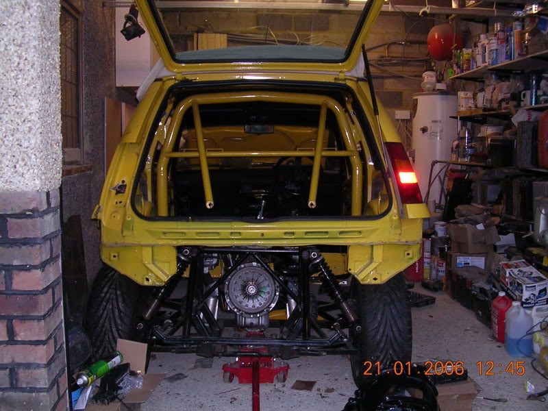

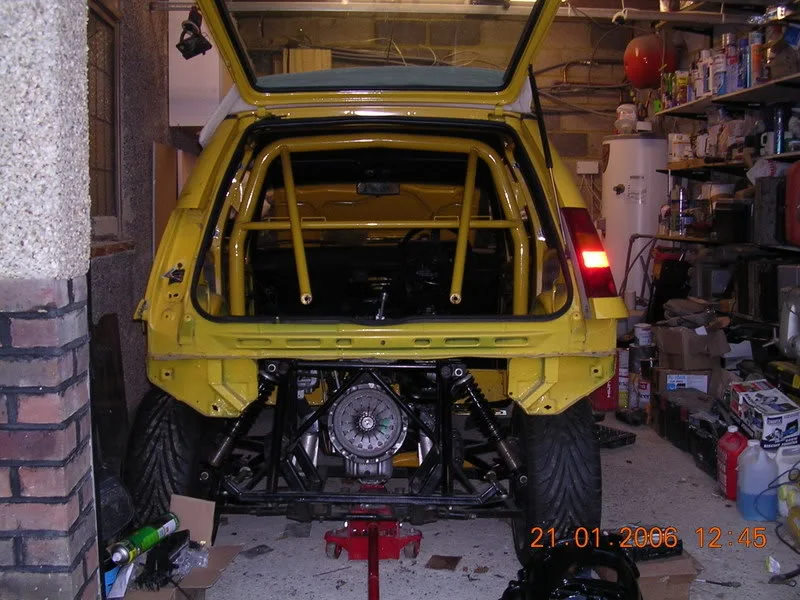

R5 GT Cosworth.
This is truly awesome!!!

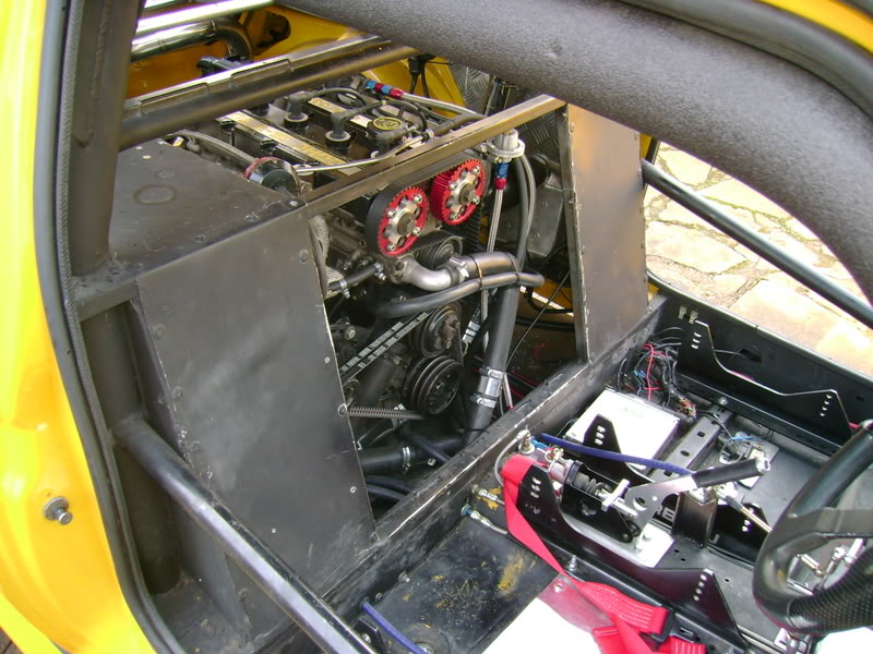

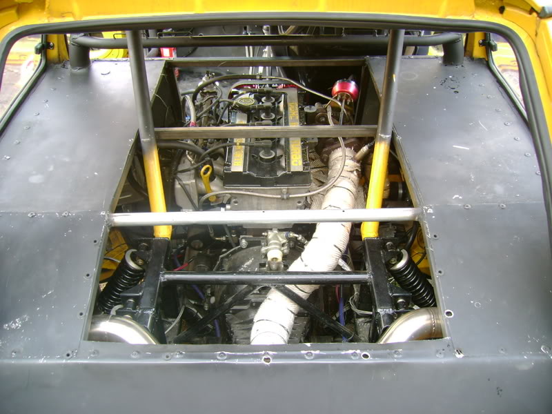

engine
2litre 16v 2wd sierra cosworth engine
t3 turbo
bosch 803 injectors
21 psi boost
grp a coil
grp a regulater
grp a headgasket
4x4 inlet manifold
vernier pulleys
huge pace ally radiator
ally swirl pot
ally header tank
2 fans running 2 stage switch + override
2 charge coolers, 2 pumps, 2 swirlpots
huge pace ally pre rad
ally grp a oil breather system
bosch 044 fuel pump
-6 fuel lines and fittings
pro alloy foam filled fuel tank
un1 gearbox
ap cossie/reno clutch
oil cooler
level 8 management
running approx 340 bhp lb/ft
chassis

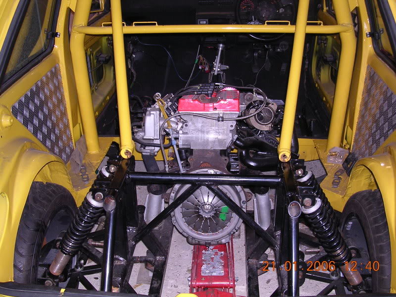

ford rs200 rear spaceframe
engine/suspension all bolted to cradle
full welded in roll cage tagged to body everywhere and to space frame
std r5 front end upto where rear seat used to start in floor

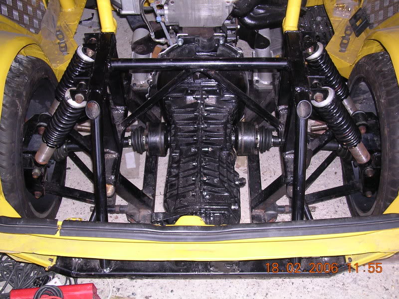

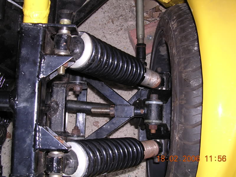

rear suspension
rs 200 setup inc.
4 coilovers
double wishbones
tie bars
race polybushes
2wd cossie hubs
all adjustable in every direction
front suspension
avo coilovers
race polybushes
r5 hubs with ford stud adapters

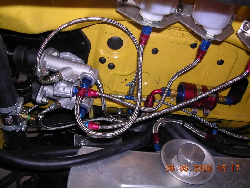

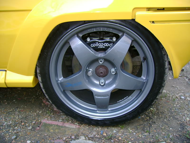

brakes

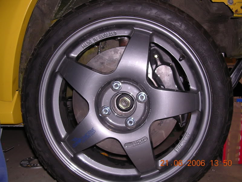

ap 4 pots up front 330 mm discs
wilwood 4 pots at rear 300mm disds
group n corsa bias pedal box (adjustable in dash)
-4 braided lines throughout
hydraulic handbrake

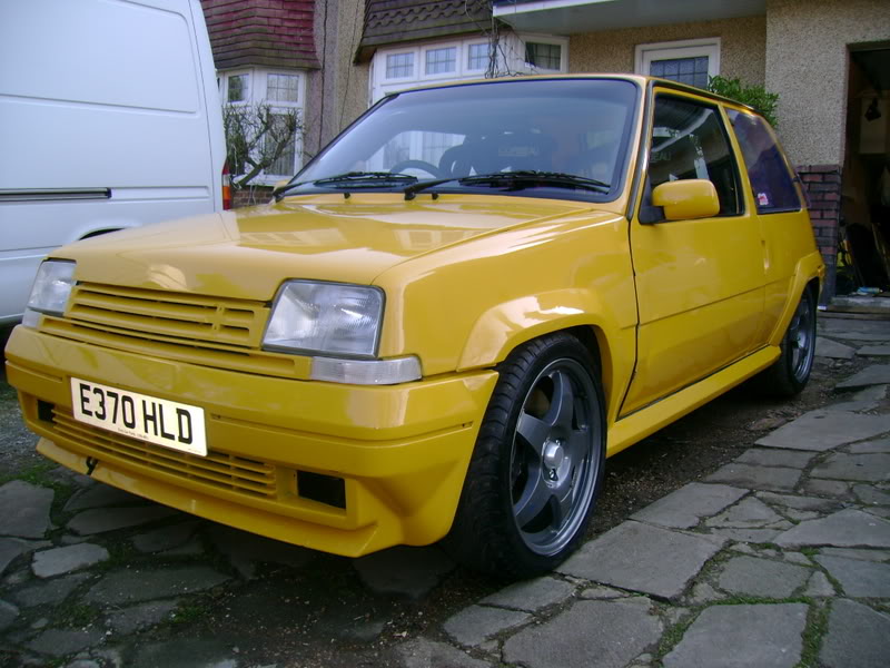

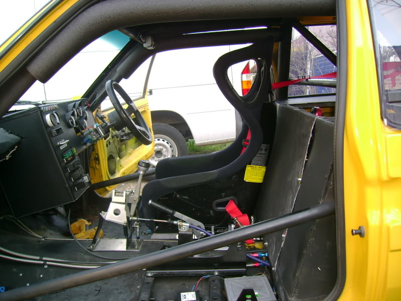

std bodywork outside

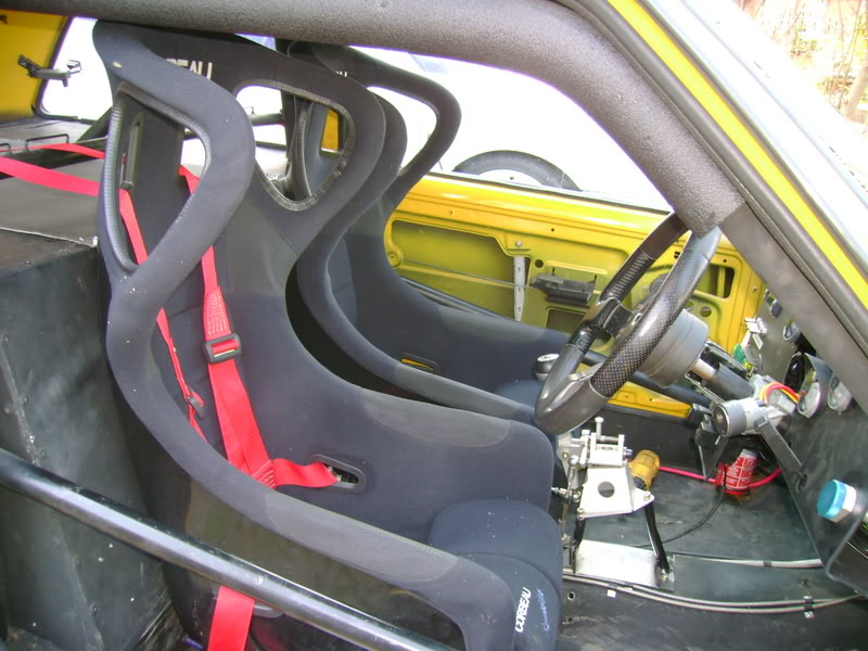

fully stripped inside
2 corbeau revolution seats
homemade ally dash housing clocks and relays/fuses
cable gearchange
plastic windows
billet compomotive mo's (very strong (and expensive))
kerb weight under 1000kgs
probably loads ive forgotten, anything u wanna know just ask

whatever it is with a cosworth lump in and on a space frame it is going to be like s**t of a shovel, it looks so standard as well which is the best part about it - everyone is just going to think another chavved up lowered R5 running ok power but unreliable - until you decimate all.

thats my mate stu's r5 took him 2 years to build and cost a fortune!! had it set up by joe stevens last week think its about 340 as quoted. this is the first time he has put pics up of it on the net he kept it under wraps even from most of his mates when he was building it. where did u get the pics from mate?

Yeah Stu's little project as someone mentioned, the R5/RS2000/Cossie hybrid, awesome machine, bar steward told me it was special, but not this special!!

This would destroy an M3 from a roll without any problems. Similar/more power and more torque and lots less weight... Probably 8 or 9 secs 0-100 and I suppose only gearing will affect top end.
