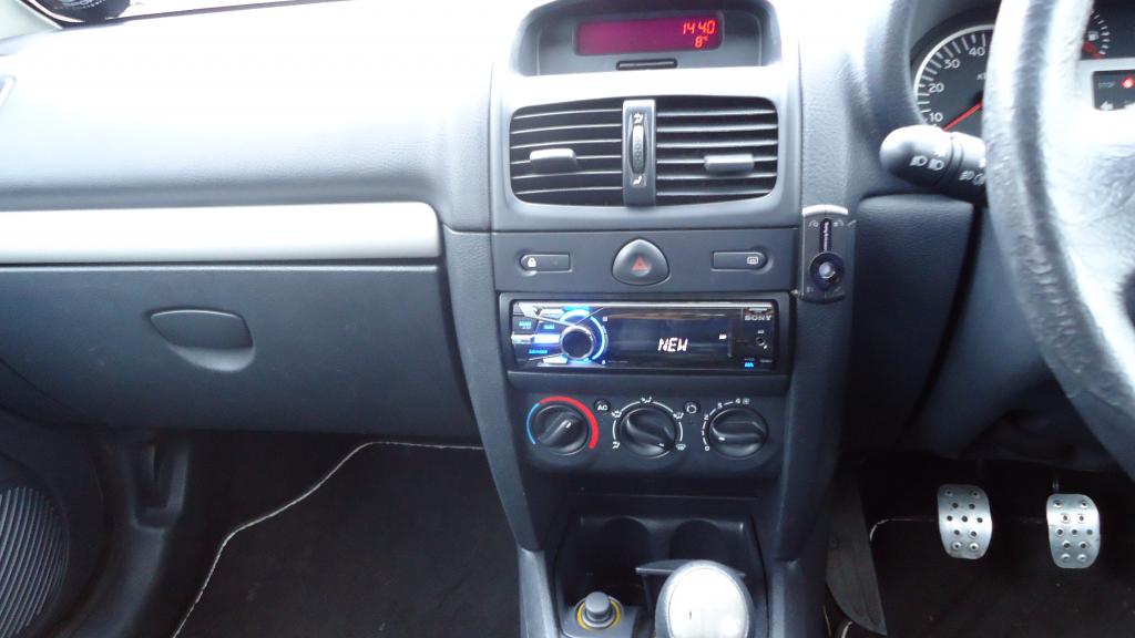

*Fitted Sony IPOD headunit and patch lead (Ipod is hidden in head unit so no wires out the front)

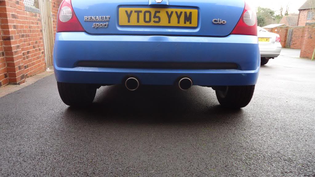

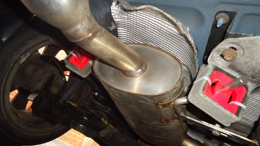

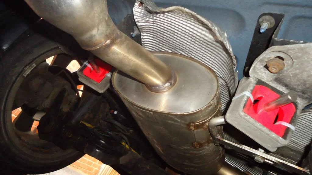

After fitting the new exhaust mounts the exhaust still does not sit correctly but is mounted very securely, unlike with the awful Renault ones that were perished. A friend of mine is going to heat up the hangers and try to sort them on his ramps
Now have a perfectly aligned Miltek;)

Looks good, I like the exhaust mount solution. The ones on mine at the moment are just filled solid with some plasticcy gunk (wasn't me!).
Where about did you get those inserts from? I can't seem to find anything online...
I found the details on here.
http://www.cliosport.net/forum/show...ified-exhaust-mounts&highlight=exhaust+mounts
Ordered 2 x EXH 008 Powerflex mounts off Fleabay for £12 inc postage ;)
Bit tricky to get it sitting dead centre but I got there in the end with some modifying of the 3x holes in the bracket to allow left/right movement as well as foreward/backward. Putting the holes dead centre did not work for me but many said it dod so take your time and it will do the job.
I had read that the Miltek systems did not always sit dead centre and mine was well off. It was just a case of trial and error. I fitted the powerflex mounts as per the guide on here. I had to modify the mounts to allow some movement side to side and i adjusted the brace strap between the two back boxes and put a couple of washers in there to get both sides sitting correctly. When it warms up it still makes contact with the bumper on tickover so i need to drop the tailpipes by a couple of mm. I will just add a couple of washers to do this i think.

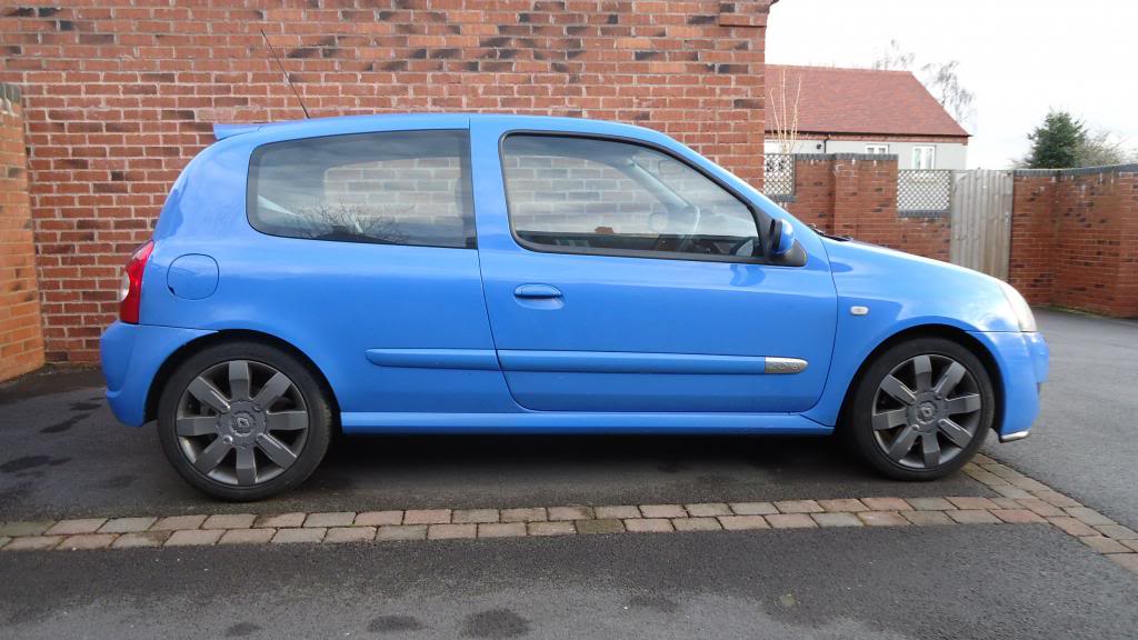

Before fitting Suspension:

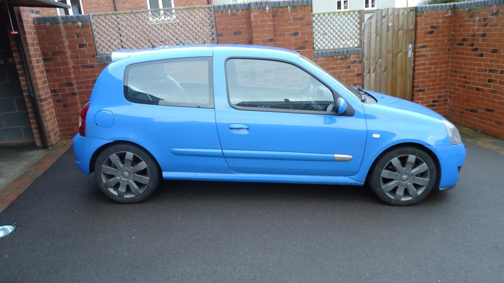

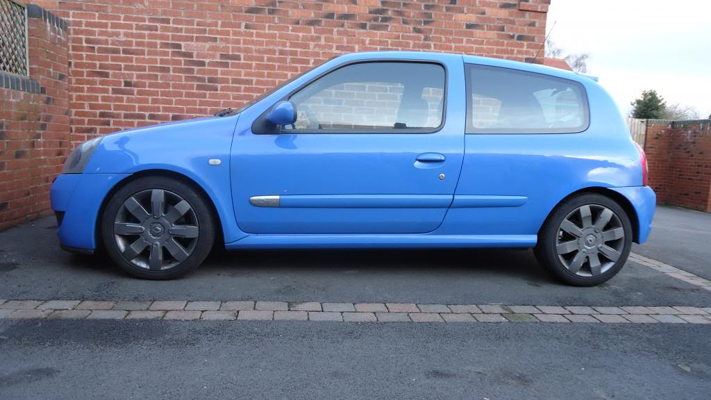

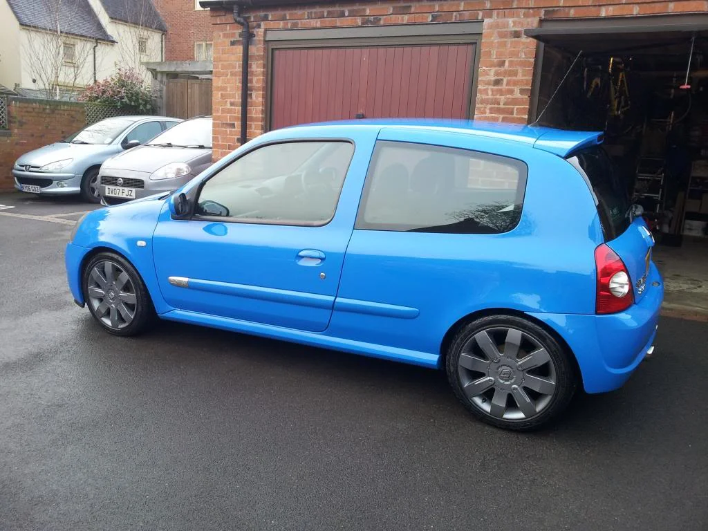

After fitting Suspension (car needs to settle a little)

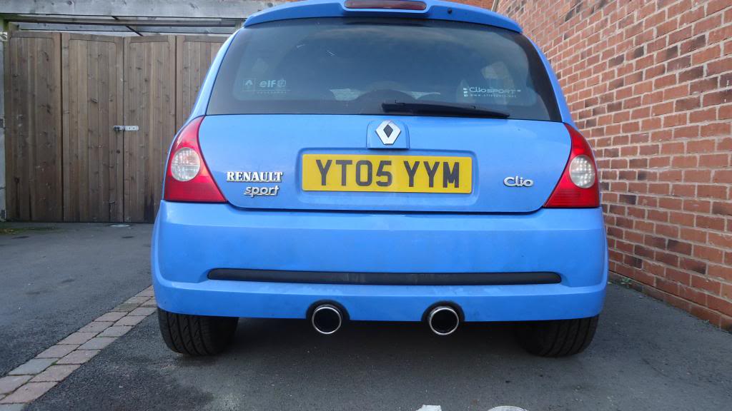

Also, a picture of how the exhaust sits now. (Also put some black door draught exluder foam strip on parcel shelf mounting plastics to stop vibration)

After a couple of very steady runs around the block to test everything and check over all the new parts I went for a slightly more brisk run out. The ride is transformed and feels so surefooted, compliant and fresh, just like I remember my new Cup felt all those years ago.
Big thanks to Josh at Cooksport and Adam at Autoworld for all their help :star:
Will take some pics after a good drive out tomorrow. I was not really after a super low look but a good ride and improved handling. May as well try to improve the cars best feature
Just gave the car a quick wash. The suspension is great. Car is still compliant for day to day use but the ride height looks good now, being not too low and the composure over bumpy roads is excellent.

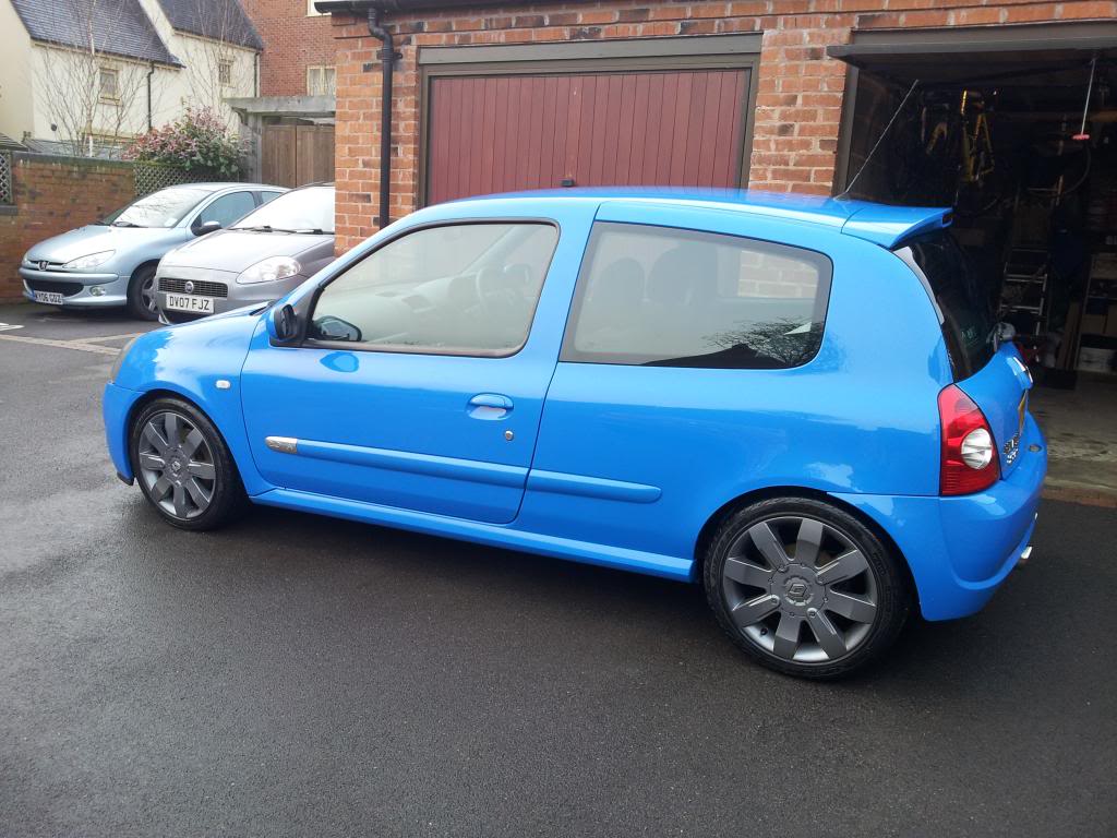

Meguiars tyre shine. Pretty good stuff, an old bottle in the garage. Made an effort for the picture ;)
Splitter was on car when i purchased it so not sure if its KTEC. I like it though. Fairly subtle as i want to keep it really
