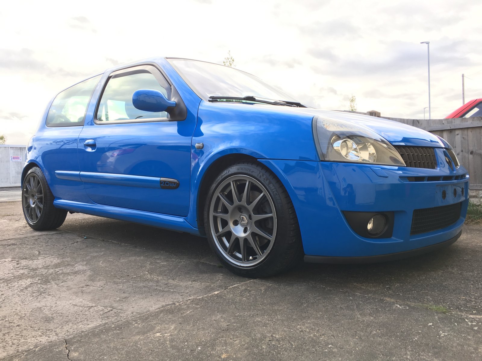

@BGEarles dropped his 182 off on Friday for me to go over.
I don't know where to begin as this thing was the most awkward car to correct I've ever done. I really wasn't expecting the paint to be so solid.

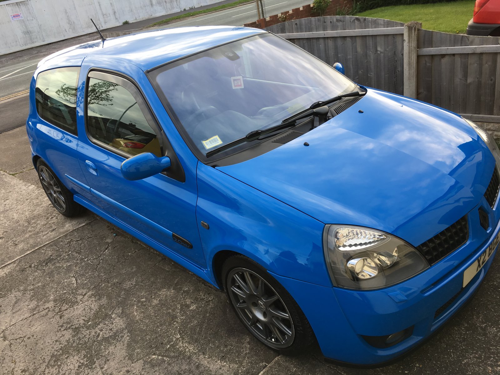

Anyway, Ben dropped the car off and I cracked straight on, I forgot to get any befores but it was pretty clean

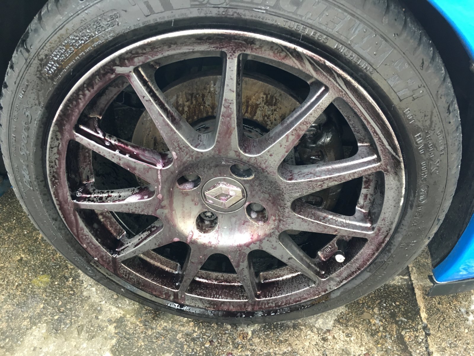

Wheels done in hot wheels, agitated and sprayed
Lovely

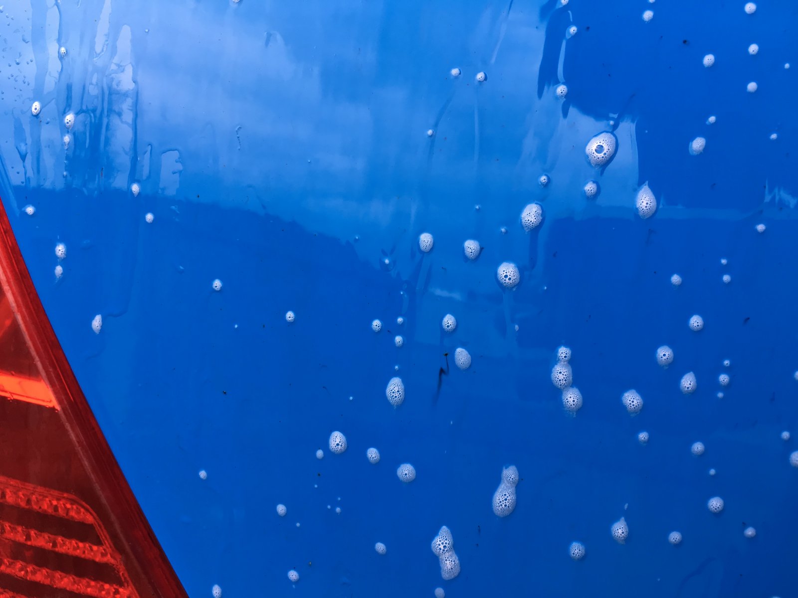

Car washed with chemical guys maxi suds

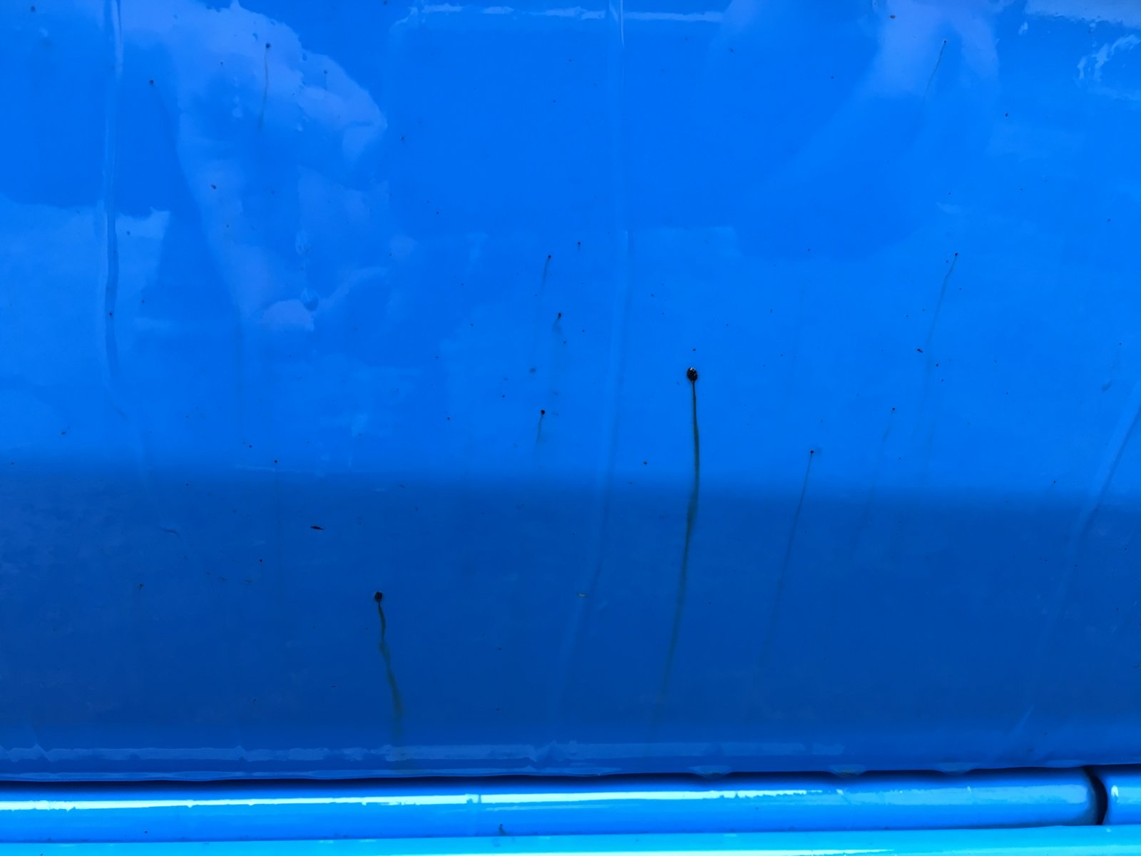

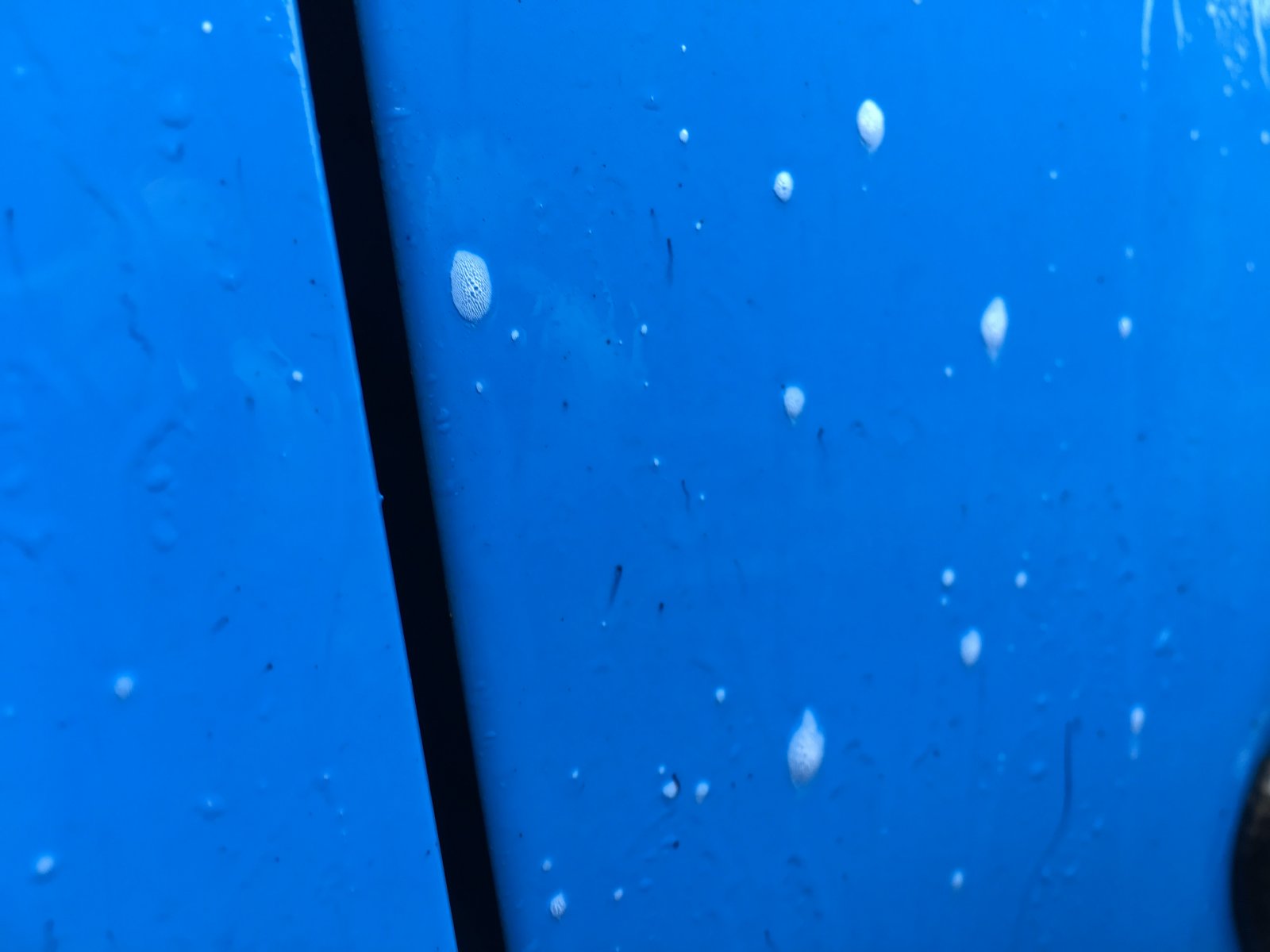

There was a fair few tar spots around the lower areas
And a bit of fallout

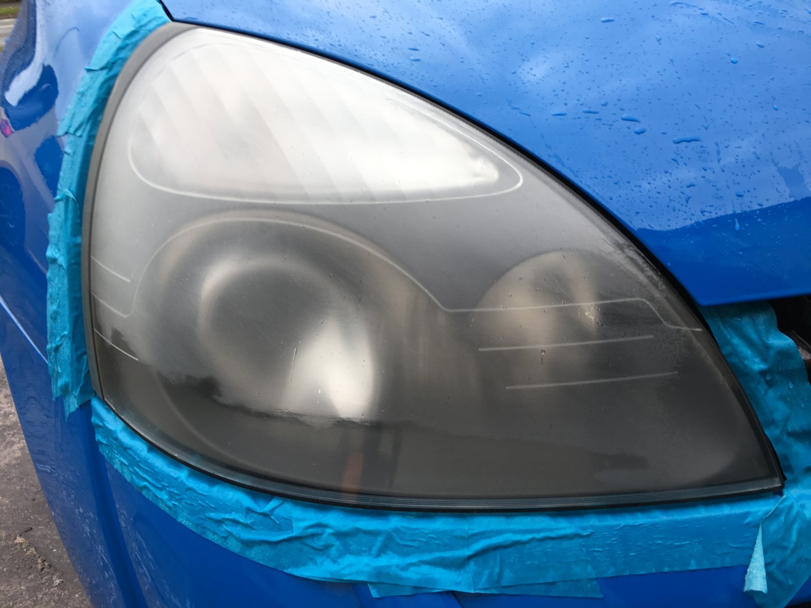

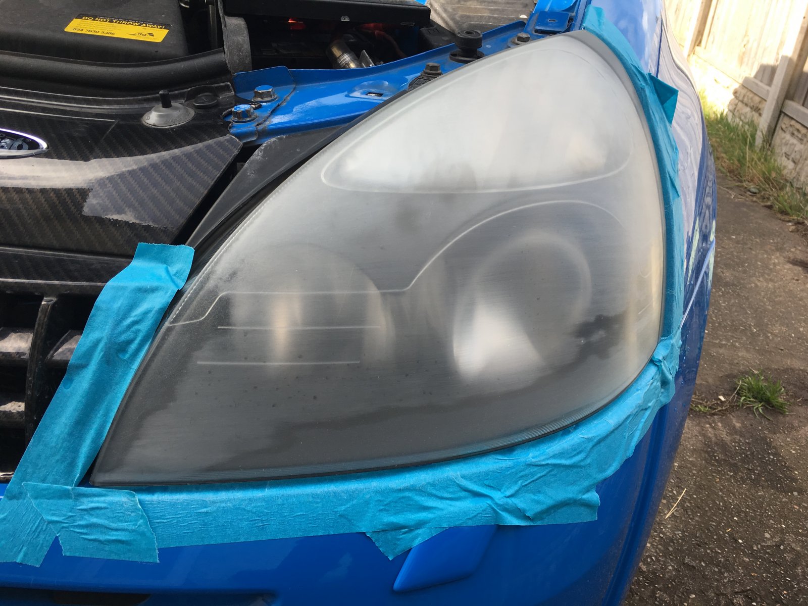

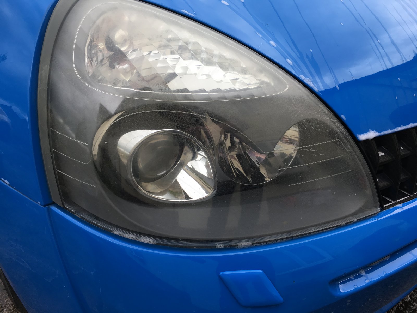

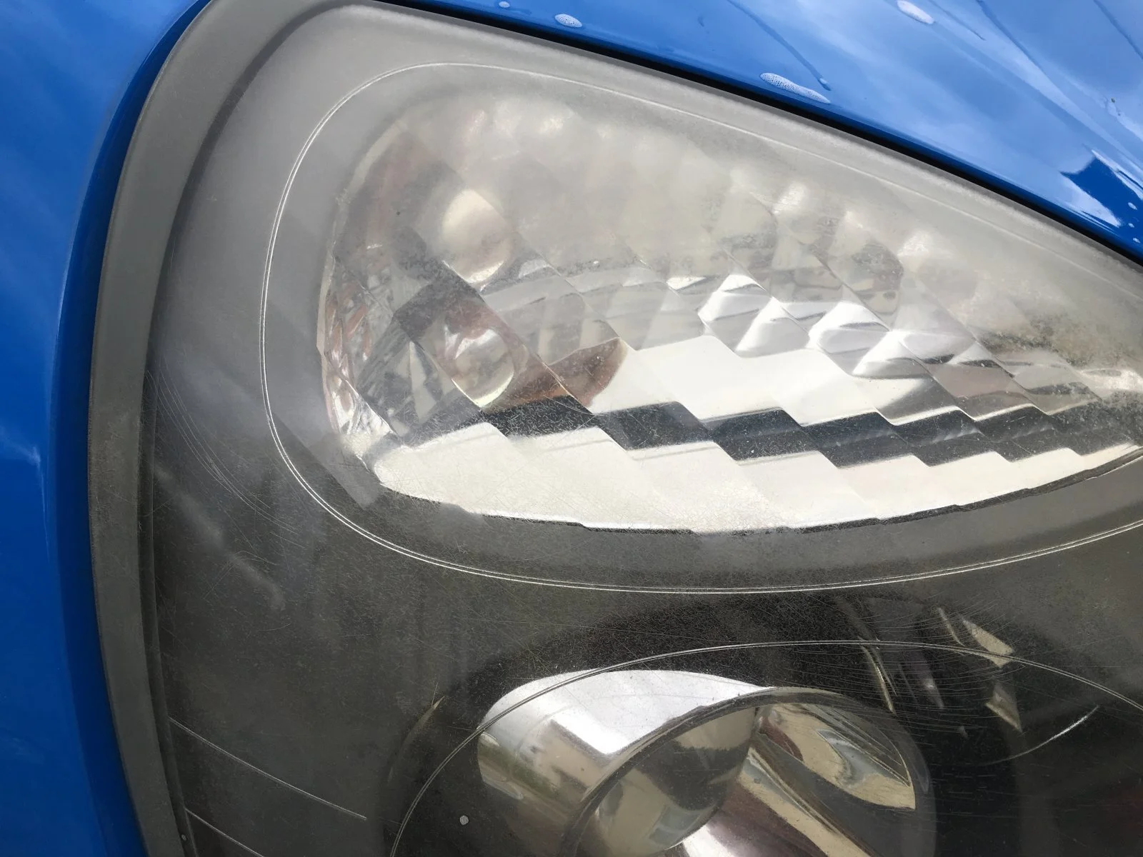

The headlights were a bit hazy so I was asked to give these a going over, so I
The hazing was deep in places so I worked from 800 grit up to 2000 grit after the final wash.

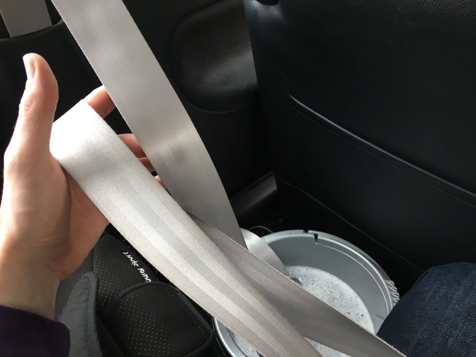

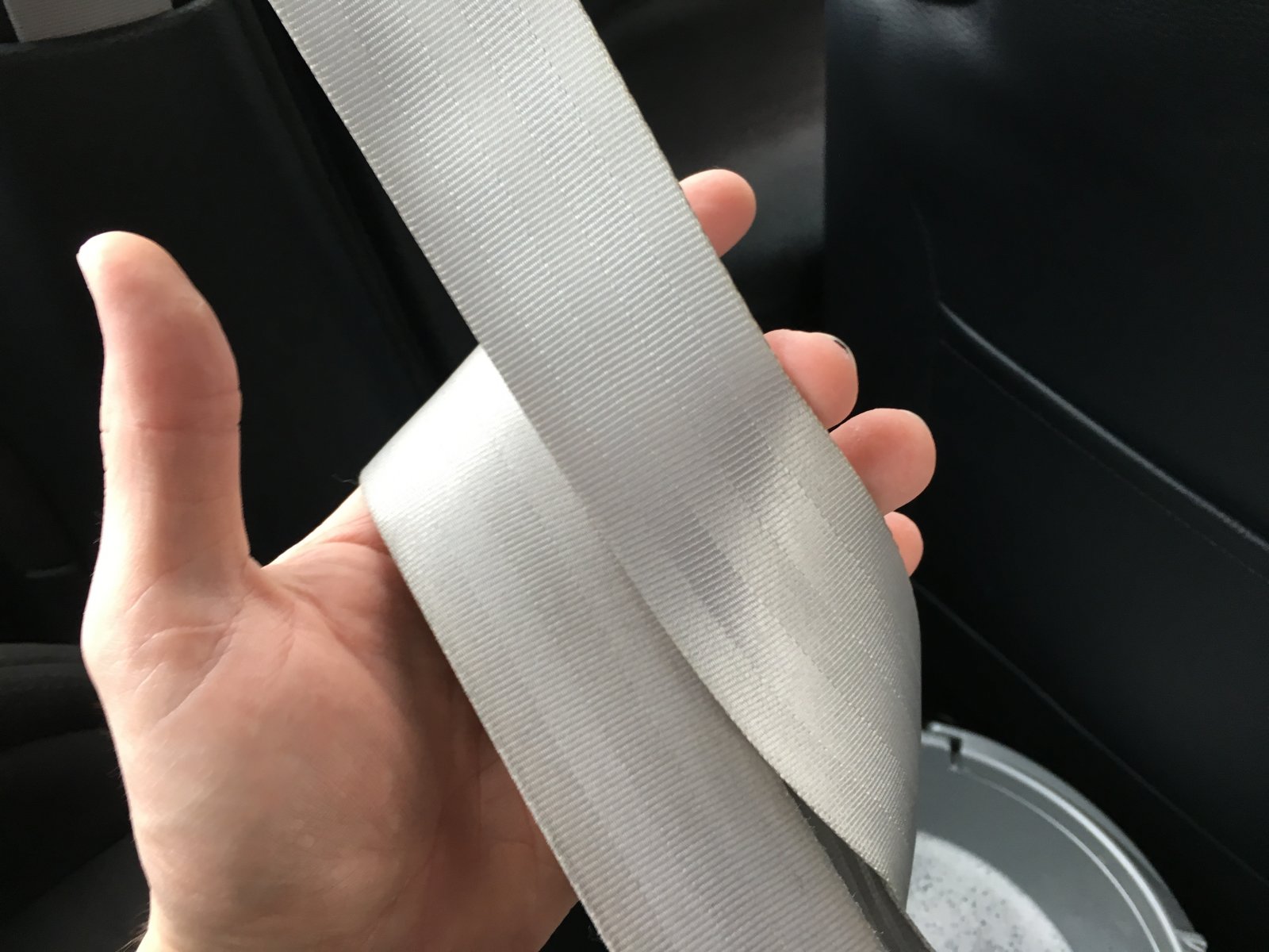

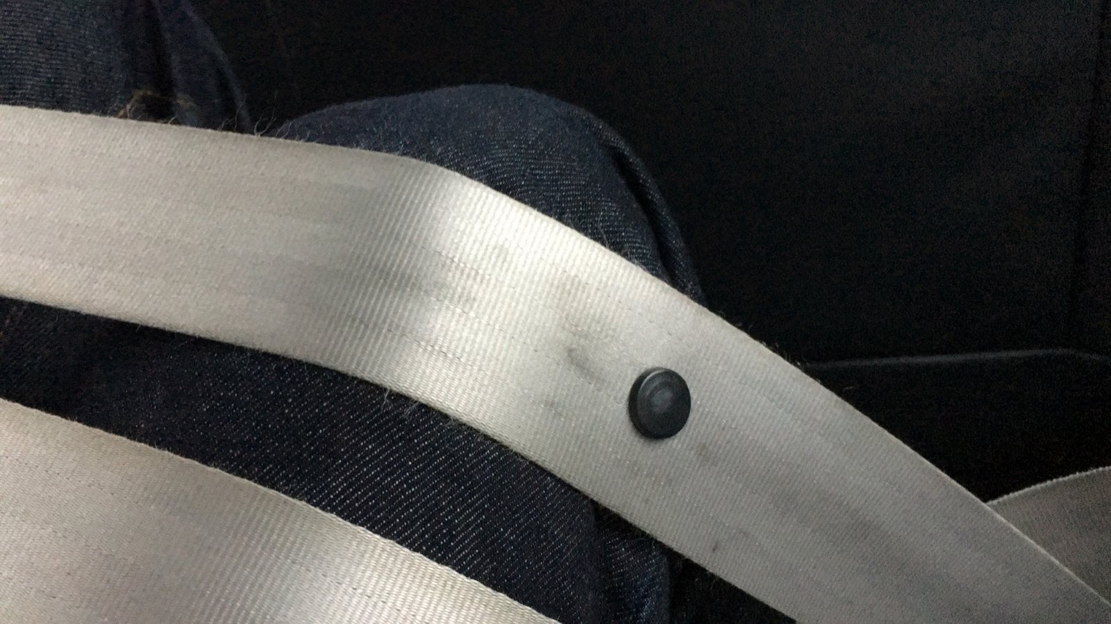

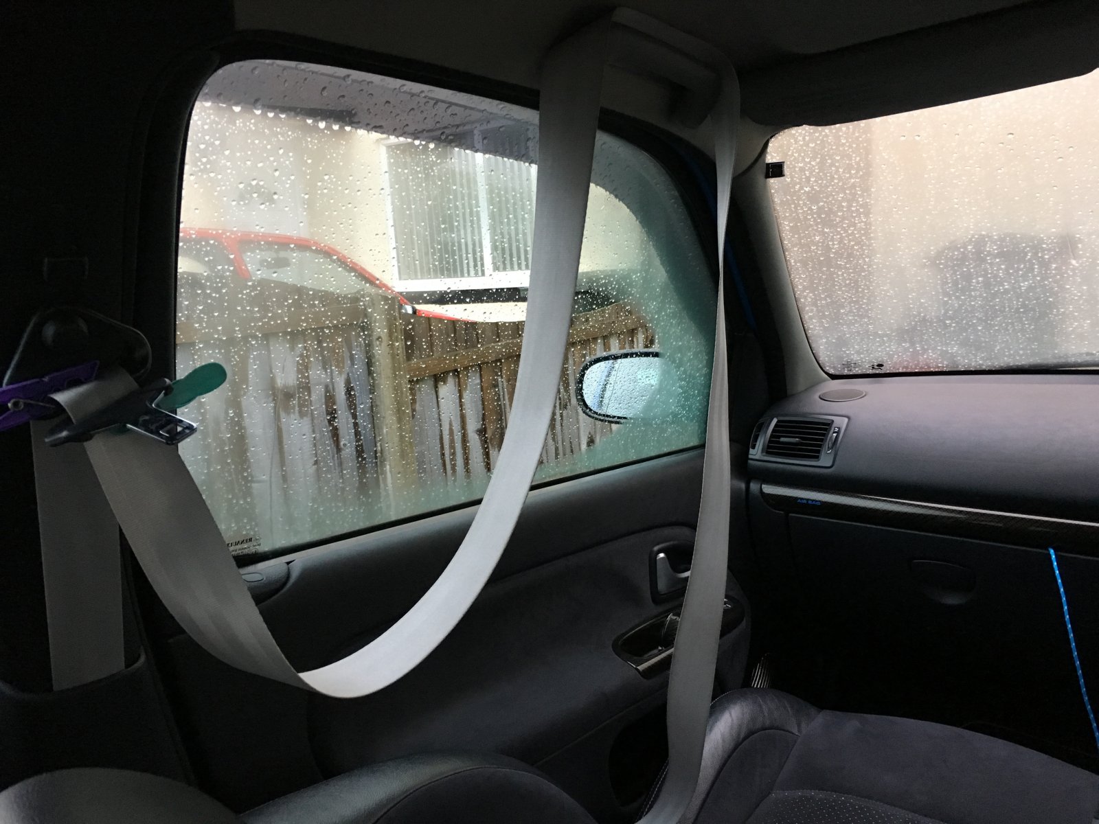

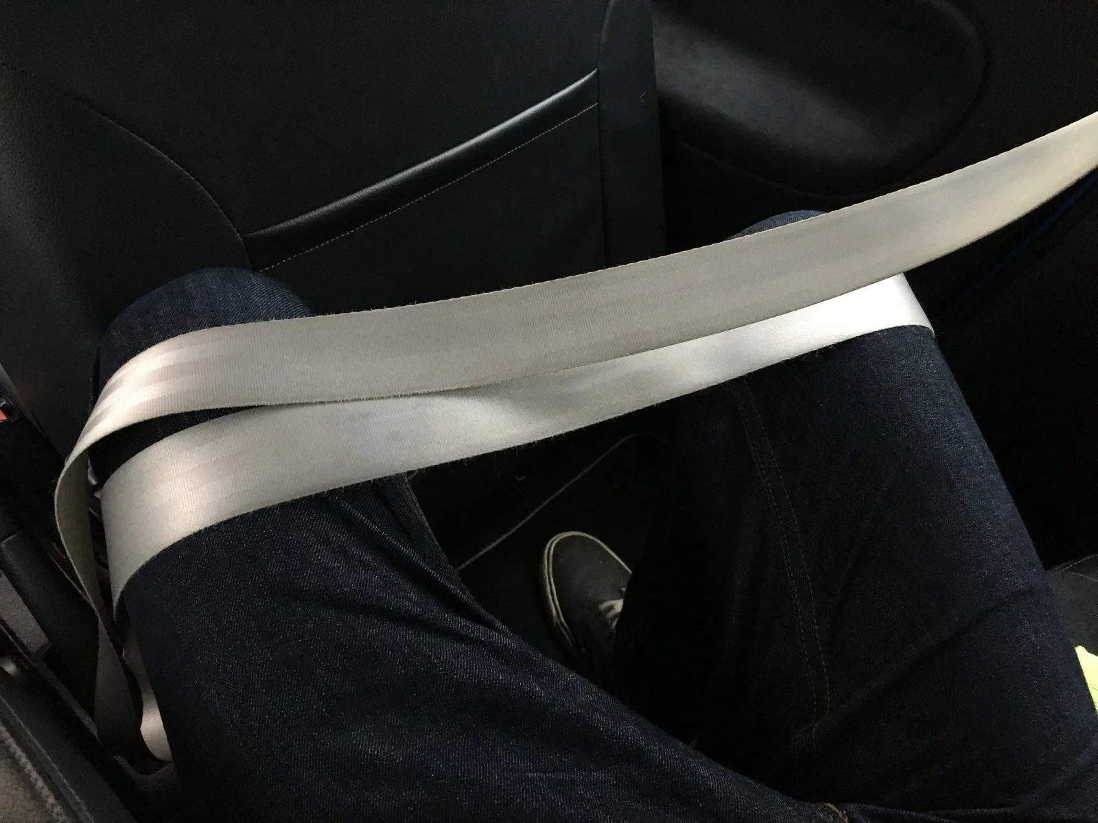

Then the heavens opened so I sat in the back seat with a bucket to clean the belts.
Drivers side after a quick scrub
After a bit more scrubbing
Clean drivers side against the clean bit of the passenger side. Good match Imo :D
I couldn't get any more out of this nasty stain but it dried pretty faint

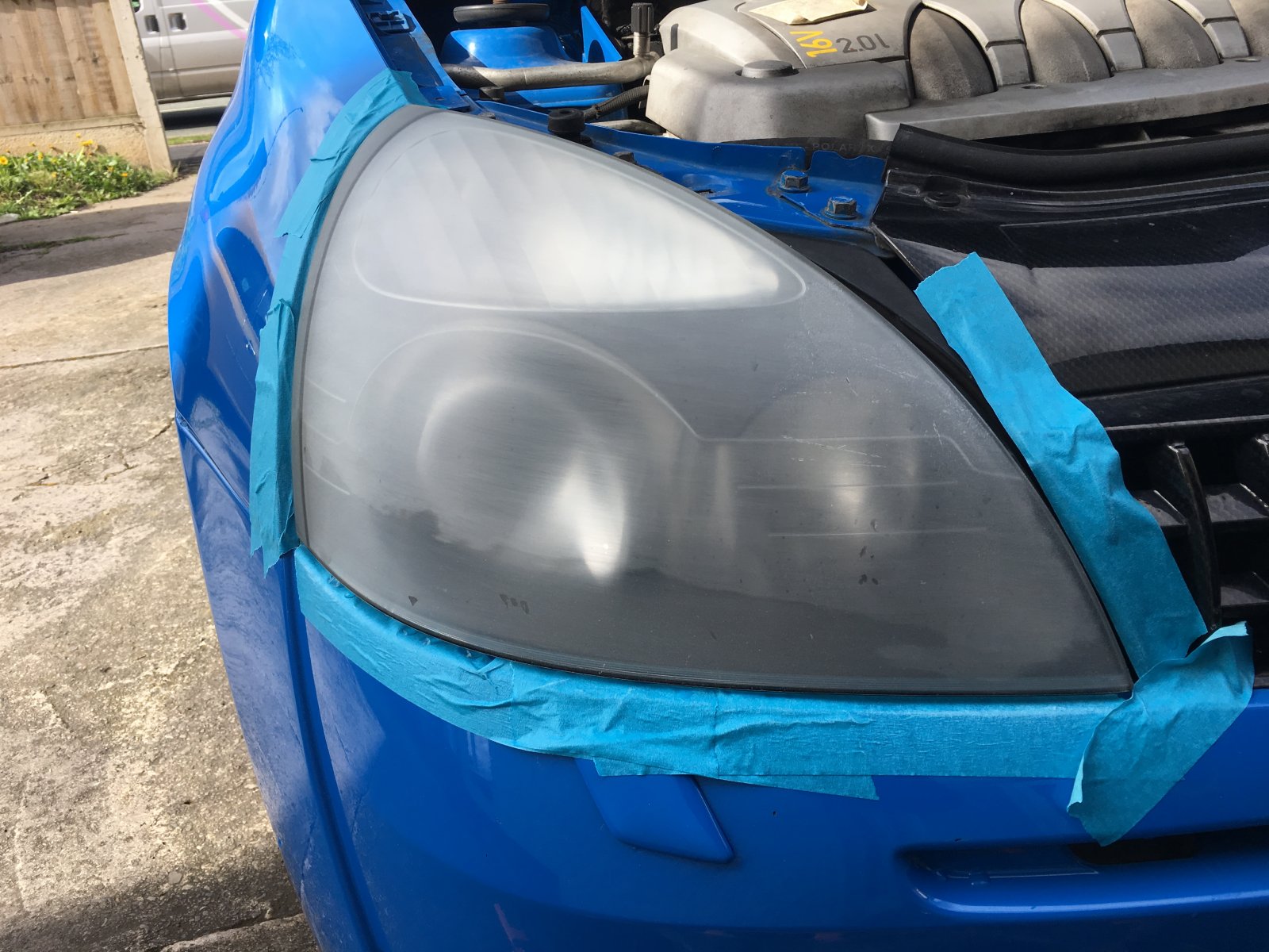

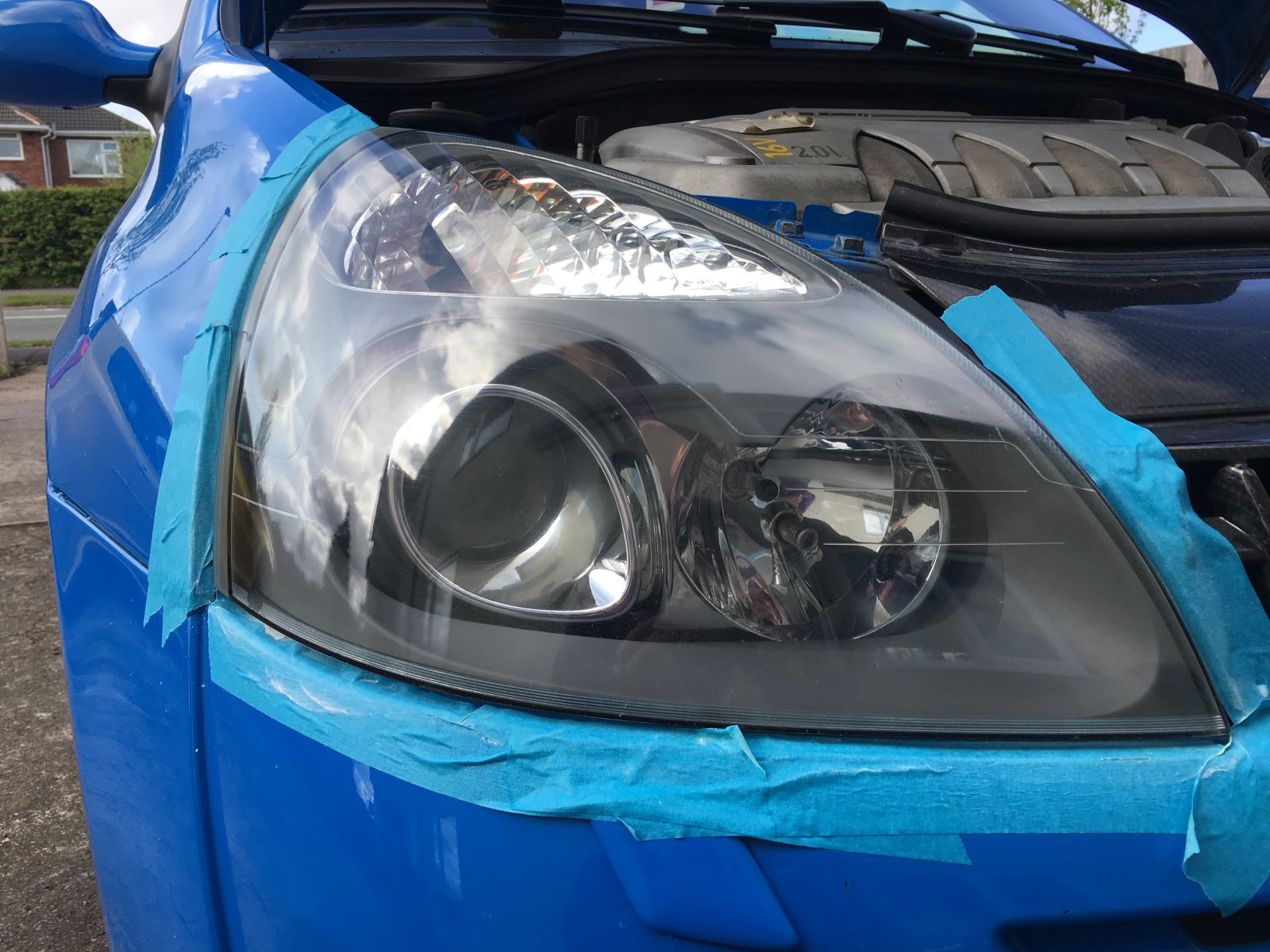

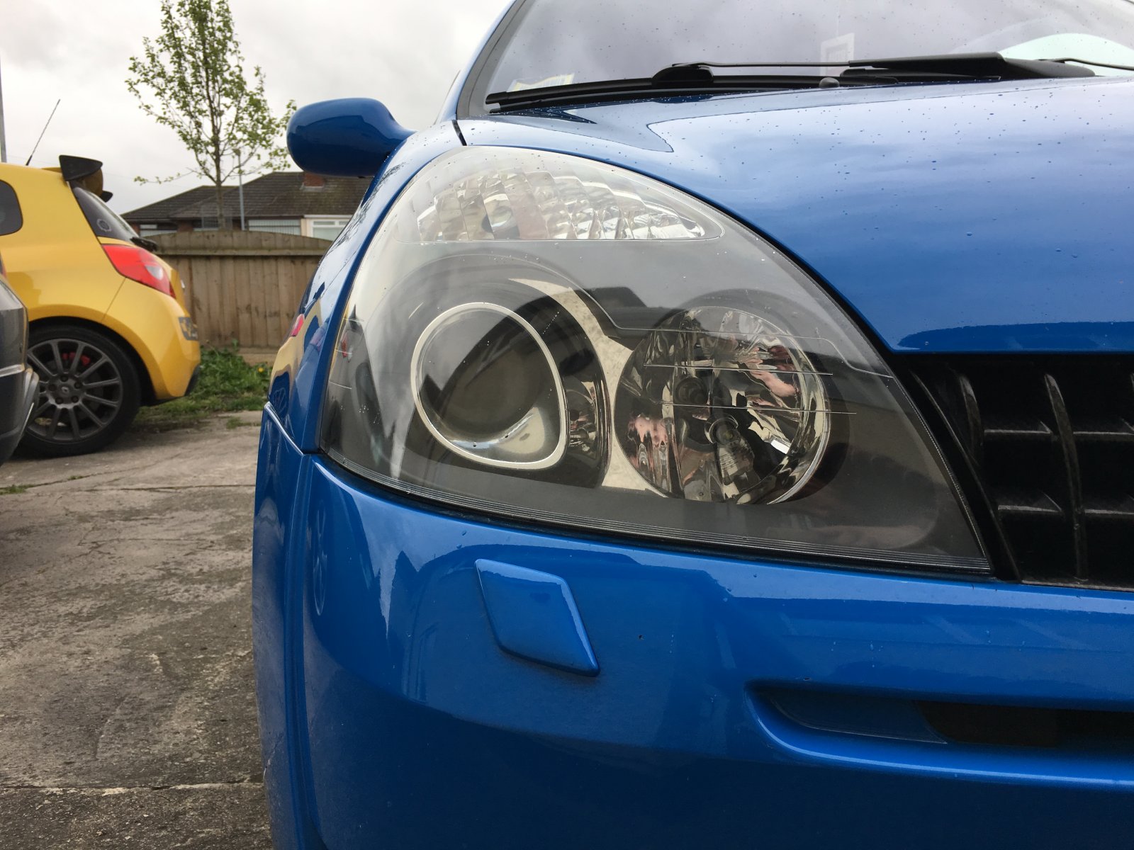

The following morning I cracked straight on polishing the headlights with G3 scratch remover followed by auto finesse #2 (can't remember the polish name) followed by carpro essence

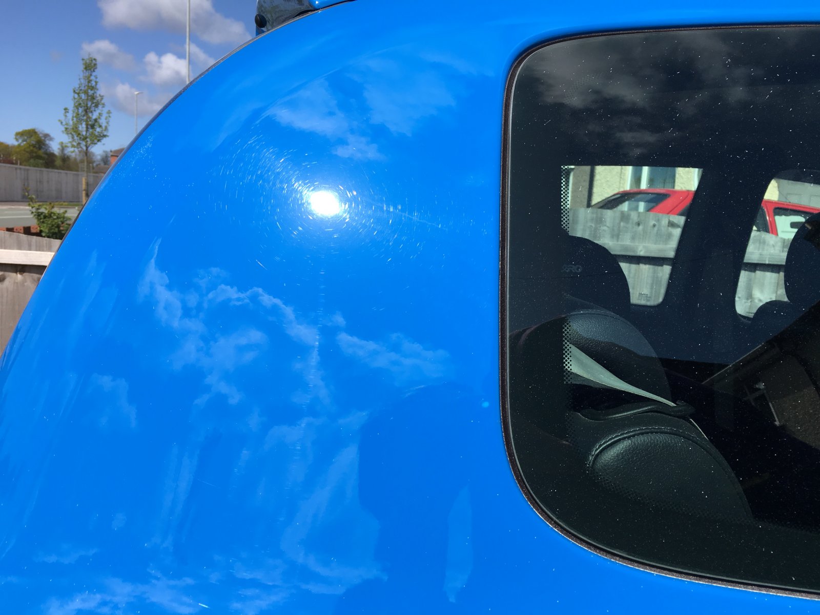

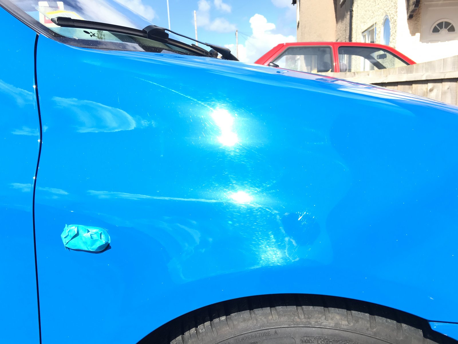

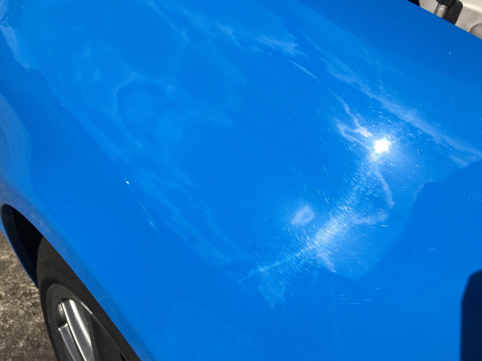

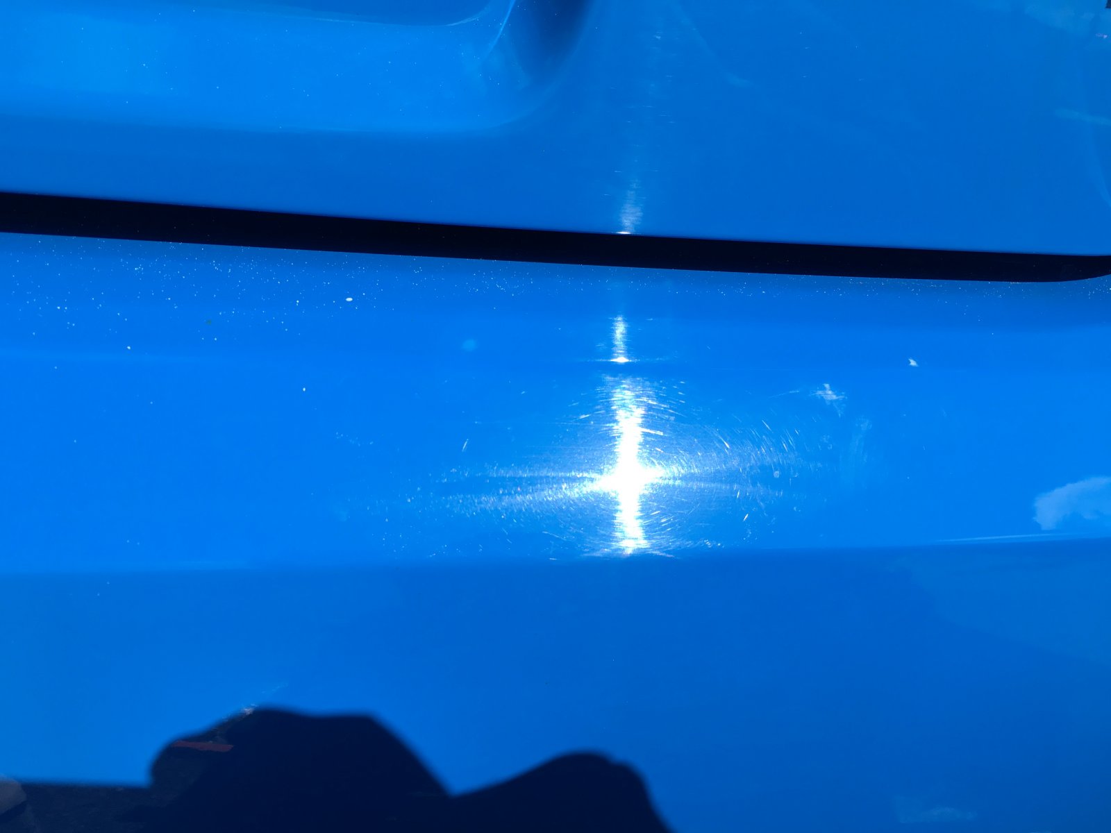

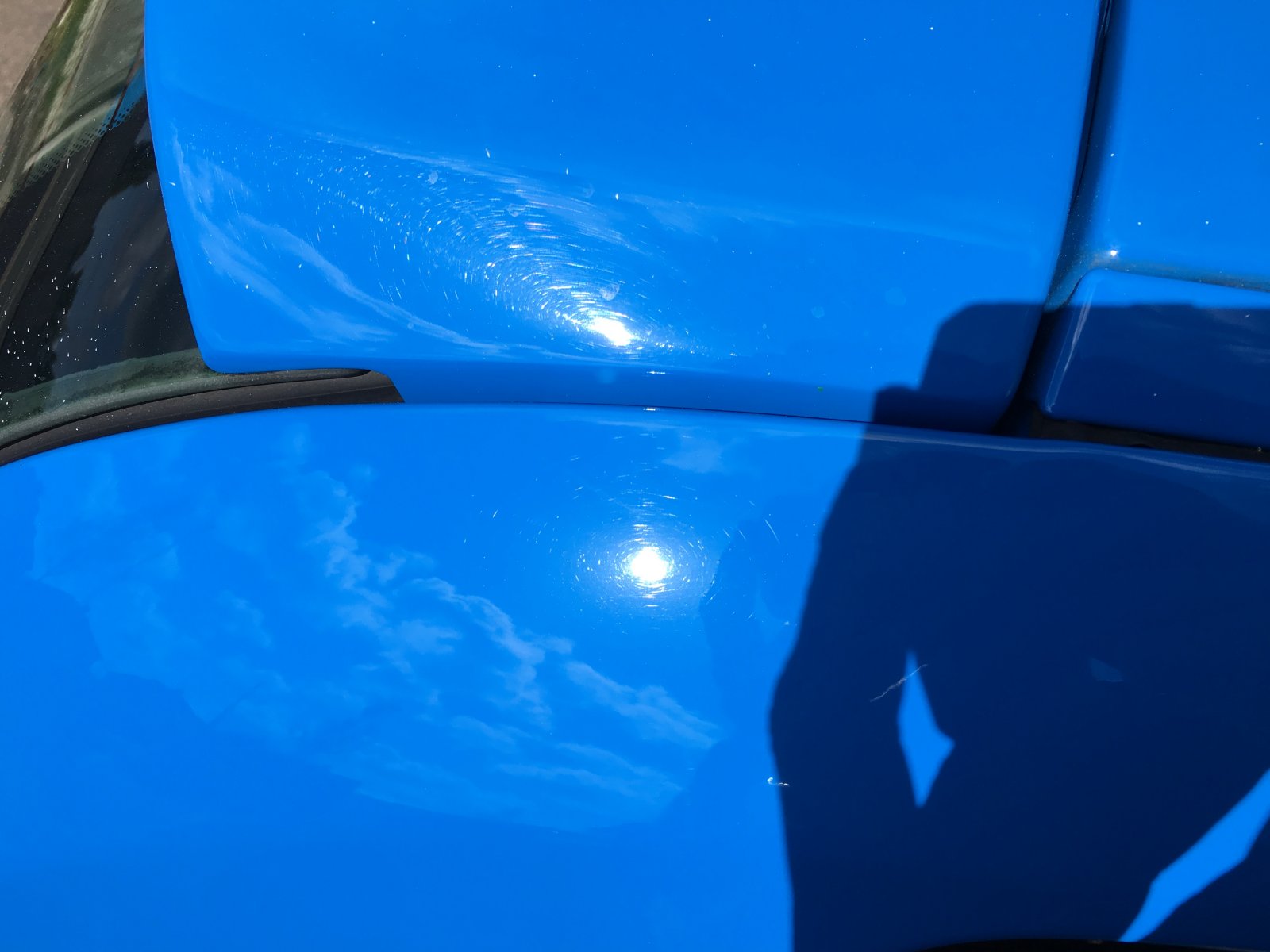

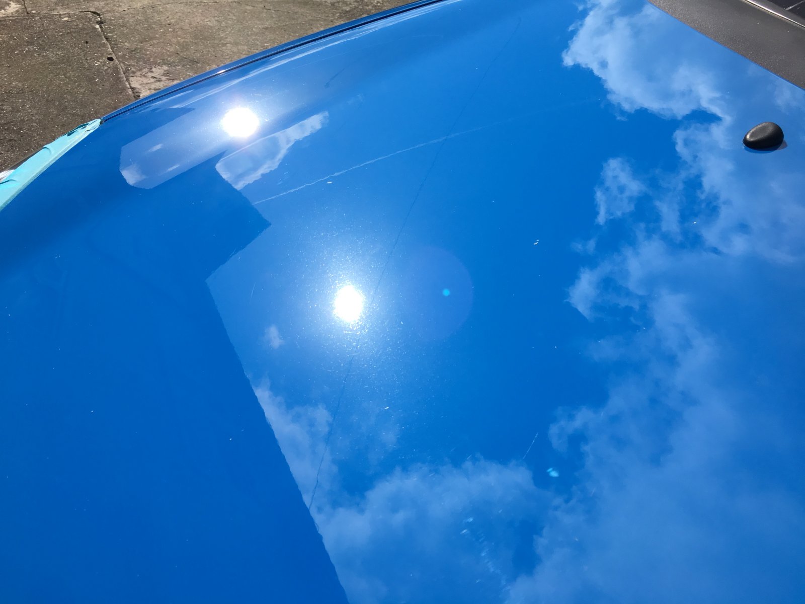

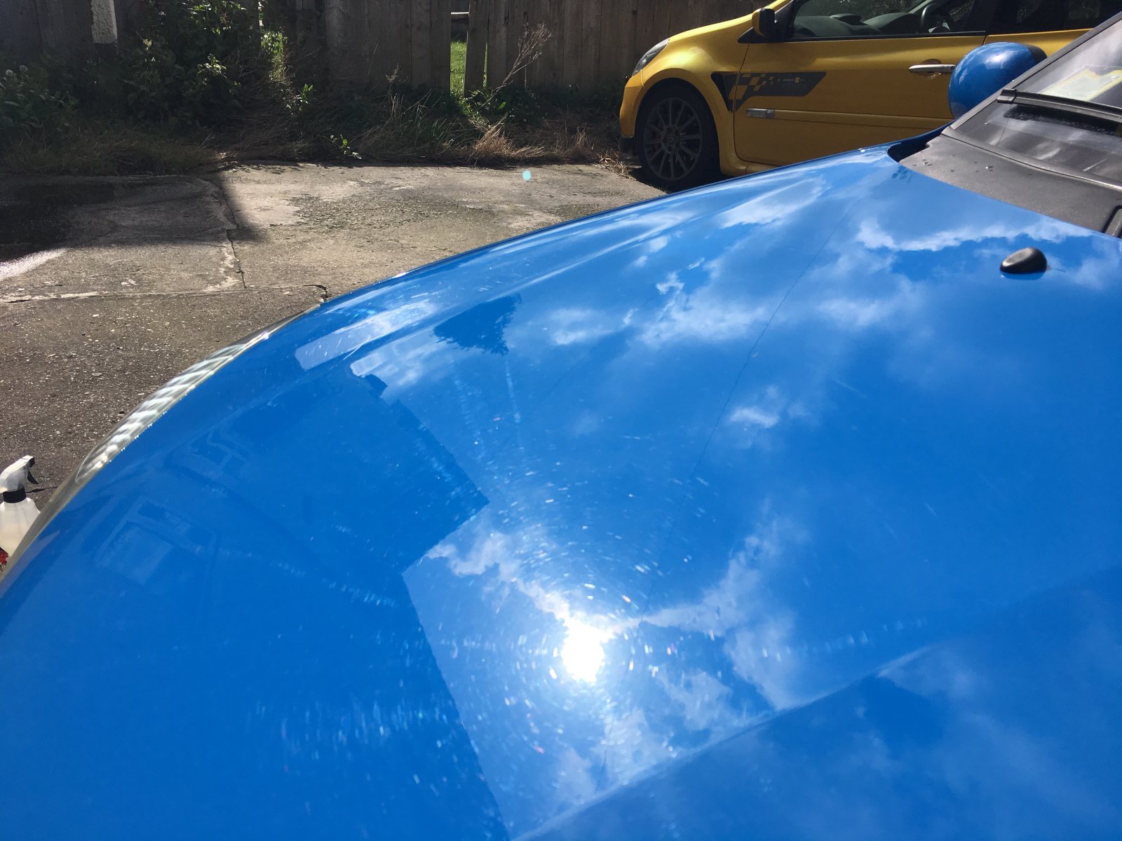

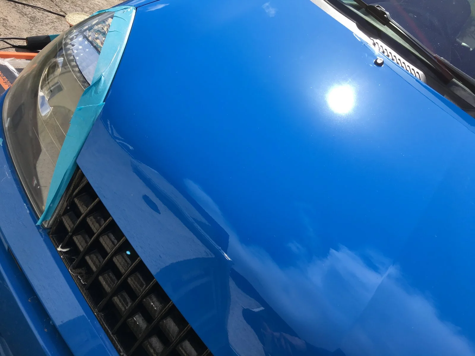

Then the sun came out so I got to have a look at the swirls. Pretty bad all over
After one pass with af#2 no good
It took two passes with G3 scratch remover to get it like this. It was driving me crazy

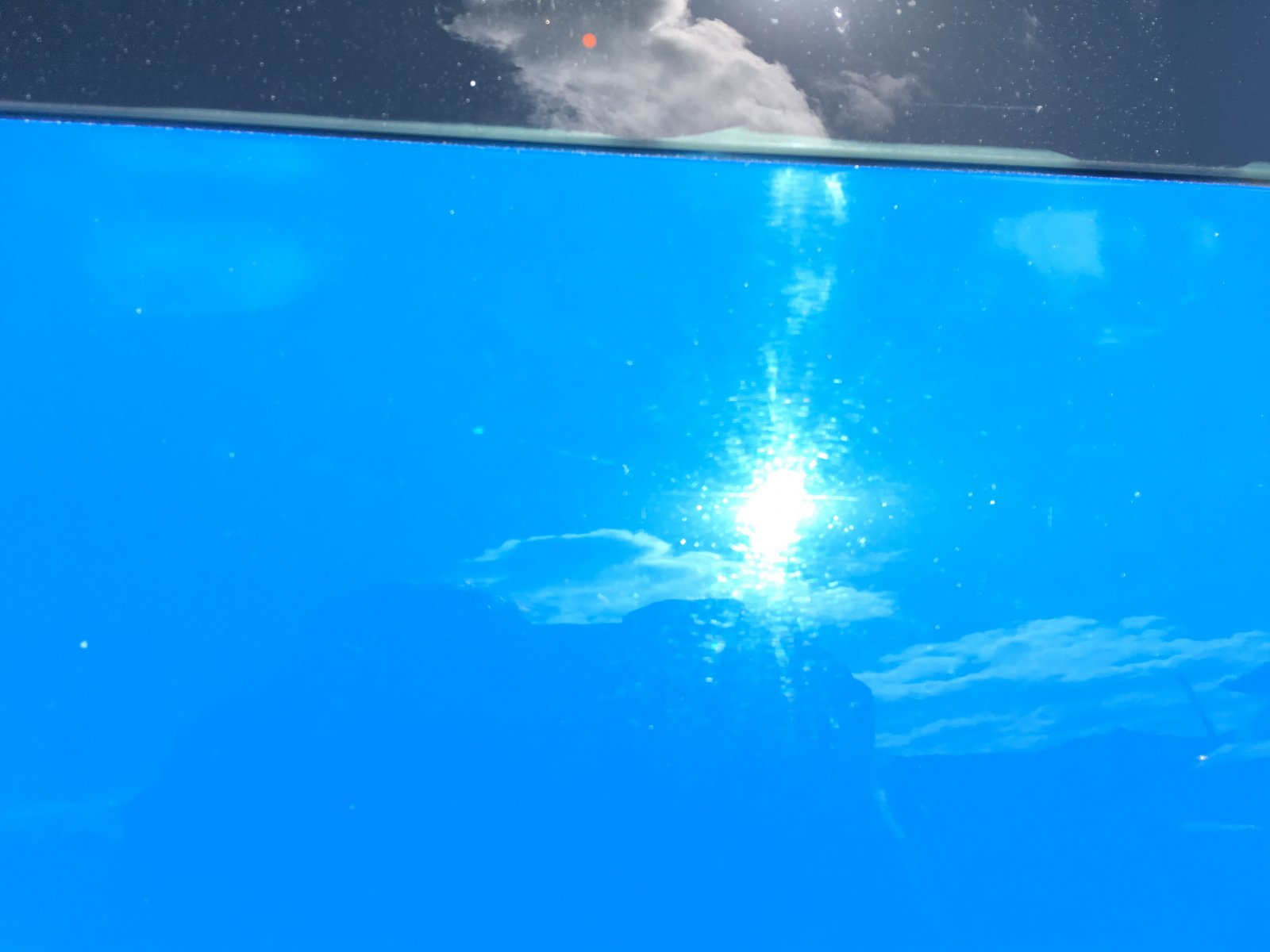

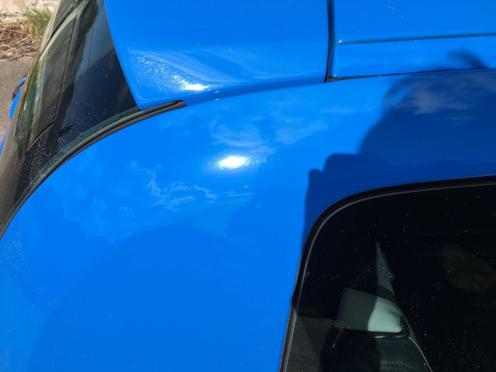

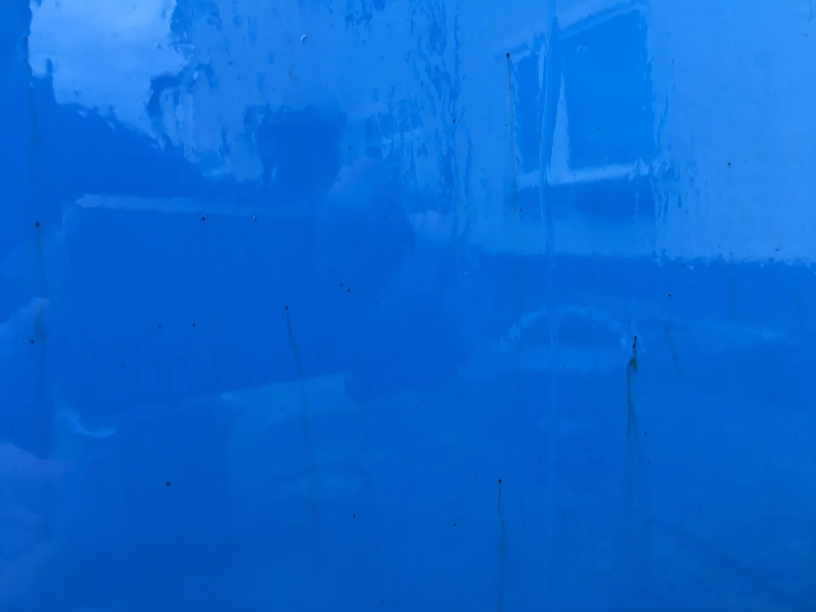

So I worked my way around the car. With racing blue being so bright I had to wind the exposure right up on the camera to catch the extent of the swirls so that's why the colour is a bit off in some of these.
A lot of these took multiple passes and sometimes multiple compounds to get any decent correction.
Exposure wound right up to show the remaining swirls

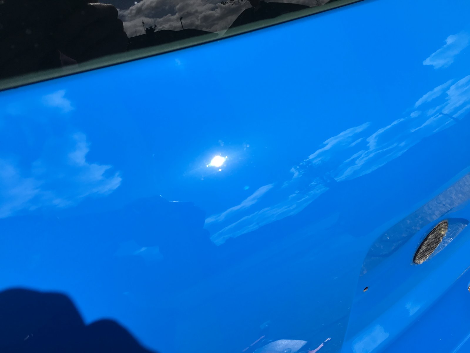

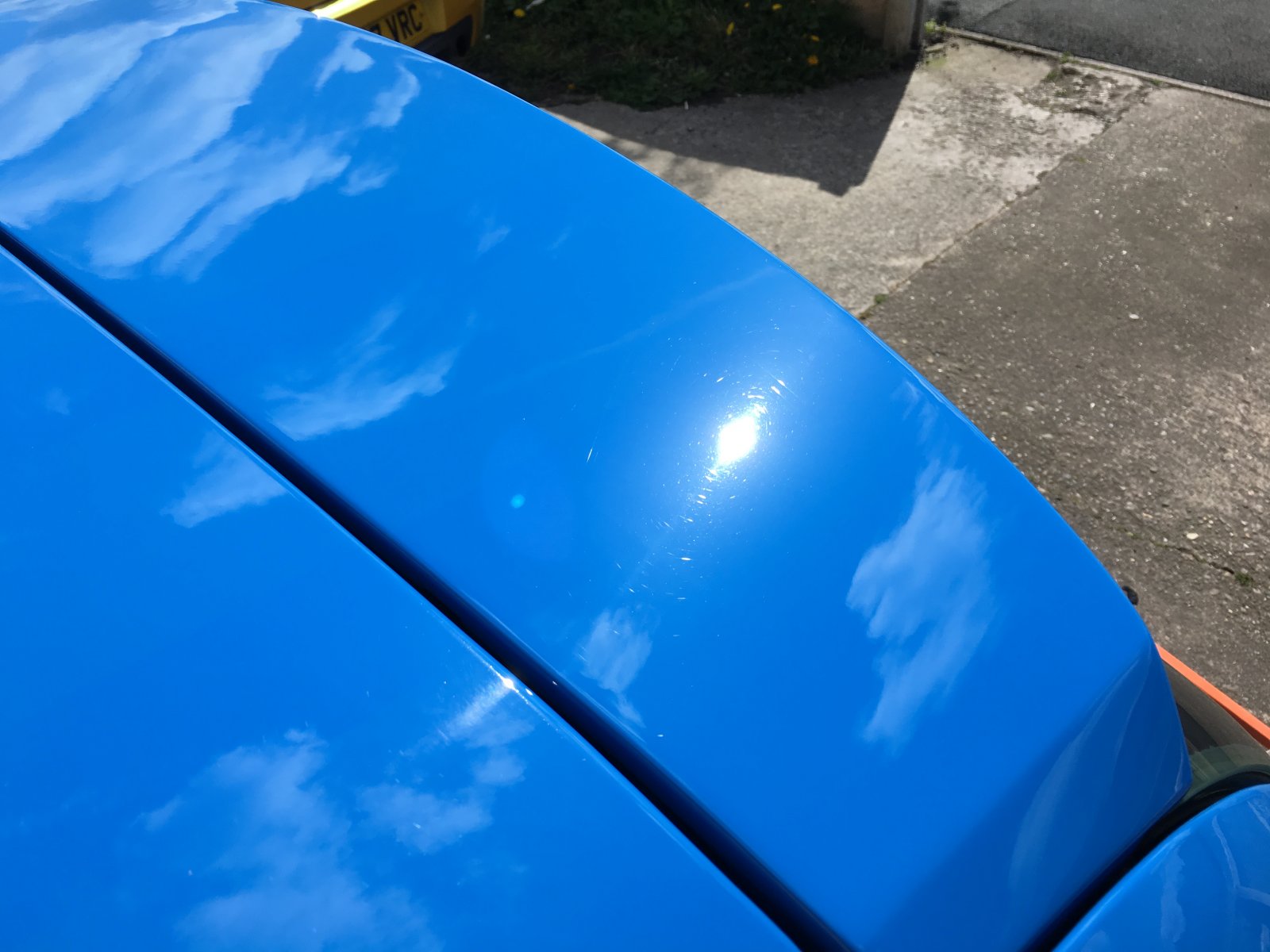

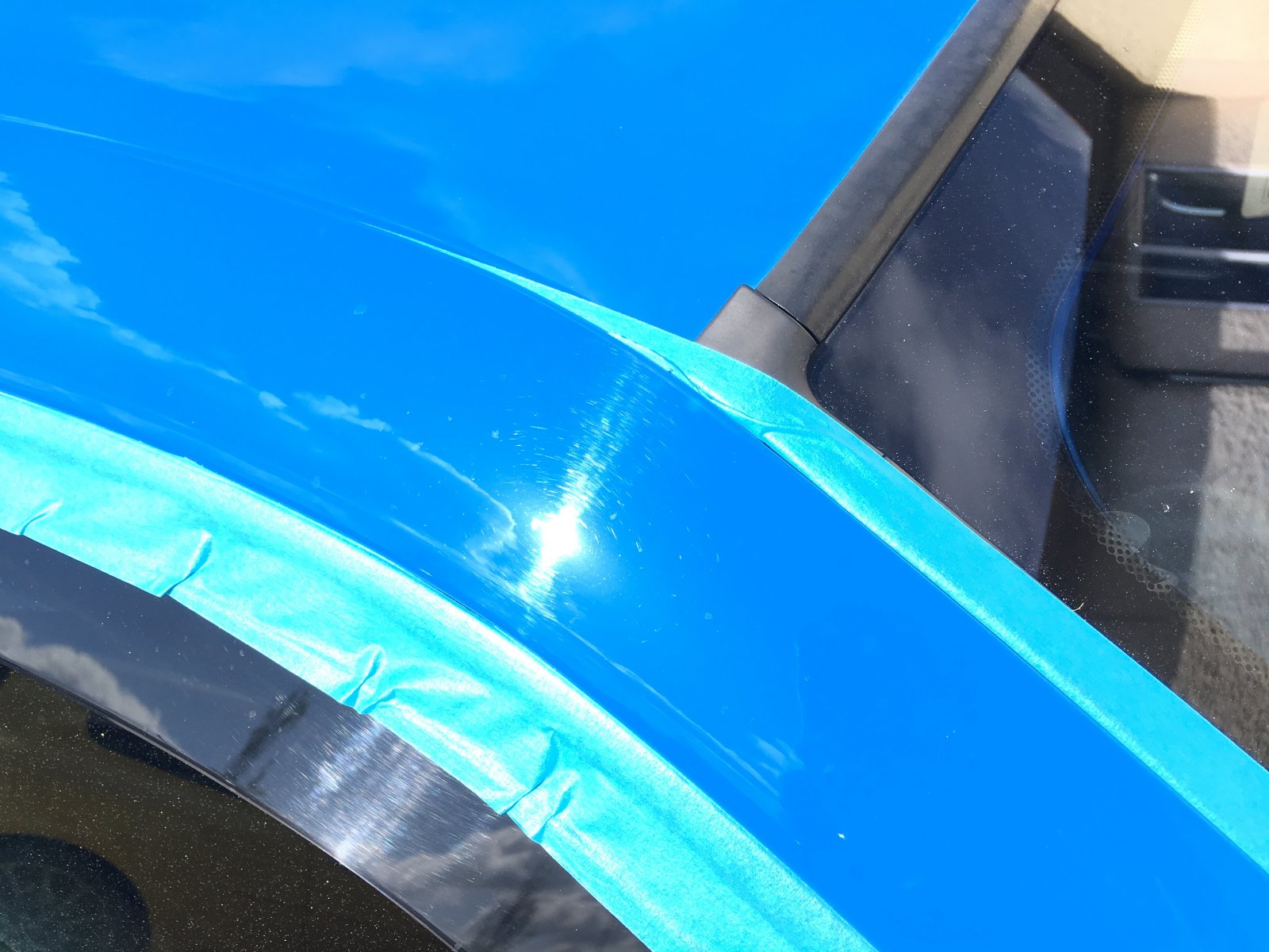

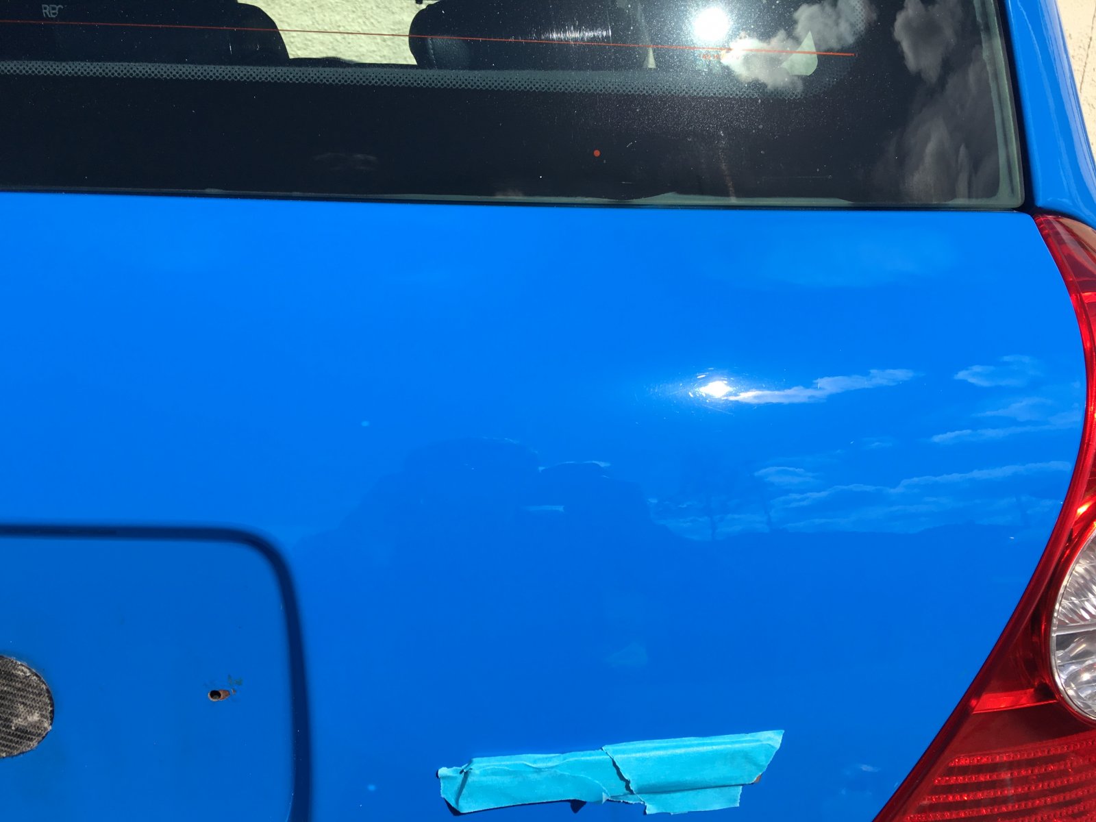

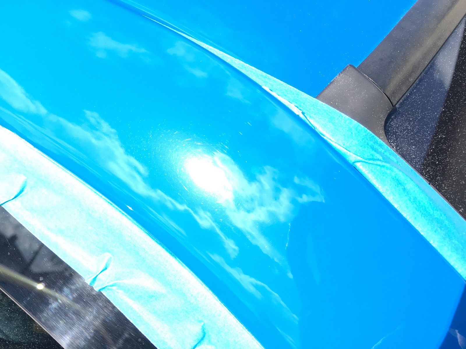

C pillar after one pass. Notice difference between rear quarter and spoiler swirls
Second pass

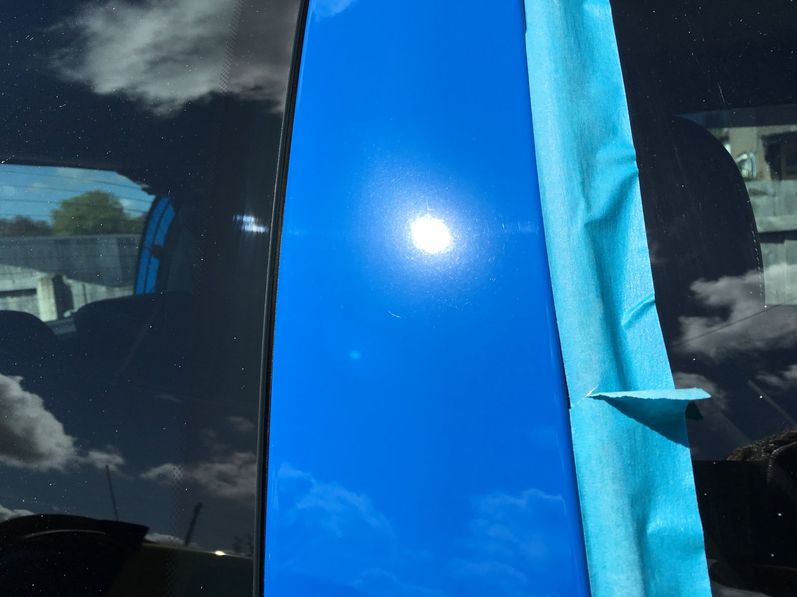

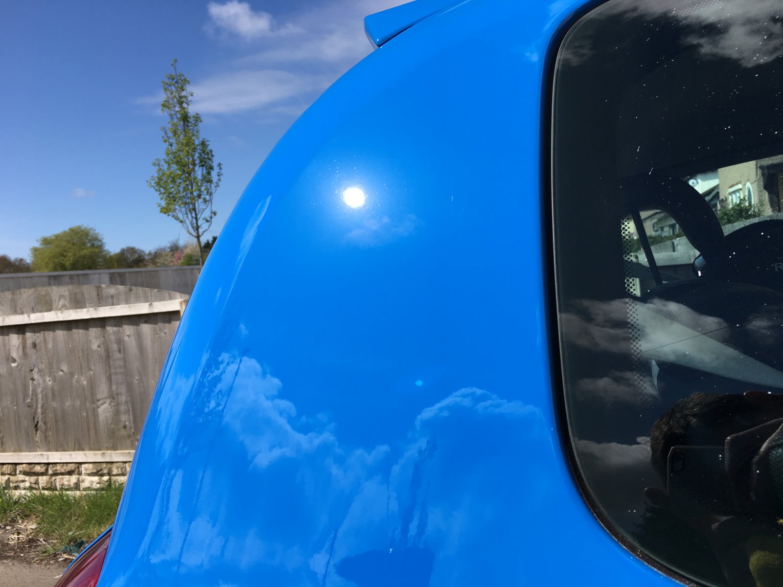

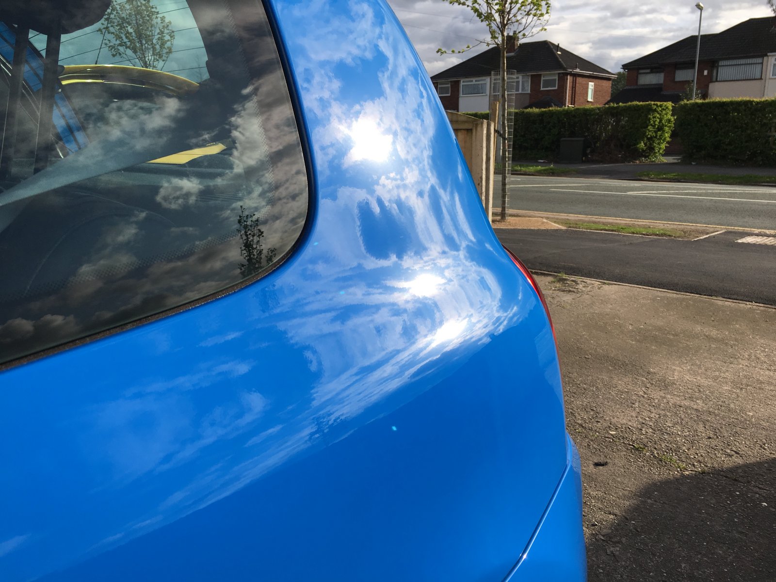

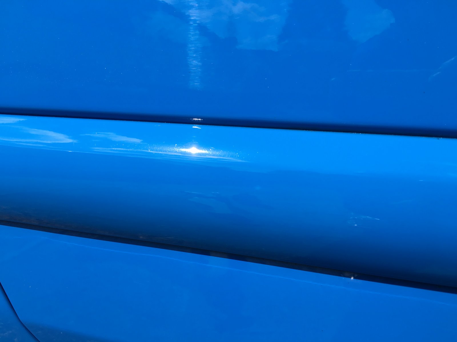

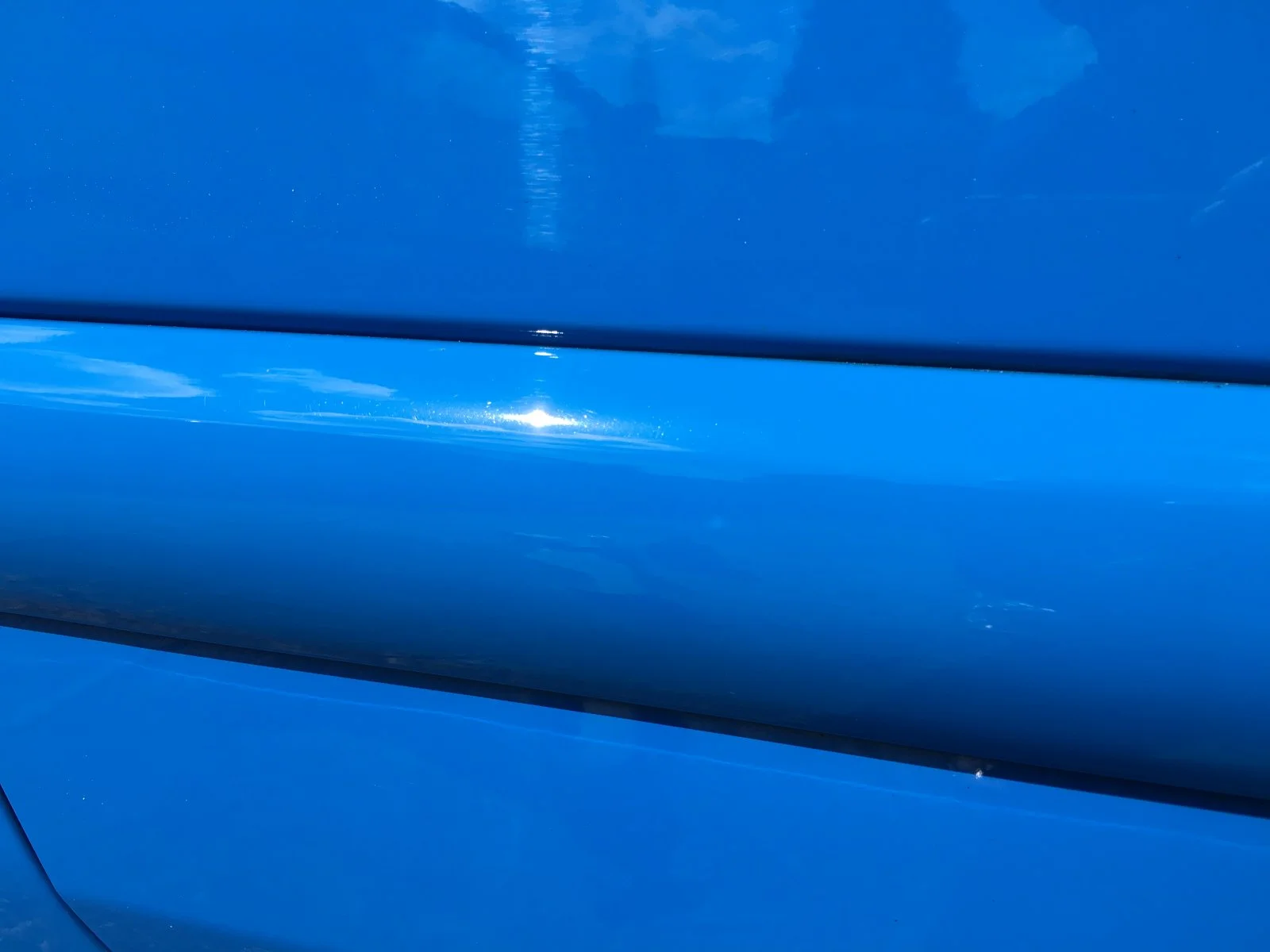

B pillar 50/50... after two passes!
Side strip before
And after. Door still to come
Yet [emoji6]

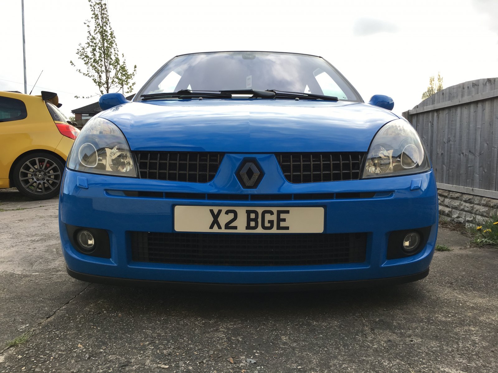

Thanks for doing this for me Scott, much appreciated [emoji16] Really happy with it.
