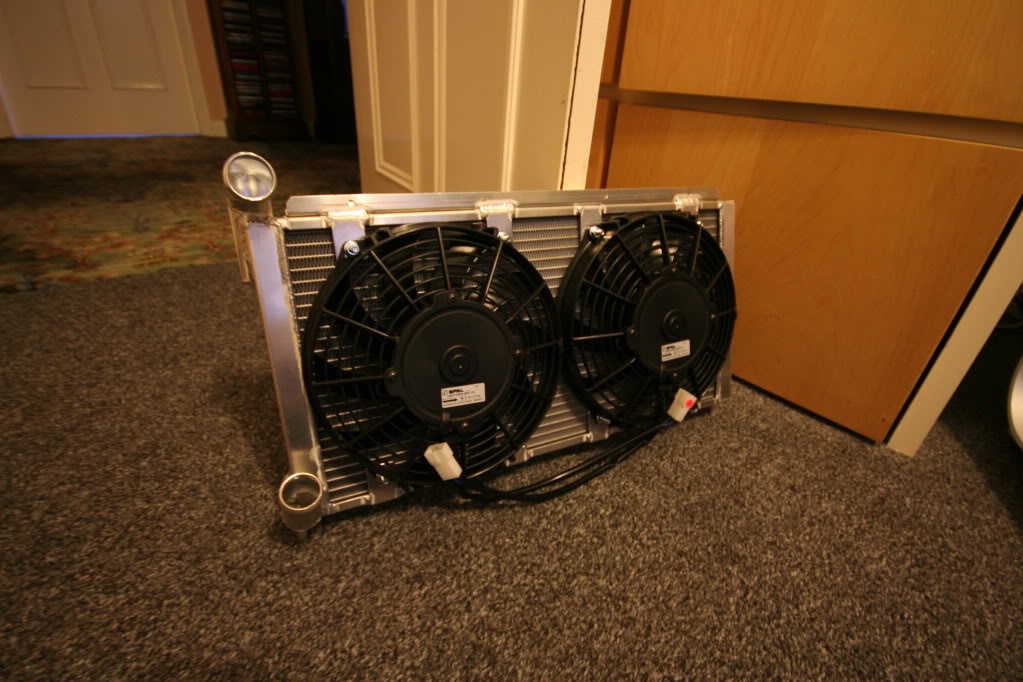

New Serck Motorsport Alloy radiator with two Spal fans, ideal for longer trumpets :)

do you mind saying how much the rad was?
pm if you like :)
Re: PH1 172 Track Car, abit special *ITB update*
im also interested how much it was as i am after one once i get my car back from the garage

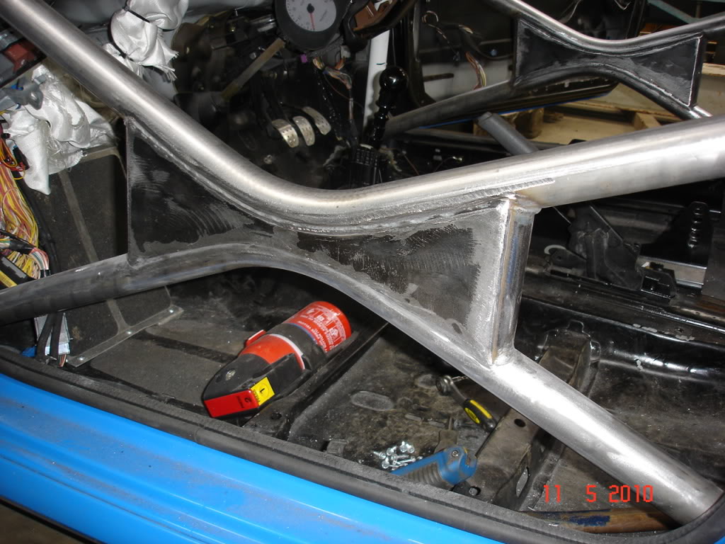

Since it doesnt look like the engine will be done in time, i re-fitted the ITB's to the standard engine and got the car running. First time it has been moved for 5 months :O
So next week will include:
1. Fitting gussets to cage
2. remove excess metal inside the car
3. alter seat frames ready for new passenger seat
4. re-paint inside of car and paint cage

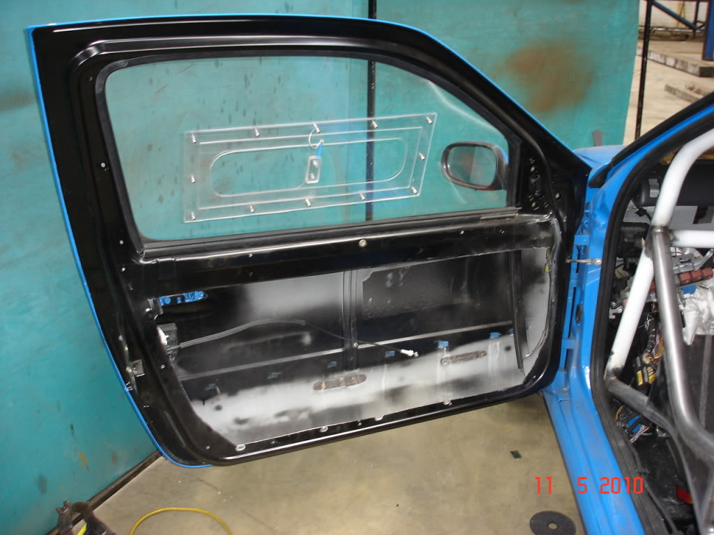

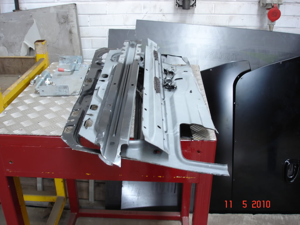

gussets
cut away door
terrible pictures but you get the idea. The interior will be getting completely re-sprayed once all the work is done
Carl
  TrackCar & F30 330d
Quite a bit of weight saved from the door gashing :)
Gussets looking nice

Are you going to be refitting the black door covers?
Getting some new ones made up from very thin aluminum. Those ones in the picture, the door handle fouls the cage door bars

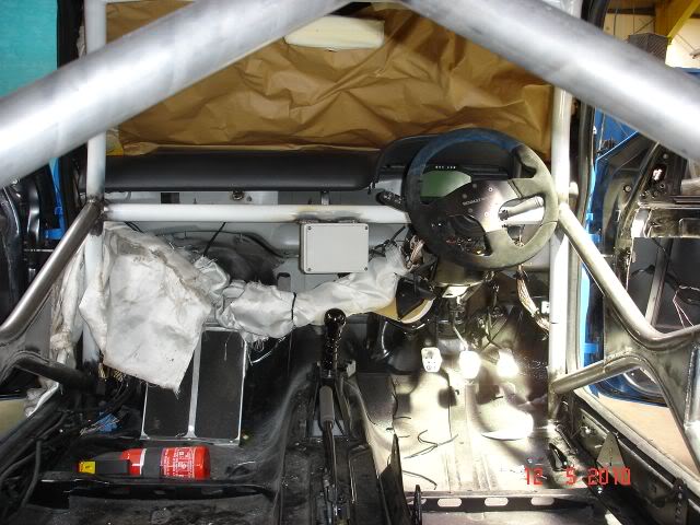

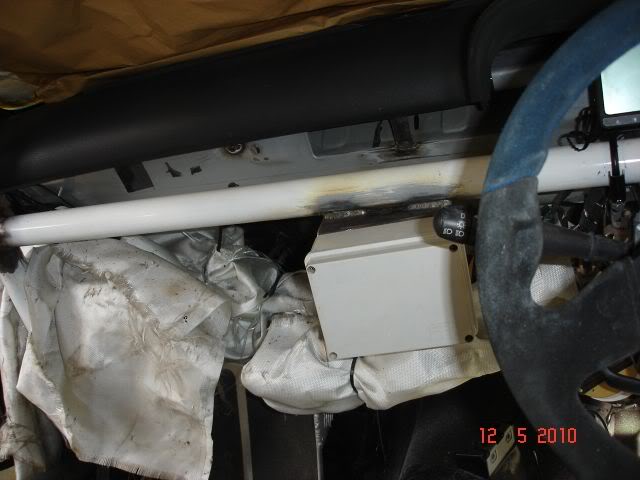

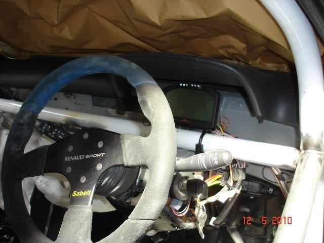

few new updates.
Noticed there was abit of play in the steering so investigated and found that the steering column was fucked. That has now been replaced. No pics im afraid.
Fitted the control box which will house all the switches and the DASH2 digital dash.
Next up. Sort the wiring out and spray everything, Including the control box.

Looks good carl at least its progressing again. 2 weeks and i will be hope to see it, hopefully somplete.
:( sabelt wheel looks tired.
