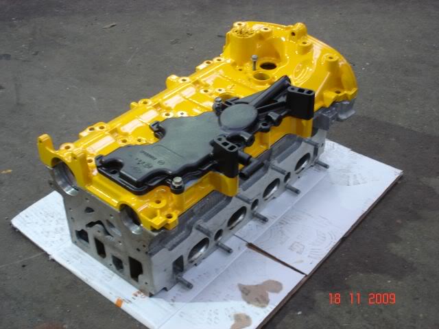

Generally I fancy the discrete look but I must say that I did like the Yellow!
Taking the cover of my engine and changing cams during the winter. Im thinking about doing the same thing on my car. What preparations must be made and what colour do you use to make it last?
Cheers

Why have you blocked up the top hole? Aesthetics?

carl you could smooth it off a little bit more,
the ridges between the cams and the brackets for the plenum (holding old coil pack)
unless you mounting coil on top instead of side slung like DAZ who has it on the themostat housing.
if you want me to get a better pic of the smooting i have done on the cams let me know, also the 182 or the 1.4 has a breather plate with no carbon canister outlet :D

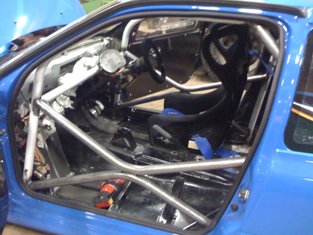

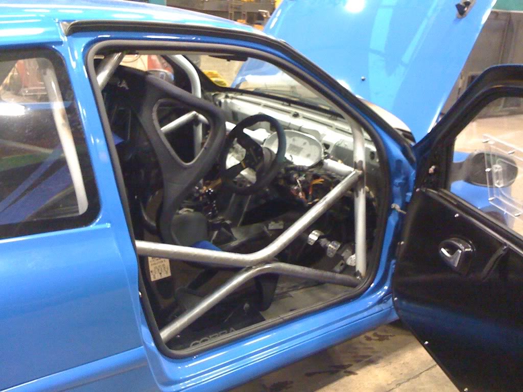

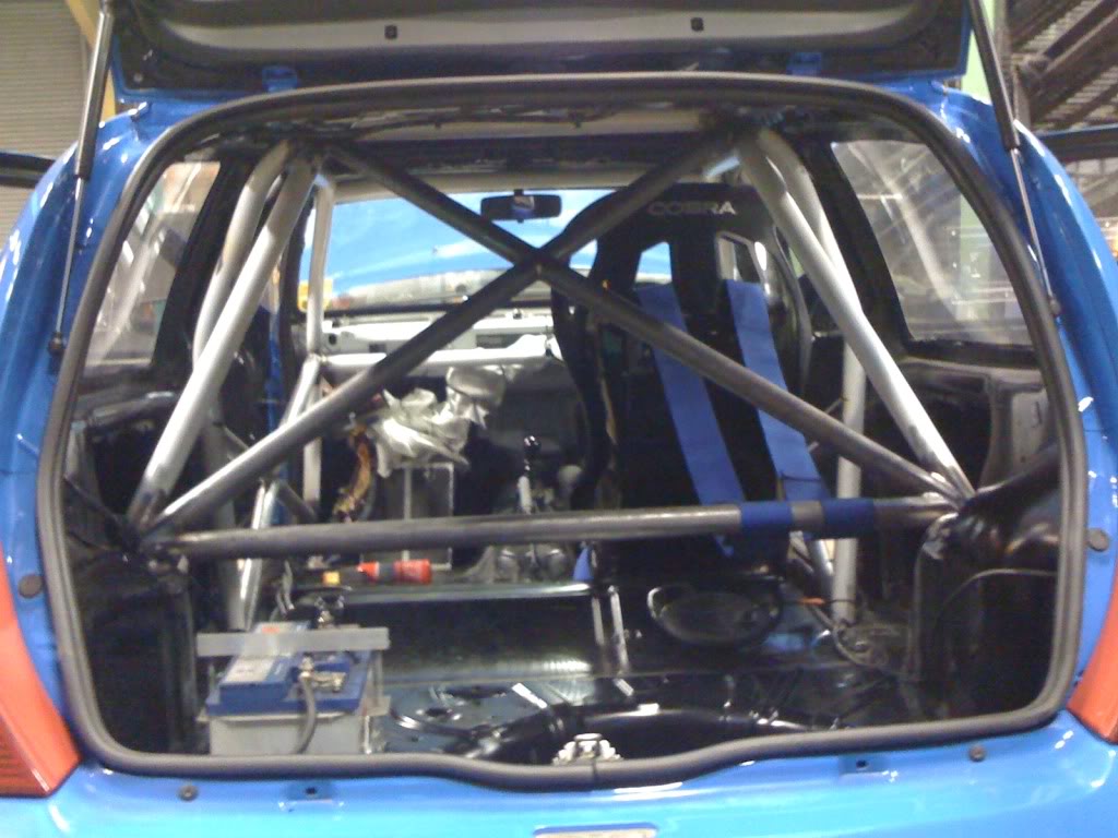

Cage fitted.
MSA spec 45mm cage, same spec as cup racer without bars to struts and the bar behind seats (can be added at a later date if we want to use car for competition use).
Also going to fit gusset's to the cage.
Will be fully sprayed white with the rest of the interior sprayed black again. Wiring covered in temp. fireproof wrapping so didnt get damaged when welding.
cage made by : http://www.geronimocages.co.uk/

damn sexy cage will look good painted as you said bet your happy with it!

Cant believe your still using that big fat battery Carl, buy an Odyssey off me and stick it under the passenger seat
ive got an Odyssey PC680 in my garage. Will be going in once the new engine is in and mapped :) Loving your new project :)

Good man, check out the brackets OBP make for them. Just got one for ours was about £15

We have a bracket that we had made up for it, so we have everything we need. Just put of fitting it till the new engine is ready.
yeah but our bracket is s**t and heavy, so a new one will be ordered.

Re: PH1 172 Track Car, abit special *ITB update*
congrats cage looks strong.
why have you not followed the A-pillar though??? dash dodging?? if so its a real shame as a tiny bit cut out of sliding top dash and it would of fit fine
Wanted to follow the cup racer spec. The guy who made it wanted it to follow the a pillar. The cage can have strut bars added at a later date.
okidoke
only problem i can see if you have now gotta post your self in aswell. that seat/rollcage combo looks like a tight fit.
pics of adrian getting in :eek:
You cheeky Git. Im going on a crash diet :eek: wont be driving the car till March so have a few month to loose a bit more :)
It's easy to get in. Hard to get out mind lol.
My mum managed to get in lol
quick release boss soon to be ordered :)
let me know when your next out on track, ill come pester you :cool:

have you eat a few pies like ???
im not the smallest person in the world and my seats are "snug" LOL
I'm 12 and a half stone
bazzon is 16/17 stone at a guess?
The seat we have is an xl one and it's abit big for me really
My shoulder width is my main problem, i have 98%tile shoulder width. Most car companys design there cars to fit a 97.5%tile dutch male. so sholder wise im on the limits of there design package.
And as carl says im not the smallest of people any how.

Cage looks good....seen it on monday when I picked mine up.
Yours is a little more complex than mine.
What sort of weight do you think the cage had added?
