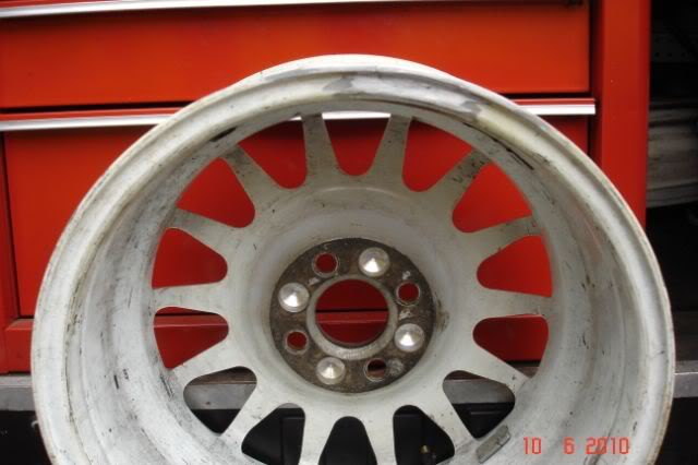

Jeez thats crazy carl did it hit a kerb or something?
Can't believe you didn't build the engine yourself anyway tbh
nope, does look like it tho.

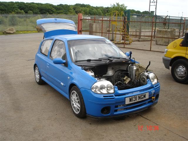

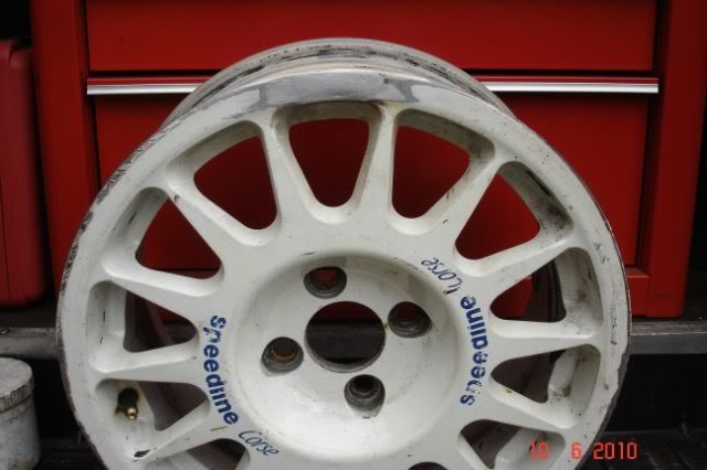

Sideways through an oilseed rape field at 80/90mph, must have hit a big rock as it damaged two wheels and collapsed one of the coilovers :dapprove:

Saw the state of your front struts today, was a right mess, broke the piston off the shaft, Lol
haha yeah i have been speaking to Curtis, they have been re-built now and should have them on friday.

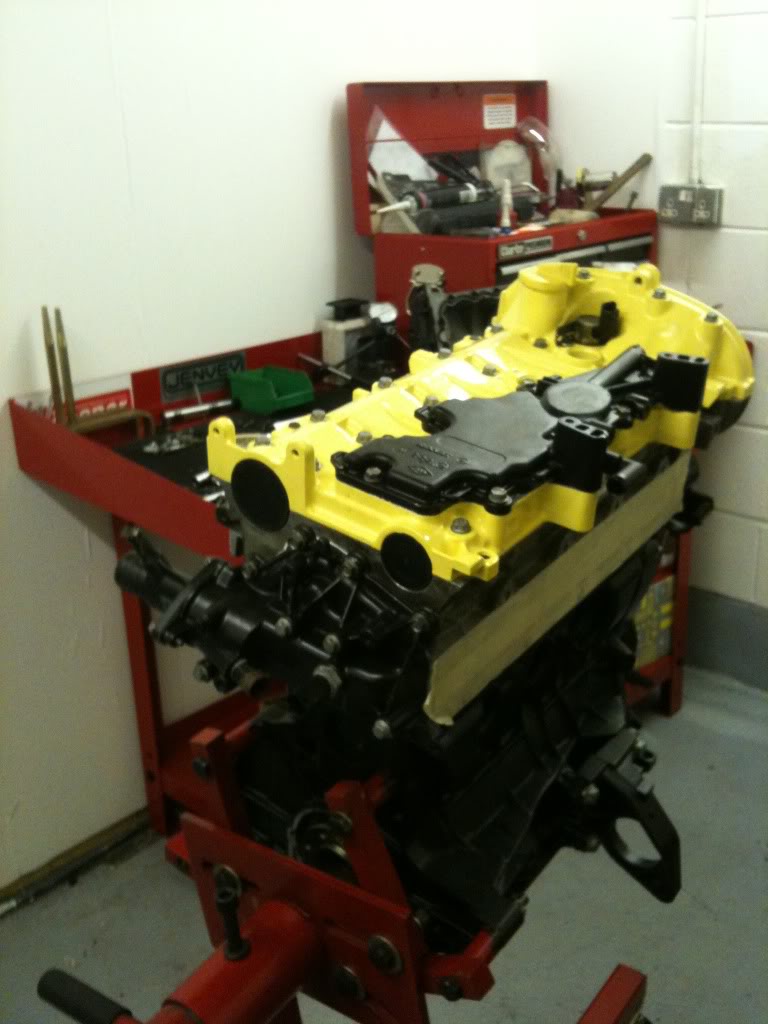

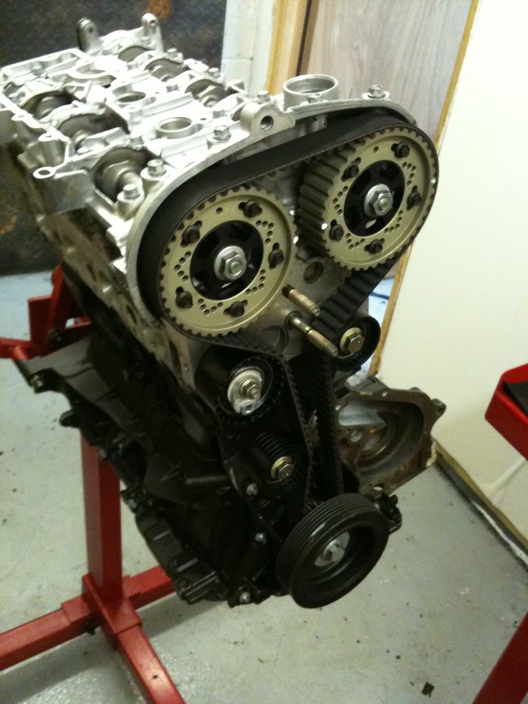

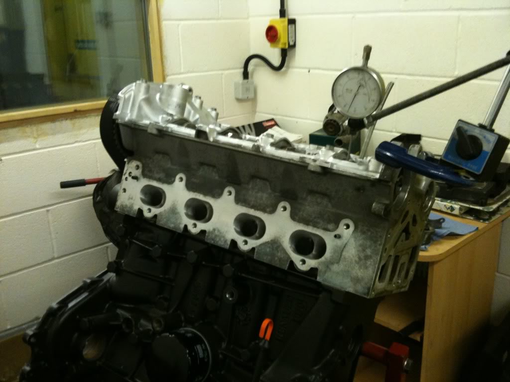

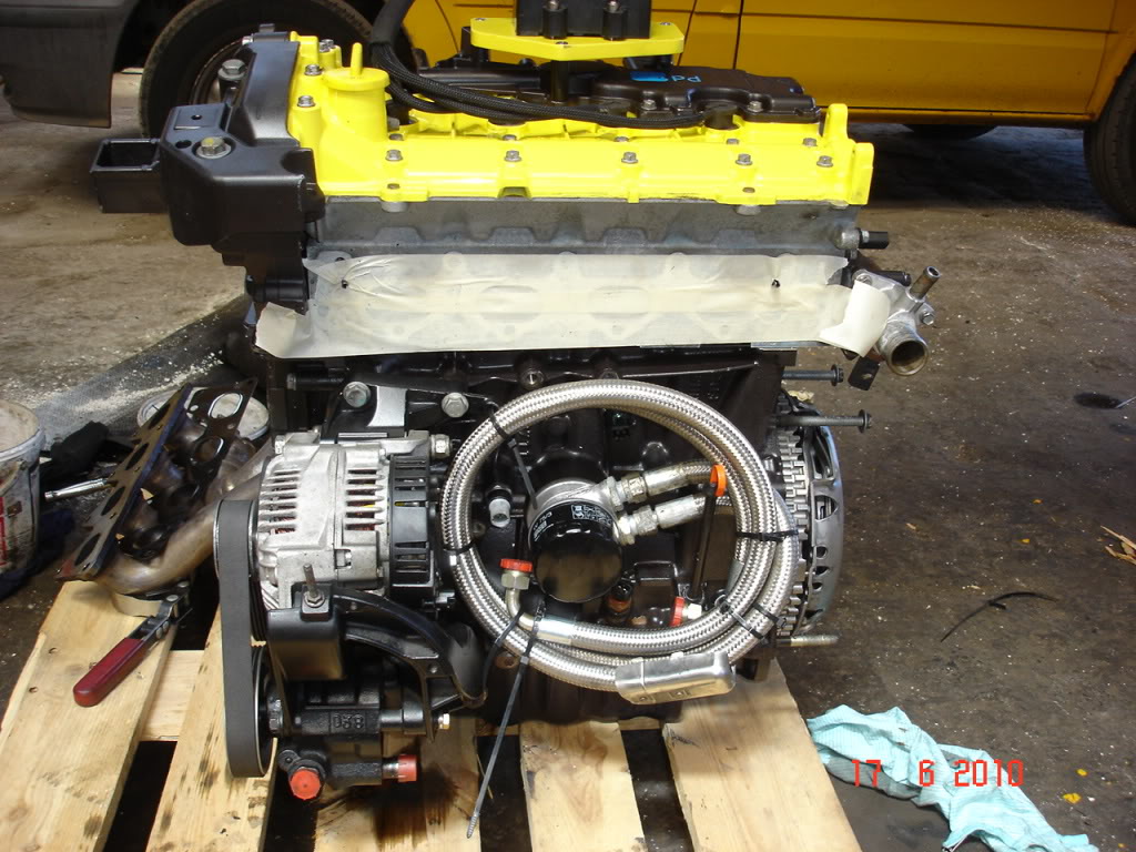

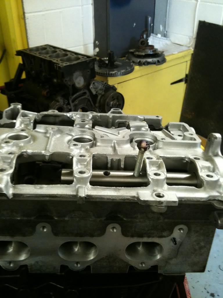

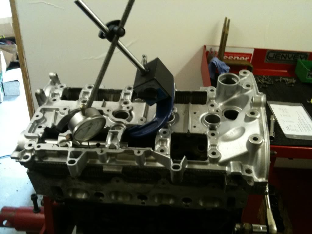

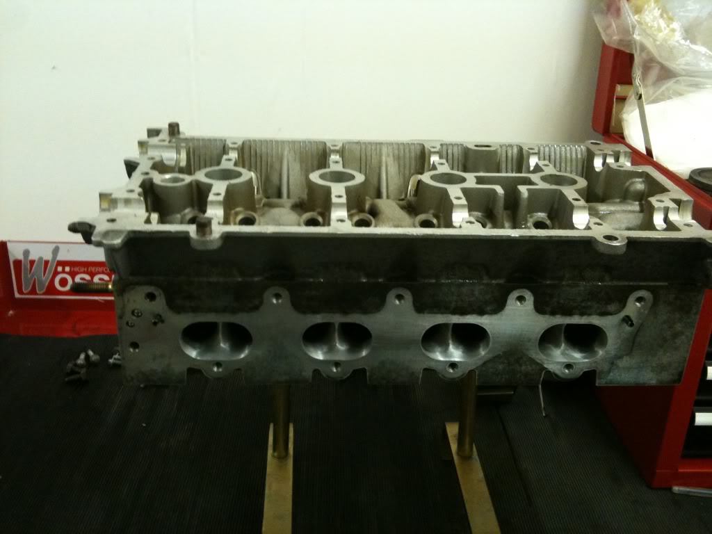

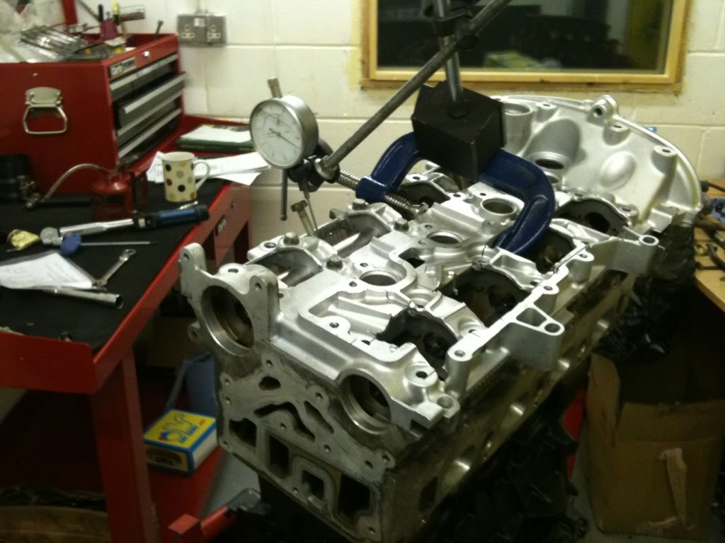

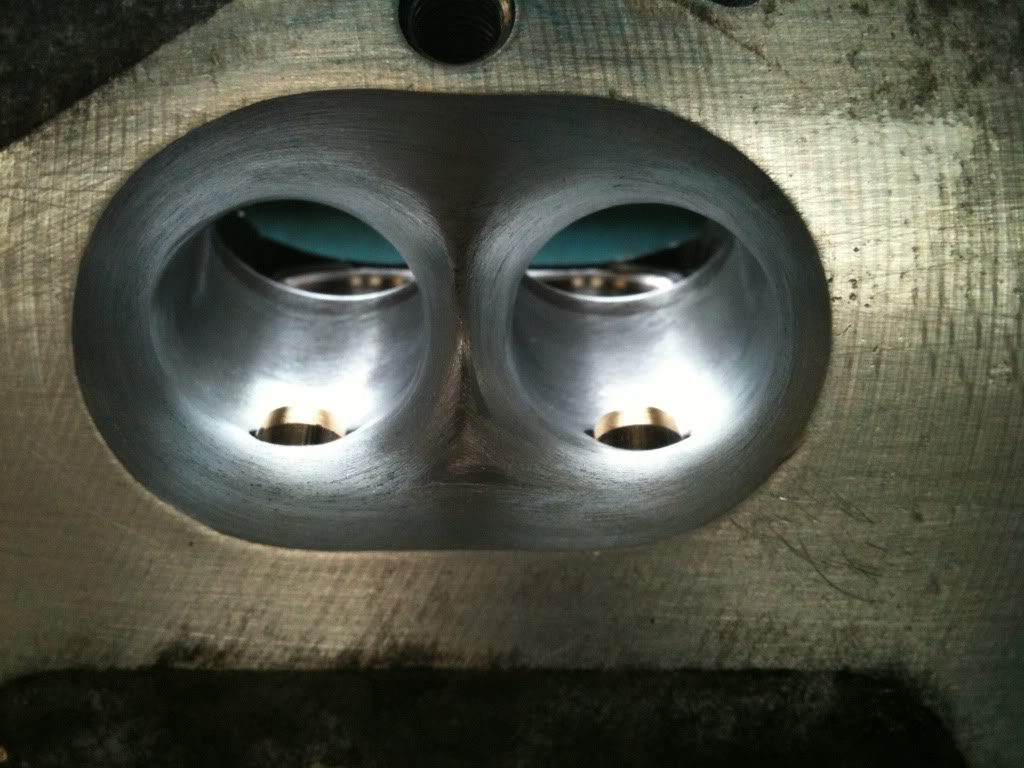

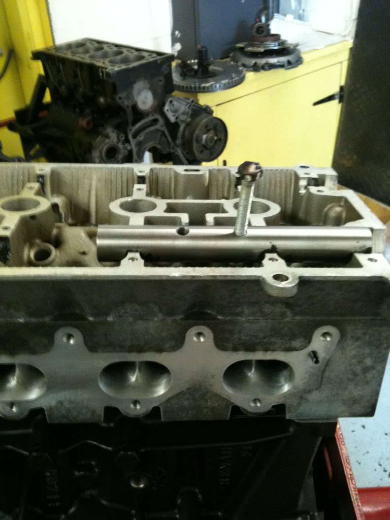

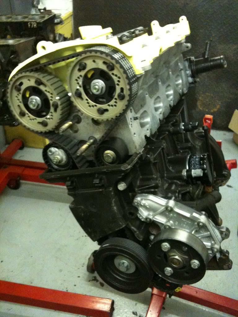

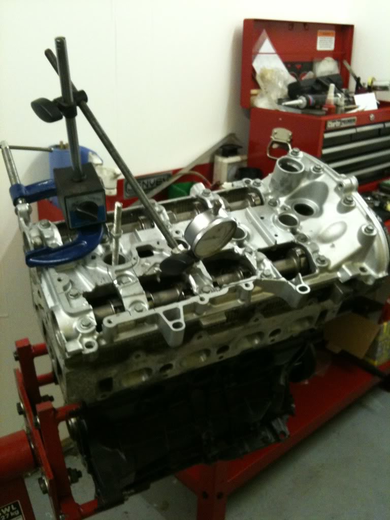

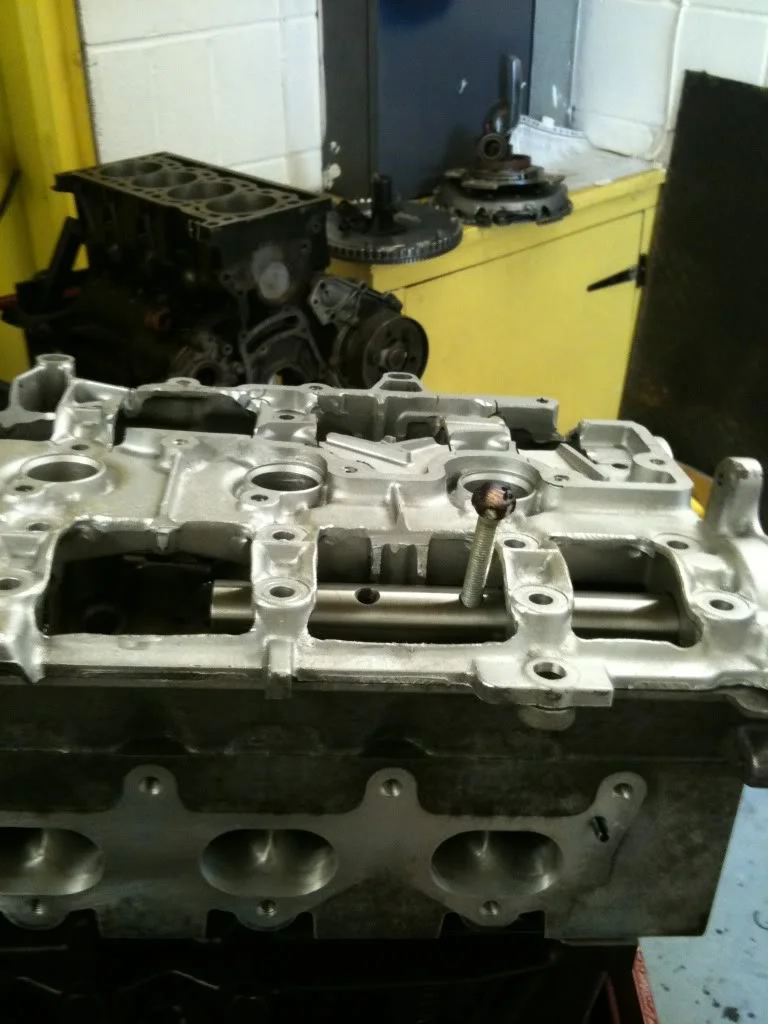

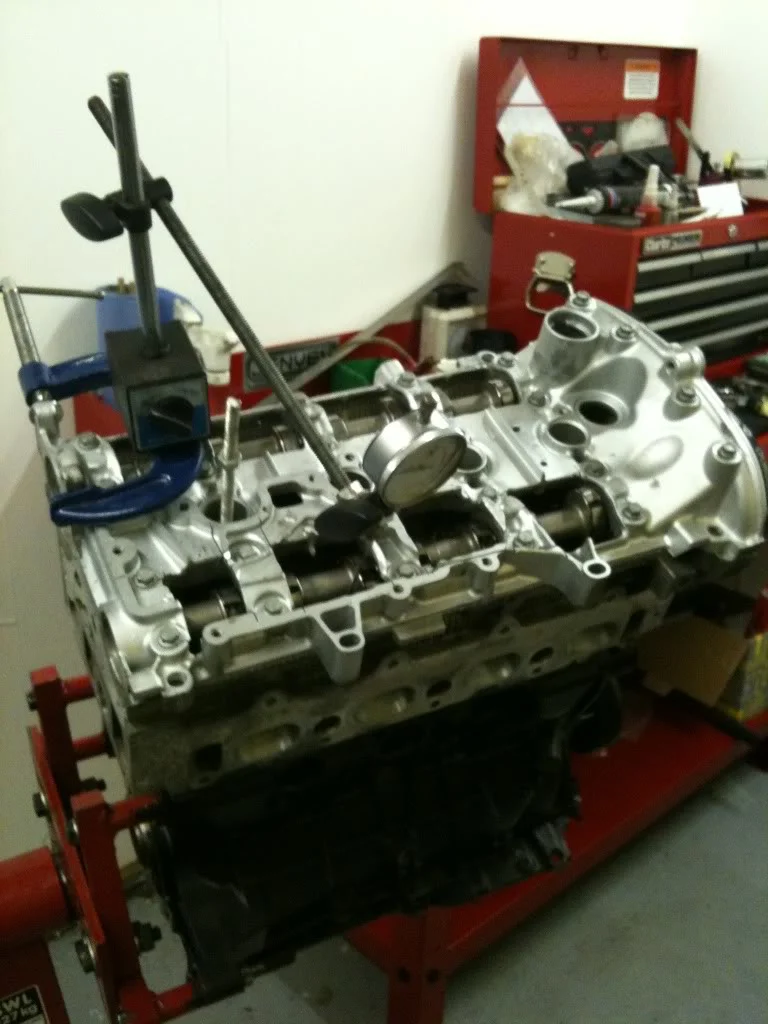

New engine is built!!! Craig has finally got his act together. Looks excellent.
spec:
F4R engine re-bored to 2.1ltr (2066cc)
Wossner Forged Pistons (12.8:1) 84mm
Catcam Forged Conrods
Catcam 423 Race/Rally Cams (VVT Delete)
Jenvey 48mm Throttle Bodies
Jenvey 120mm Trumpets
Catcam Uprated Valve Springs
ACL Race main/thrust bearings
King Race big end bearings
Full Race spec Headwork (AP Developments)
OMEX 600 ECU
Lightened Billet Flywheel
Catcam Adjustable Vernier Pulleys
Catcam ARP Bolts
Full Samco Hose Set
Helix Paddle Clutch
Carl
  TrackCar & F30 330d

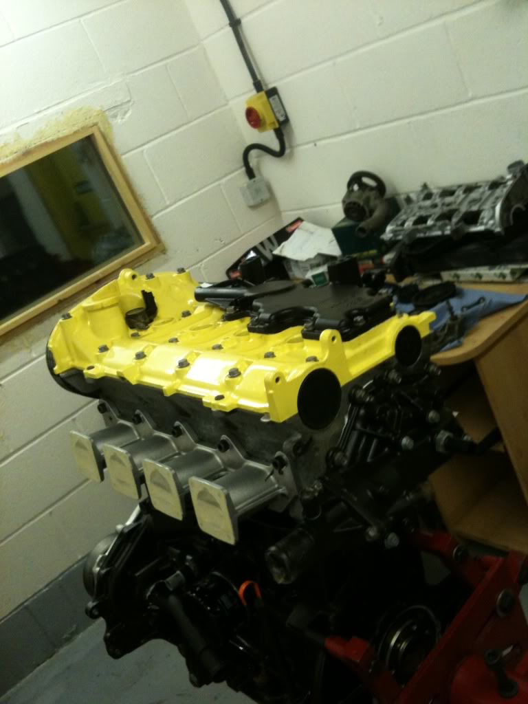

Engine looks nice.
I was confused when i was looking at the pictures of the cam cover with the holes cut out. But now i see the yellow one :)

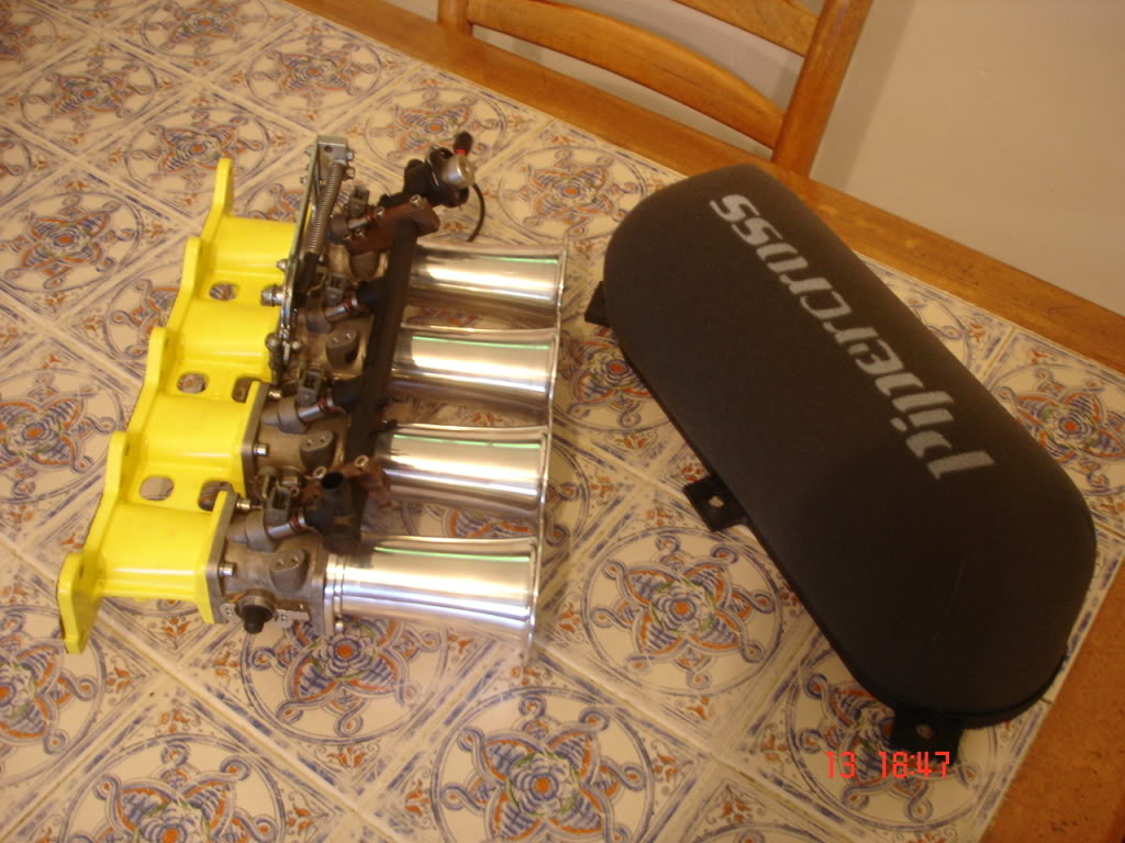

With having 120mm trumpets will you have any issues with the filter being squashed up to the bonnet?
Barron
  Turbo S,Exige,R5,182
Engine looks nice.
yeah with 120mm its very close with the bonnet, if not touching the bonnet.
People have used the 120mm trumpets before so it should be fine.

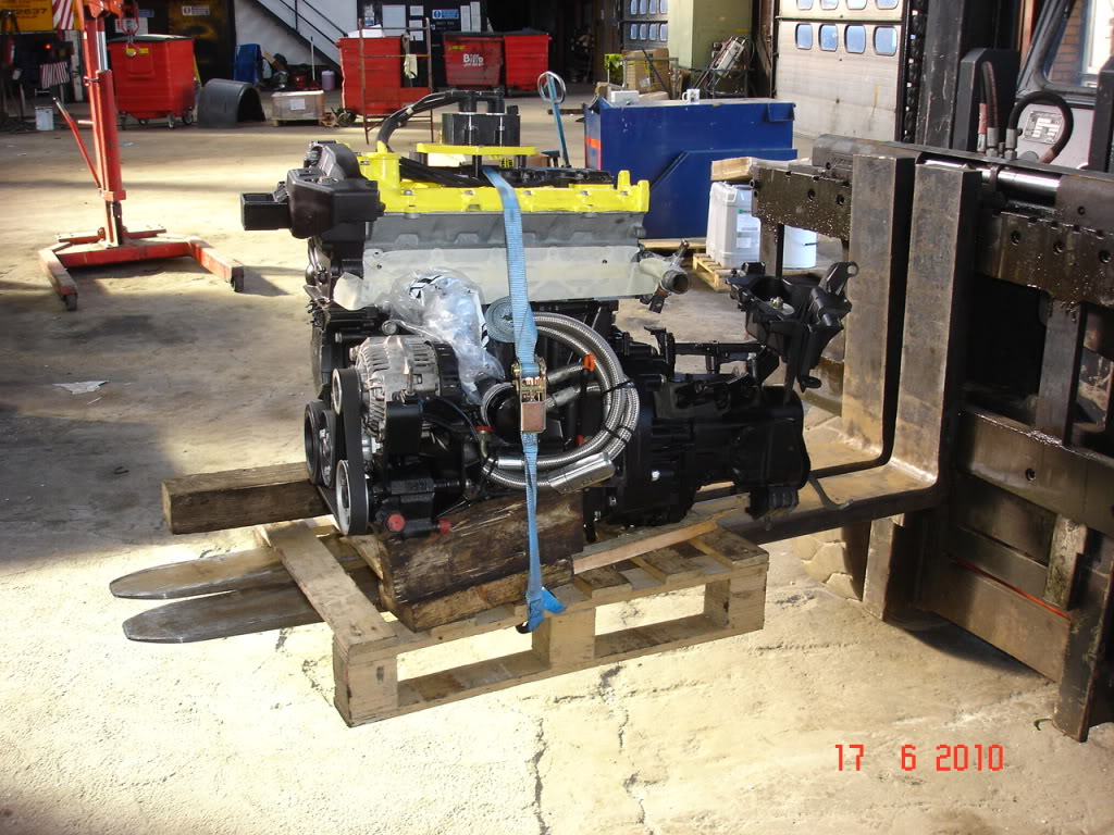

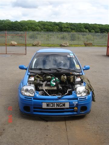

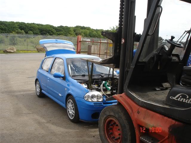

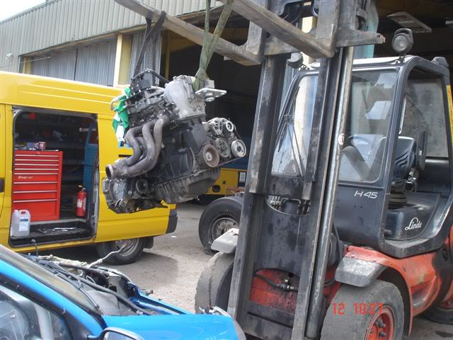

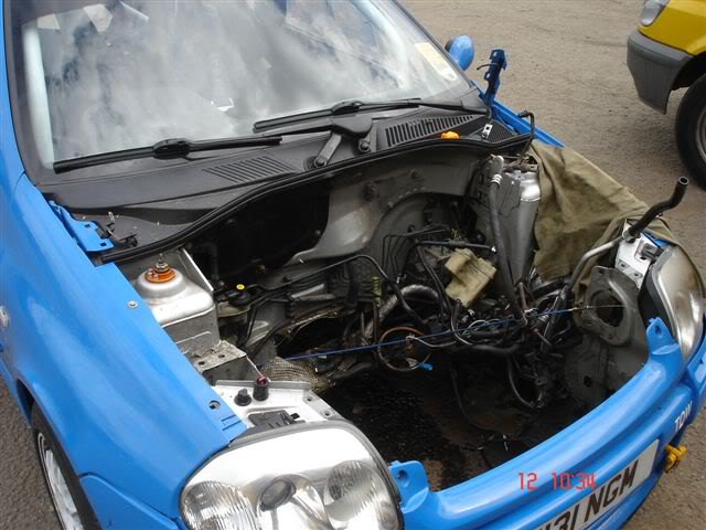

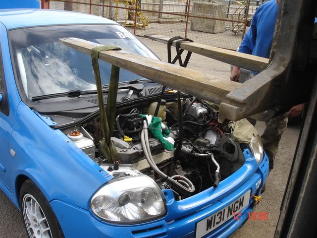

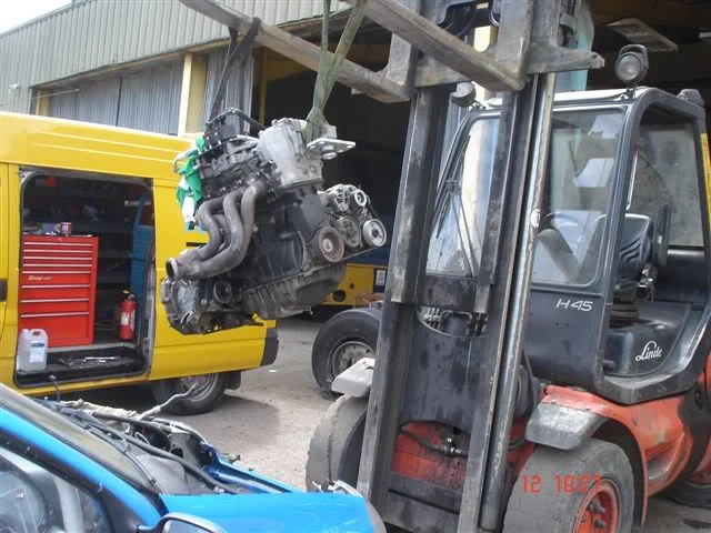

Removed the engine on Saturday. Ready for a tidy up and new engine to be fitted within the next week or two if Craig drops it off tomorrow.

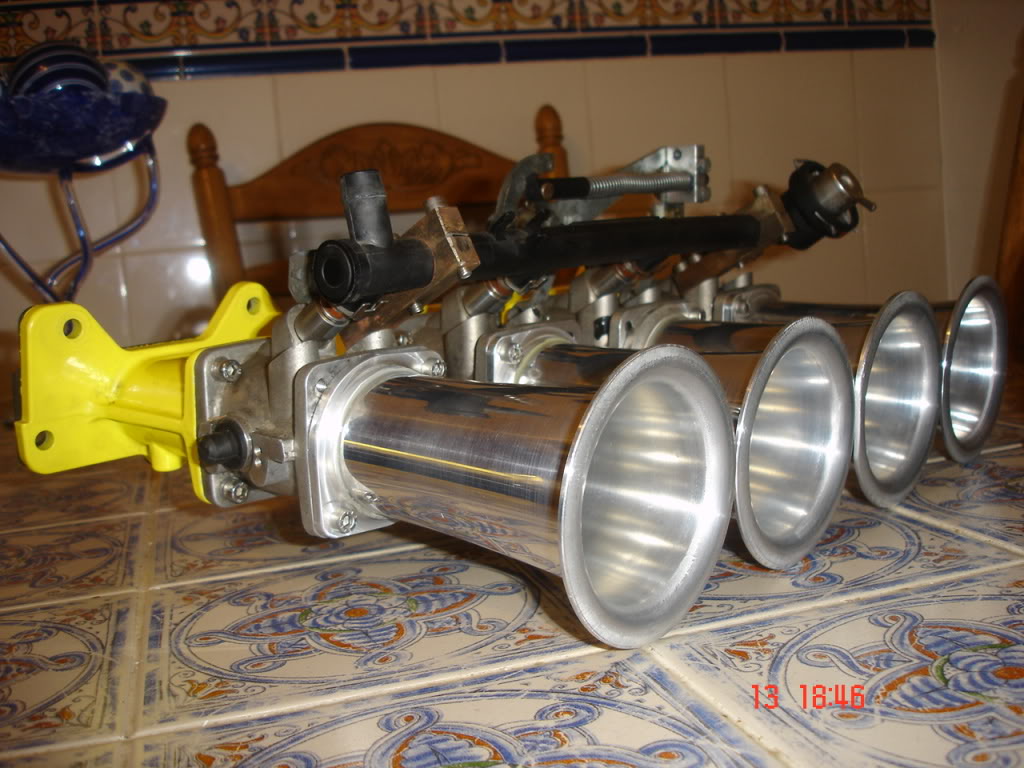

built up the ITB's ready for new engine.
Jenvey 48mm bodies with 120mm trumpets.

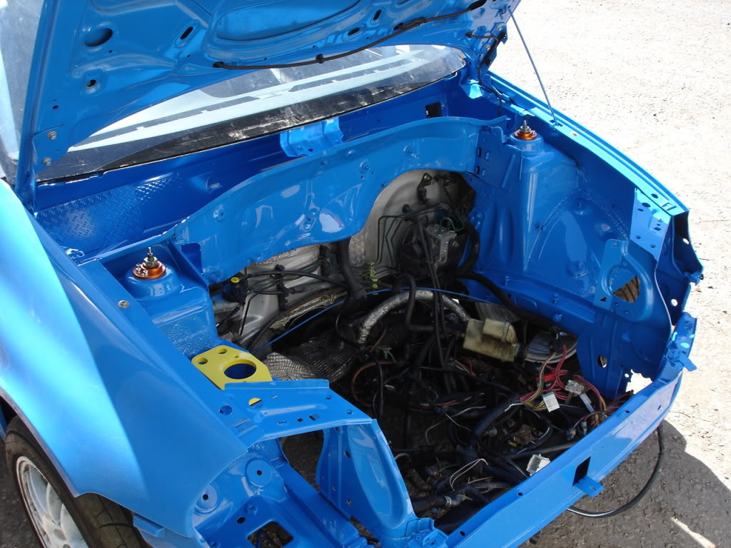

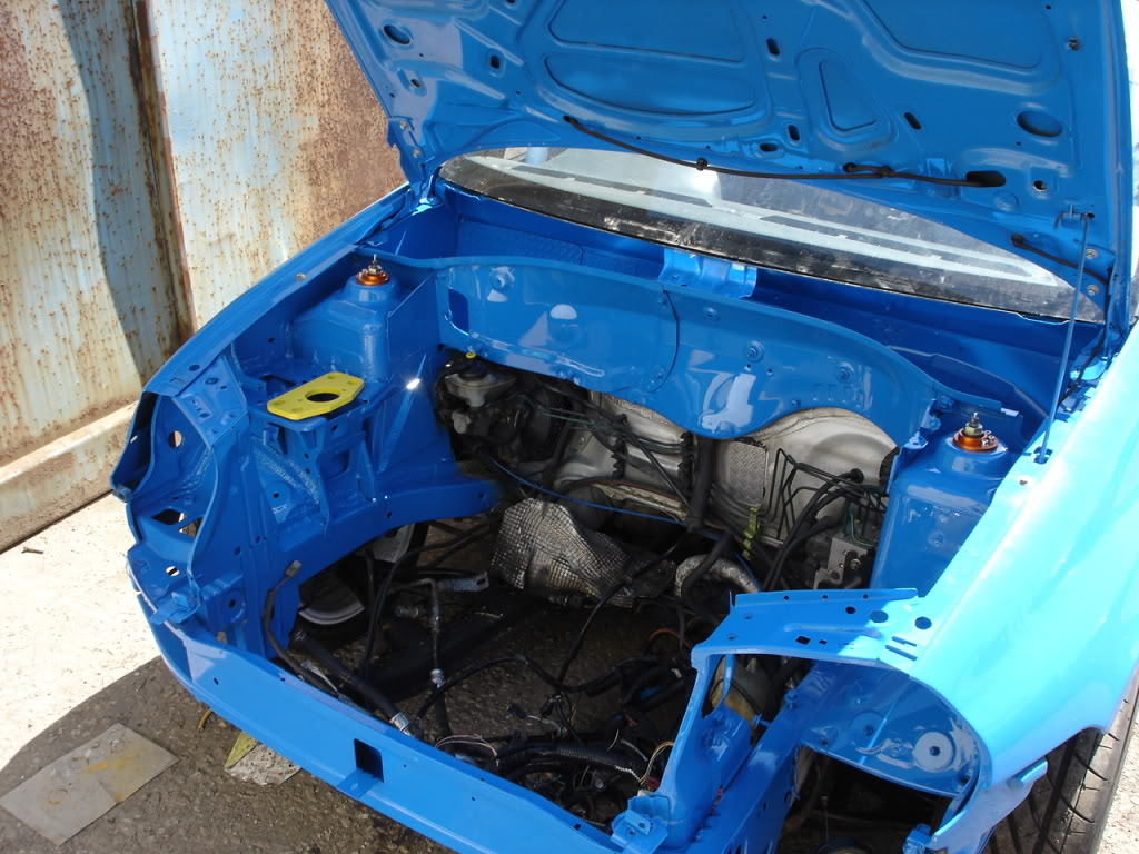

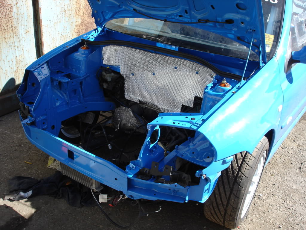

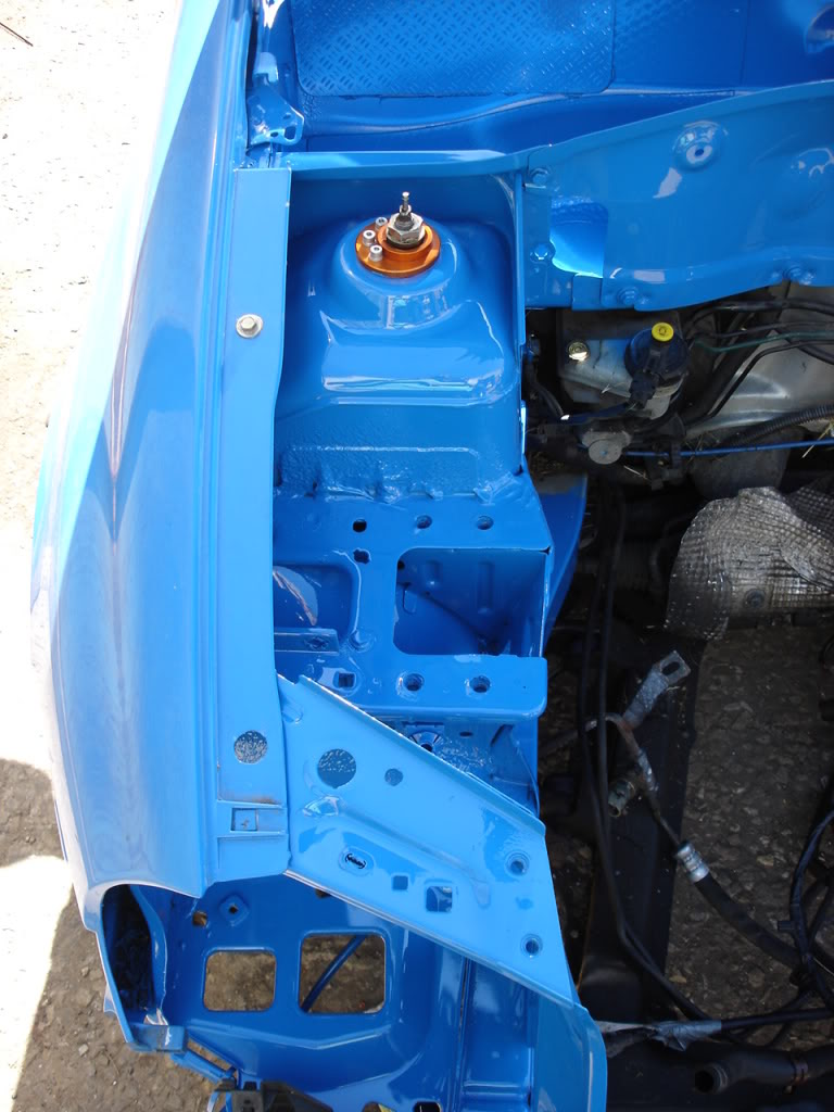

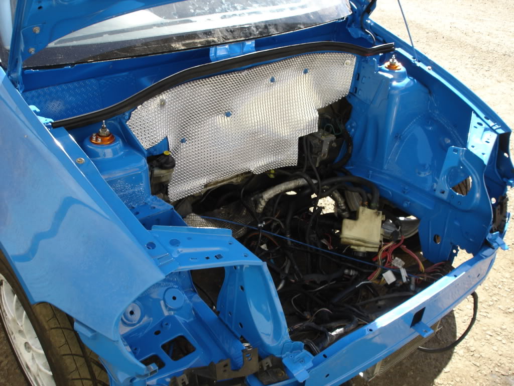

Well on with the engine/engine bay now.
Fully pained engine bay:
Added some Nimbus heatshield (will be adding some stainless bolts to make it look a bit neater)

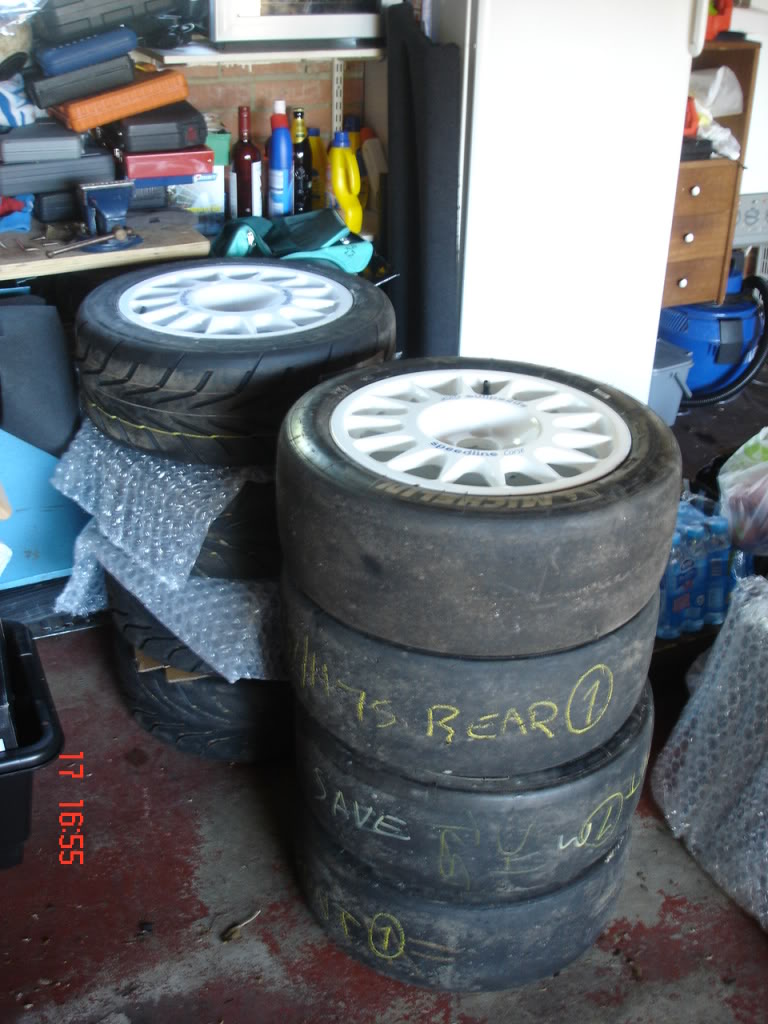

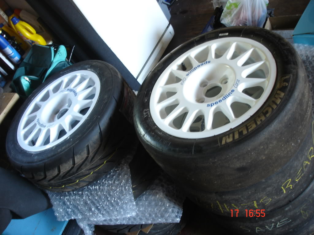

Bought 4 new Speedline 2118'2 and got my other 4 sprayed and a medium set of slicks fitted. Had a guy who used to be in charge of toyota's Le-Man teams tyres check the slicks over, separate them into sets and mark the compounds as well as providing me with some tyre softner.
Now have:
4x Toyo R888
12x Michelin Medium compound slicks
4x Yokohama Parada Spec II
