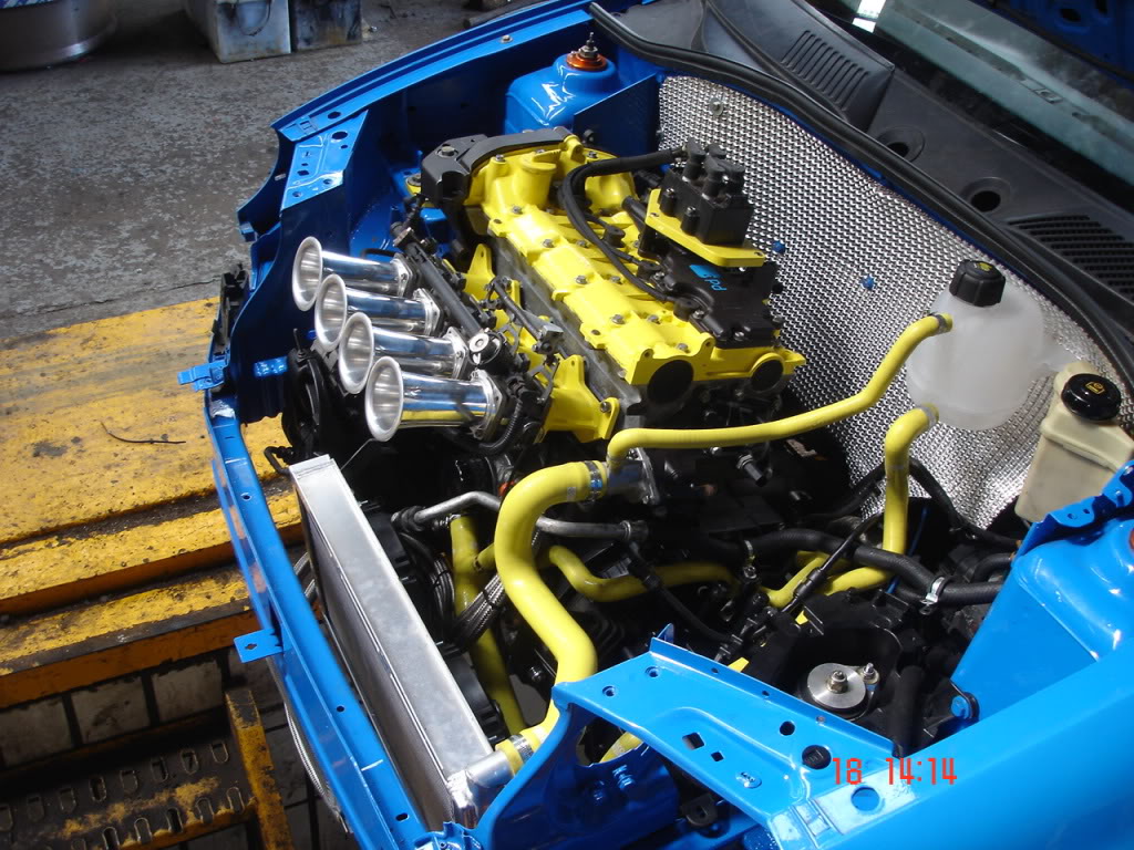

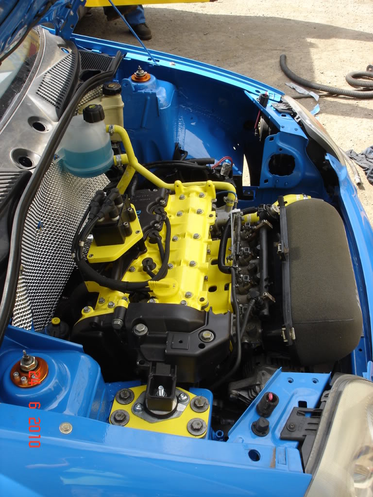

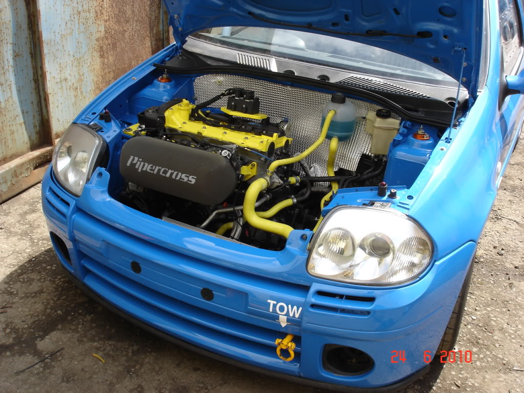

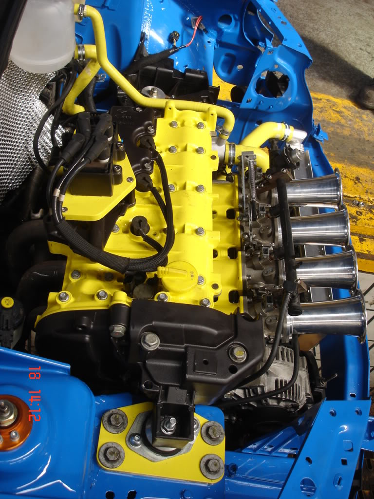

Engine bay looks much much better. The Nimbus heatshielding is good stuff.
The enigne looks so cool aswell. I see you've taken apart the K-tec enigne mount and had that powdercoated/sprayed. I'll be doing that one day.
Look forward to seeing it in the car now :)

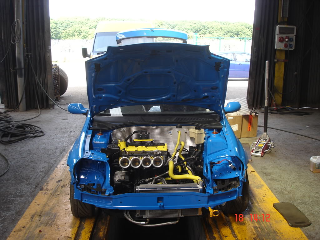

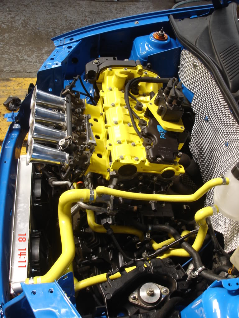

Engine Fitted. Still missing lots of bits and need some tidying up. Would say about 70% done. The throttle bodies are not correctly fitted due to it being the old manifold so not having the locating holes.

I love it! Seems a shame to have to put more stuff back in the engine bay!! The trumpets look very long, they going to fit under the bonnet okay?
  ITB'd MK1
120mm trumpets fit ok. it's pretty tight but they do go even with a filter
have to slightly deform the filter once it's on to stop it rubbing on the bonnet and splitting

My god that looks so cool.
Love all the yellow bits and they dont look tacky at all.
Another car which is truly insprination!
Great work guys.
Barron
  Turbo S,Exige,R5,182
Thanks for the comments, the colour scheme was based on the successful renault F1 car

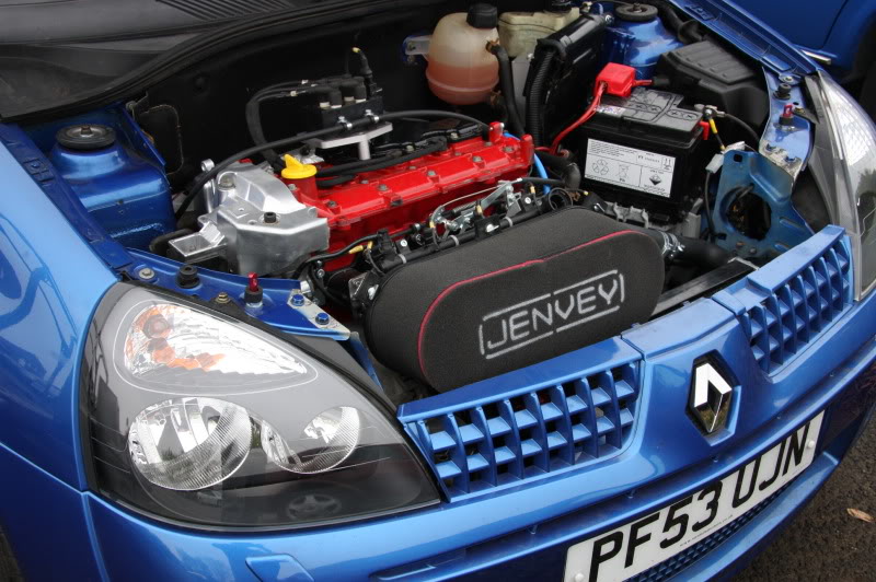

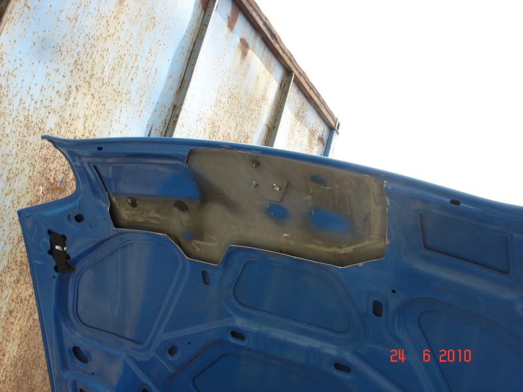

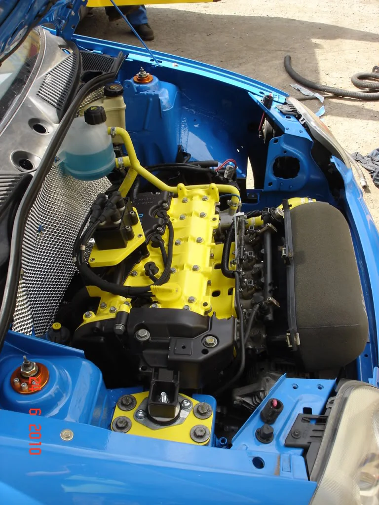

if the air filter is touching the bonnet that surface area of the filter that is not being used, baisically you cant suck air off a flat surface.
mare sure theres space around the filter.

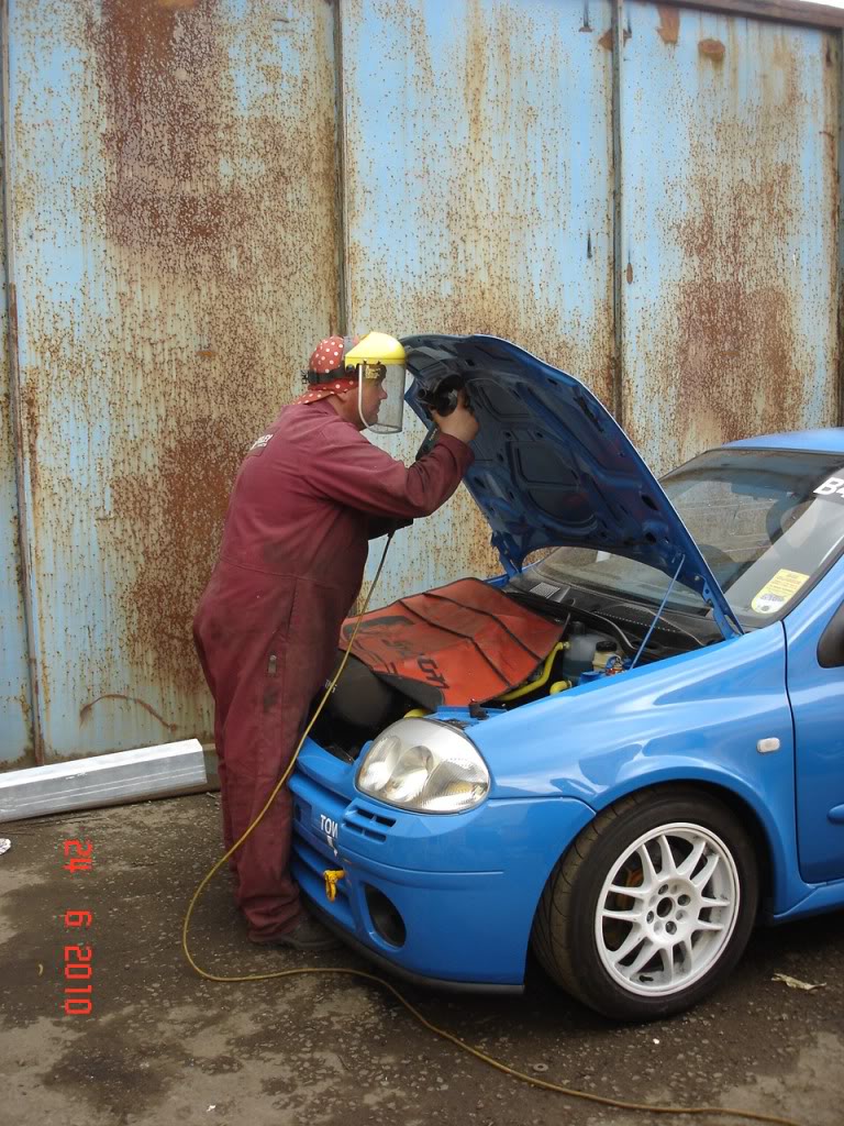

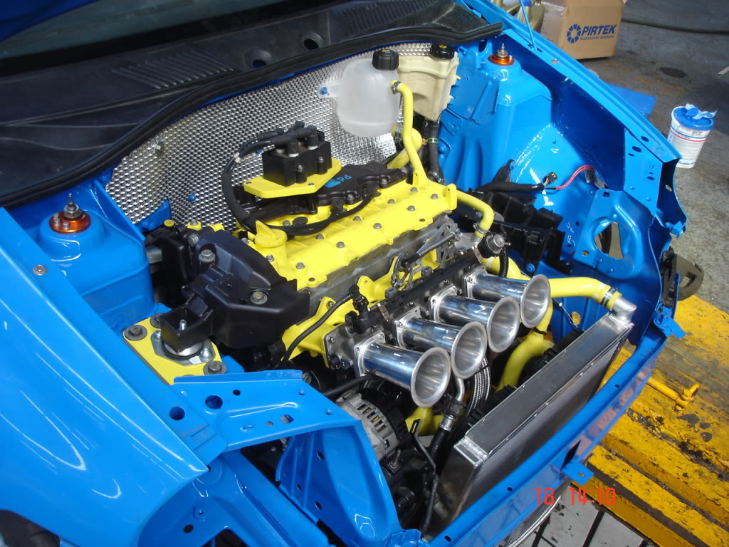

The engine is now complete!
Once fitted i wasnt too happy with how close the filter was to the bonnet so decided to cut the skin out of the bonnet. I didnt have the nerve so gave the job to the fabricator.

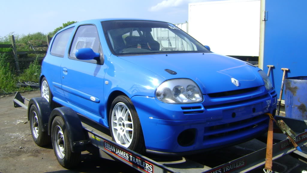

The car now will be loaded onto a low loader and will delivered to Tour De Force on monday morning, ready for mapping and running in.

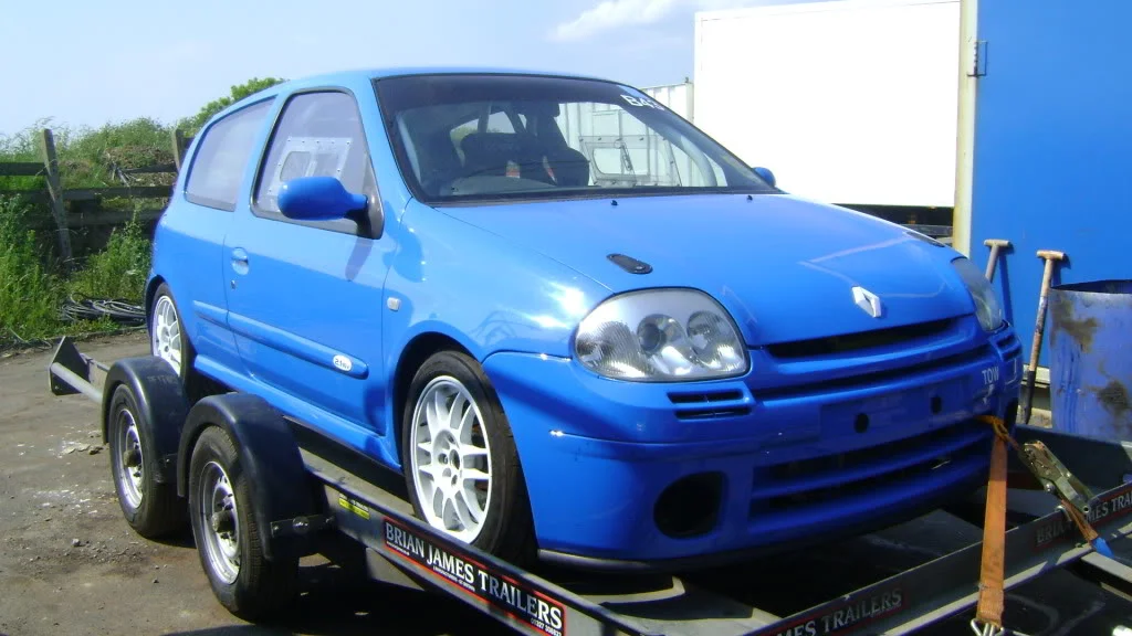

Ready to be dropped off at Tour De Force on Monday morning.

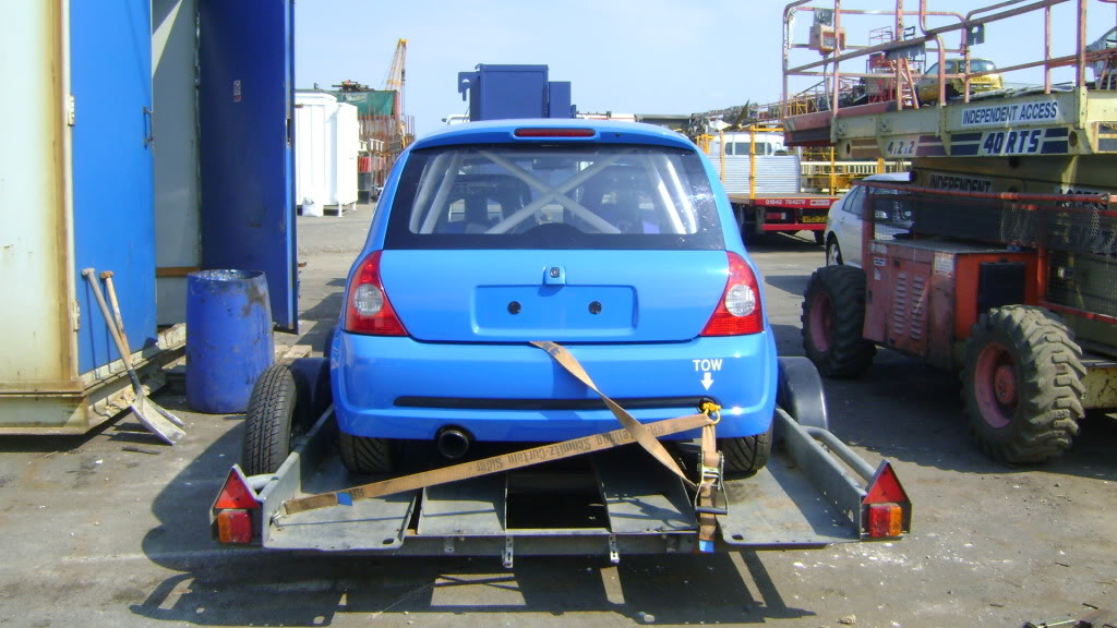

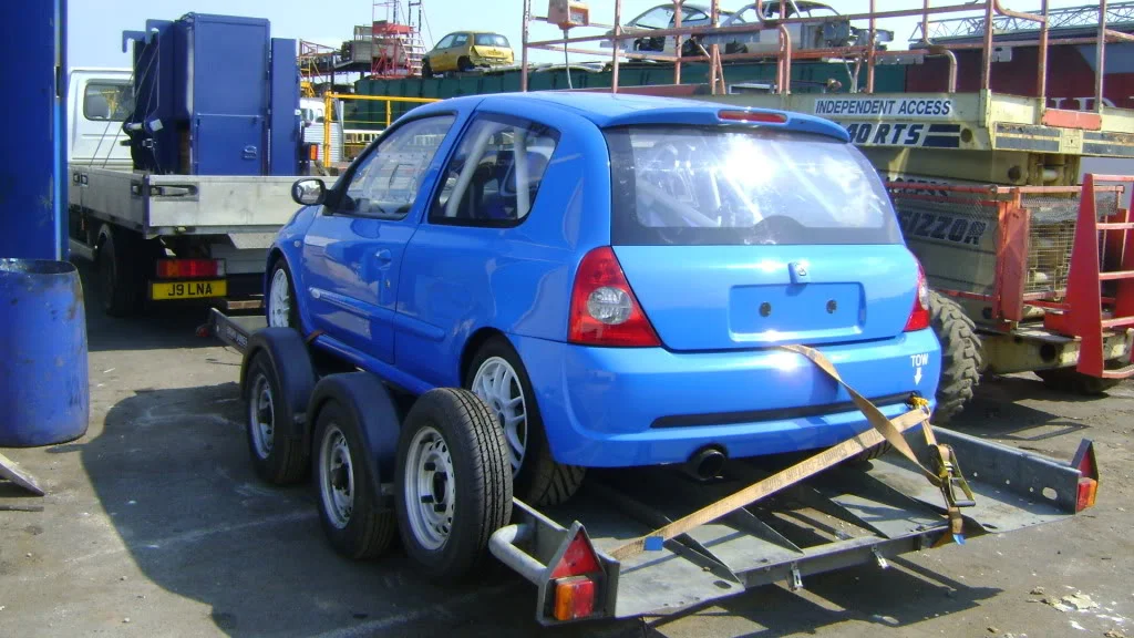

Car was delivered to Matt at Tour-De-Force last monday.
The engine bay wiring was stripped back with the renault ECU being removed. The dash was then fitted and control box wired up.
Matt got the car started and the engine sounded spot on, produced the correct oil pressure etc. But then a big puddle of oil appeared under the car. The crankshaft oil seal was not sealing correctly so the car lost about a litre of oil in 10 mins of 2k rpm.
Craig (AP Developments) agreed to collected on friday morning to fix the car under warranty. Craig has found the problem with the seal and is under way with sorting it out. The car will then be dropped off again at Tour-De-Force on wednesday for Dash calibration and mapping.
