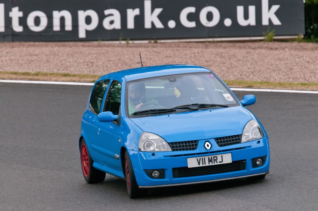

A small update

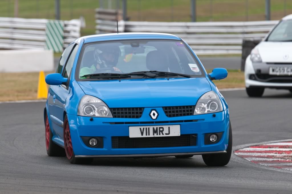

Went for another trackday at Oulton on Wednesday, was a good day but I did have some problems with my wheel bolts coming loose.
I re torqued them up and after 6 laps they were starting to come loose again. I then decided to remove them all, clean them up to remove any grease on them as they had been copper greased and then put them back in and torqued up to 110Nm. Seemed to do the trick as they lasted the whole afternoon, its never the same though when its in the back of your mind and you keep having to check :(
Anyway, some pics:

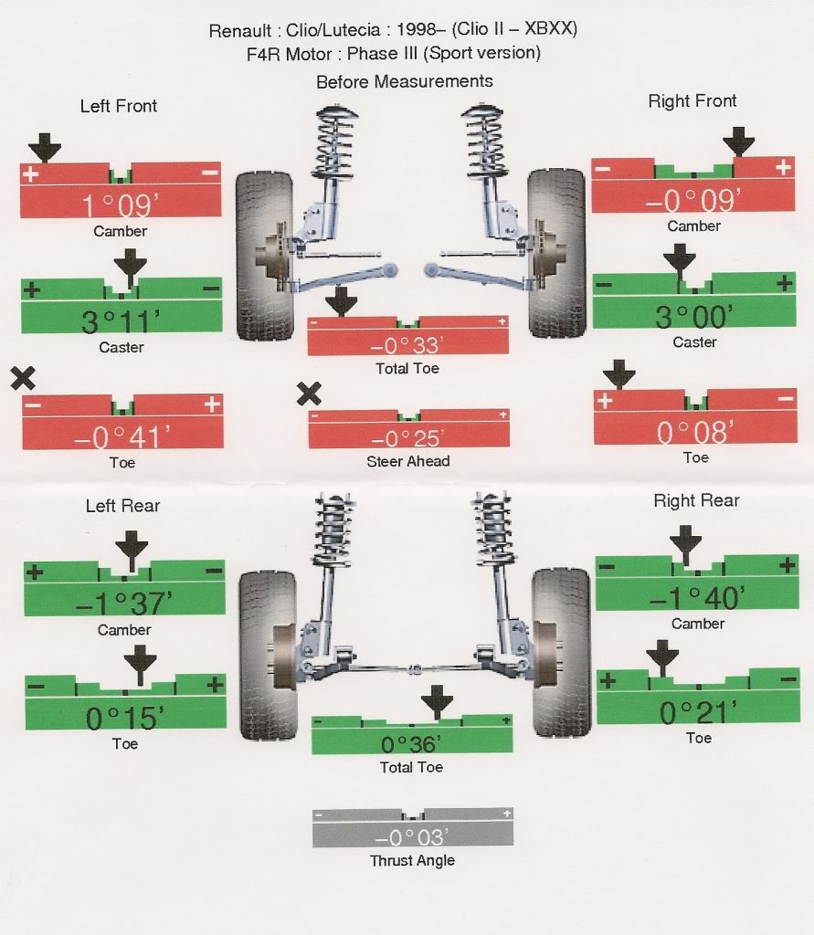

Also had my wheels aligned yesterday. The alignment was all over the place after I had my coilovers fitted even though the garage did the tracking, but they really struggled with it and I ended up taking it with a compromised setup tbh.
Here is the before alignment, as you can see its not a pretty sight:

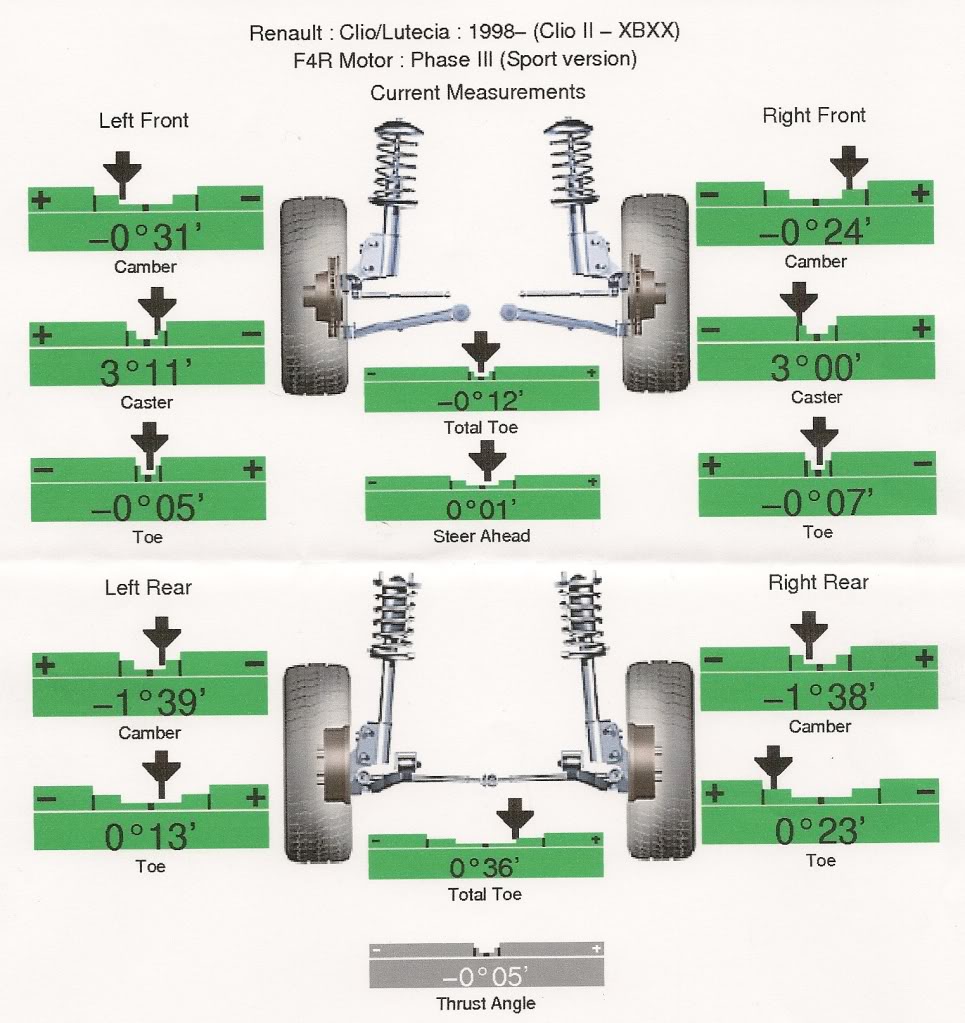

And this is after, all the readings are now within the tolerances but they said they would have preferred a bit more -ive camber on the front but thats as much as they would adjust.
Car is now transformed, steering is straight when going straight and it doesn't pull to one side like it used to. Its a much more enjoyable car to drive and since getting it done I have only driven it around town so really looking forward to a blast in the dales :D
Alignment was only £45 too, so happy days :star:

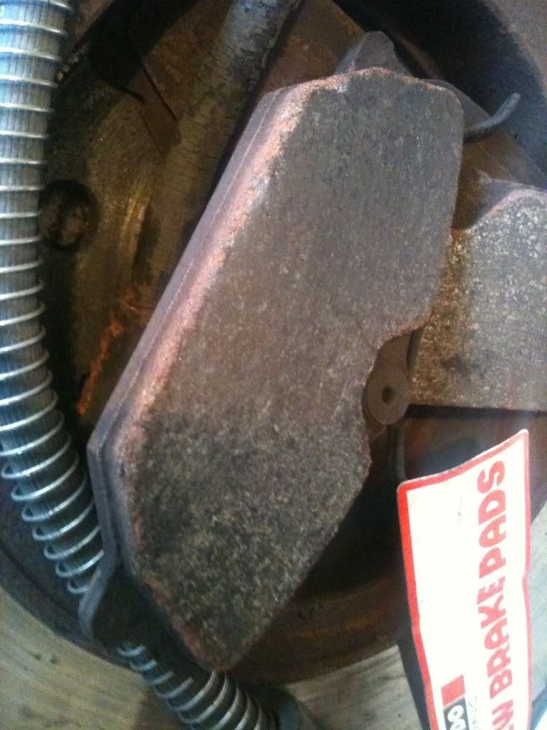

Got my brakes changed today, gone for brembo HC's, DS2500's, braided lines and ferodo dot5.1 fluid.
Not bedded in properly yet but already notice a big improvement, much more bite than before :)
Previous to this my brakes were only changed for OEM stuff in January and the brakes have deteriorated loads in the last 2 weeks.
3 of my front pads had cracks in but apart from that didn't look too bad imo, although I dont really know lol
Pic below shows one of the pads with a crack in and the thickness left.

You used OEM pads at that trackday? and lol at your before alignment print :) I had mine all done 6 months ago and doing about 6k as put it all out again...!! getting it done again on Monday.

Nice one Mike, where did you get the pads from if you don't mind me asking?, after that run we did last sunday i'm starting to think i really need to do mine, not a nice feeling when you need the brakes and it's spongy as hell :(

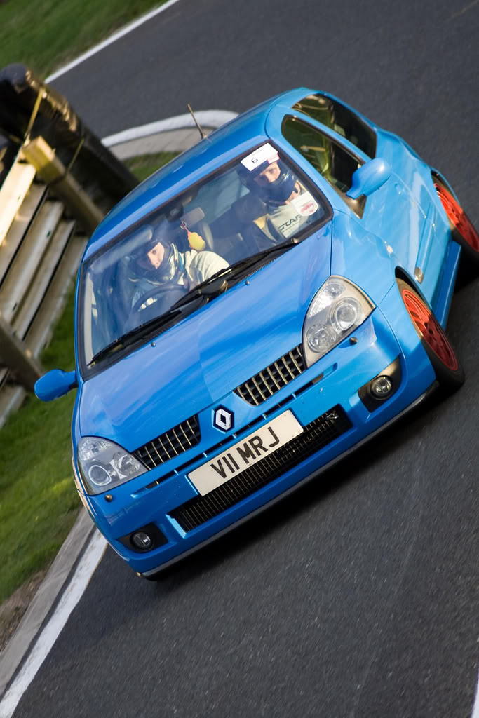

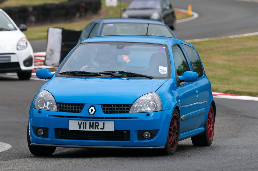

So, this month I have been to cadwell, with nixiej and feirny, who was naturally the photographer for the day ;)
Splitter looks so cool in this pic :D

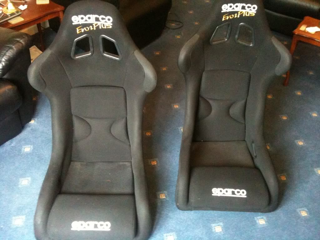

And today these babys turned up :D
So all in all an expensive month for me! Just on the lookout for harnesses and sidemounts, then my seats should be in for trax :D

Nice seats Mike :)........are those the ones you were looking at on ebay last week ?
Yep they are, paid way over the odds for them tbh :( They are almost mint though which kind of makes up for it :)

Ooooo very nice seats mate.
You are going down the same route as i have, make sure you keep everything so you can put it back to standard and sell. Its too late for me :(
Cheers mate, I am coming to the idea of selling all the standard stuff because I am running out of space to put it. I know I'll regret it though :(

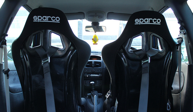

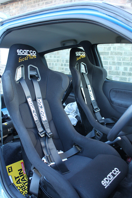

Anyway, another quick update, fitted my seats on Saturday. They are a million times better than standard as far as support goes, and the harnesses are no more hassle that seatbelts I have found being the normal buckle type.
Seats by mjenic, on Flickr

Brilliant seats Mike, i would love some of these myself.

Those seats are mint Mike! Cant wait for a sit in them, oh and my car has just been sold :( lol Cant beleive I wont have it after Saturday!!!
Just seen :(
Yep they are nice, think they are exactly the same as chris's but a bit, erm, wider :eek:

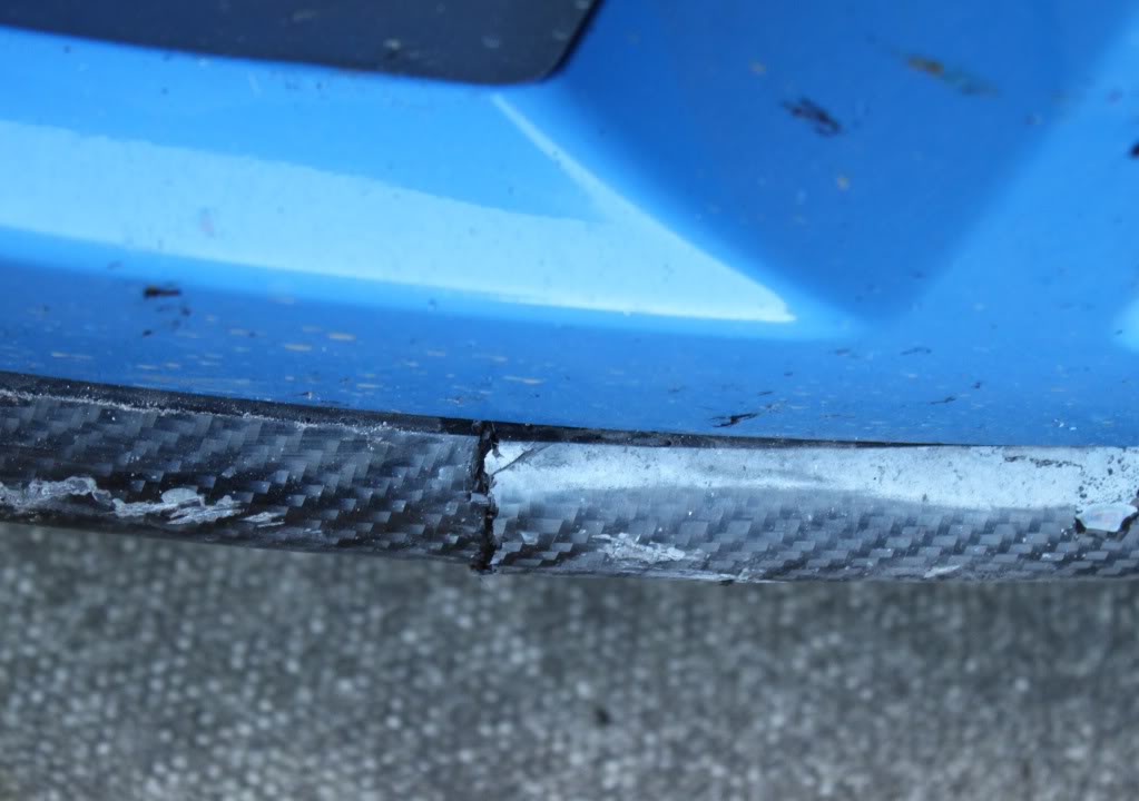

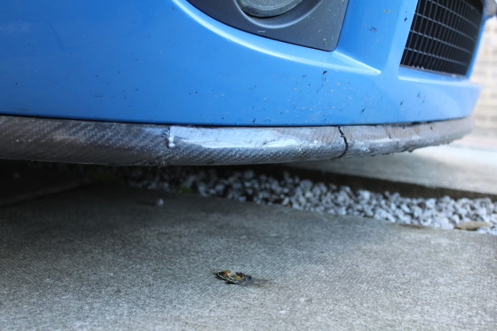

Well it had to happen eventually, especially since half my street is unadopted :(
Looks split in 2 places, only noticed the 2nd when I looked at the pic :(

Unlucky Mike, bound to happen at some point. You going to get another CF one or something else?
Unsure yet, I am going to leave it for a while since it looks ok from a standing height. Might get a fabia one but would prefer another ktec. Another option would be to try and bond this back together and spray it black, might try that first.

Seats look real nice dude, nightmare about the splitter. Doesn't look too bad at all in pics tbh, at least its still splitter shaped lol
jenic
Re: RB182 Diary
You should have gone 3" harnesses :(
Otherwise can't fault it :approve:
Cheers mate.
These were £40 each, brand new. Couldn't get anything in 3" close to that :(
Happy with it though, nearly got some blue 3" one's off ebay used but just really wanted black :eek:

Now all they have to do is withstand the test of time lol.
Got pissed off with the bimarco's after a couple of months. I'm taking it your going down the fully stripped route dude?
