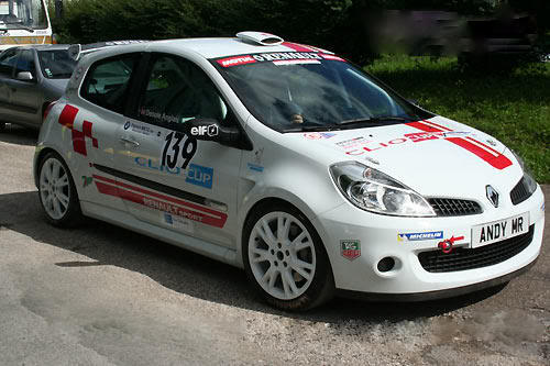

Hi guys, newbie here,
I've been racing in the French hillclimb championship since last year in a new racing clio cup. I've run the car straight out of the box so to speak, having great fun especially as some of the events are up to five miles.
OK, problems, well the main one has been driving a left hooker at speed, some very hairy moments close to right hand ditches!!! Also have had problems finding suitable soft slicks because of the 17" boots, am running the softest compound Michelin circuit tyres at mo. That apart the car sticks like the proverbial s**t when the tyres do warm up.
Next step is to upgrade the motor from 205bhp, i see a few of you guys on the forum have links with clio cup racers and as I'm not restricted to power output, I was wondering what your suggestions might be.
Cheers
Andy
^sweet
throttle bodies and cams, even whack the megane 225/230 turbo engine in (although its yet to be done!)
What mechanical restrictions do you have for your championship or is it open?
Even if you are free on power, do you still have to use std. inlet?
/Yoz
Looks lovely mate, as above. Meggy 225 lump aint been done but i reckon it might be a bit tight as we all know there aint much room in the 197 bays.
