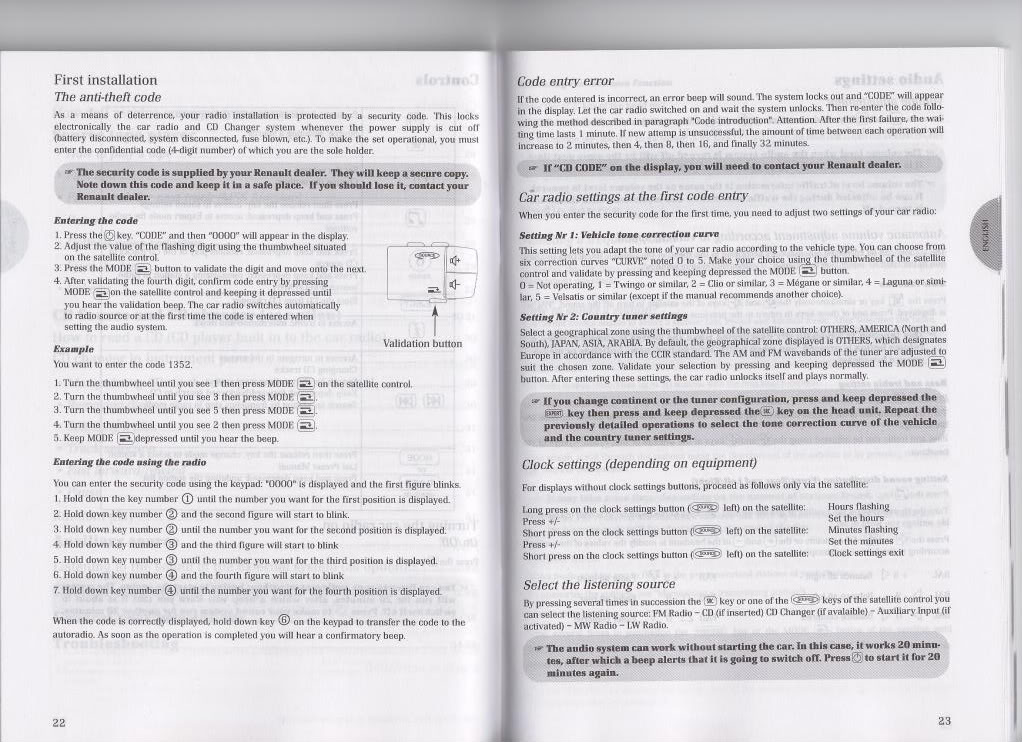

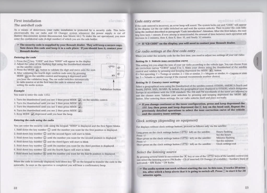

Have you got the radio manual? It runs through it in there. I can't be bothered to type it out, but will if you haven't got it.
The keys? The keys are to remove the radio?. Should work fine if you just type in the code, then hold down one button iirc.
I was following other advice and hitting any other button after the code was entered. didnt work
just went and tried holding 6 there and spot on. +1 for this thread ;)
