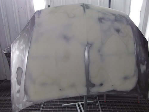

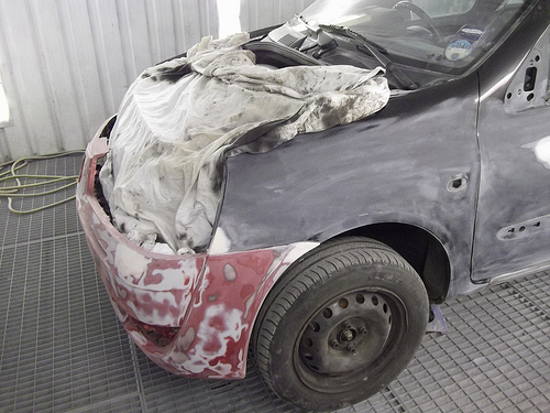

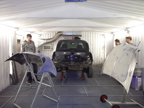

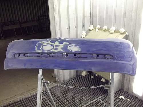

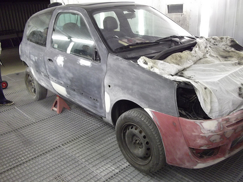

right, had the idicator primer on most of the car today, block sanded it down to see the high and low spots, another tin of filler, a dozen sheets of sandpaper and we are still not satisfied.
so plans for tommorow is another coat of indicator, sand AGAIN, and the hopefully start to shoot some colour into the blighter :)
pic'sof current state, not much change but all in the booth ready for paint now :
wings blended in with the sport bumper nicely :)
and the bonnet which i had wished i had just bought a new one, pain in the arse to get it right :banghead:

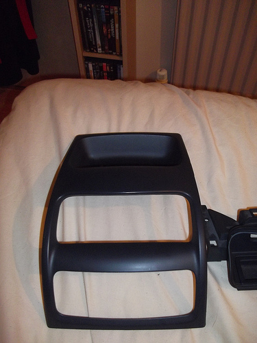

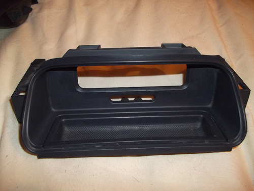

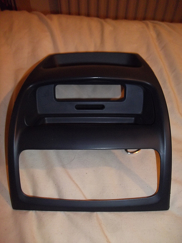

plus my little modification which i think is unique, bar the standard crap renault sat nav :rasp:
plan is to intergrate a sat nav ( of my choice ) into the centre console, the batteries will be removed from the satnav and will only be powered when the egnition is turned on.
to update it i will plug the usb lead into the nav and run an extension usb lead from the original into the glove box so that i can update via my laptop :)
standard all together
then cut the top curv shape off allowing the satnav ( dismanteled of its cassing ) to stand almost upright underneath the re-molded into a bigger curv
then cut this up and re-modify so that the screen can fit snugg behind the enclosure.

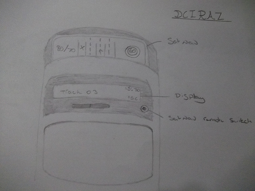

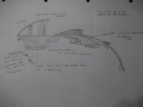

right so whilst i was bord last night, i desided to draw up some comical plans for my sat nav build, drawing is not my strong point so bare with me :eek:
front view as it would be seen inside the dash.
side on view of the workings with in. basicly most of it you won't see but....
