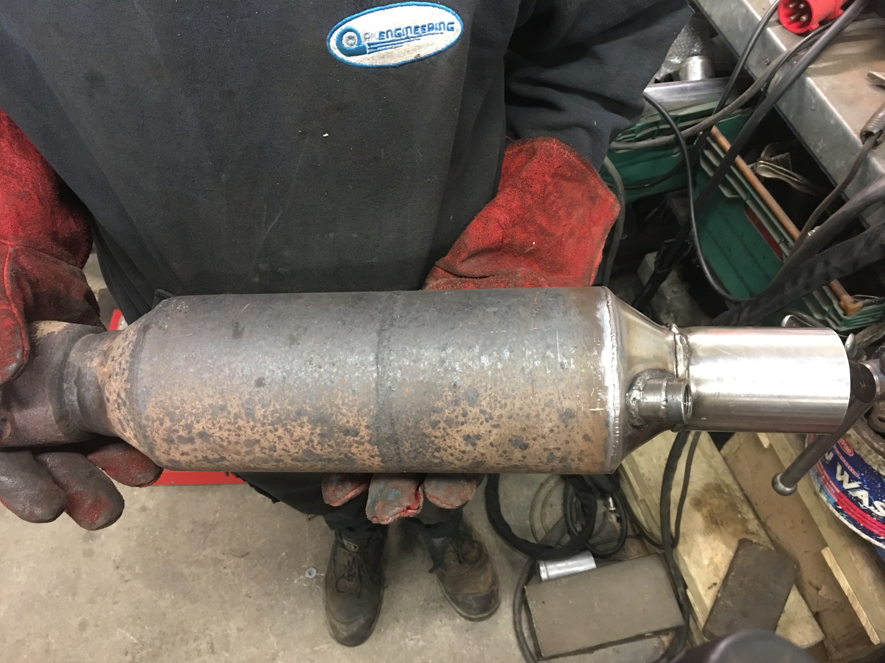

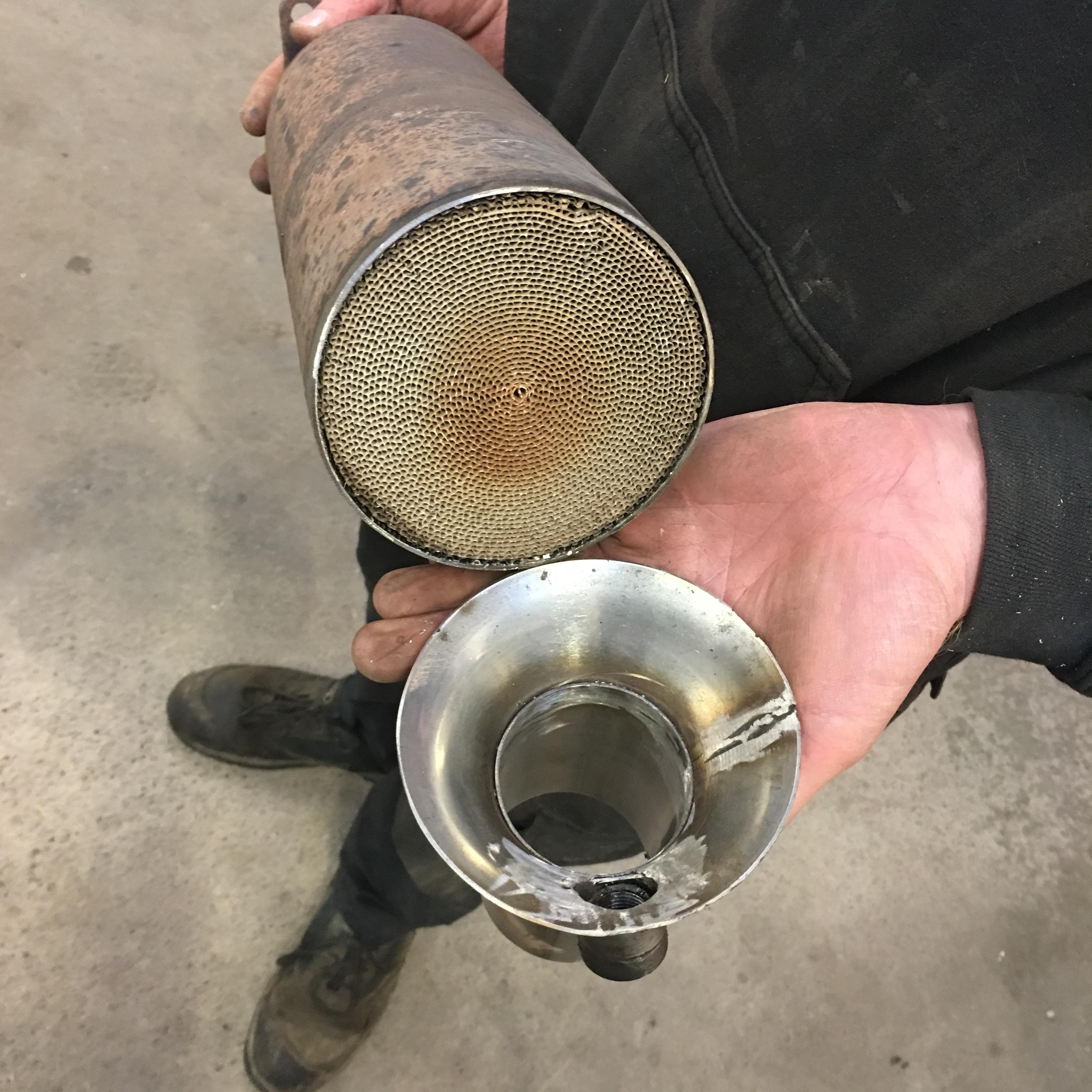

Thanks, and thanks for the feedback on suspension. Another idea for the melting pot. I'm torn on the budget, we've already spent a lot more than planned. That doesn't mean it's a pattern to repeat, it also doesn't mean it's worth economising for the sake of it... Very tempted to get stock shocks. It handles well, even on the tired shocks, and I think the setup would work well at the 'Ring + we can get them trade. The current main hope is to have the funds for DN trips over the next few years. I don't think coilovers will significantly improve that, and they will dent potential funds.
NB: Don't forget we kept the CAT :smiley:. The CAT and quality of the PMS system are what we're attributing the low 81db. Also, there is no way it was 81db. However, that doesn't matter because it's significantly under 90 and therefore not worth worrying about.
Speedy300
  M140i
Budget going out of the window, I know that feeling!
Did you get the PMS sports cat? I was planning to get the full system including the sports cat so it would pass MOT's. I think they tend to be generous with their DB readings at Thruxton.
No, we stuck with the original CAT as advised by PMS. Nicky's kit includes a higher flowing end for the original CAT. And, by all accounts, the CAT is pretty good. Ours certainly looked in good condition after 110k when we chopped the end off. It breezed through our MOT emissions test.

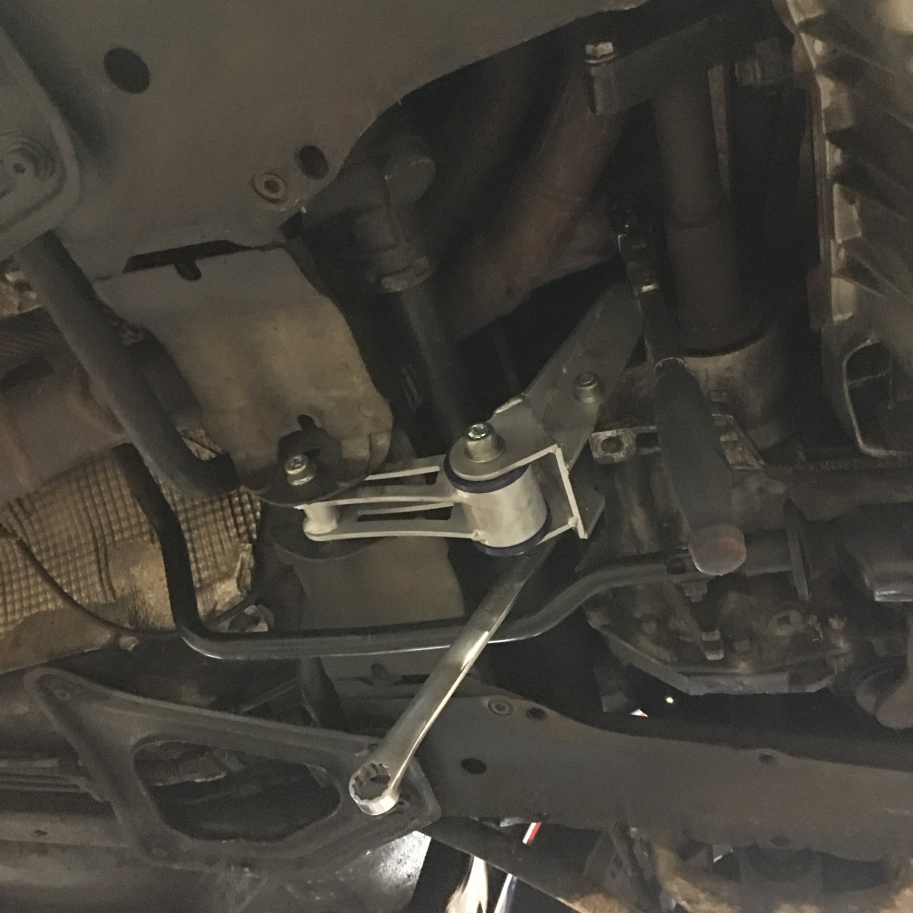

After each track day and before the next outing we spanner check the Clio. Oil changing it every 1-2. Since buying it the clutch has been a concern and we've suspected the shocks are also originals. At Bedford, Jem called time at 4 pm because the rear wheel bearings were making a din. The shocks and clutch felt fine, better than they did at Thruxton/Combe.
The todo list looked like:
  1. Replace Rear Wheel Bearings
  2. Fit Vibratechnics Engine Mounts
  3. Replace Shocks
  4. Replace Clutch

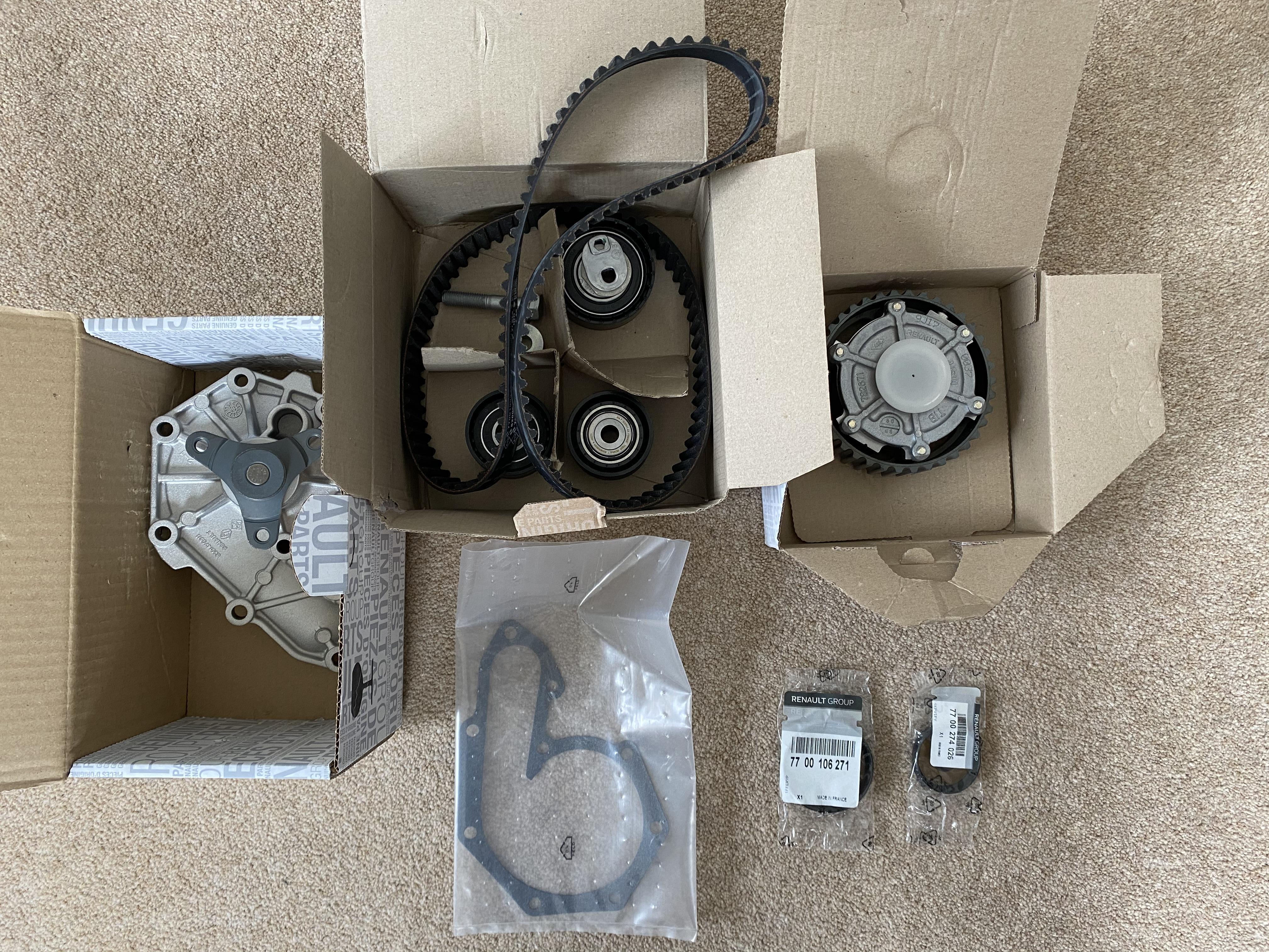

  5. Replace Cambelt and dephaser
  6. Fix ePAS issue - The knob needs twiddling before it cuts in
  7. Fix ABS issue - Semi-fixed, we have a switch on the dash to turn it on/off again
We're all super-busy and focused on a need to do, only. The cambelt and dephaser were done by the previous owner. With no receipt and some interesting paint markings to suggest it might not have been timed with the correct locking tool. However, we took a peek at the belt and a healthy dyno run suggests it's not am immediate worry. Therefore, we just did an oil change and fitted SKF rear bearings. Leaving the rest for another day.
Thruxton again, LOVE THIS PLACE. No videos as the GoPro failed. An easy 120mph+ indicated through Church and no need to lift. An epic-day with LOTS and LOTS of laps and great friends. CD run a great event. MUCH better than MSE, no cones scattered over the track and a far better briefing. Our friends with the VR came too and were equally taken with Thruxton. We let them out in the Clio, this proved a mistake as the Oaf broke our seat rail with his heft.

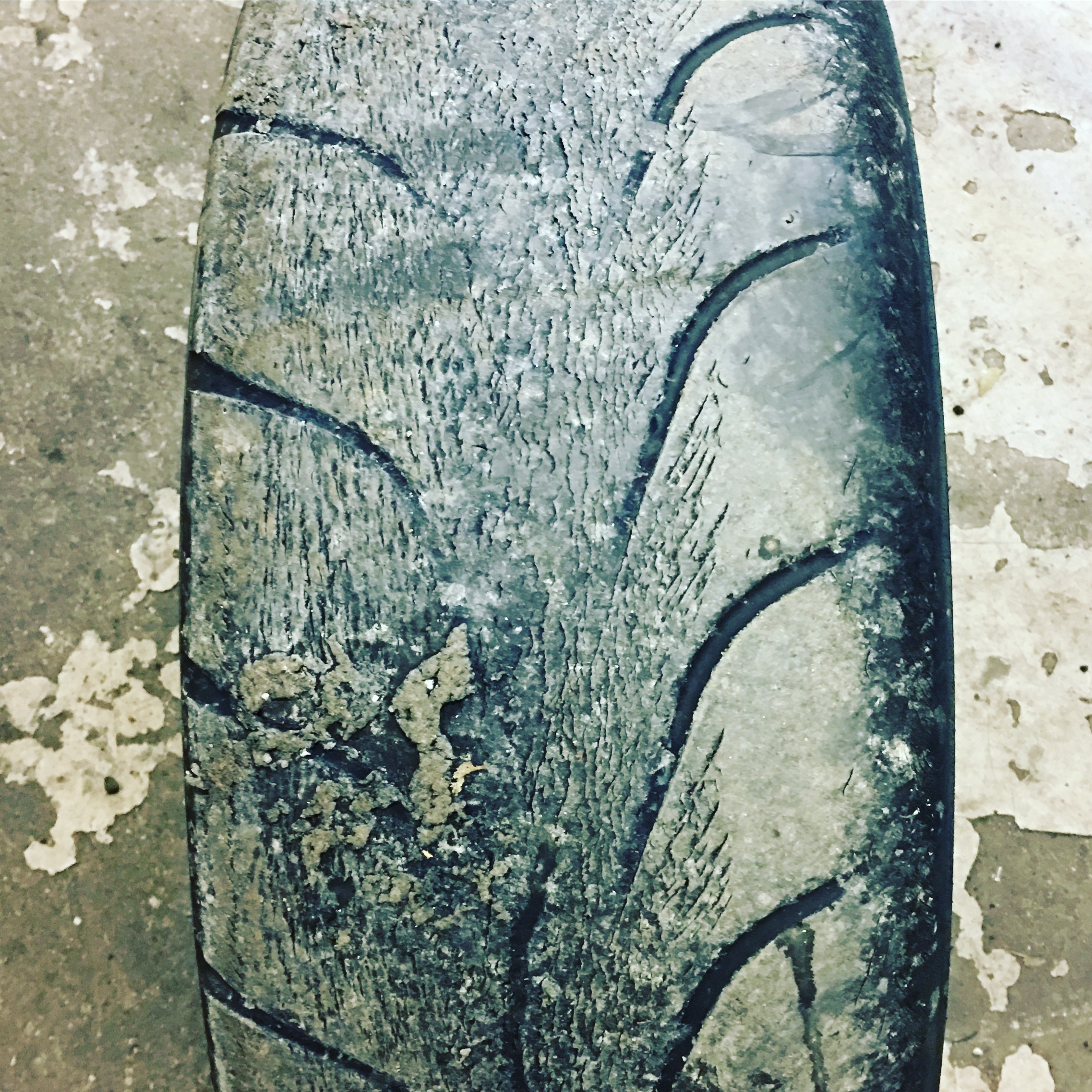

Church is BRUTAL on tyres, we refer to it as the cheese grater...
Thruxton confirmed the shocks were shot. After 110k and several track days on top, it's not surprising. Given how well they had done and how enjoyable the Clio was to drive, we opted for some factory replacements and used the savings vs. coilovers to buy some more Pure Motorsport Upgrades.
Top mounts and strut brace ordered and fitted.
We also used tried and failed to fix the ePAS. We tested all wires, cleaned up the earth contact and still, it oddly requires us to twiddle the knob and wiggle it (a nod to Mighty Car mods) to kick in. Hey, ho, off to Rocky we go...

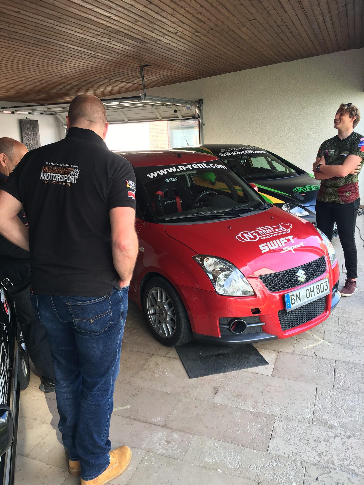

Having greatly enjoyed the Swift, I'd be remiss for not mentioning a small issue that occurred at the end of the day...
Dropping the Swift back, the owner of N-Rent was super pleased to see us in one piece. He'd been out doing some laps himself in their Clio and had noticed us overtake him.
Pulling the data-card he asked who was driving around 10:30 am, which was me. He said they had a GPS'd 127mph on the straight into SX, and that was fast in a Swift! But we had a problem... I'd over-revved the car by 500 rpm and that was a 1000 euro fine.
This isn't my first rodeo, and I asked the day before if it was possible to over-rev their Swifts when changing up. Or, if they only counted overrevs on downshifts/hero shifts. The owner assured me it was the latter. Using all of the Revs was fine. To get the most out of the Swifts you have to use ALL of the Revs. They make 'good power' up-top and to keep it 'on-cam' the ratios require using every drop.
Firstly, the owner was surprised I could read the data plots and point out it was only 200rpm over, not 500. Secondly, I could point out it was on up-shifts and not a hero shift as he'd tried to 'sell' it to us as. At this point, the owner couldn't speak or understand English anymore and I realised it was a shakedown. Our deal was very good and our extra laps must have eaten into their profit. I didn't want to leave the day with a bad taste so I offered a further 100 euros to smooth it over and get our deposit back (blocked on my credit card).
The 100 euros did the trick and we were all smiles again and invited to sign the wall.
For this reason, I won't hurry back to N-Rent. A shame, up until that point the experience was great and the Swift ideal.
Massive thanks to my friend and his son for including me in their special trip. The above is just a side note in an otherwise EPIC excursion.
Worth noting, I had the only over Rev. The other laps were all fine and my friends' data plots were all around 200 rpm lower than mine from what I saw. The other laps were all wet, this was one of my only dry/damp two.
N-Rent could still be a good option to hire from, unless you like ALL of the Revs :D.
Also worth noting, all of the rental companies charge for over revs and data log. N-Rent is not unique in this. This is the only time I've been charged/accused though...

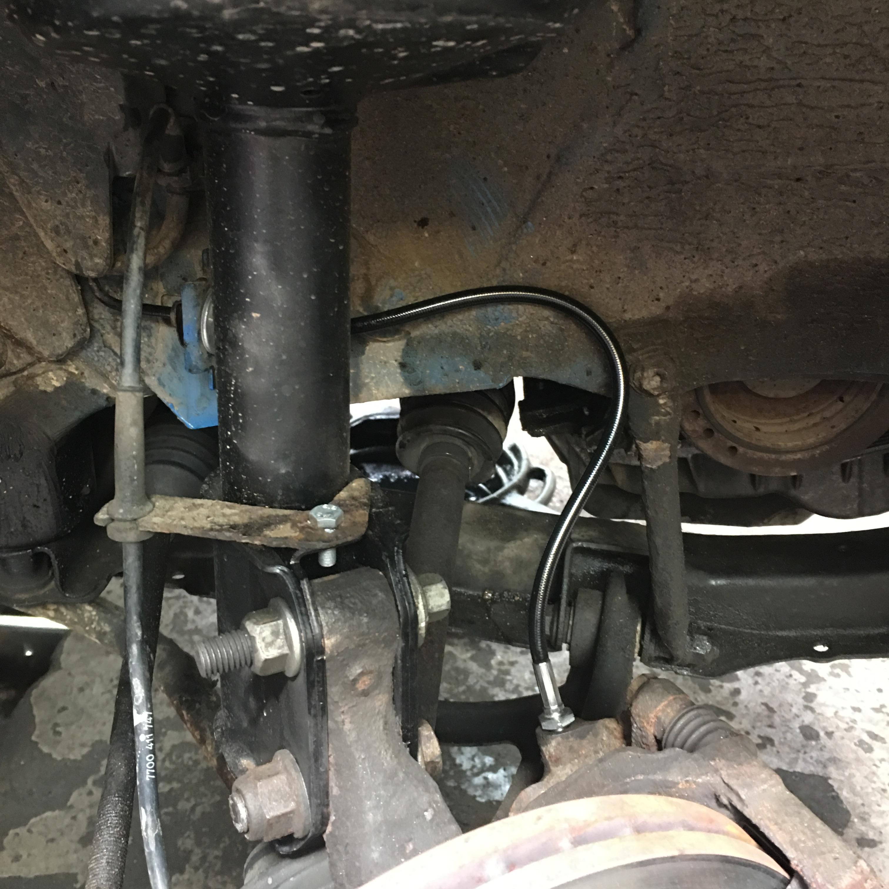

Before Dony, we also did an oil change, our usual spanner check and fitted SS brake lines and the Vibratechnics engine mounts. And, sadly discovered a pretty big oil leak from the sump gasket. We silicon sealed it to stop it dripping and kept an eye on it throughout the day. Not a drop was split but it's not a fun job to replace... Our list now looks like...
  1. Fix oil leak(s)
  2. Replace Clutch
  3. Replace Cambelt and dephaser
  4. Fix ePAS issue - The knob needs twiddling before it cuts in
  5. Fix ABS issue - Semi-fixed, we have a switch on the dash to turn it on/off again

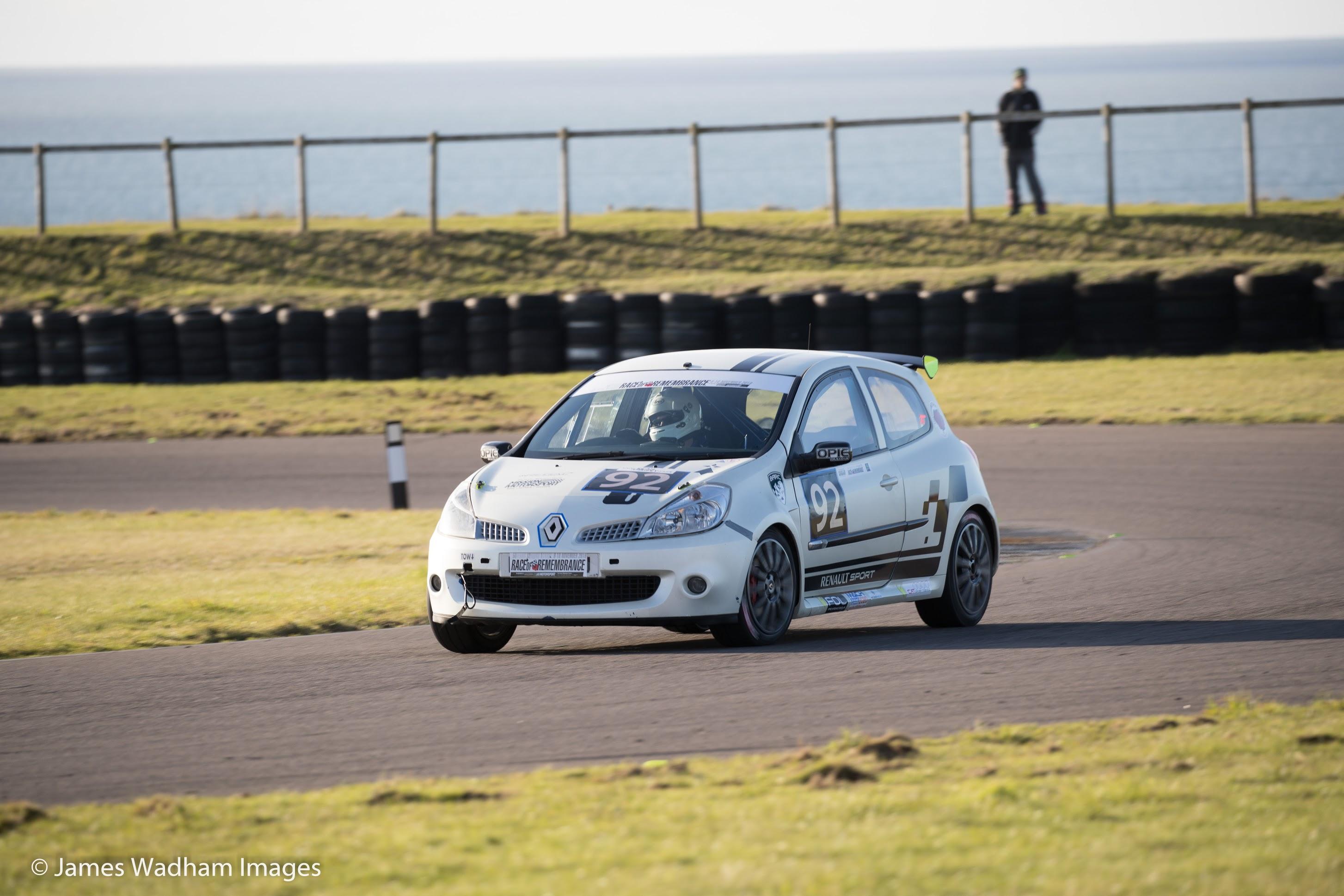

19-years and 64-days before this photo I stopped at this Crickhowell Petrol Station. Headed for Portsmouth to start a career with IBM at the tender age of 18.
In this pic I am driving the other way heading for Anglesey Circuit to race in the 2019 Race of Remembrance [RoR]! And, still with IBM! Before descending into my usual ramblings please consider supporting this exceptional charity. Corona uncertainty cancelled this year's RoR [2020]. How can you help?
And, acknowledging two people better with words and wheels than me... Here are Nick Trott and Dario Franchitti on 2019's RoR.

Our writeup begins in the middle of RoR 2019, with the sorry photo above. In the wet and dark, the owner lost it into Rocket, tagged a marshall post's concrete foundations, and broke his collar bone. Ending our race.
My first challenge was telling the other paid driver the owner had crashed. My second was repeatedly answering "You must be gutted?". Yes... But no... Not really...

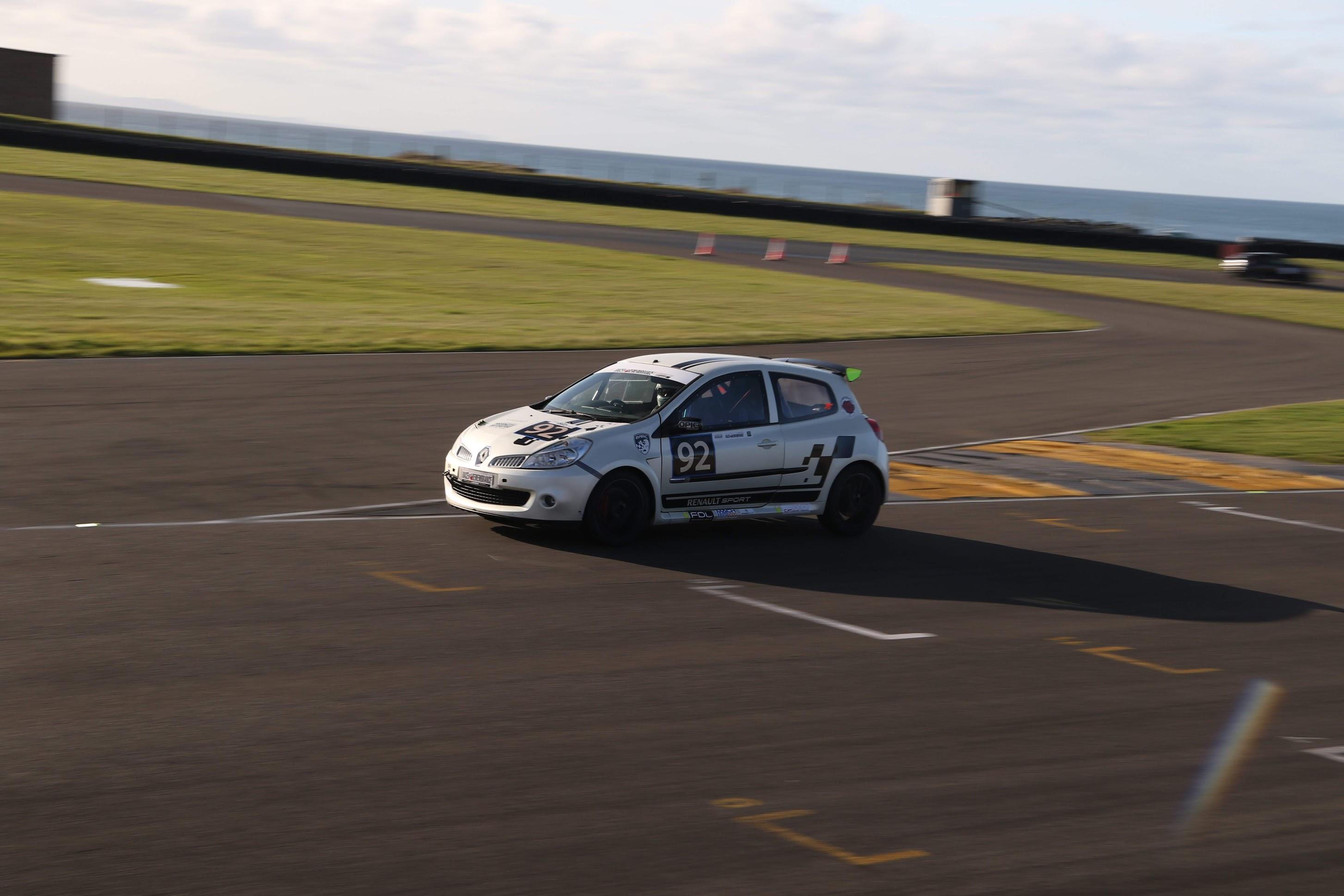

The practice session opens and the owner takes the Clio for a few laps to warm it up. It started sunny, then a bit overcast and moist. The owner brings the car back in and it's all change to glorious sun shine. Briefed by the boss, I am let out for 3-laps to see how it goes.
IT'S FAST, faster than I expected. The LSD works well and rewards keeping your foot in. This is counter to how my open-dif Clio 182 works and takes some recalibrating. On mine, a little lift tucks the nose. With 92, lifting seems to understeer and it rewards remaining more 'committed'. My first three laps aren't a disaster and I pit for some feedback and tips. Our hot-shoe offers corrections to my lines into Rocket and am told no braking required for the first corner.
Out again for another 3-laps, I manage to miss our pit board and extend this to 5. The last lap of which sees me turn in too early for Church. Realising my mistake and carrying too much speed, I lift. The Clio starts to understeer only making my situation worse. The grass is now inevitable. The question becomes how many wheels and spin or no spin. Back on the gas we're no longer understeering. I can see I am going to make it. Momentum is on my side and if I keep my foot in and 'deal with' two wheels on the grass it'll be 'fine'. Sheepishly return to the pits to be greeted by the owner "Had an off have we?". "Ah... you saw that?". "No, but have a seen the other side of the car...". The poor Clio is coated in mud from our excursion. My quickest lap was a second off the owner's. This prompts two things, the end of practise as I've been deemed quick enough and time to get some new tyres. The Michelin PS4s are our wet weather option and qualifying is going to be dry-dry.

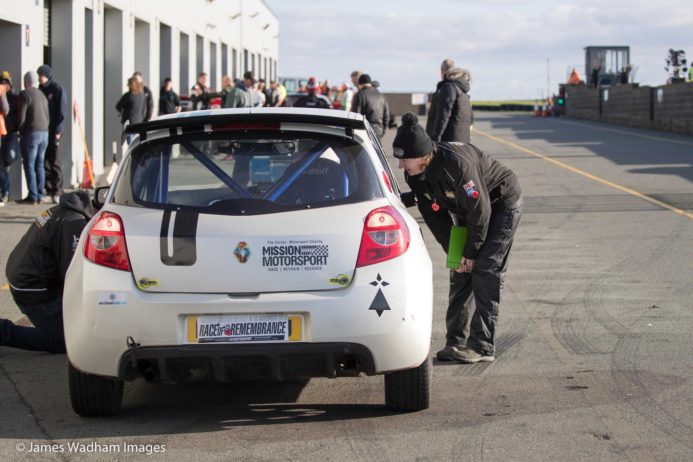

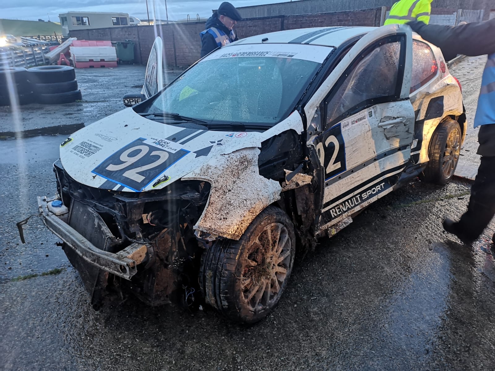

It's on
Cars assembled in Parc fermé, it's getting real.
Our original driver order changed because the fourth driver's charms have worn off. Allowed to race without having taken part in qualifying, he is not allowed to race at night. The order is the other paid driver to start, then the owner, hot-shoe, and me for the final stint of the day. 90 minutes in the dark! The start is Chaos, the other paid driver does well to avoid contact and survive. At the end of his stint, he hands over to the owner, who goes on a charge. We are watching in awe as he moves up 3-5 places a lap. His lap times tumbling. And, then... We see some yellows, hear rumours of a biggie, and see an ambulance go down the pit lane. Hot-shoe and I are watching the timing board and can see 92 not moving. It's not a good feeling. 92 starts dropping through the order and we learn it's the owner who has crashed.

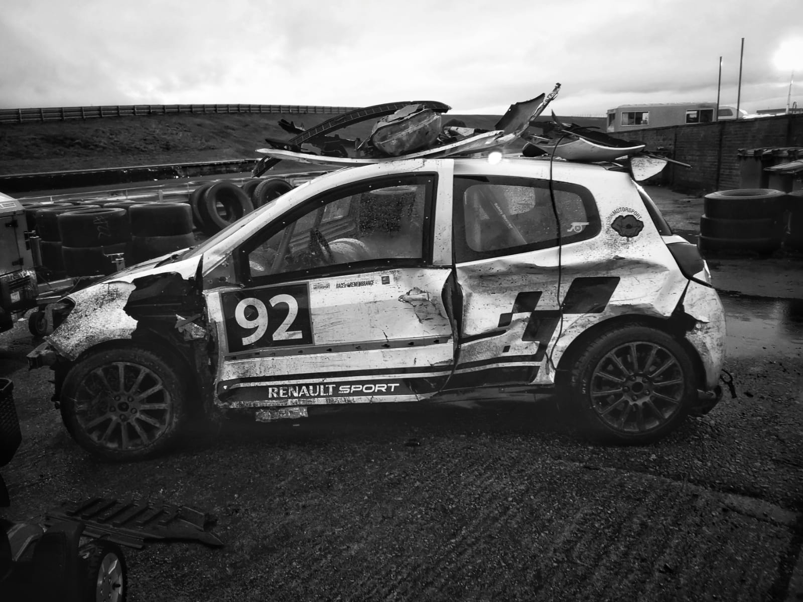

It's off

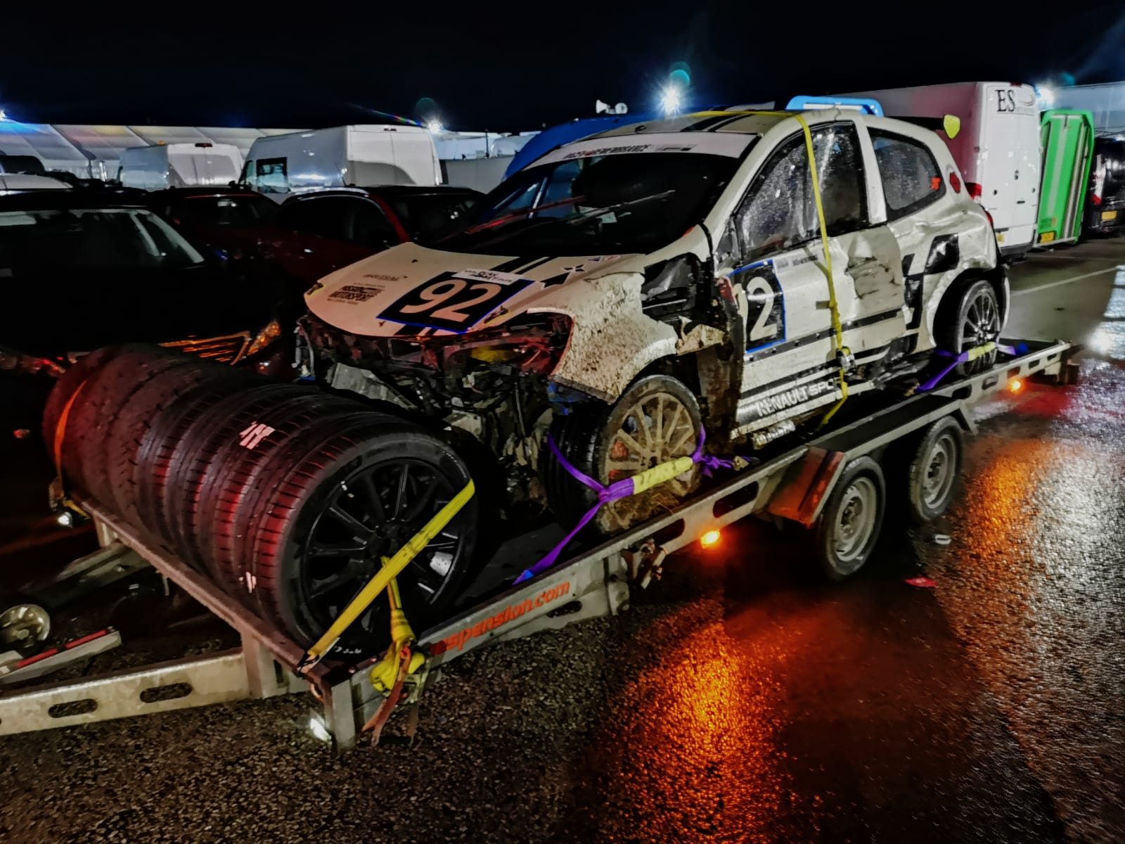

He's OK but in shock, looks a bit pale, and our medic's concerned his shoulder is badly broken. Our mechanic and medic take the owner off to A&E in the 'sheddy work tool'. Figuring it would more comfortable and quicker than an ambulance.
A friend, Rich, who came to spectate and I set about loading the Clio on the trailer and helping where we can. Keeping busy keeps my mind off things and there is a lot to do and work out in the aftermath. Rich was on Facebook straight away trying to find a local Clio. His spirit inline with the ethos of the event. However, there is no way the marshalls are going to let 92 back on track. It's all our mechanic could do to stop them cutting the cage. 92 is dead, our race is run.

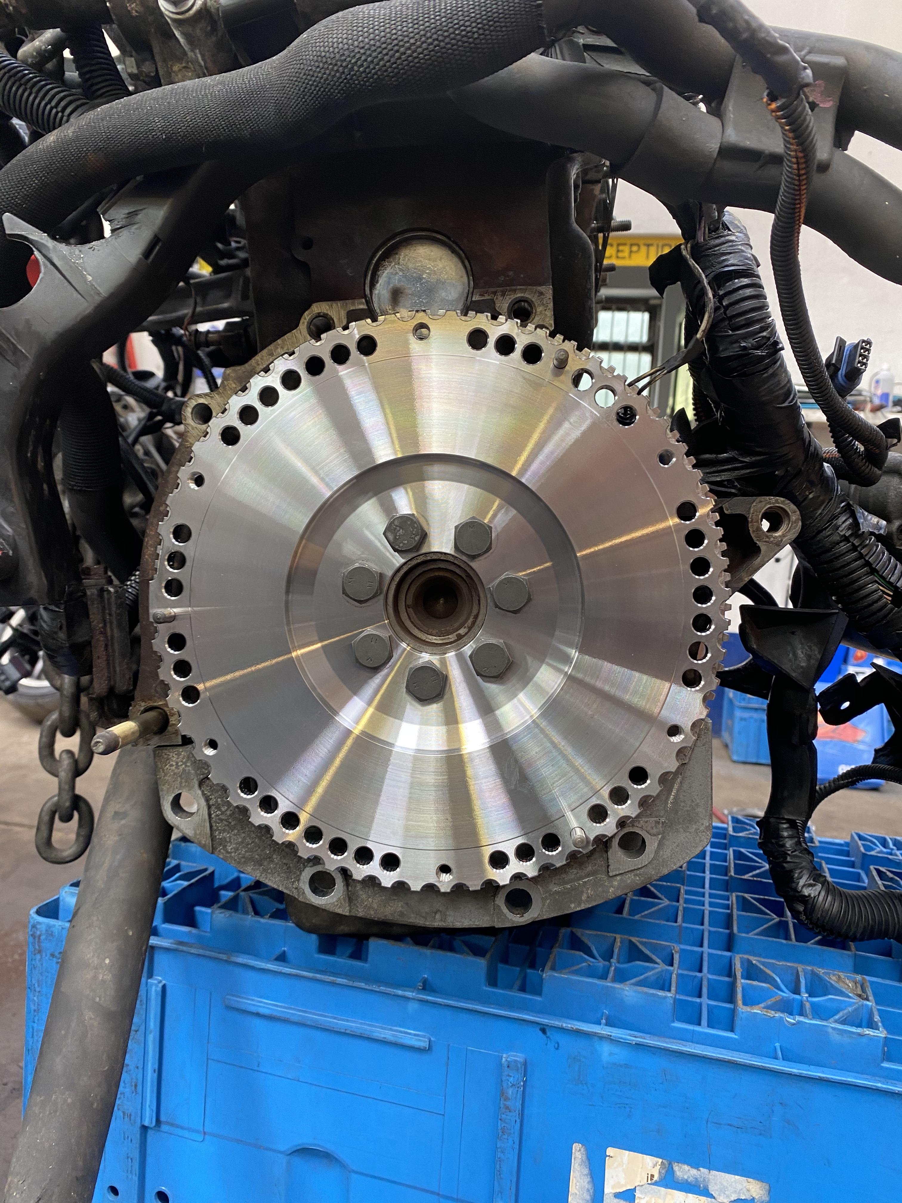

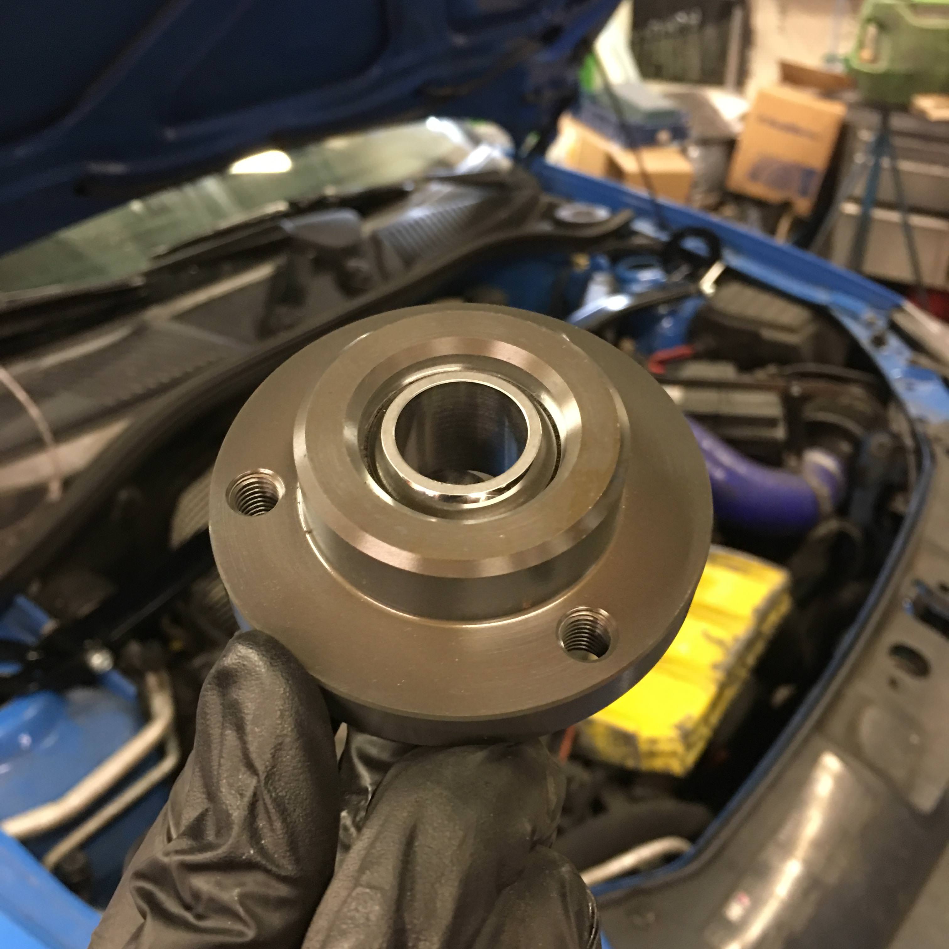

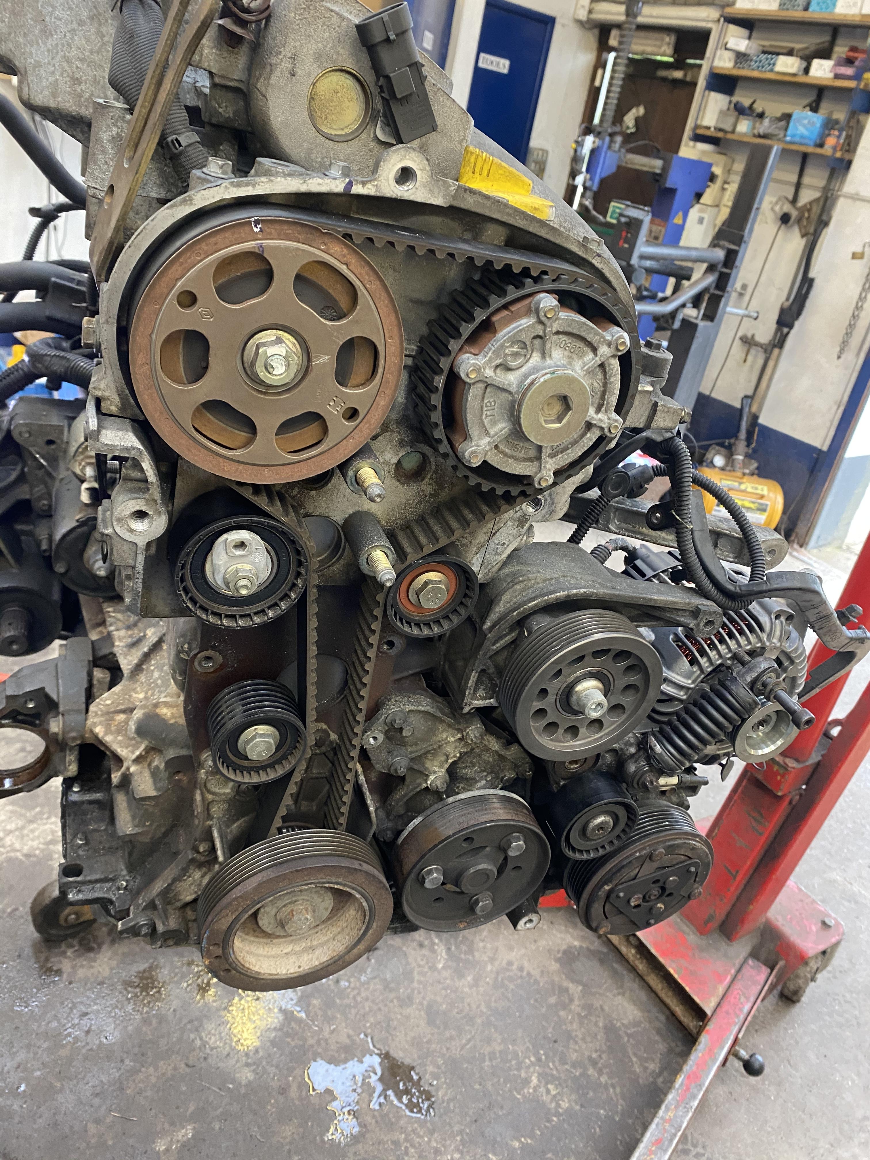

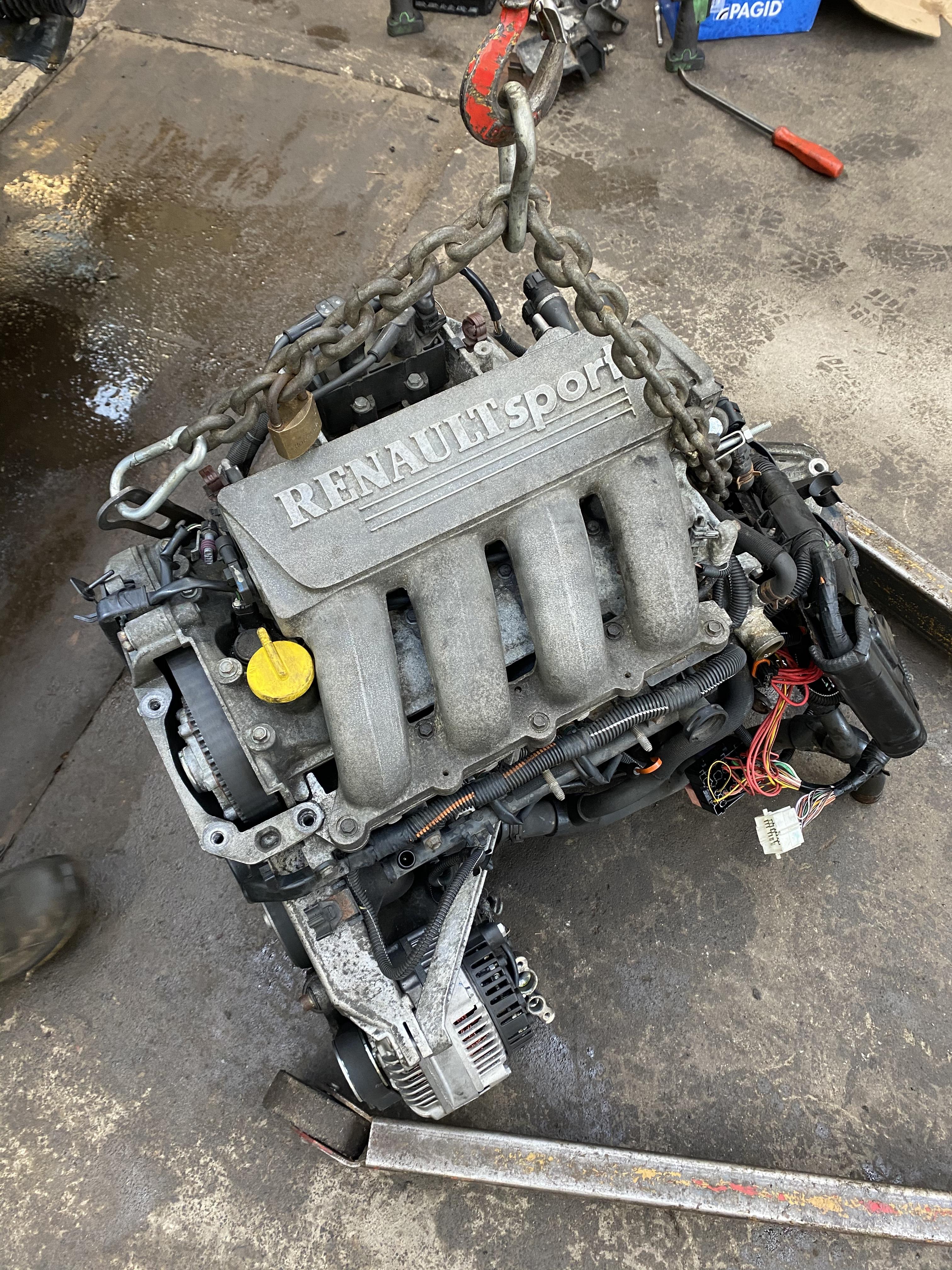

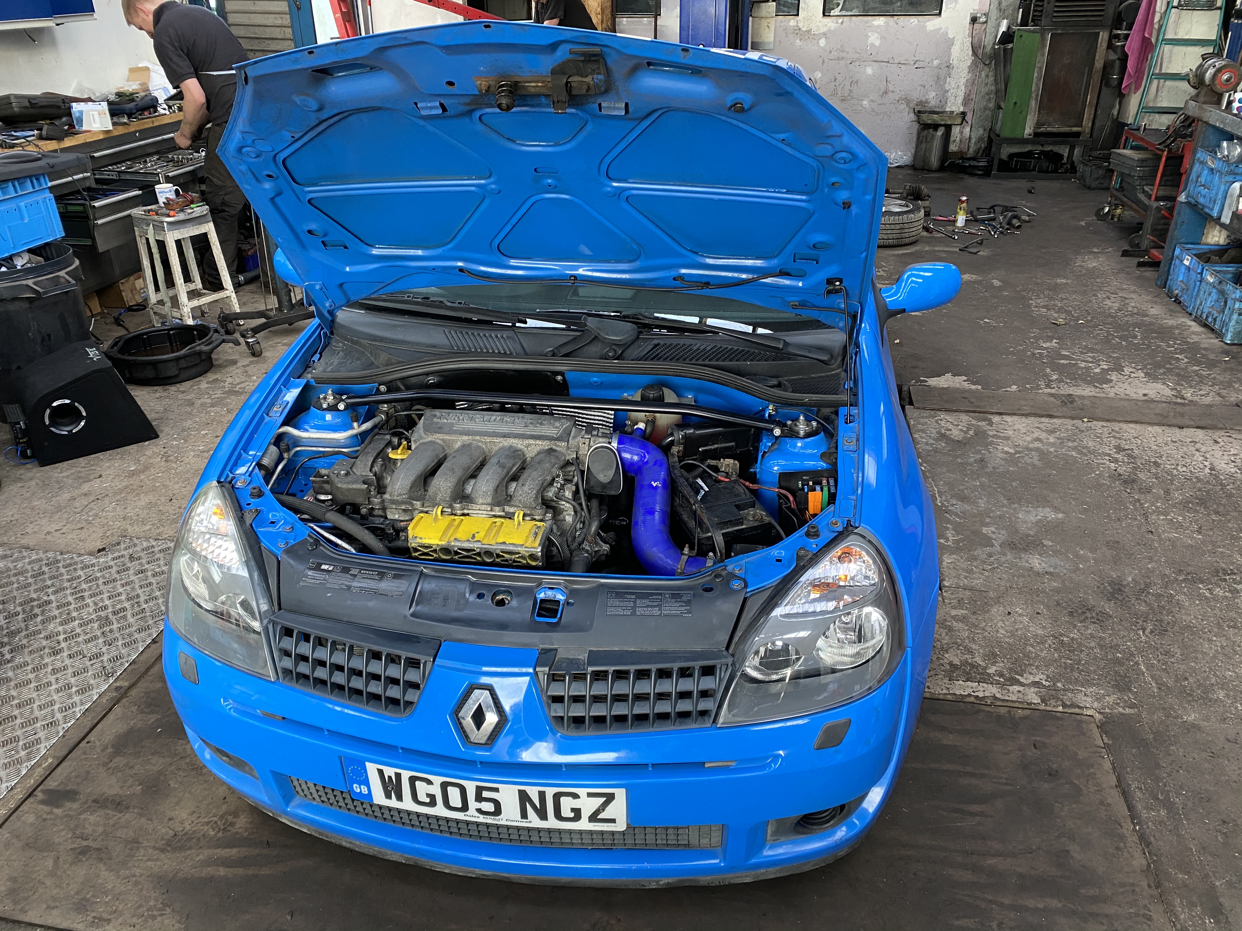

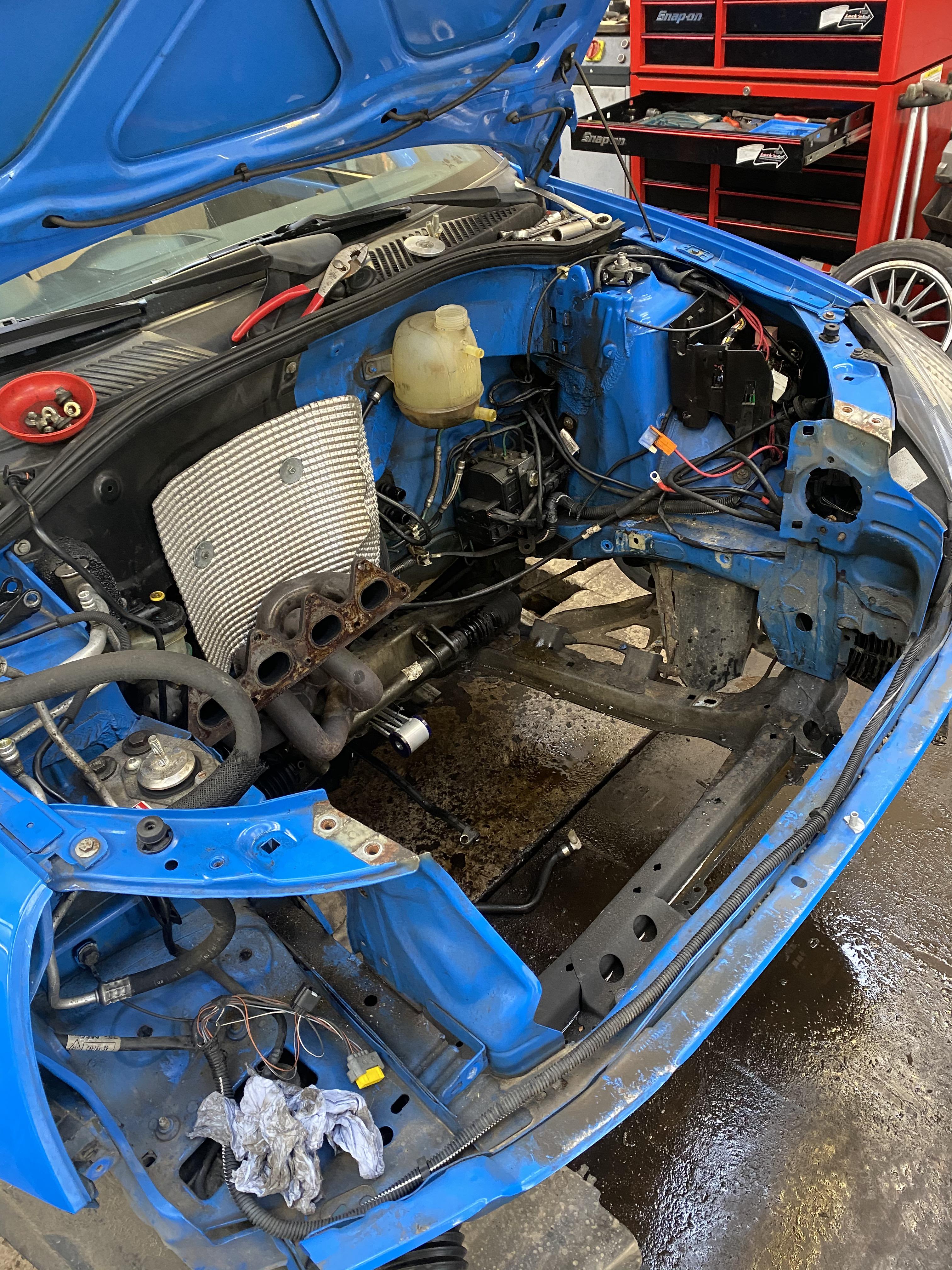

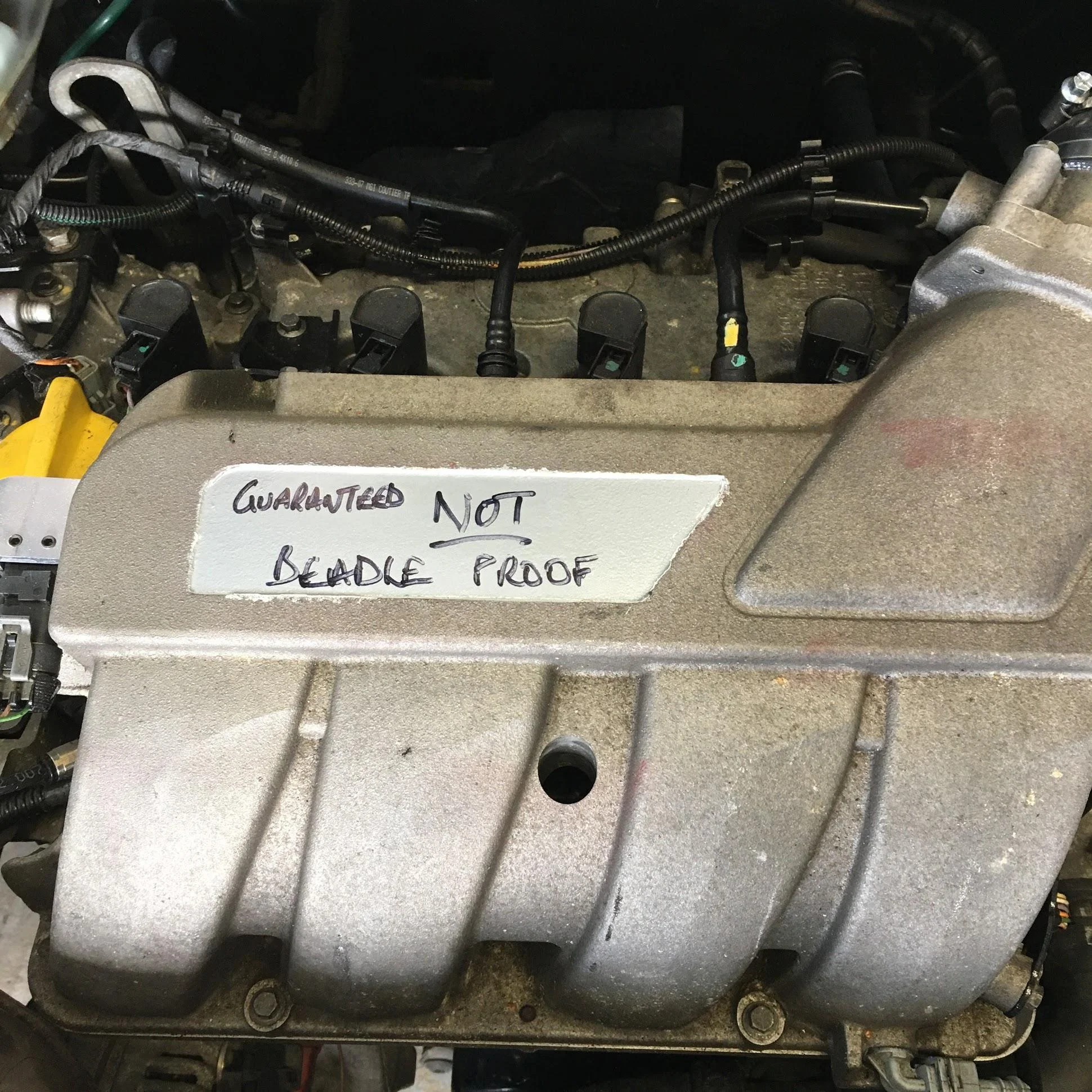

Oil leaks, cambelt, dephaser and clutch...

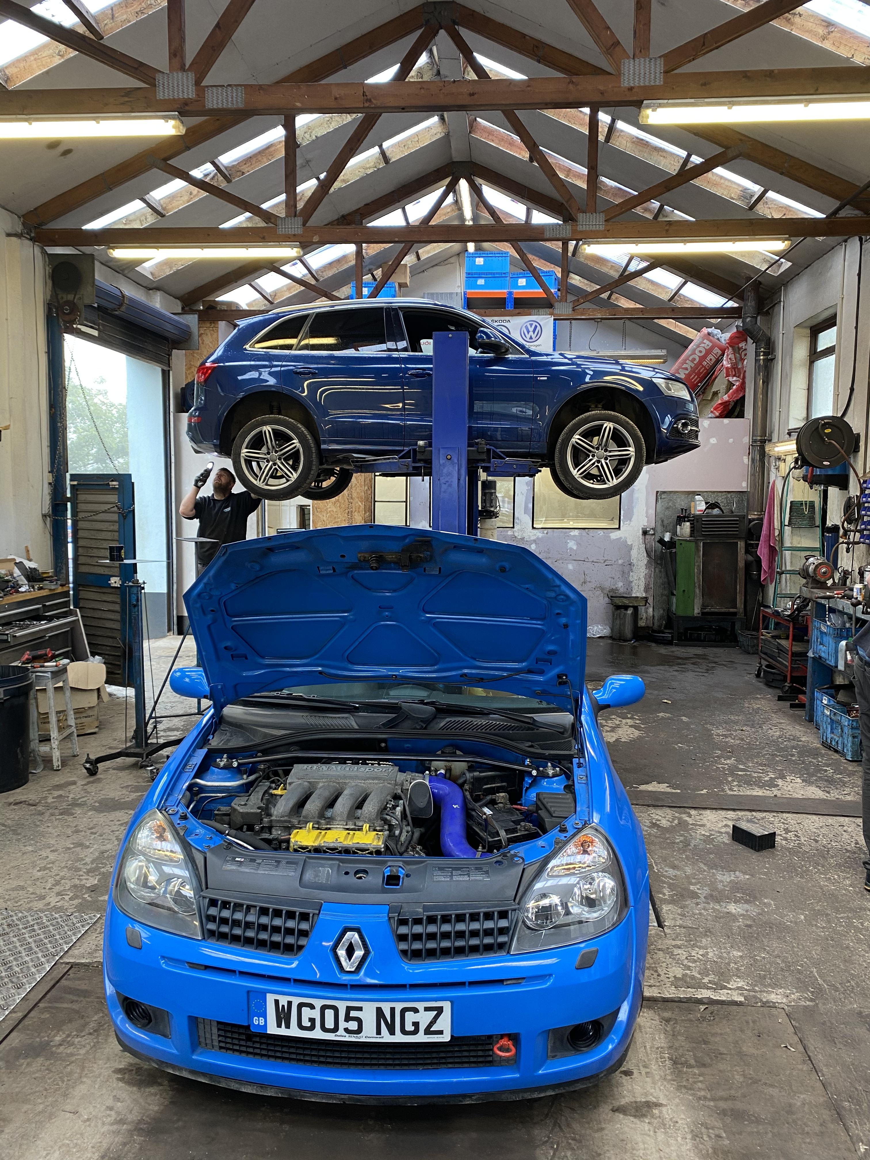

It was never going to be a small job. Helpfully, while we were drawing up a plan, Si suggested the Clio hangs on to Revs and 'we' should get a lightened flywheel while doing all of this. More Pure Motorsport Goodness ordered.
Parts assembled, the adventure began. I've helped a friend build a Caterham in 24-Hours as part of a team, but I've not taken an engine out or done something on this scale. 50% looked forward to it. 50% wondered why on earth, on a gloriously sunny weekend, we thought this was a good idea. Thankfully, this was something Jem could do in his sleep (possibly in his nightmares vs. the Volkswagens they specialise in).
No turning back now!!!
Someone had been in before and the tipex was an ominous sign. However, Jem had the factory locking tool so all was well.
And, breath...
Well, that was an experience. Mostly, I tried to stay out of the way and fetch things. Massive thanks to Jem. While doing all of this we also did a full service, including replacing the gearbox oil.

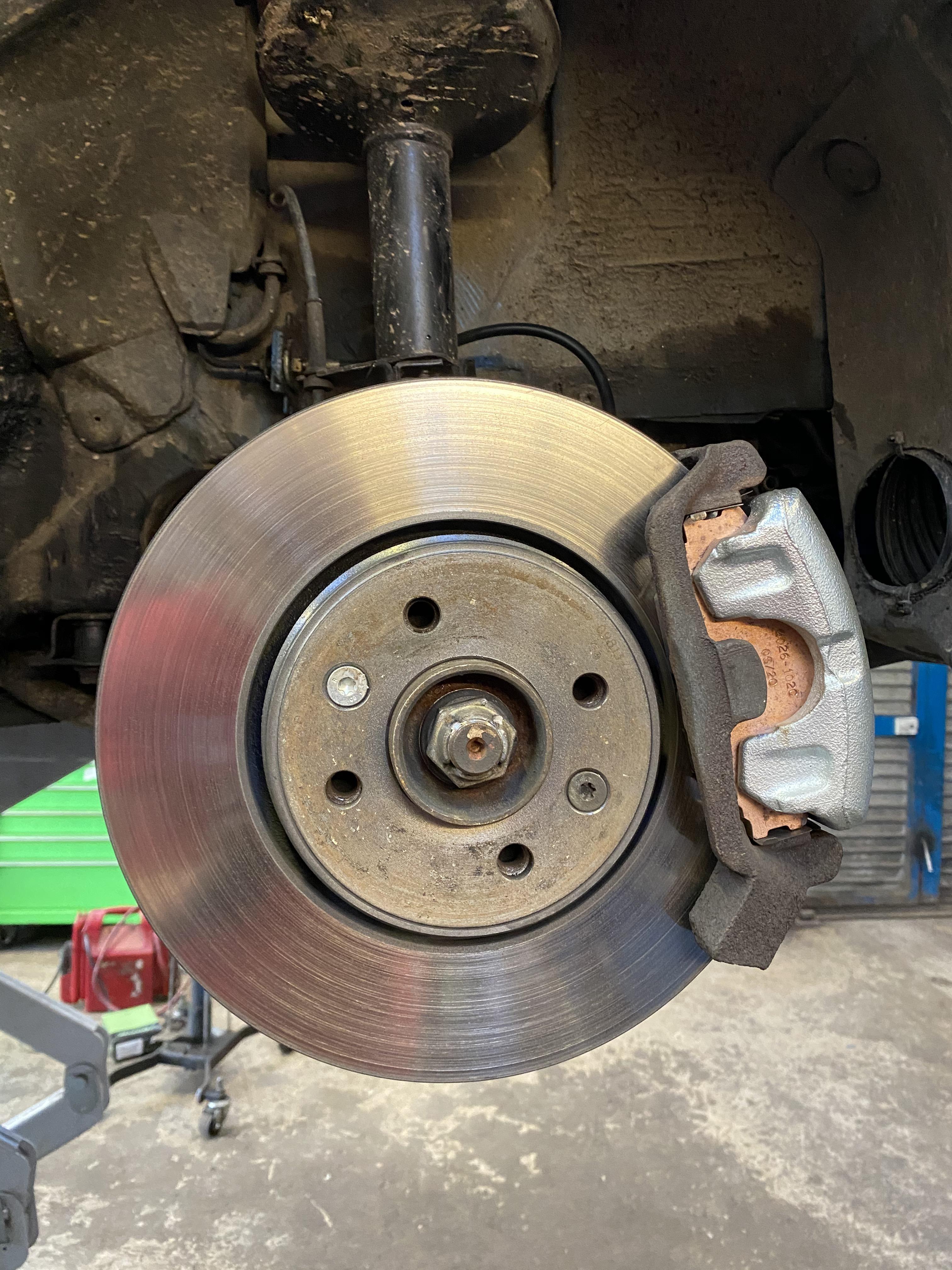

New front pads, discs and calliper
Our discs and pads looked OK, but measuring the front pads showed a discrepancy between driver and pax-sides. As a precaution, we bought a replacement calliper and new CL6 pads & discs.
