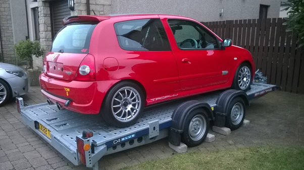

Hi all, I have been mulling over doing a build thread from when I bought the Clio over a year ago, so I have finally decided to bore you with the car’s progress to date.
A quick photo below of it sitting ready to go for its 2015 track outings before I run through the build & photos over the last year:

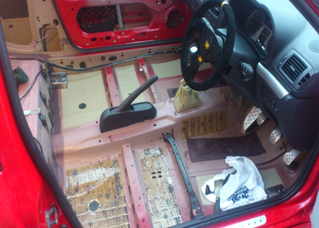

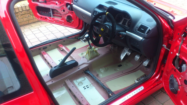

So with piece of mind on the mechanical side, I started stripping and throwing away what was left of the Trophy interior and removing every bit of sound deadening & tar that I could find. Dash was stripped out as well and all sound deadening behind removed and the cage feet were trial fitted:

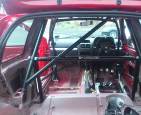

A big thanks to Mark Fish for getting the safety devices full cage to me in time for my May outing and the great deal I got on stock item they had following a group buy.
So after a further few nights of the heat gun and the scraper, the floor was ready and I had the cage mounts welded into place!
All progressing well, but the main thing I should have done at this stage was paint the inside of the car!! Has bugged me every time I get in it since and the thought of taking everything out to get it done now fills me full of that can’t be ars*d feeling. But with the clock ticking for the 19th May track day, I pushed on regardless. A lot of the guys say not to bother painting the inside but due to my OCD it will end up being grey or red at some point this year!!

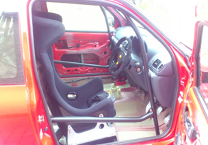

Regardless, cage fitted and the seat mount, seat and harness put back into place:

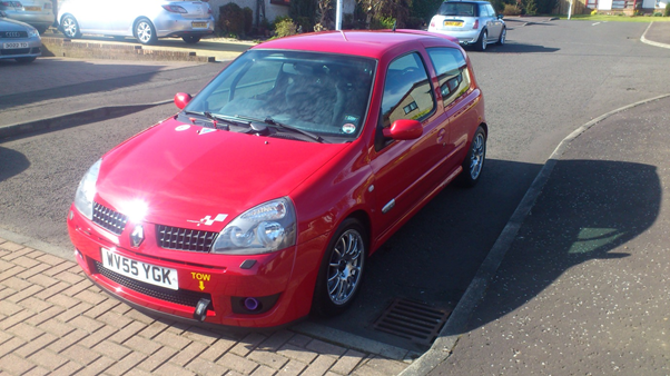

So its May 19th, Knockhill pre booked, as you can see from the photo below the weather is spectacular!
It was a great start to the day, get the car polished and ready to go, drive out the street to take it up and a 100 yards from the house it develops a miss-fire!! Unbelievable, especially as it drives 500 miles up the road 2 months ago, it clears and makes the 20 minute drive to the circuit no problem at all. On arrival we change the tyres over and get signed on. Start her up and the misfire is back! You can imagine my complete and utter pi**ed off state. A quick check over and its noted that its cylinder 3, I try leads from a mates car and its gone completely, but as he’s booked on as well, no chance of borrowing his that day. Rebuild mine and its running well, I get about 15 laps in and it’s back, so pack up and just watch for the rest of the day! To be fair the grin was still on my face as the Clio did handle superbly. Good thing was the problem was only a minor one, lead nr 3!!

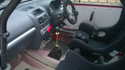

As I wanted to take a passenger I needed a second seat. This is where my OCD kicks in a little!! I don’t want to lose the seat I have so I set about sourcing a brand new Sabelt Taurus seat to match and I managed to get one J. It’s in Ireland, but brand new and slightly larger so I can sit my ass in comfort! So it’s ordered with matching OMP mount and TRS harnesses as the original has, and I slide the original to the passengers side. All installed and looking quite good. I had also picked up a whiteline rear ARB, courtesy of Ears motor sport, and a further set of pro race 1.2’s in white and fitted them with some Yoko A048’s & made myself some door blanks and rear quarter cards to tidy things up a little.
...................more to follow............

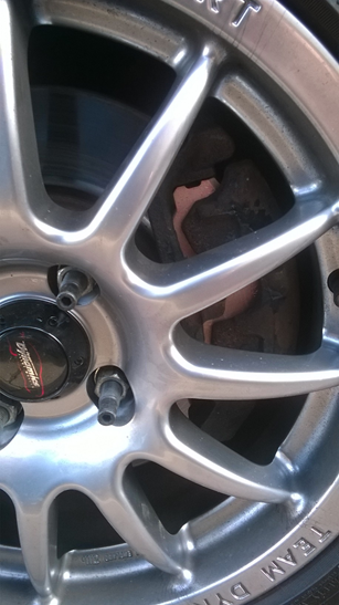

Out again in July, another spectacular day and the car is running amazingly well. The temps that day were through the roof and after a 10 lap burst you couldn’t touch the wheels when you come back in!! unbelievable the white wheels are absolutely baked in dust and the biggest disappointment of all were the DS 2500, they failed, luckily enough no damage done, but that was enough for me, time to change!
As a note that’s the white wheel after a coating of wheel clearer, a good scrub and a pressure wash!! After a few passenger laps in @Fraser.J.’s Phase 1, it was time to get some Carbon Lorraine RC6’s and some new Brembo High Carbons, even as a passenger the braking power and confidence with the RC6’s was clear to see over the DS 2500’s & they were a must purchase!

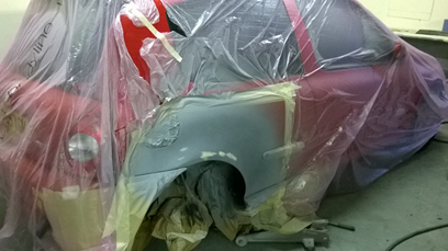

I know it’s just a track car, but I do like things to look right, so the car went to the body shop to get the rear quarter repair improved upon.
One other thing I noticed was that the Trophy has had the roof done too, no damage to the roof in the accident, as you can see the inside now the interior has been removed. As the quote was a little expensive for the roof repaint, noting it was a track car, I opted to add a few stickers to take your eye away for it. This shall generate mixed opinions, but I like it and when you’re not on a step ladder taking pictures in the grey dark with the flash making them glow, they don’t stand out that much…..

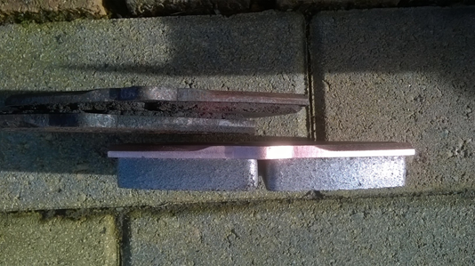

Brake pad change, 4 track days on RC6's, and they needed a change...........? expensive when you look at the mileage, but by Christ they stop the car!!
That shiny gold coating will last for a lap at most!

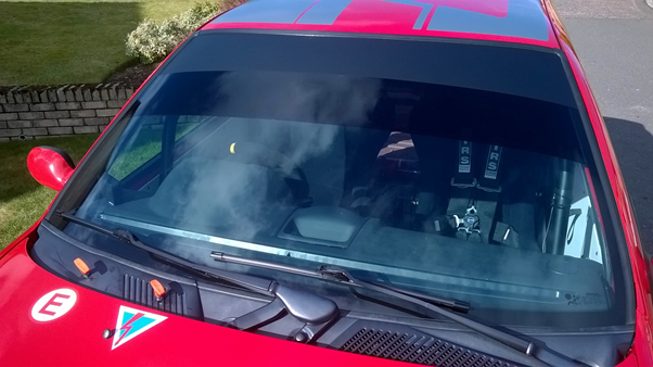

Then in the hope of some summer sun, a sun strip was fitted...... I went for the touring car look, 2 stage, solid satin black at the top (£1.79 Ebay special) and a trip to the local tint guy who covered half the front screen for £10 in limo tint! seems to do the trick and the Ebay special hides that halo look you get on the black dots around the edge of the screen, well it has to look right too!!
