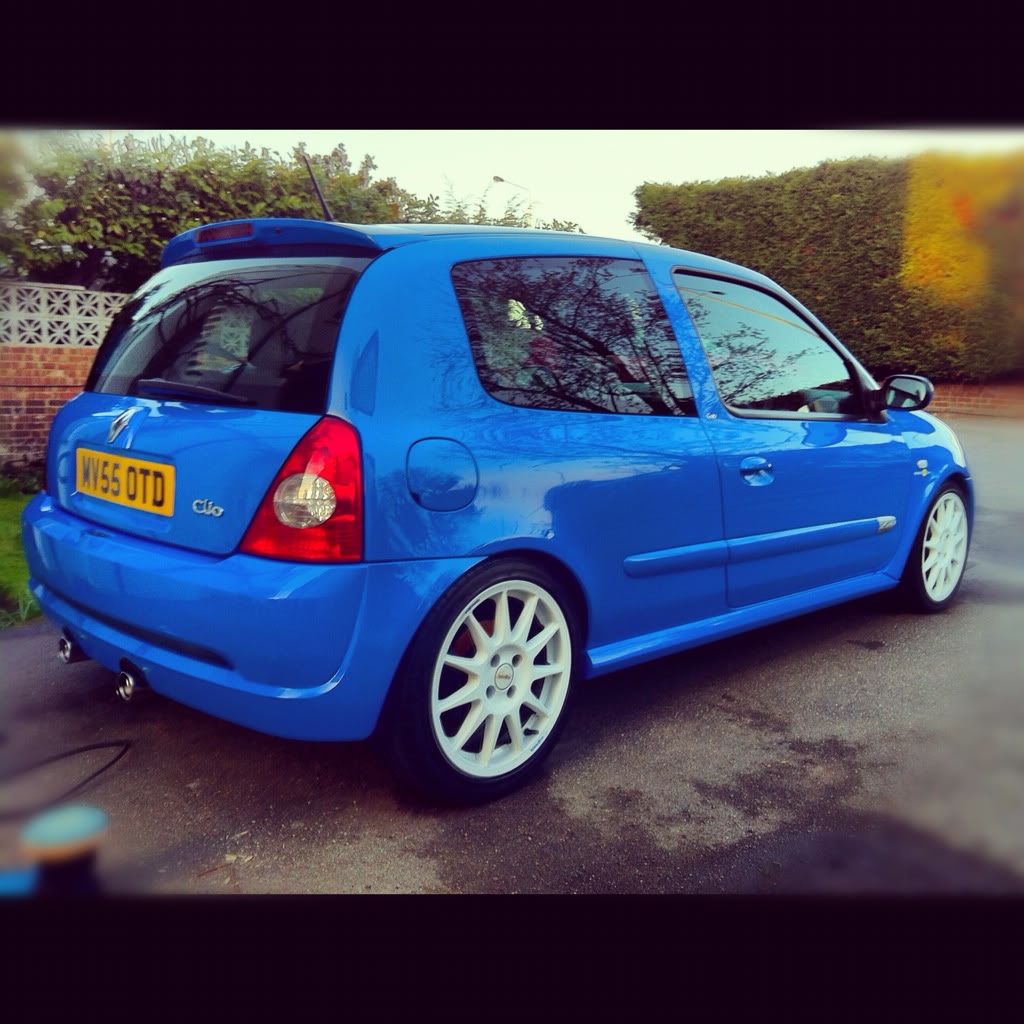

Seeing as it was such a lovely day I thought I would finish machine polishing the Cup.
I had completed the front of the car last week but run out of light to finish the whole car.

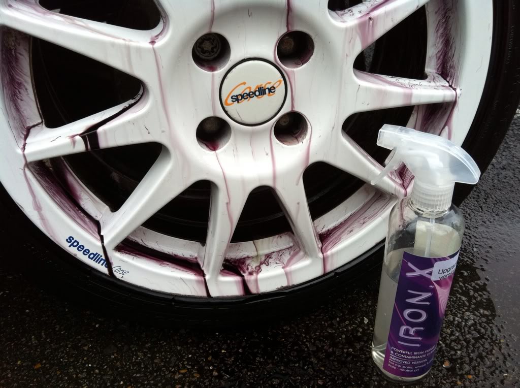

I started by cleaning the wheels with Auto Finesse Imperial, left to soak then agitated with a brush.
Rinsed off and the sprayed with iron x, again left to dwell and then rinsed off.
Tyres cleaned with APC and brush.
Whole bottom half of the car sprayed with Auto Finesse Citrus Power and left to dwell for a while.
Rinsed and then Iron X applied to areas that needed it.
Rinsed again then the whole car cleaned with Auto Finesse Lather and Meguiars Wash Mitt (2 bucket method).
Rinsed and then patted dry with a drying towel.
The rear end was Clayed, so was the roof and rear quarters. I also removed the Renault Sport badge from the boot.

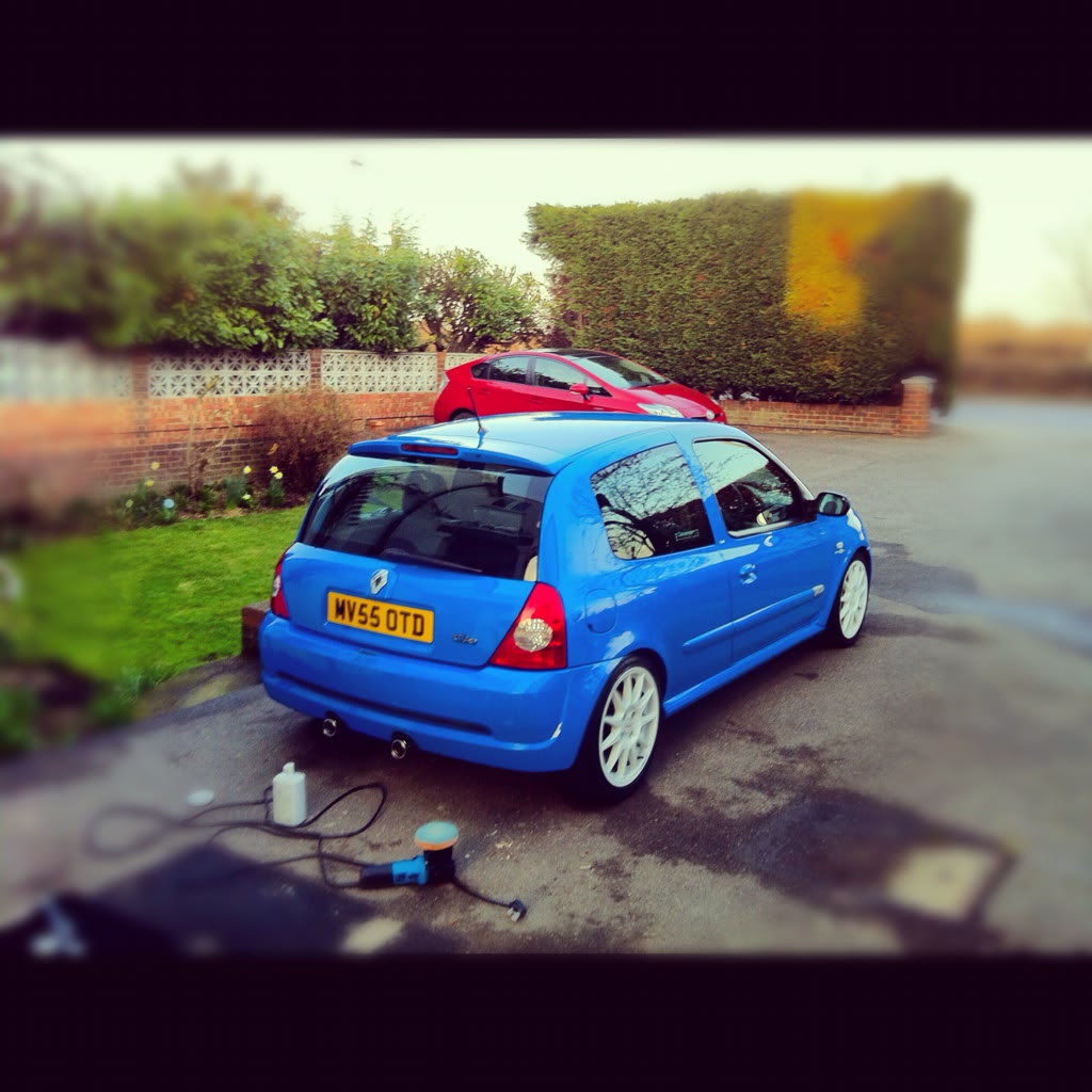

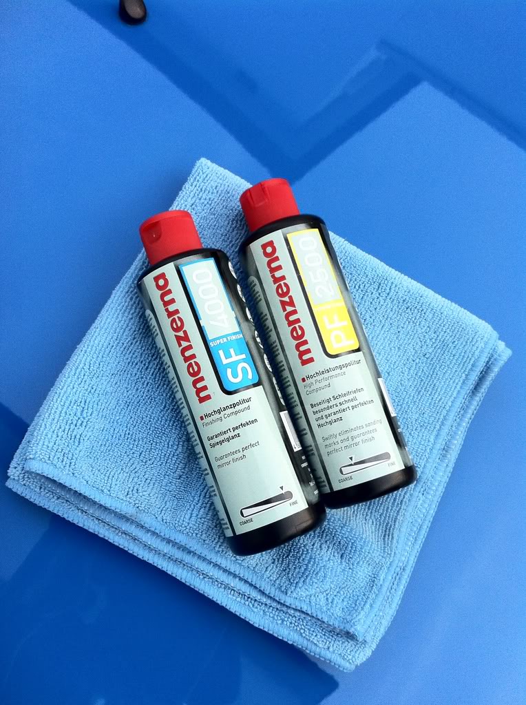

Once all the areas were Clayed, the appropriate areas were taped up and I began the Machine Polishing stage. Used my DAS-6 Pro with Orange Menzerna pad and Menzerna polish.

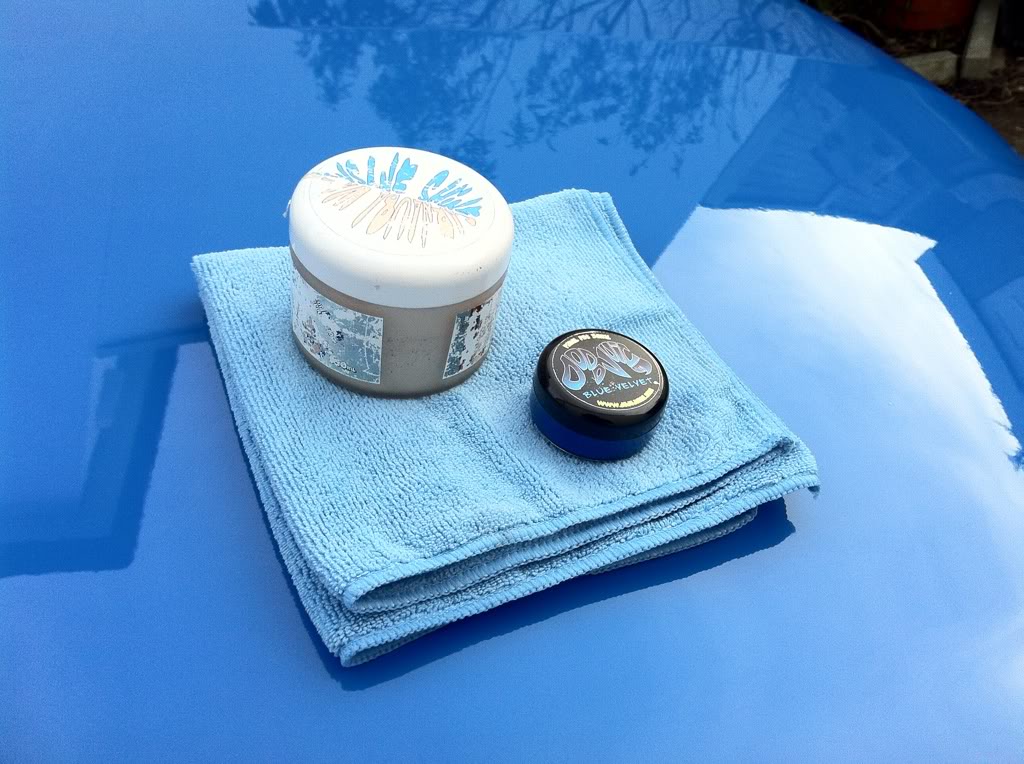

Once all areas had been polished, they were waxed with Dodo Juice Light Fantastic.
Trims treated with Auto Finesse Revive and tyres with Meguiars Endurance.

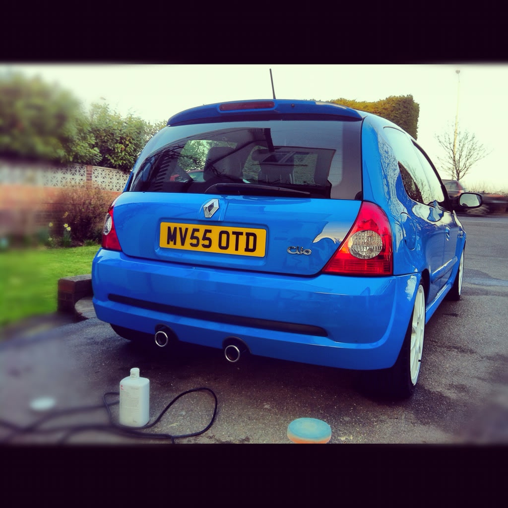

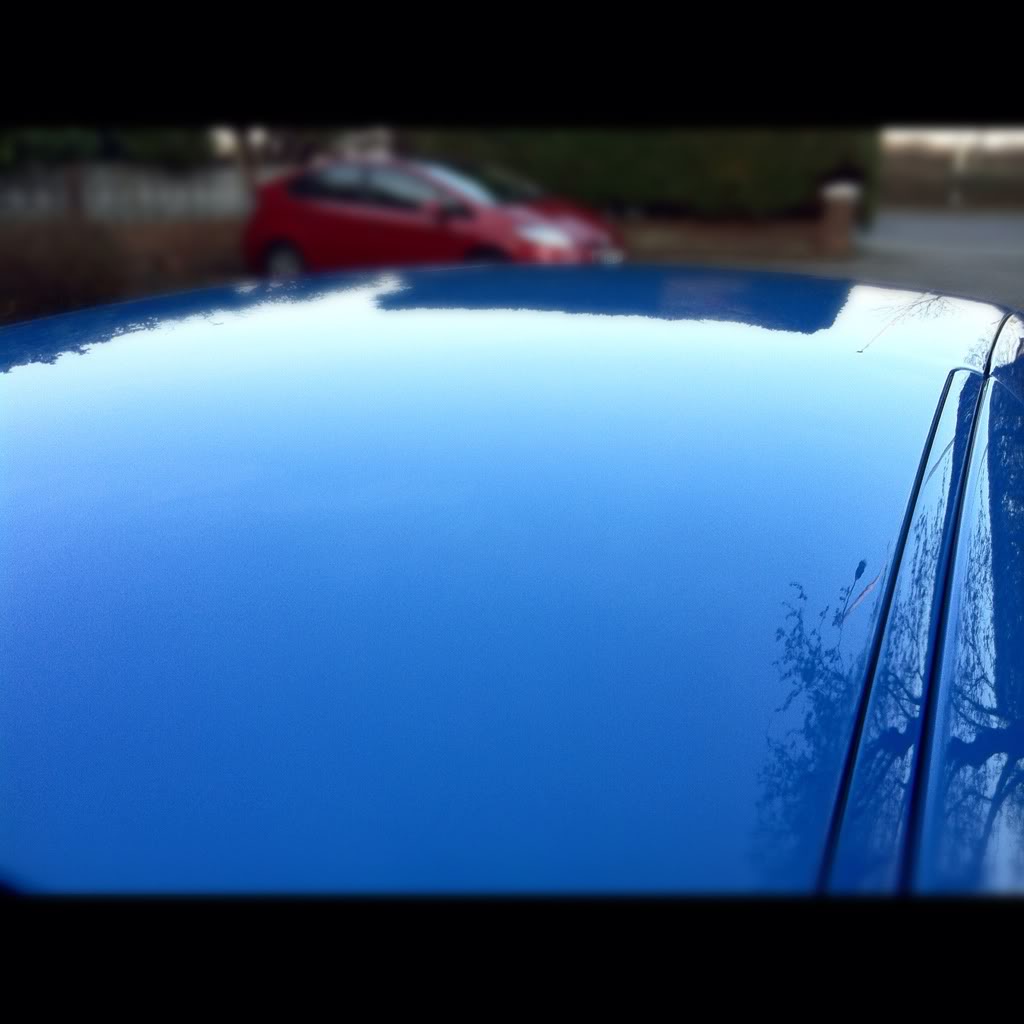

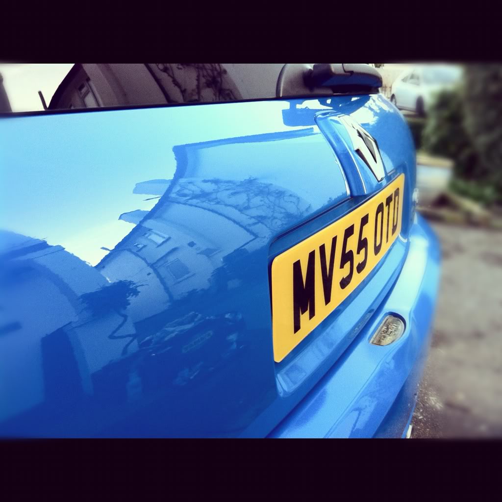

Heres a few pics.
I think the rear bumper was resprayed, there is was some slight orange peel so that's where the blue has come from.
Plus the polish was a purple colour.
