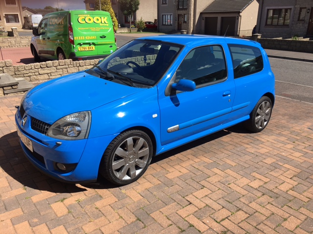

I somehow ended up with another clio a few weeks ago in a totally unplanned deal.
A mate that had owned this RB full fat for the last 9 years as a daily driver ,gave me a shout to see if i knew anyone that would be interested in it and the rest is history :smile:

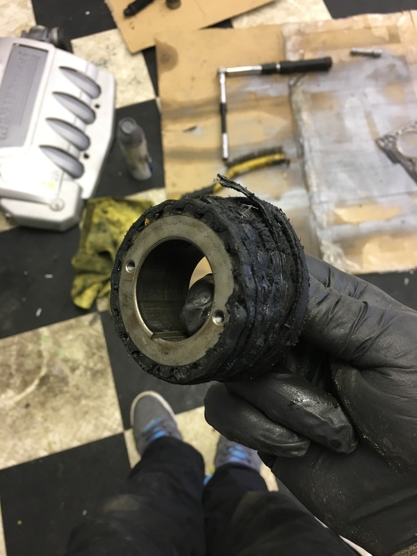

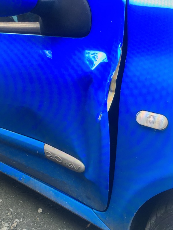

The car had timing belt and dephaser done a year ago but sadly the aux belt went and did the timing , made worse when the recovery driver never fitted the towing eye properly meaning the car rolled off the lorry and took out the drivers door.

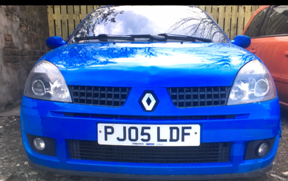

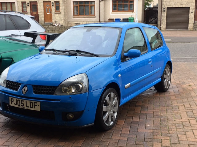

So this is how I got the car.

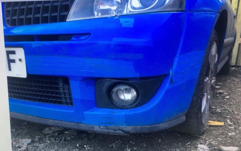

The front bumper was damaged and had been covered in tape to hide the scratches, along with a dead engine and knackered drivers door.
Plans at this time was to break it for parts , but as its a rare colour and a 80k mile , 2 owner car i decided to save it .
New door fitted (thanks Stu)

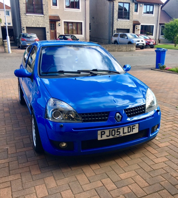

Gave it a quick wash and buff

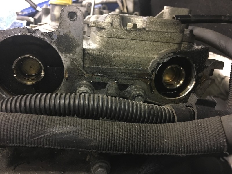

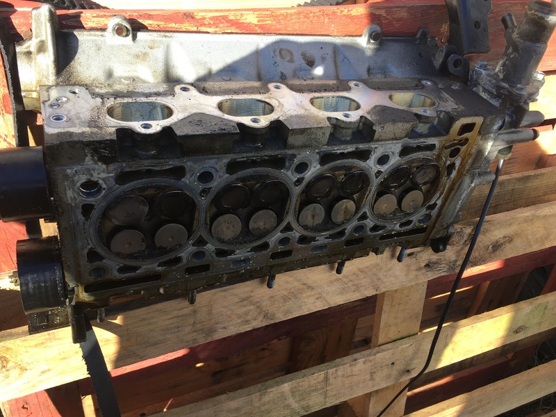

Timing is well out

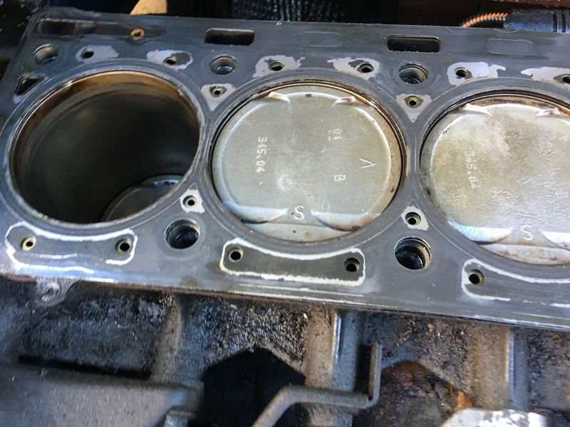

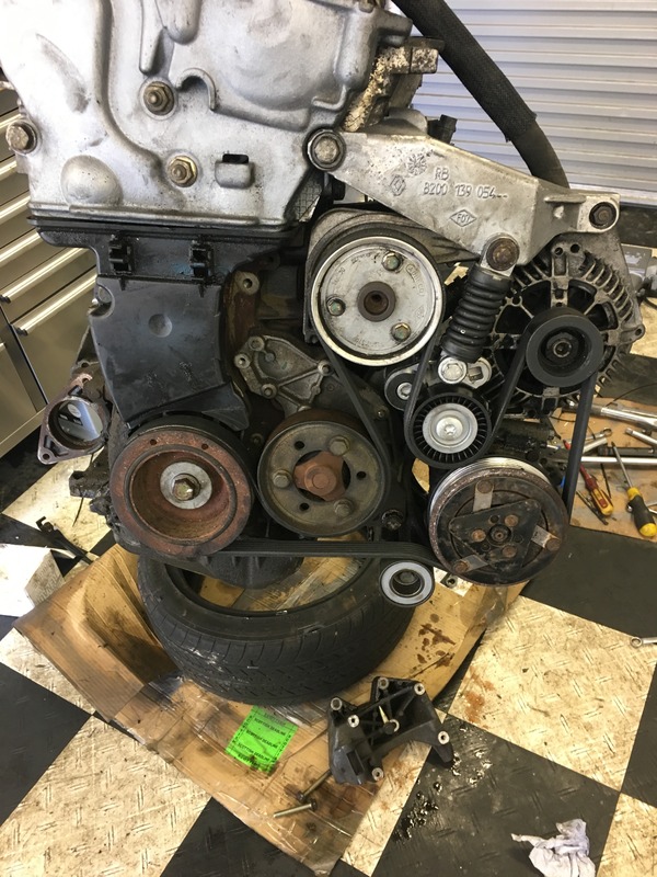

So pulled the head to find 16 bent valves, but the pistons looked un marked.
Found the rest of the aux belt

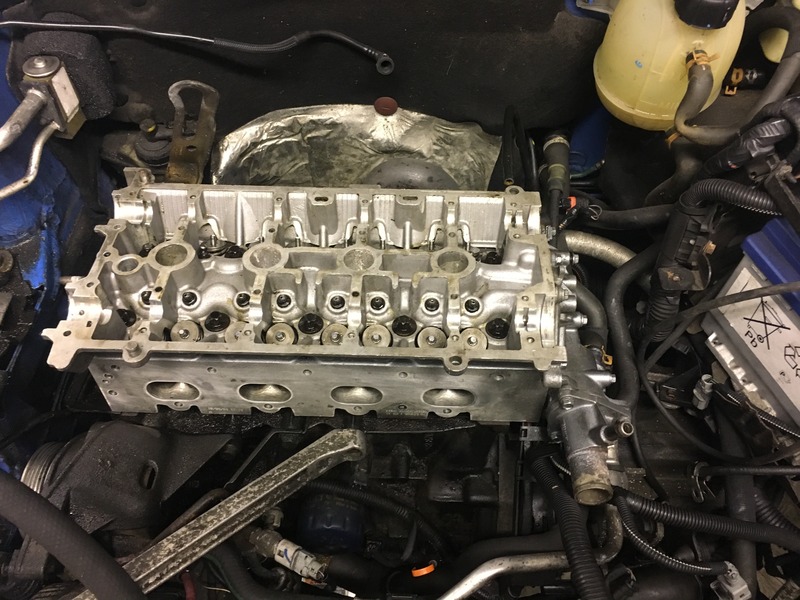

New head on complete with genuine full aux and timing belt kit
Sadly once complete i started the car and there was a knock from the engine , guessing when the valves hit they knocked the shells. So made the choice to scrap that.

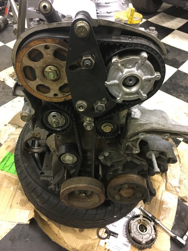

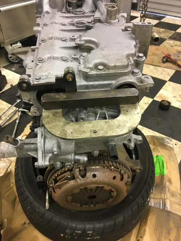

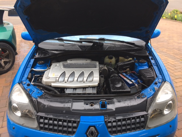

So new 70k engine sourced ,dephaser,and full belt kit transferred over and we now have a sweet running engine in the car.
Thats as far as i got before having to go back to work, but I have a new bumper at the paint shop and a pair of new front tires to go on , then it will be ready for an MOT.
Not overly sure if i will keep it or sell it on once done , if i keep it I will fit a set of cooksport springs and leave it at that , the car already has a RS192 exhaust and jetex filter.

These are the only pics i have on my phone at work , the rest went on a pen drive showing the new engine going in and timing belt being fitted . Including a video of the horseshoe going back in after rotating , knowing how people are so scared of timing these engines.

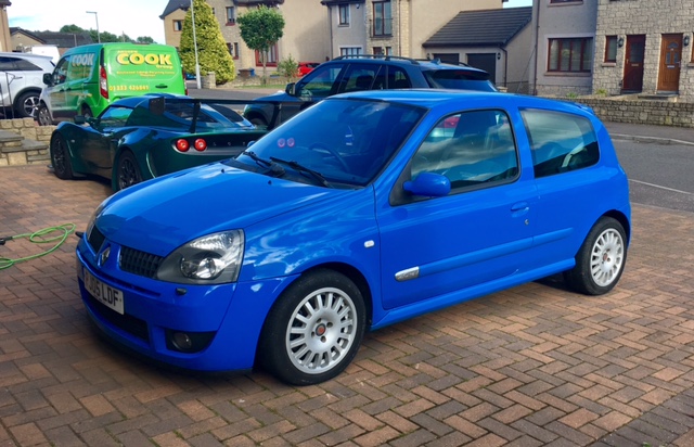

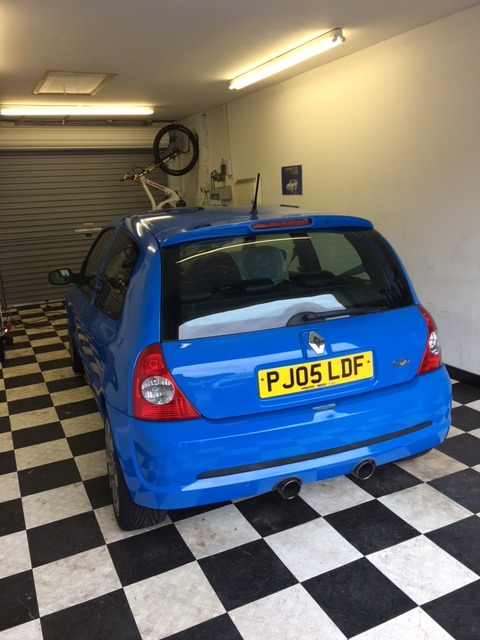

Made a start on this again today .

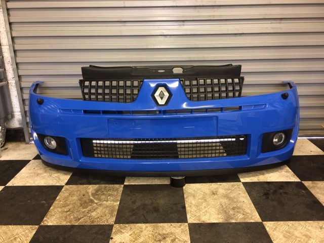

Picked up my new bumper from the painters and got it built up ready to fit.

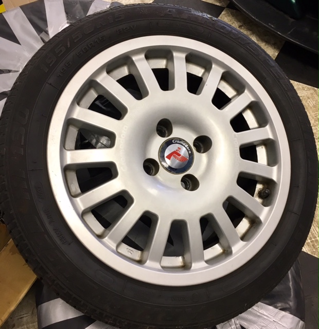

I also picked up a set of sportline springs to lower the car a little , and somehow ended up with a set of 15's as well :tongueout:
Hope to get the springs , wheels and bumper fitted up by the end of the week then its MOT time .

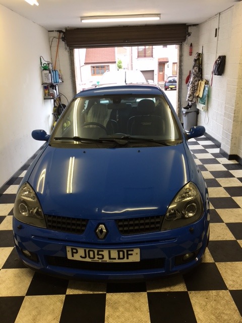

neil a

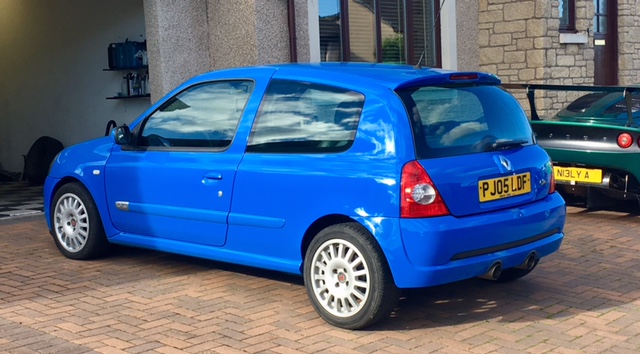

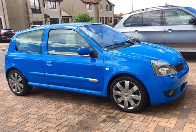

Few more jobs done today , new wheels and spacers fitted along with sportline springs which ideally would of liked to of sat a little lower.
I have a new bonnet to collect as there is a dent and some lacquer peel on this one , but apart from that i think its ready for MOT

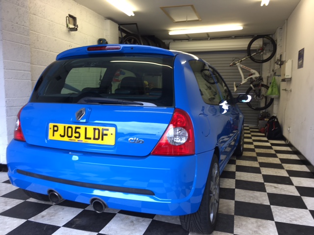

Will hopefully get a few hours to give it a quick detail at some point swell as the paint is a little flat as the cars been sitting around for a while.

Put the standard wheels back on with a pair of new tyres. Hope to get it in for an mot tomorrow.

I was planning on keeping them incase i get another track clio at some point , will probably stick a set of AO48's on them.

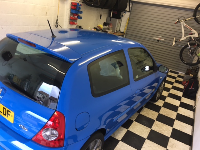

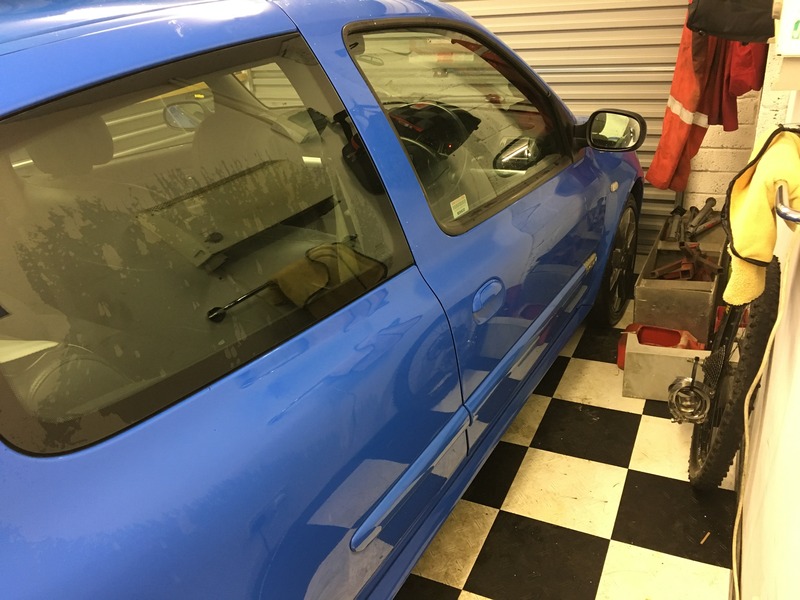

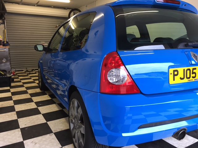

Thanks it has came up quite well and still not had a proper detail , has a few age related marks but overall tidy for its age.

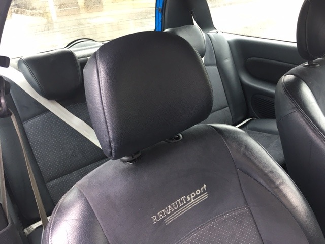

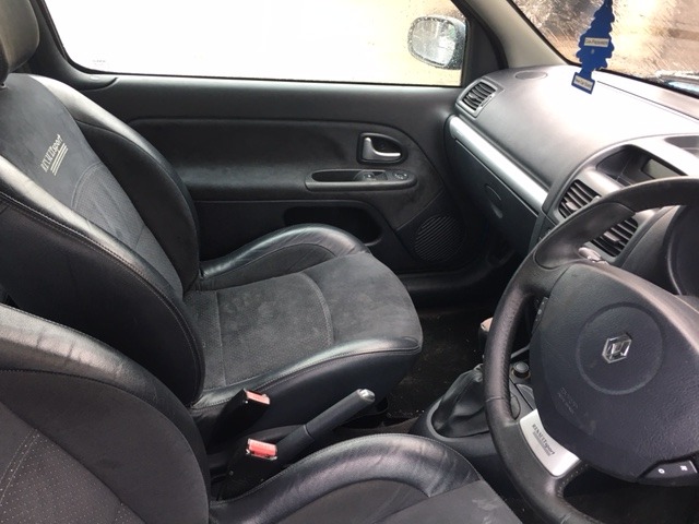

I started to clean up the seats the other day , they are really good for bolster ware .
The steering wheel is good as well , think it may have had replacement thumb grips in the past.

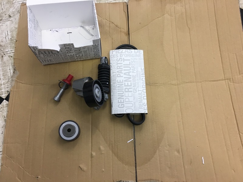

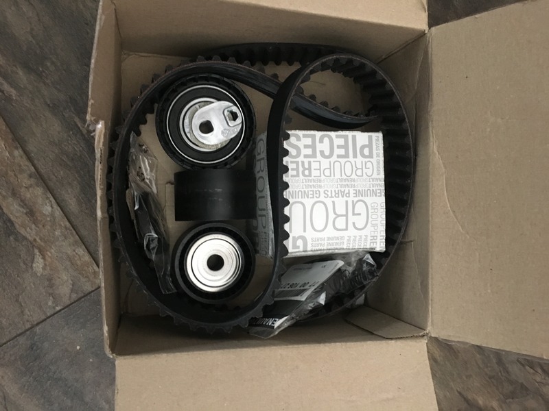

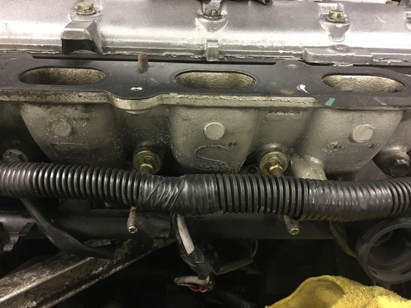

New aux belt kit
New timing belt kit

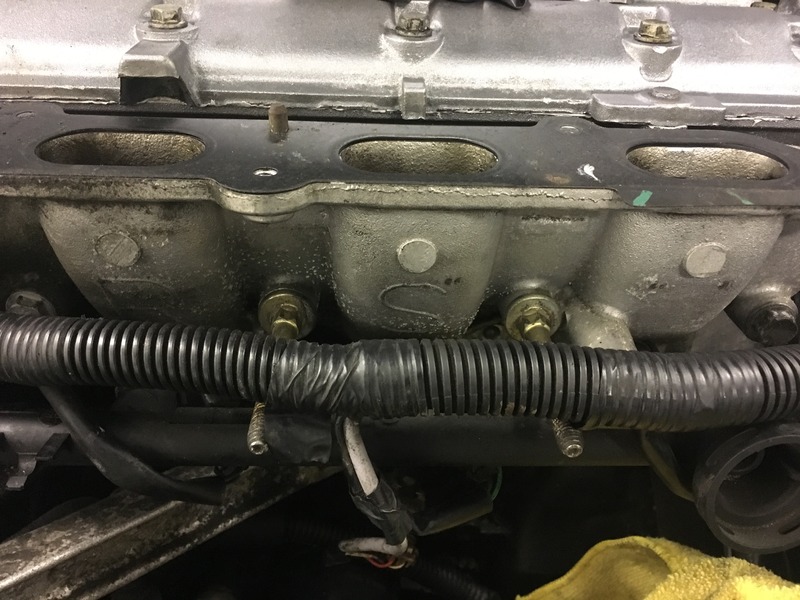

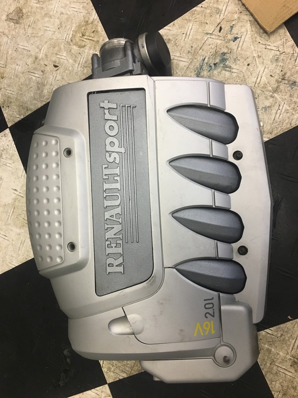

RS inlet
Upper inlet painted , carbon canister feed was modded to work with the 172 inlet
