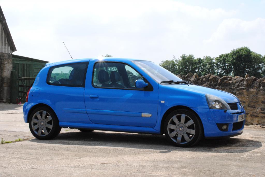

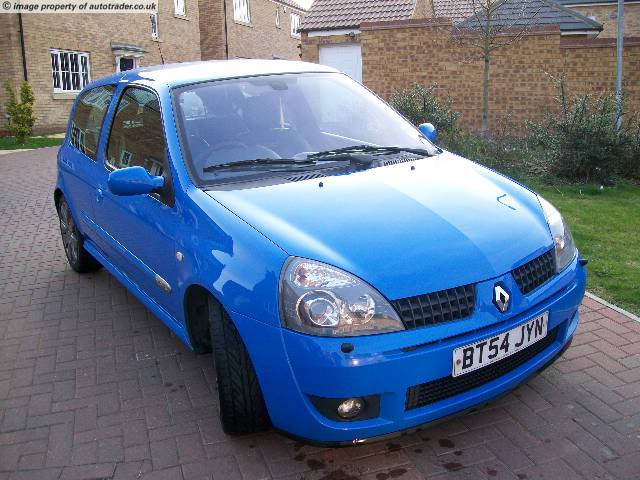

Here is a quick picture from the advert (not Clio oil on the driveway) :p

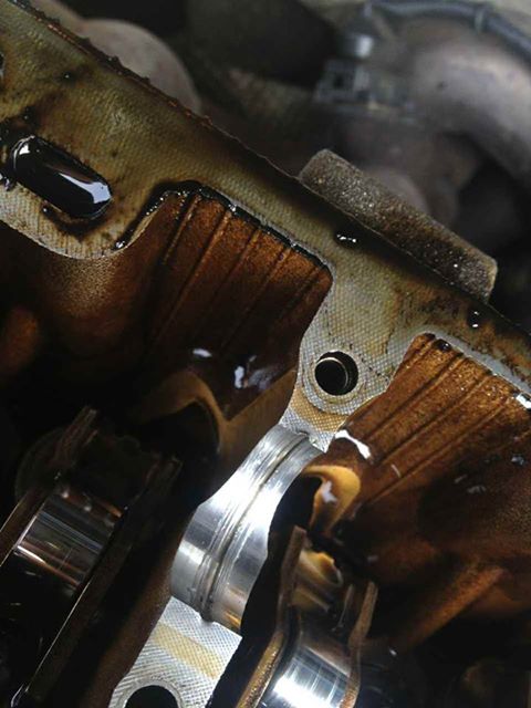

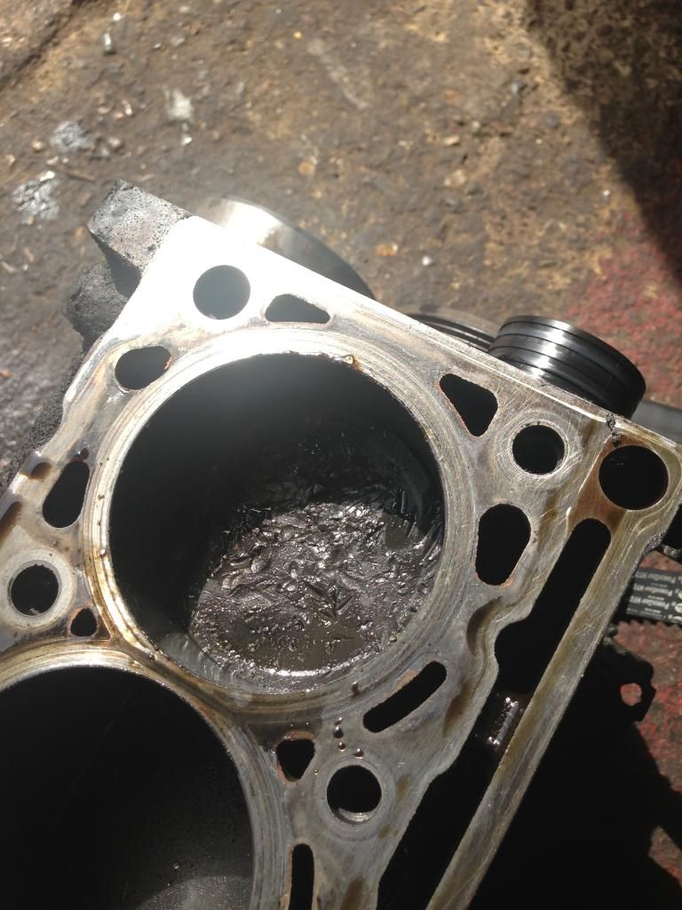

Well after the compression check everything took a turn for the worse :(

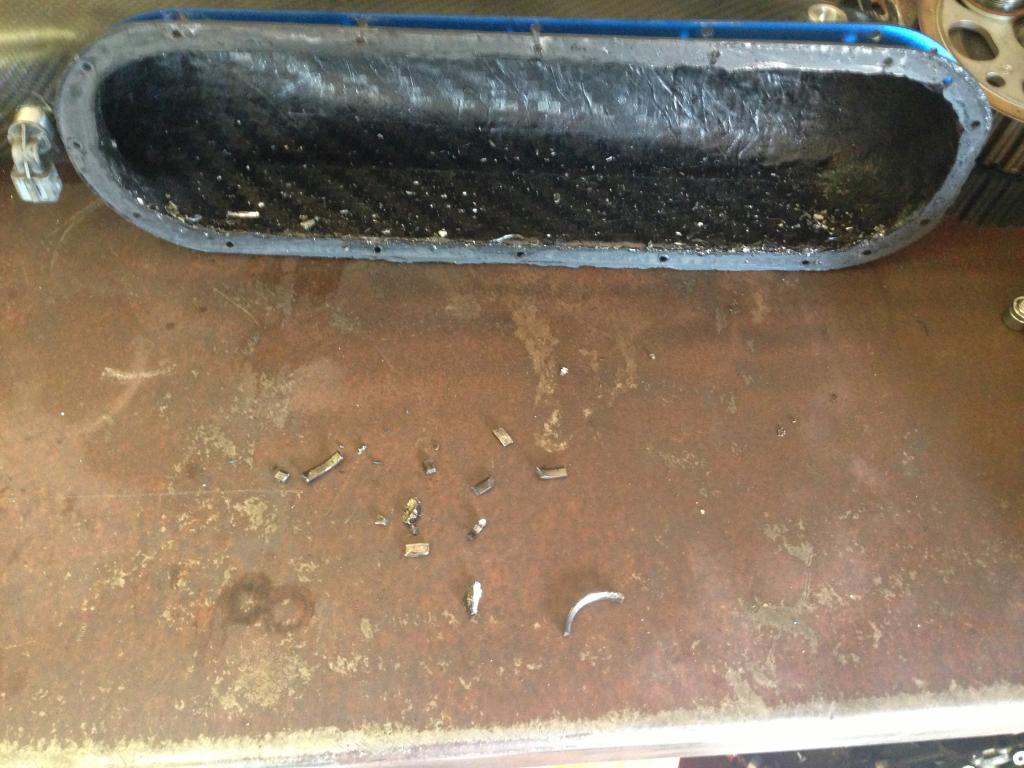

Mike/James took the rocker cover off to reseal and ended up finding this :dead:
At some point this engine has been run very low on oil that groove is 2mm deep! :sick: I bought the car on 83k on it and it now has 117k on the clocks. It has always used a bit of oil but never caused me any problems what so ever. It ran smoothly and seemed to pull pretty well never had it on rollers so I don't know what power it was making, the car is now on 117k miles
Panic stations need to source a new engine!

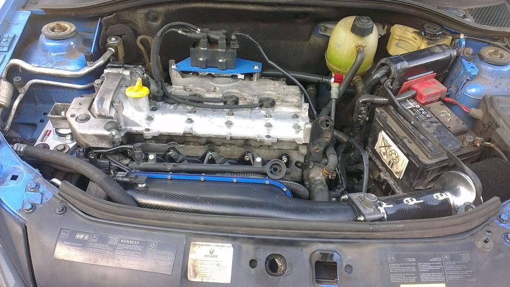

Well I collected the car From James/Mike on Friday evening just in time for CSS shame the weather was terrible so the RS2 wasn't out on display much.
I am popping back down to staines on friday to have the map finished, just didn't have enough time, so driving it very gently this week. Still just so happy to have the 182 back after 3 weeks of Chevrolet spark driving.

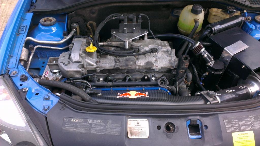

here are a couple of poor quality pics, engine bay needs a wipe over I know :p
I have a new battery to go on as mine is very weak now, which should help to freshen up the bay a little bit, also need to get some degreaser and a couple of little brushes and give the engine bay a little bit of a freshen up.
I can tell already that the car wants to pull so much better with the rs2 fitted just a shame I can't use it yet lol I dont think it has been over 1/4 throttle yet. I cannot wait for it to be fully mapped so I can see what she can do now.

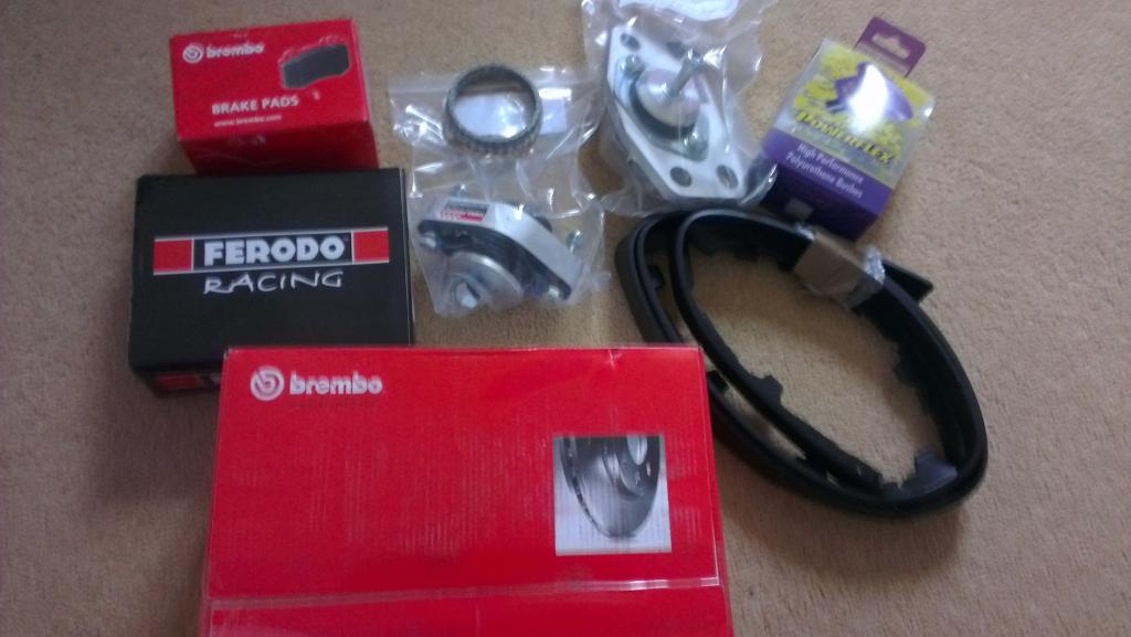

Work completed to date
Fit 172 engine with 182 rocker cover (elf 5 40 oil and renault coolant used)
Belts and dephaser changed
Clutch changed (gearbox oil replaced)
Rs2 manifold fitted
Brembo HC front discs and ferodo ds2500 pads
Climate control resistor pack replaced (was blowing fans full speed)

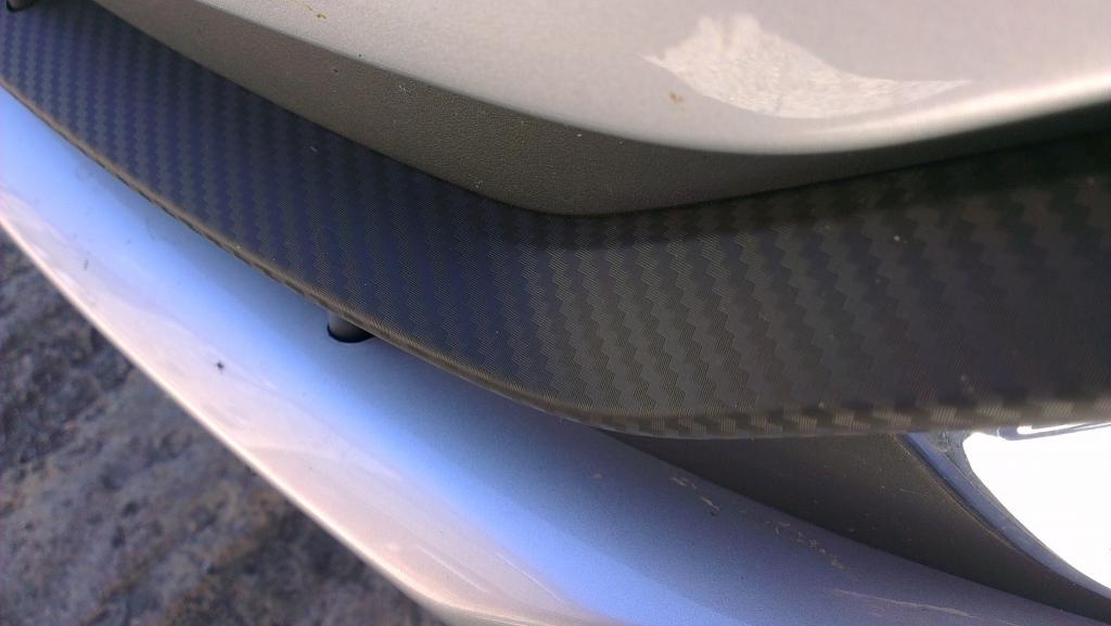

Skoda front splitter (I don't think it looks as good as the original but it looks fine considering it was £13 as opposed to £100+ for a standard one)
Yozza sport full decat exhaust system
Near future plans
New clean numberplates
steering wheel refurb (snappy)
Rear discs and pads (oem spec)
Antracite Speedline 2118's
Full standard suspension refresh (shocks, bushes, wishbones) with either sportlines or cooksport springs

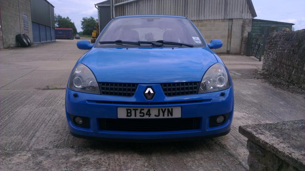

Well I fitted My front 3/4 plate from fancyplates today. It arrived very quickly I only ordered it Sunday afternoon.
quality seems spot on, just hope it doesn't attract any unwanted attention.
The rear plate will have to wait til tomorrow as one of the screws needs drilling out...typical
I'm really pleased and feel it freshens up the front end of the car loads.

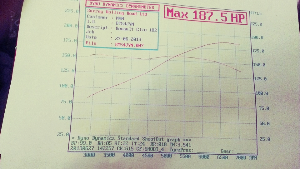

Well I thought I had better update by project thread as I collected my car from S & MWM yesterday evening after it had spent all day being mapped at surrey rolling road, really pleased by the results the graph I have is from part way through the day as the very final bit got finished off on the road as ran out of time at SRR and got kicked out, James and Mike think it should be making low-mid 190's for bhp with a lovely smooth torque curve peaking at about 163/4 ft lb torque with it holding over 150 ft lb right the way up to 6500rpm.
To say I am pleased is an understatement I was even happy with my RR graph from earlier in the day, Mike mentioned about getting it on the rollers again soon to check the power output.
So far I absolutely love the RS2 setup, It makes the car SO much more driveable the car now pulls whatever speed/gear you are in/doing. :)

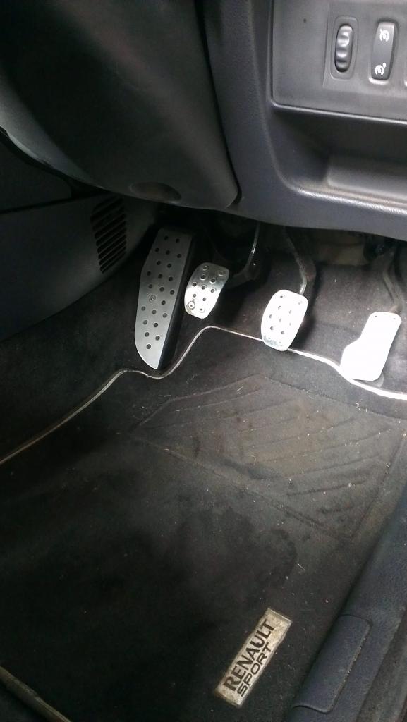

Fitted ally foot rest looks very nice imo. I also had a replacement front windsreen fitted this morning my national windscreens (through insurance) as my old one was stone chipped to hell and had finally developed a crack.

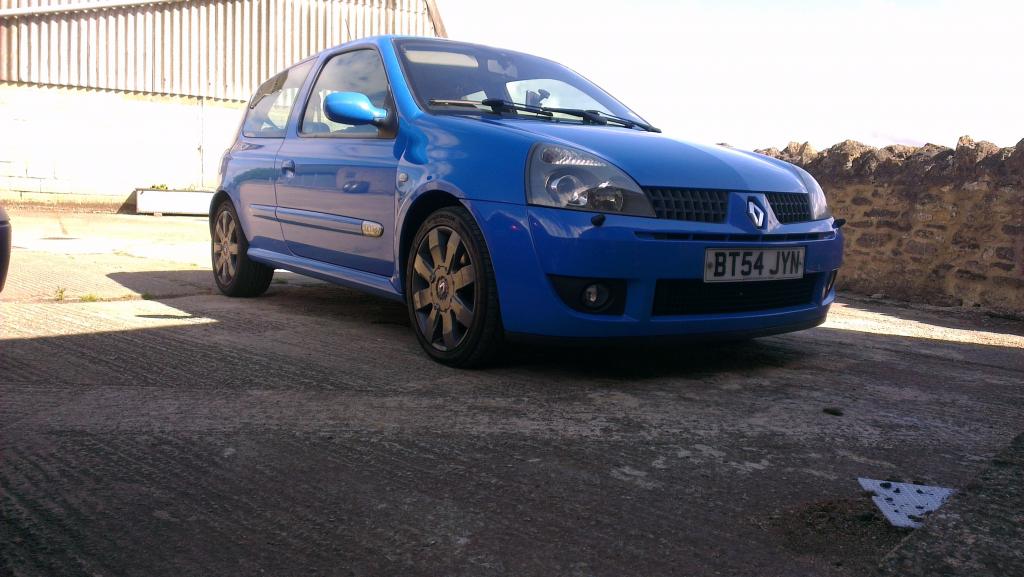

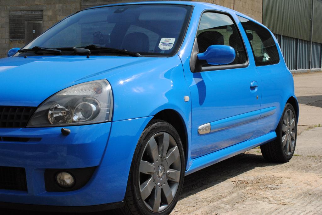

Anyway here are a couple of quick pictures of my (Finally) clean RB,

Epic torque curve that, must go really well. Not good that its burning oil though.
Was discussing the RR results on your car with Mike when he had it for mapping and I think when we move the RS2 from our Black 172ph2 onto our RB I may go for standard cams on Mike's latest timing values rather than putting 197 cams in again, as the plan is to use it a little less on track in future, so the tiny bit of BHP it will cost us over 7K seems a worthwhile trade for the extra midrange torque.

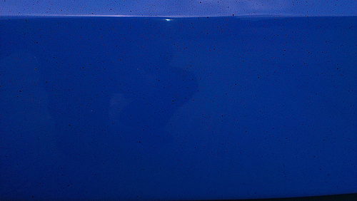

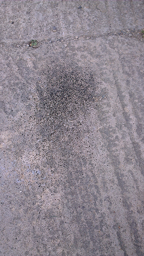

This is a section of rear bumper after 6 days and aprox 200 miles
And this is just behind where I park my car (exhaust end)

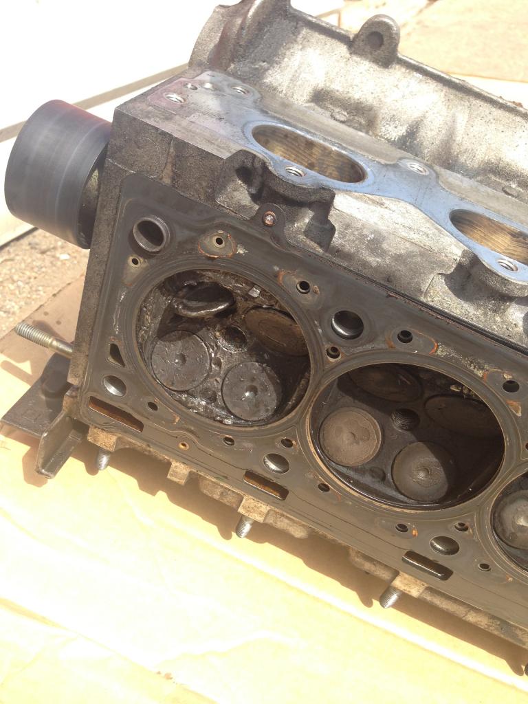

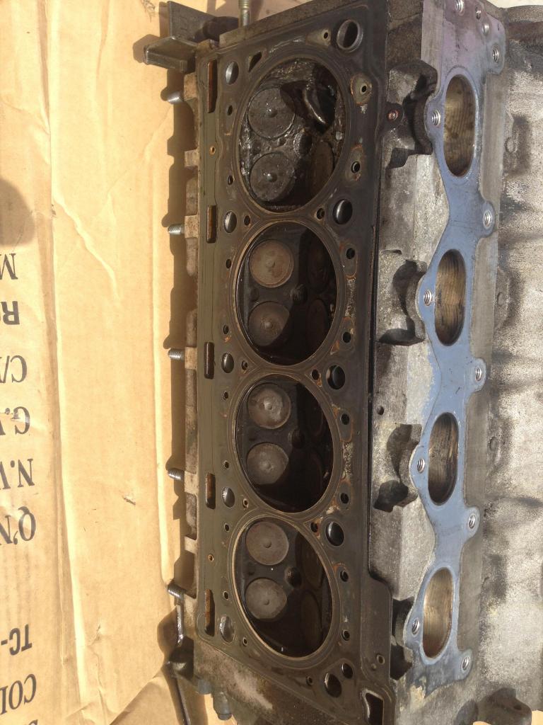

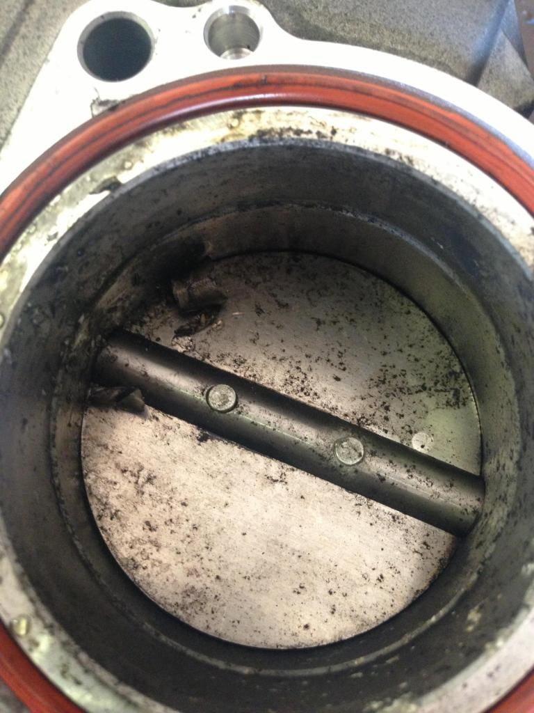

Well things just went from bad to worse!!:mad:
Some of you may have read the thread last night, but incase you didn't. I was just driving to work yesterday evening when as I came round a roundabout in town the car turns in to a steam train, massive cloud of white smoke and the car ground itself to a halt. Popped the bonnet and it had drained the header tank, had a look round the bay no signs of leaks anywhere have a look under the car and a small amount of coolant is leaking from the manifold to decat join. Got a mate to tow me round the corner to his house and got it recovered to Staines today,and made my way home using public transport :dead: from Staines to Croughton via Reading, Oxford and Banbury.
So six weeks after fitting a replacement engine I might be needing another :cry:
The standard two piece valves are rubbish sadly. They join right at the hottest part.

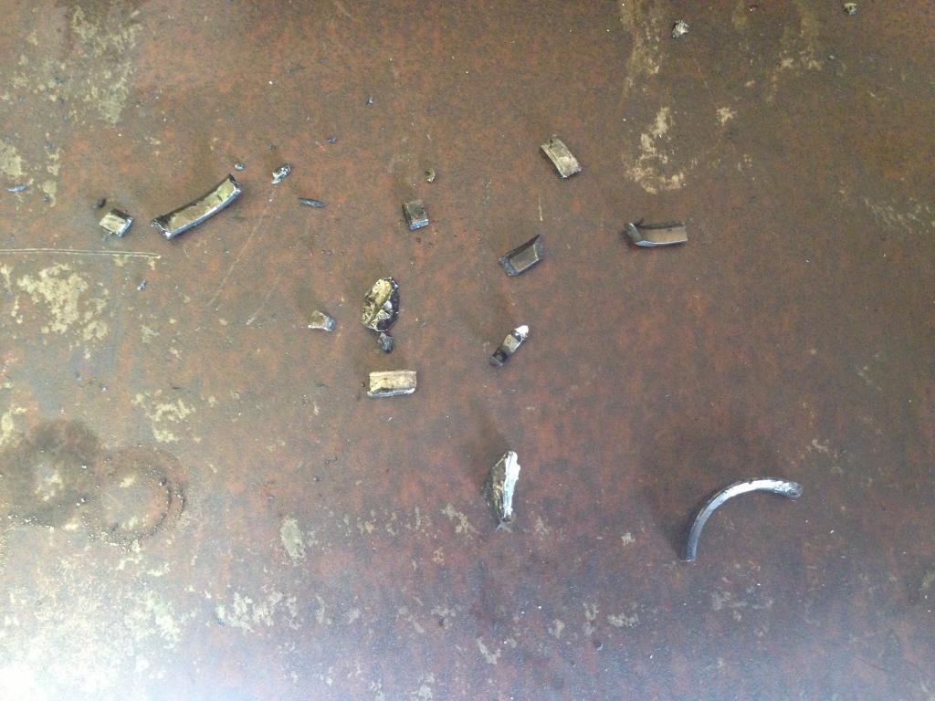

I will get some pictures of my shagged engine when James emails them over to me, apparently is is a proper mess.

As promised though photos of the damage, you can see the mess it made of the RS2 manifold so that required totally stripping down too.

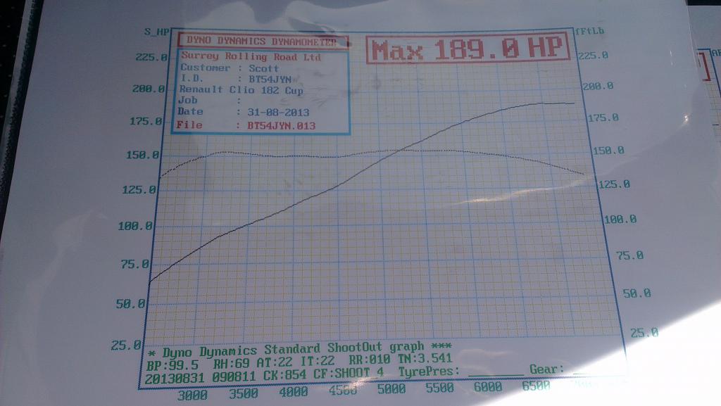

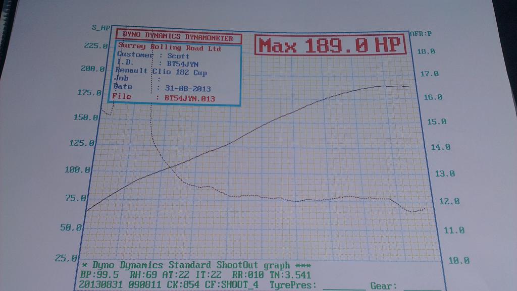

Was up at Surrey Rolling Road today with a few cliosport members and clio16v members.
I'm pretty pleased with the results, Charlie informed me that its running a bit rich and in his opinion should be closer to the 195bhp mark.
Mike at MWM has had a look at the graphs and it is a suspect inlet temp sensor playing up. Going to get him to have a look when the car goes down for its suspension refresh and get it back on the rollers.

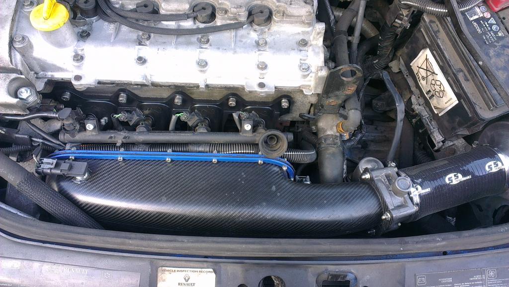

One small mod to the engine bay, totally reversable but I was bored at work the other night so went over to the paint dept on the look out for a Red bull racing sticker (my employer and our works cars are also Renault Sport powered:p) I quite like it atm time will tell if I still like it in a few weeks......
Don't panic the oil catch tank bracket it being tidied up before Trax was just a quick fix at the time :p

Blimey, that was a whirlwind of a read. Glad it's finally running well for you. Fair play for sticking with it when many others wouldn't.
Nice torque spread that, I think I am going to go for retimed 172 cams rather than 197 like he had before when the mrs has fitted the RS2 on our RB.
Will have to ask Mike nicely if he is up for timing them in for me to his latest specs.
