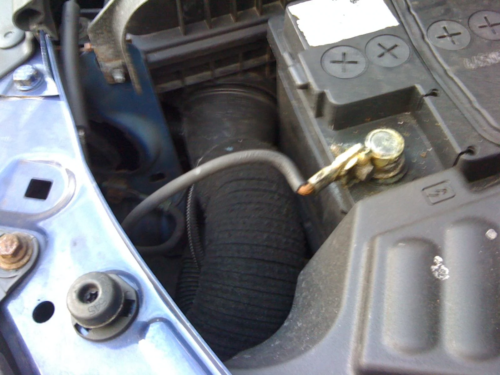

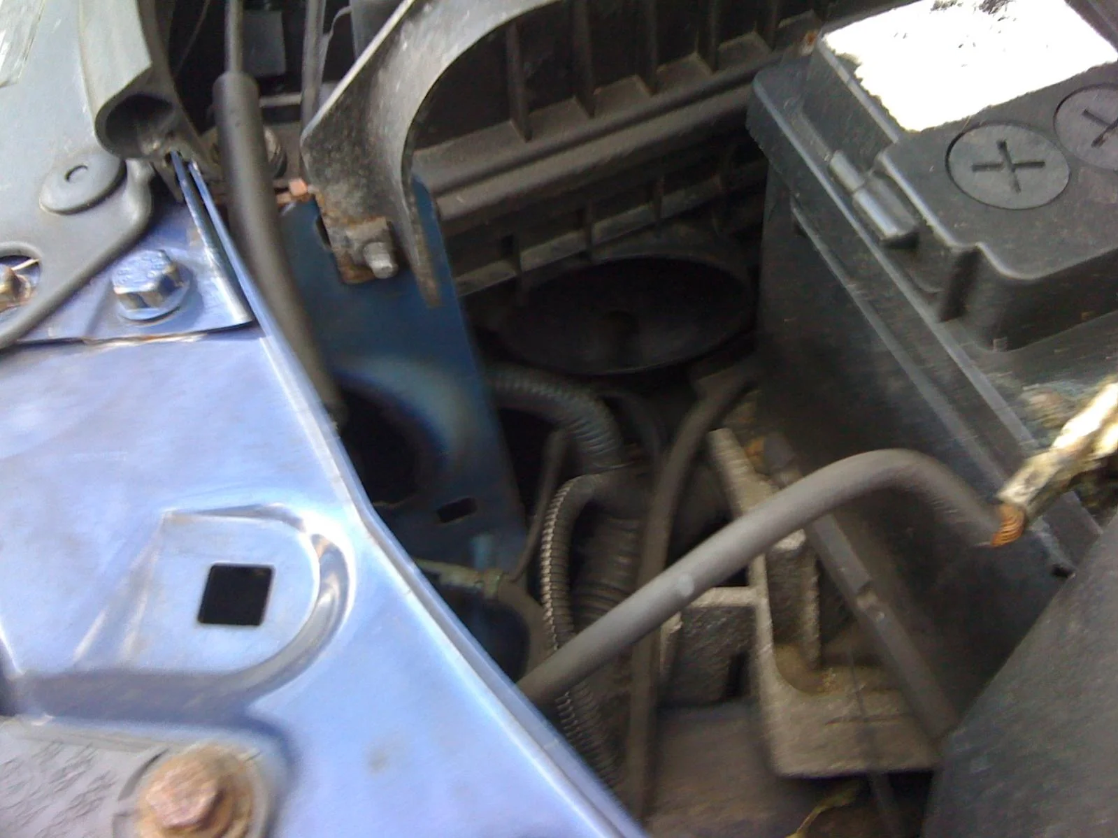

On the subject of CAF pipes and removing the standard side entry pipe as they are only a 'shoulder part', am i really reading it right?
This morning i was bored and decided to try it out, so i pulled off the fluffy pipe that goes from the standard PH2 airbox down behind the nearside headlight.
Is this right? All i seems to have done it make my car sound like a boy racer when i floor it...

so there is slight performance gains then from removeing the CAF?
this goes against all logic in my head lol
